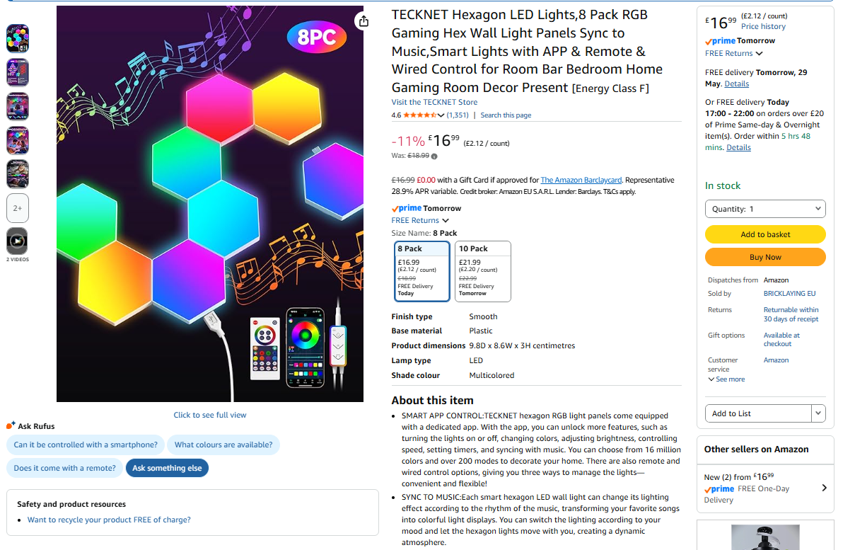

    Tecknet TK-WL001
    https://www.amazon.co.uk/dp/B0DB29L9KR
    Amazon product page screenshot for TECKNET hexagon RGB LED wall light panels, 8-pack.

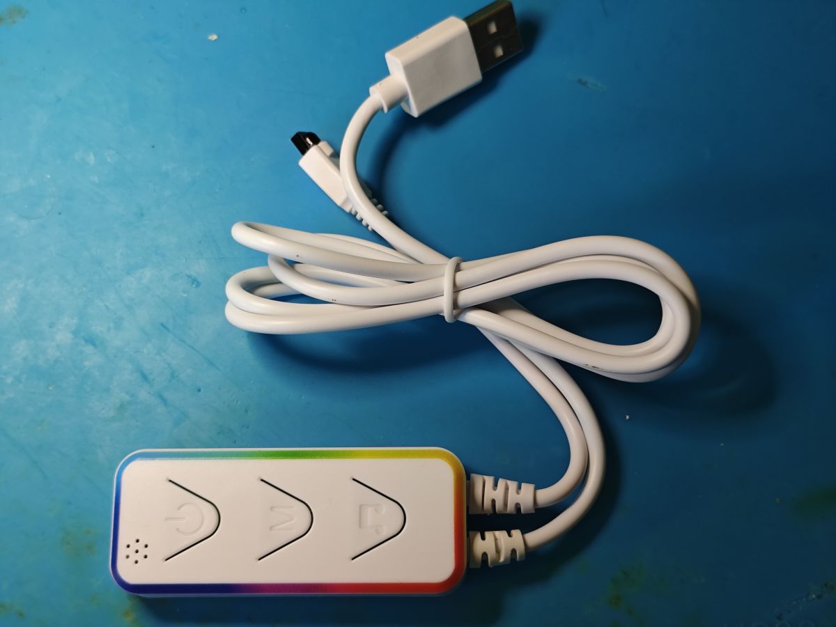

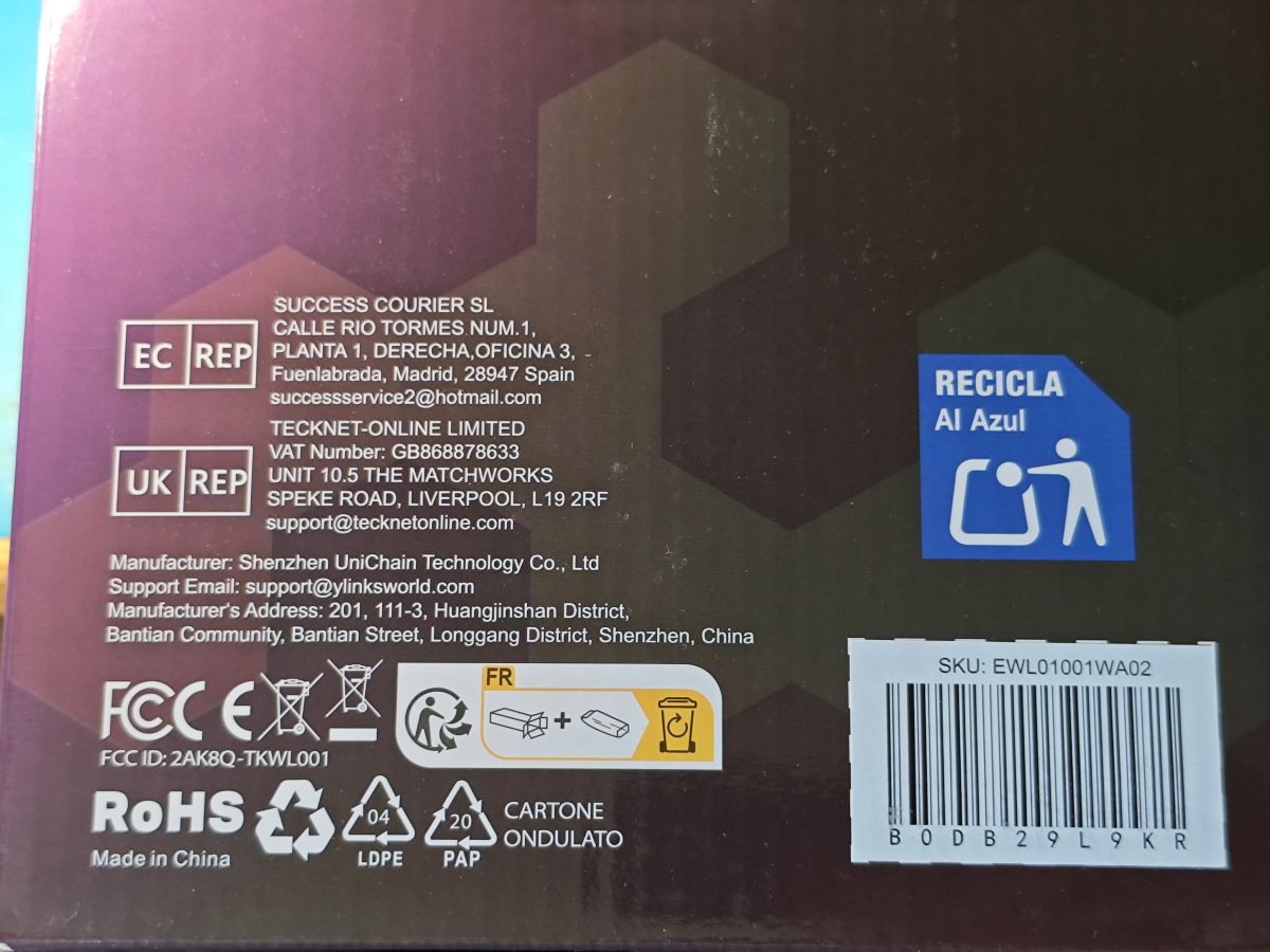

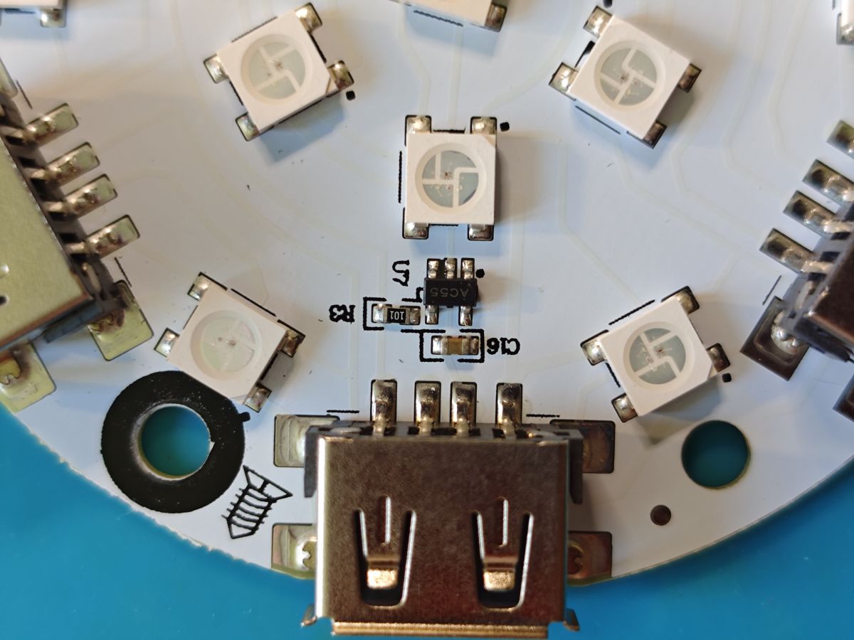

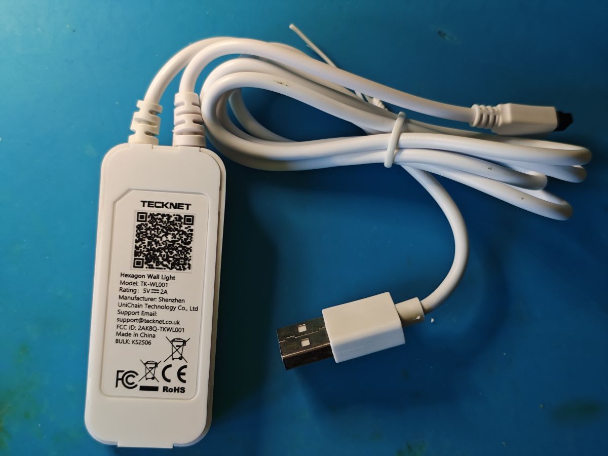

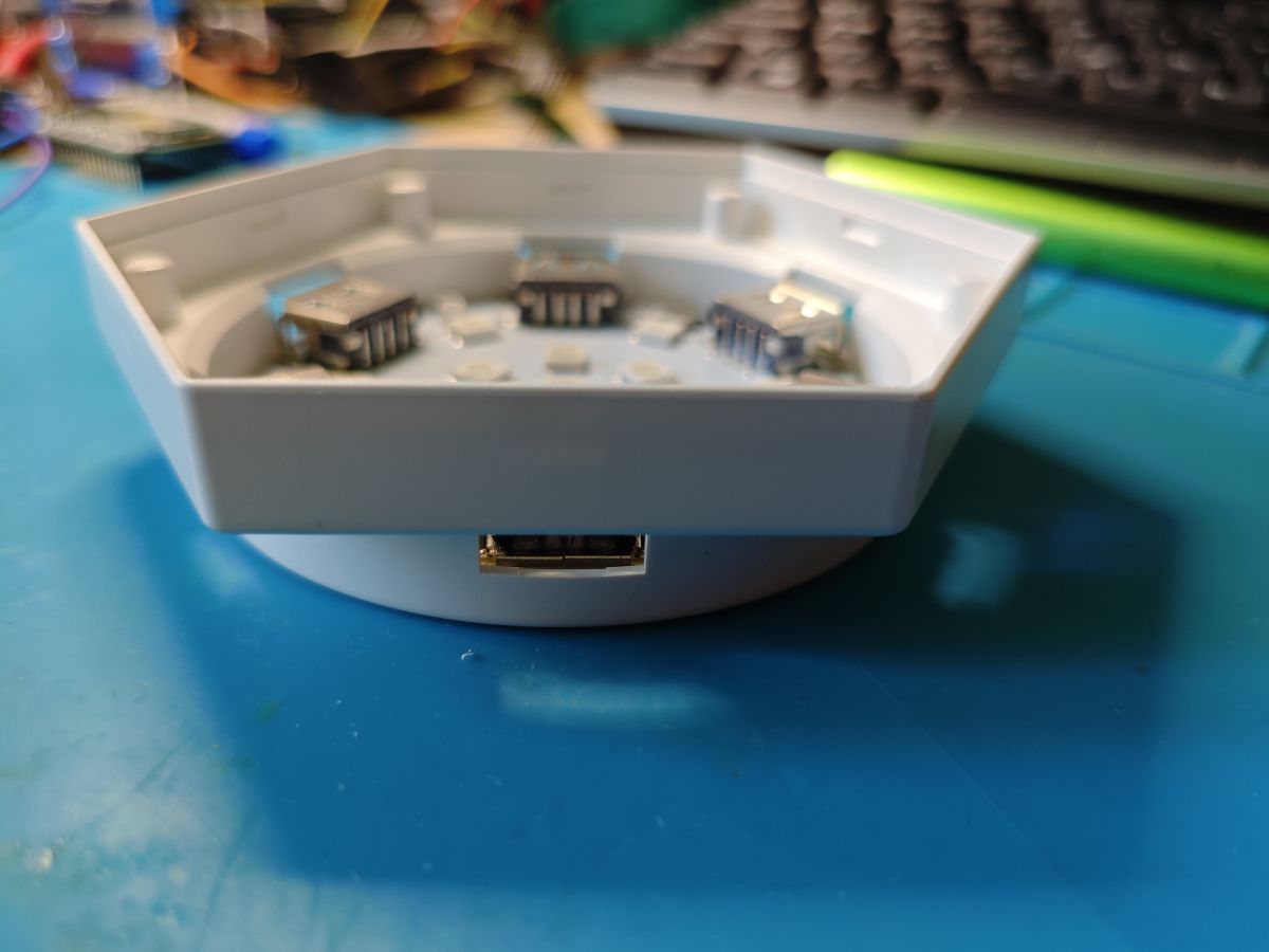

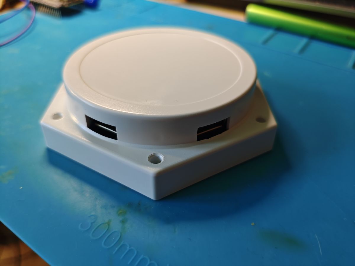

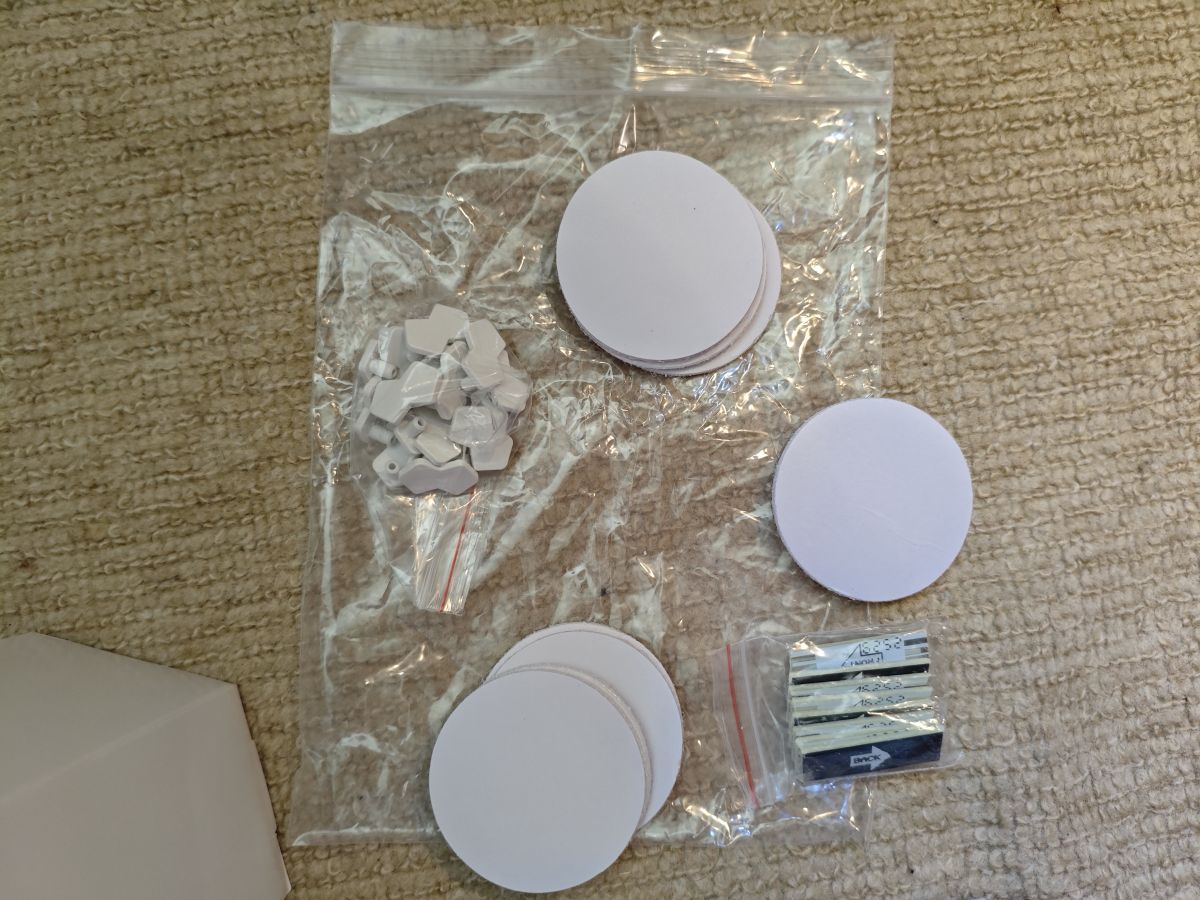

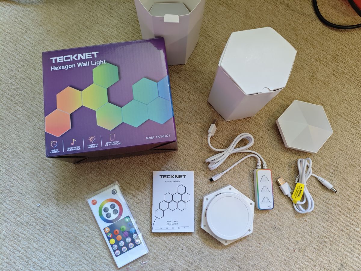

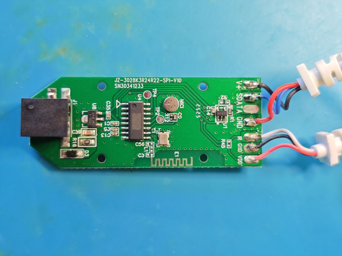

    but the price of not paying enough attention to the description, looking for obvious signs it's not a Tuya wifi device, means getting a bluetooth variation - not what I had wanted.

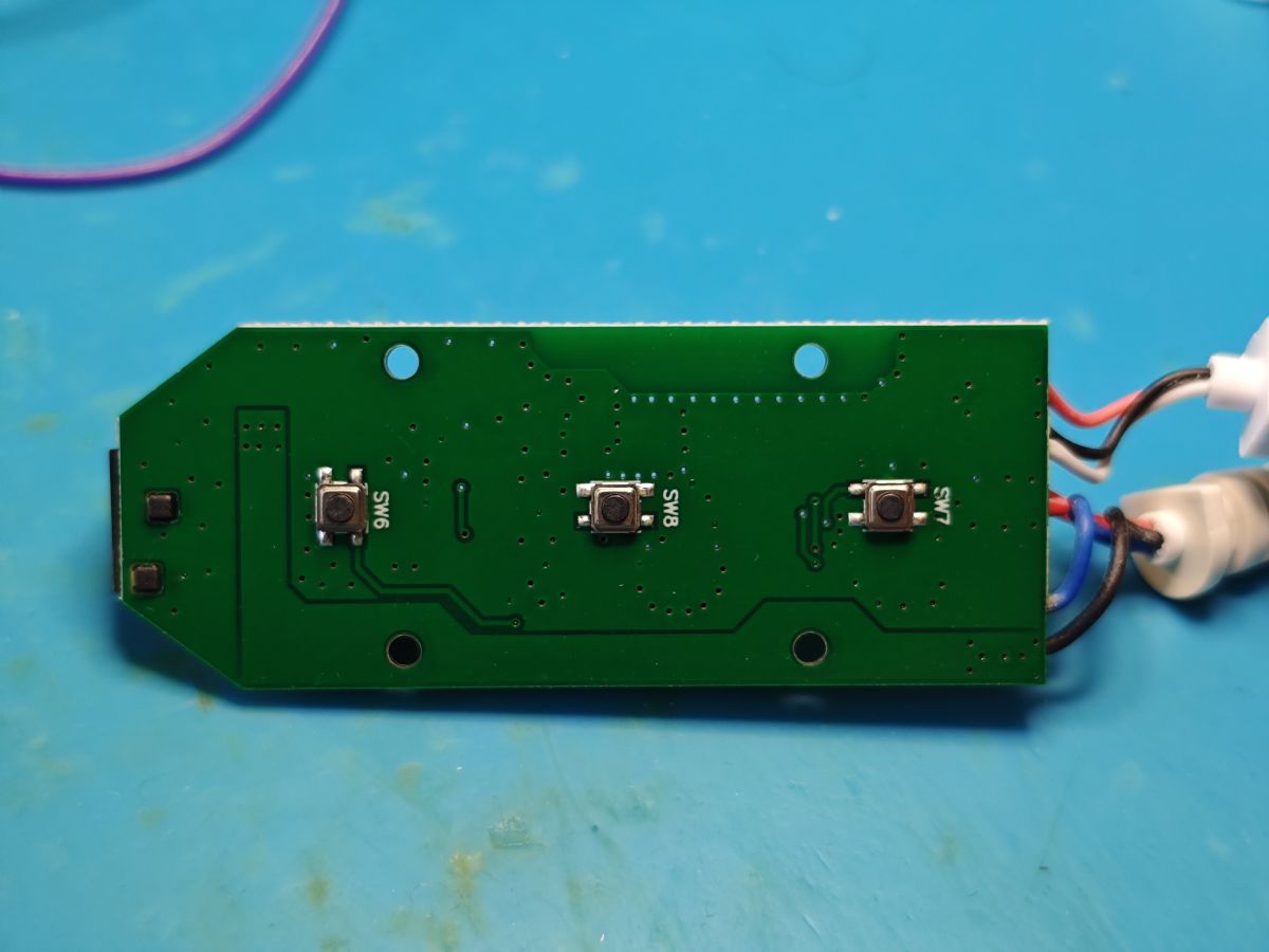

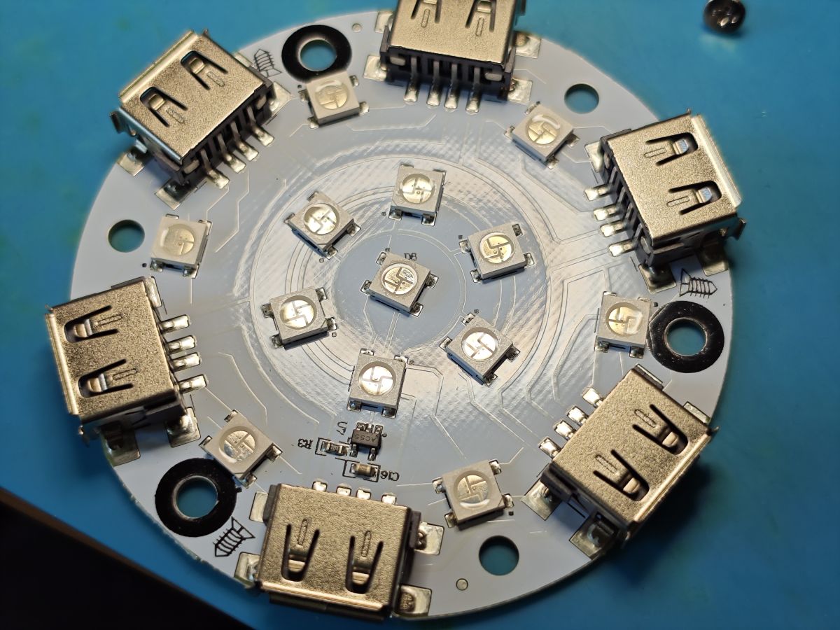

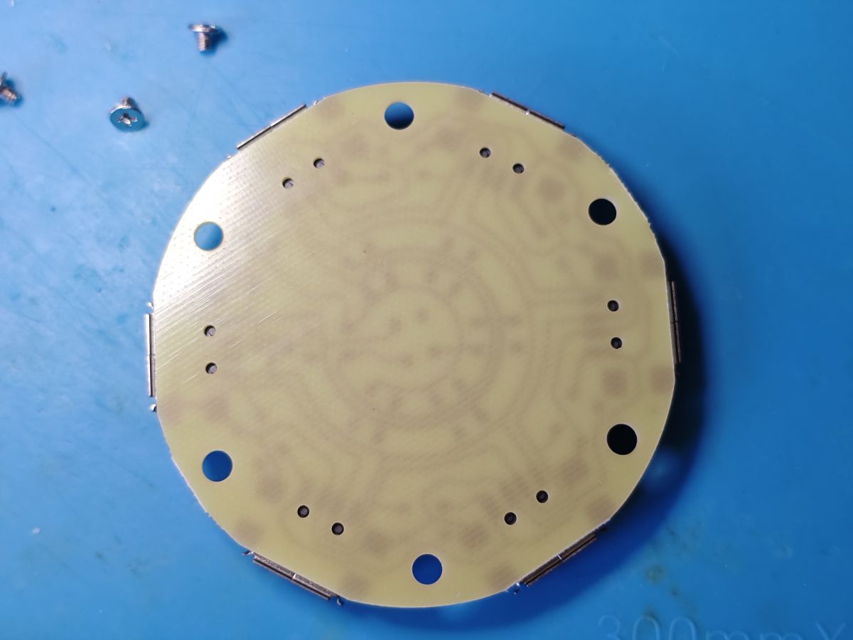

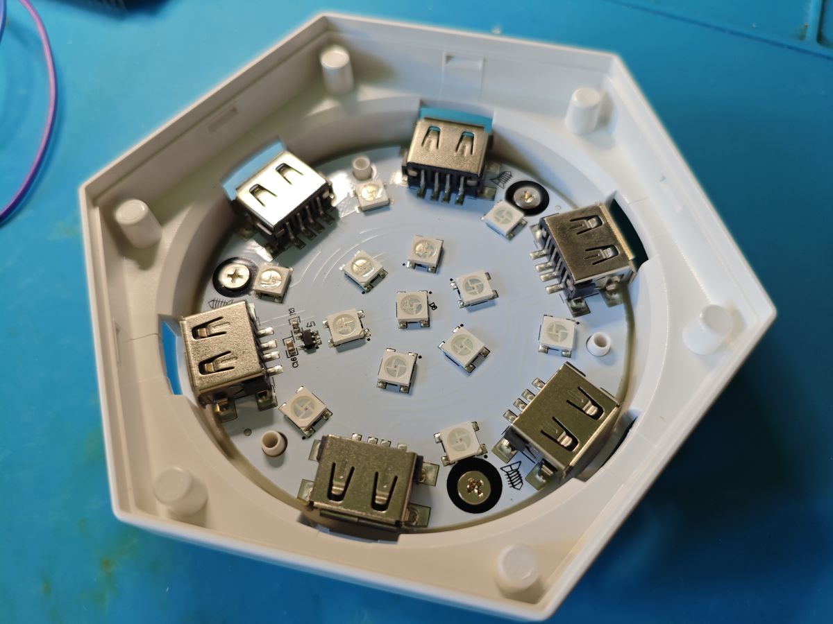

    No matter, it can be documented a little before being returned. Here are some photos that may be of interest.
    Tecknet TK-WL001 hexagon lights: unknown Bluetooth chip - internal/external device pics Tecknet TK-WL001 hexagon lights: unknown Bluetooth chip - internal/external device pics Tecknet TK-WL001 hexagon lights: unknown Bluetooth chip - internal/external device pics Tecknet TK-WL001 hexagon lights: unknown Bluetooth chip - internal/external device pics Tecknet TK-WL001 hexagon lights: unknown Bluetooth chip - internal/external device pics Tecknet TK-WL001 hexagon lights: unknown Bluetooth chip - internal/external device pics Tecknet TK-WL001 hexagon lights: unknown Bluetooth chip - internal/external device pics Tecknet TK-WL001 hexagon lights: unknown Bluetooth chip - internal/external device pics
    Tecknet TK-WL001 hexagon lights: unknown Bluetooth chip - internal/external device pics Tecknet TK-WL001 hexagon lights: unknown Bluetooth chip - internal/external device pics Tecknet TK-WL001 hexagon lights: unknown Bluetooth chip - internal/external device pics Tecknet TK-WL001 hexagon lights: unknown Bluetooth chip - internal/external device pics Tecknet TK-WL001 hexagon lights: unknown Bluetooth chip - internal/external device pics Tecknet TK-WL001 hexagon lights: unknown Bluetooth chip - internal/external device pics Tecknet TK-WL001 hexagon lights: unknown Bluetooth chip - internal/external device pics Tecknet TK-WL001 hexagon lights: unknown Bluetooth chip - internal/external device pics Tecknet TK-WL001 hexagon lights: unknown Bluetooth chip - internal/external device pics

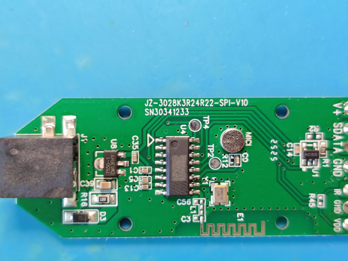

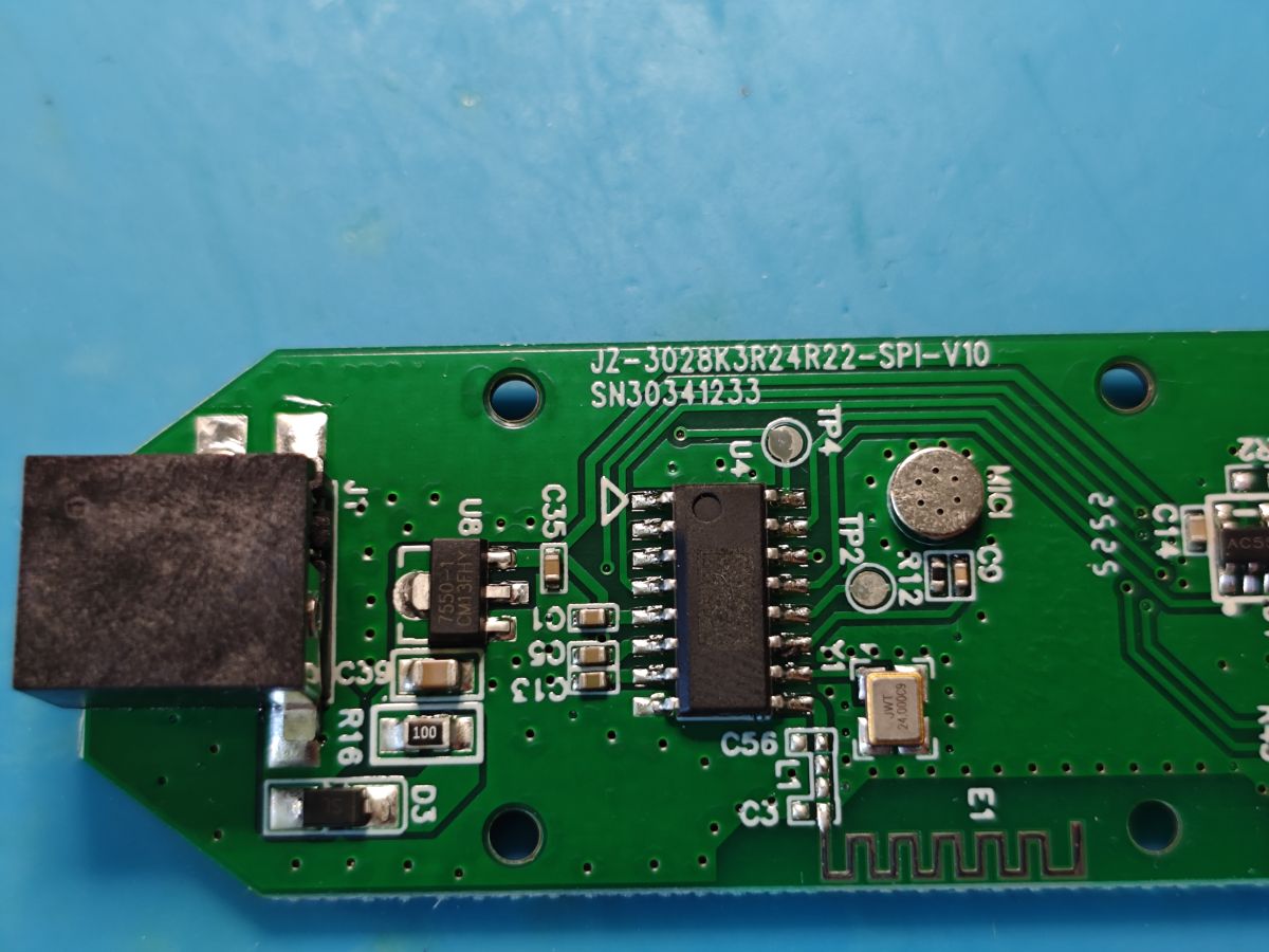

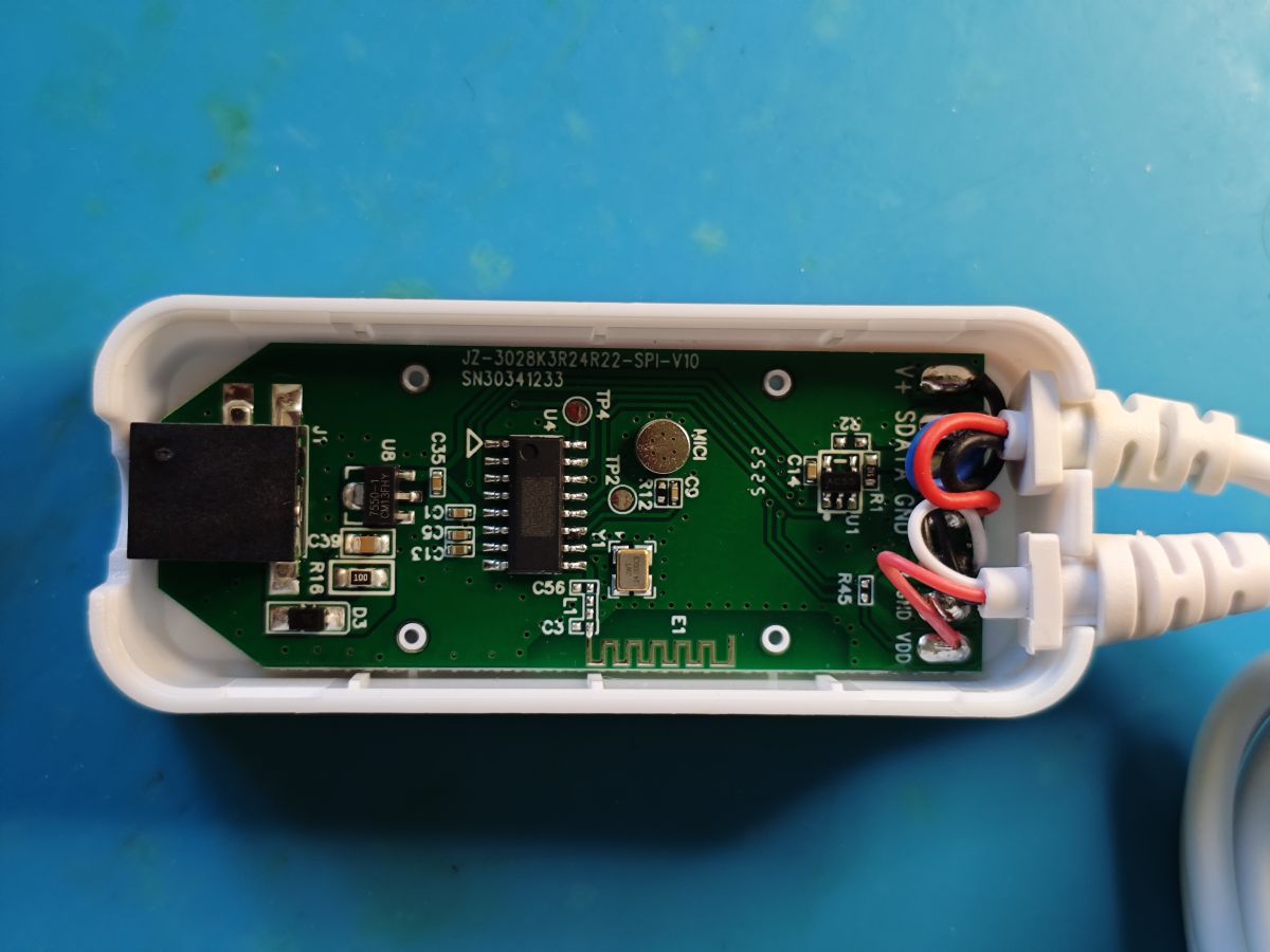

    Interesting the bluetooth chip's identity has been lasered off - I wonder why.
    PCB marking
    JZ-3028K3R24R22-SPI-V10
    SN30341233
    Maybe it's a Yichip SOP16 MCU and the IO31/ICE pin has a boot log out like the YC1166 here. No, no debug log from any pin.

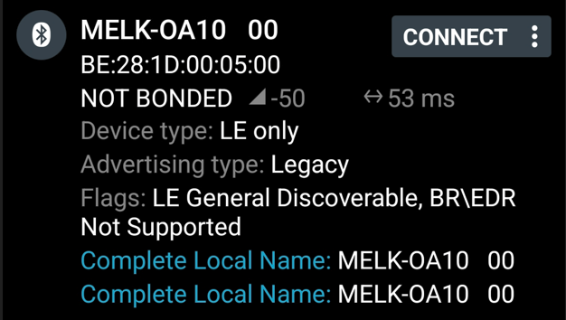

    nRF Connect shows this is broadcast:
    Googling for
    MELK-0A10
    brings up these interesting results:
    https://www.reddit.com/r/LedLightStrips/comme...dnt_like_the_suggested_app_for_my_led_strips/
    ELK-BLEDOM Integration for Home Assistant
    ELK/MELK protocol BLE LED devices are detected as supported by the LED BLE integration, but setup fails

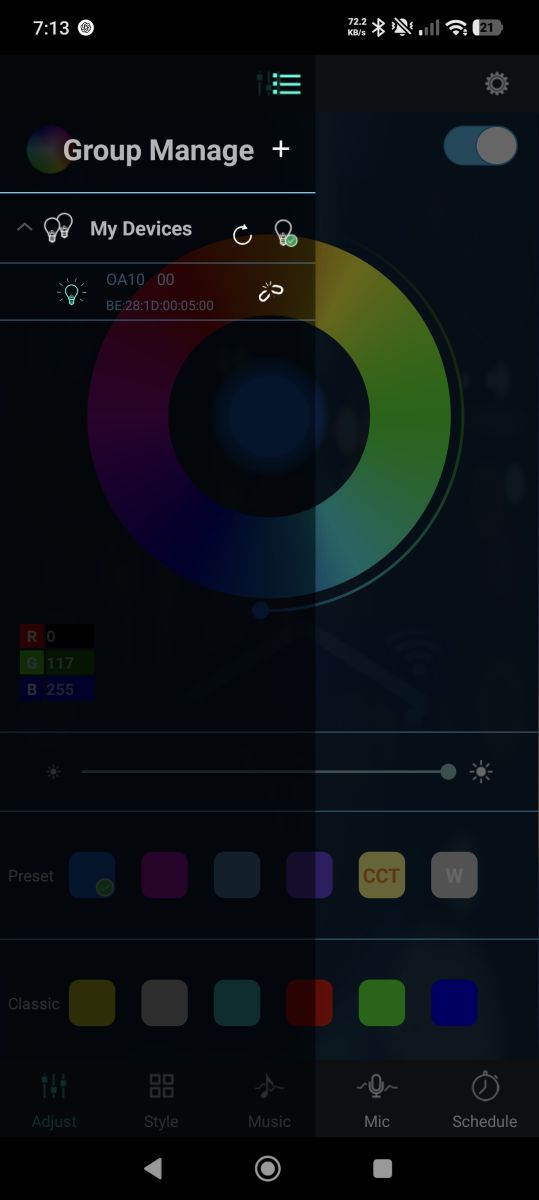

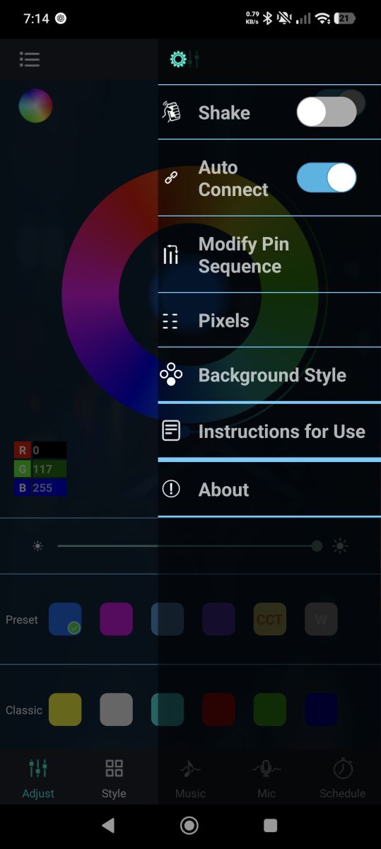

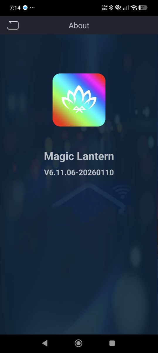

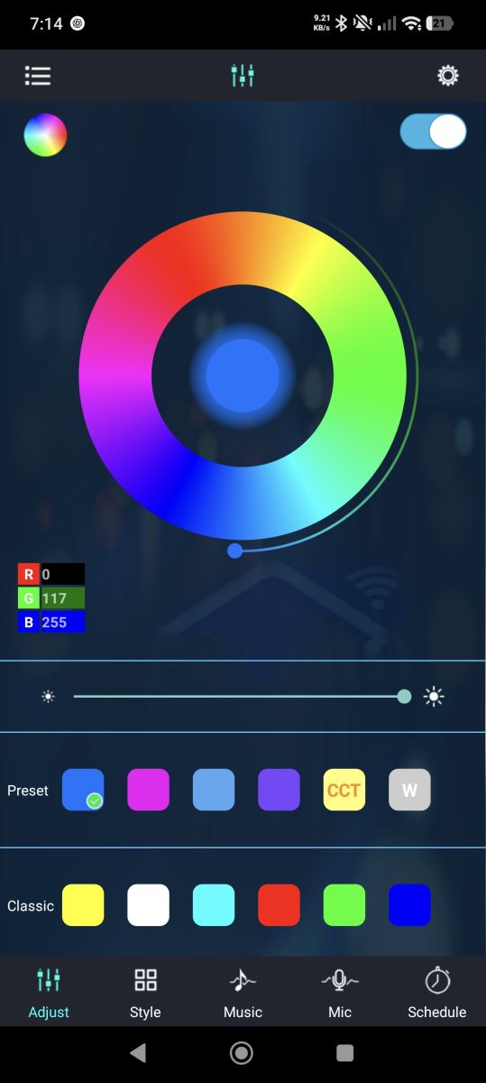

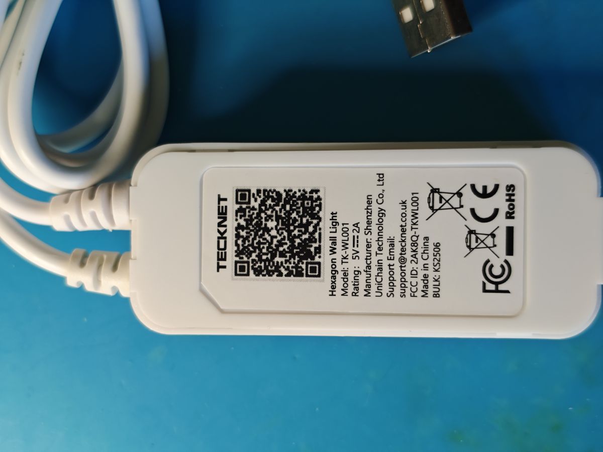

    The QR code on the controller sticker takes you to http://www.easytrack.net.cn/download_Mgc/165JINGZEKONGGU which redirects to https://elkapk.adgo.top/AppDownload/download_ad.html?platform=magic_lantern for links to the Magic Lantern app
    No area to show firmware version

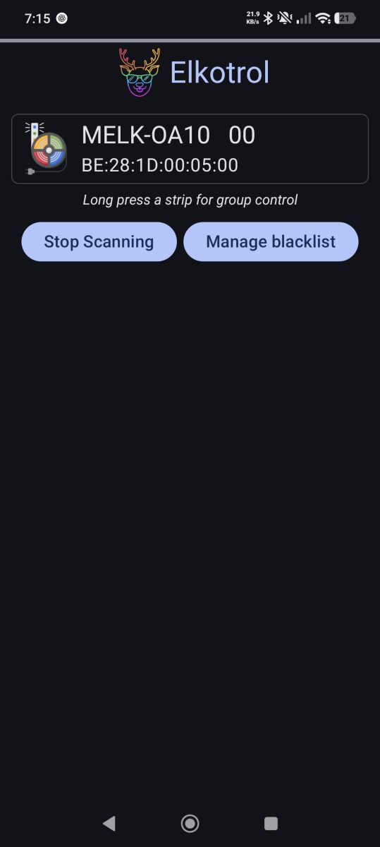

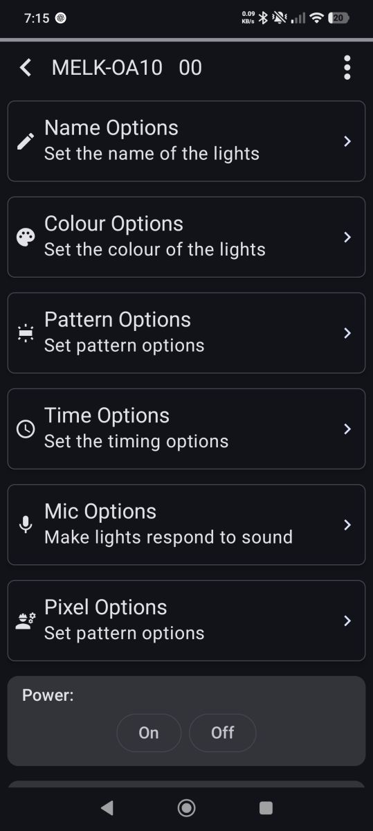

    Elkotrol app also picks it up, but no firmware info either
    https://play.google.com/store/apps/details?id=com.leet.elkotrol
    Screenshot of Elkotrol app showing device MELK-0A10 and buttons for scanning and blacklist App screen for light control showing name, colour, pattern, time, mic, and pixel options plus a power on/off toggle.
