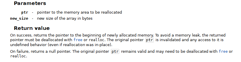

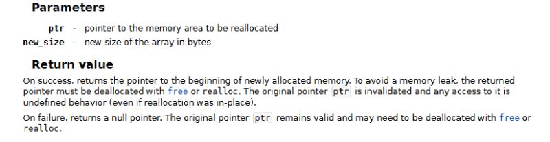

    Screenshot of realloc documentation with “Parameters” and “Return value” sections
    In the low heap scenario, realloc fails to reallocate the memory, so it returns NULL, but original pointer is not invalidated. So, by overwriting request.received with returned NULL, we orphan the original (still correct) buffer.

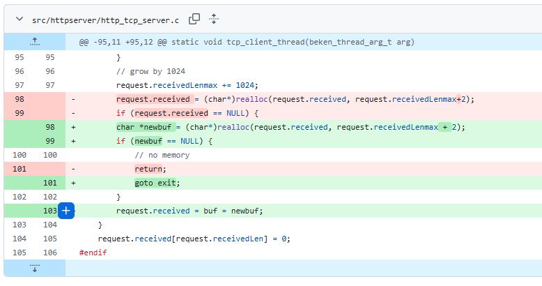

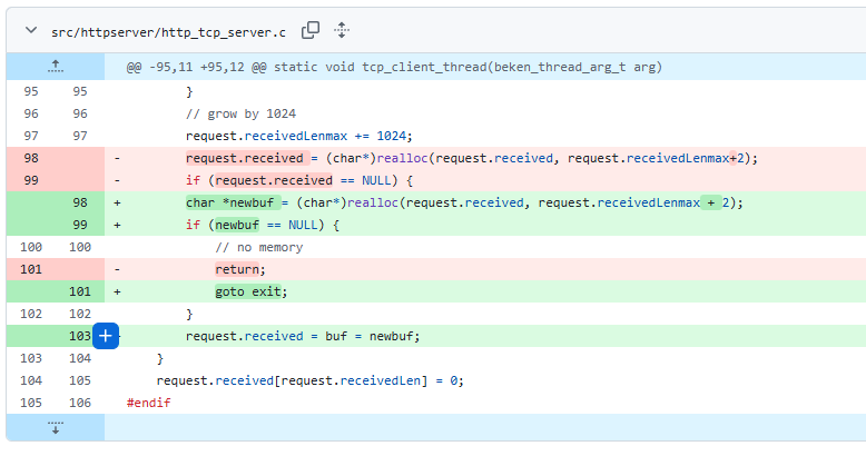

    Just extra question - why return has changed to goto exit?
    Screenshot of a C code diff: realloc result stored in newbuf and NULL handled with goto exit
    so the path still hits the function's unified cleanup block. The return would skip those and leak the already-allocated buffers and socket resources.
    is the answer i'm being given ;)

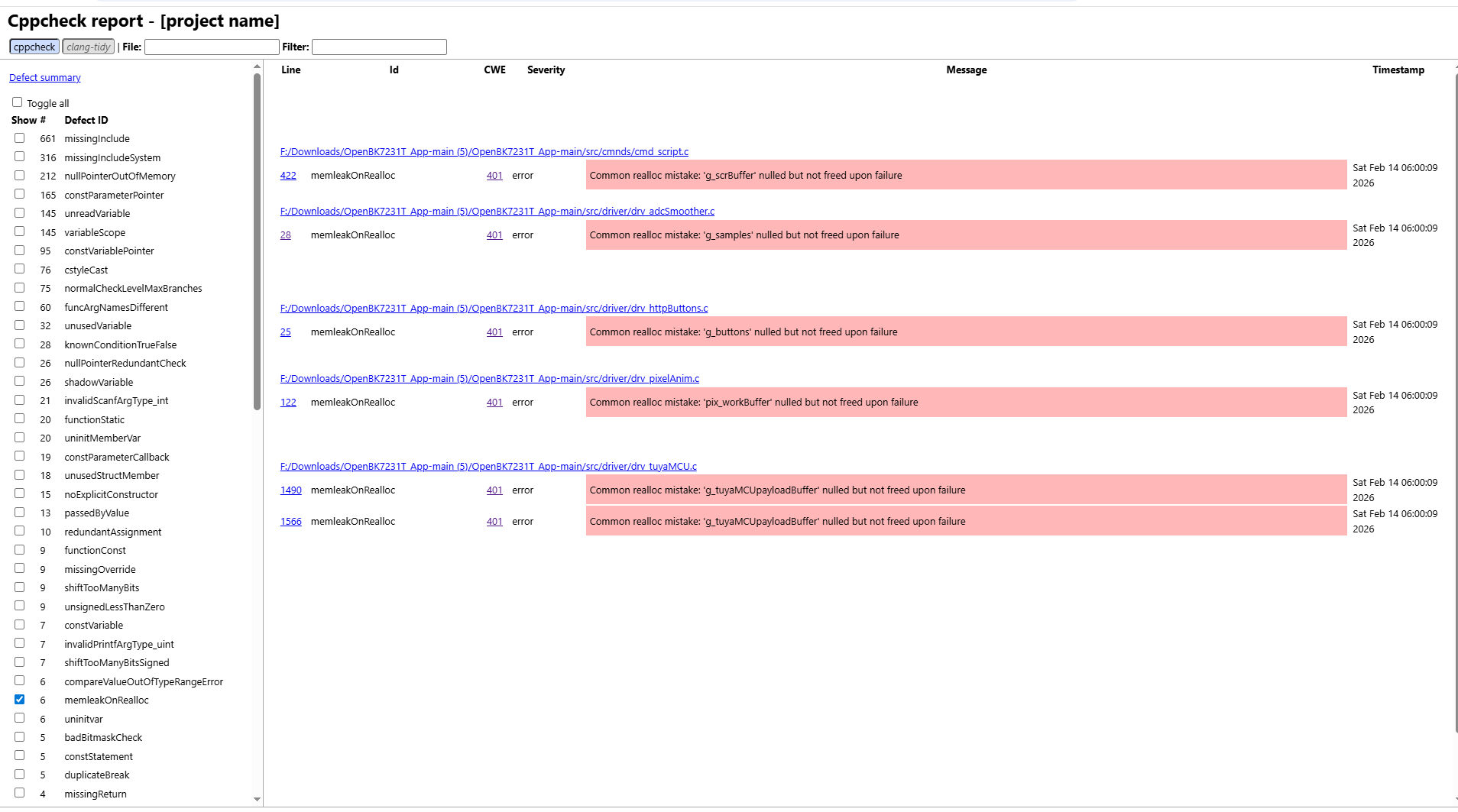

    for sure. I double, triple, quadruple etc check with LLM (new chats, different contexts, different questions etc) and, if necessary, confirm with other tools too. eg:
    Screenshot of a Cppcheck report listing memleakOnRealloc errors across multiple C source files.
    Added after 5 [minutes]:

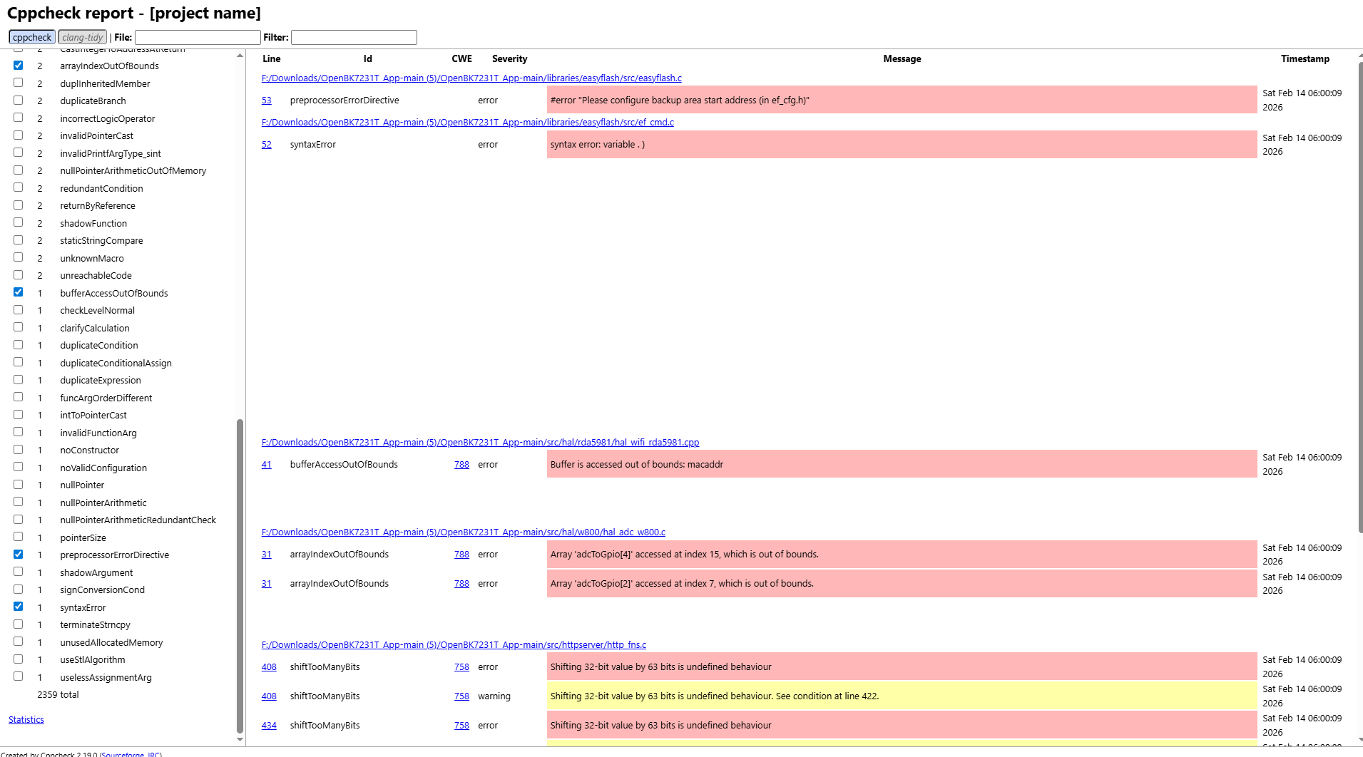

    it's fascinating seeing what these tools have to say about the code. opens up another world of things to look into, wondering if these *are* real issues requiring attention, what does and doesn't matter...
    Screenshot of a Cppcheck report listing static analysis errors in C and C++ files
    Added after 10 [minutes]:
    this is that report if curious
    • cppcheck-report.zip (3.25 MB) You must be logged in to download this attachment.
