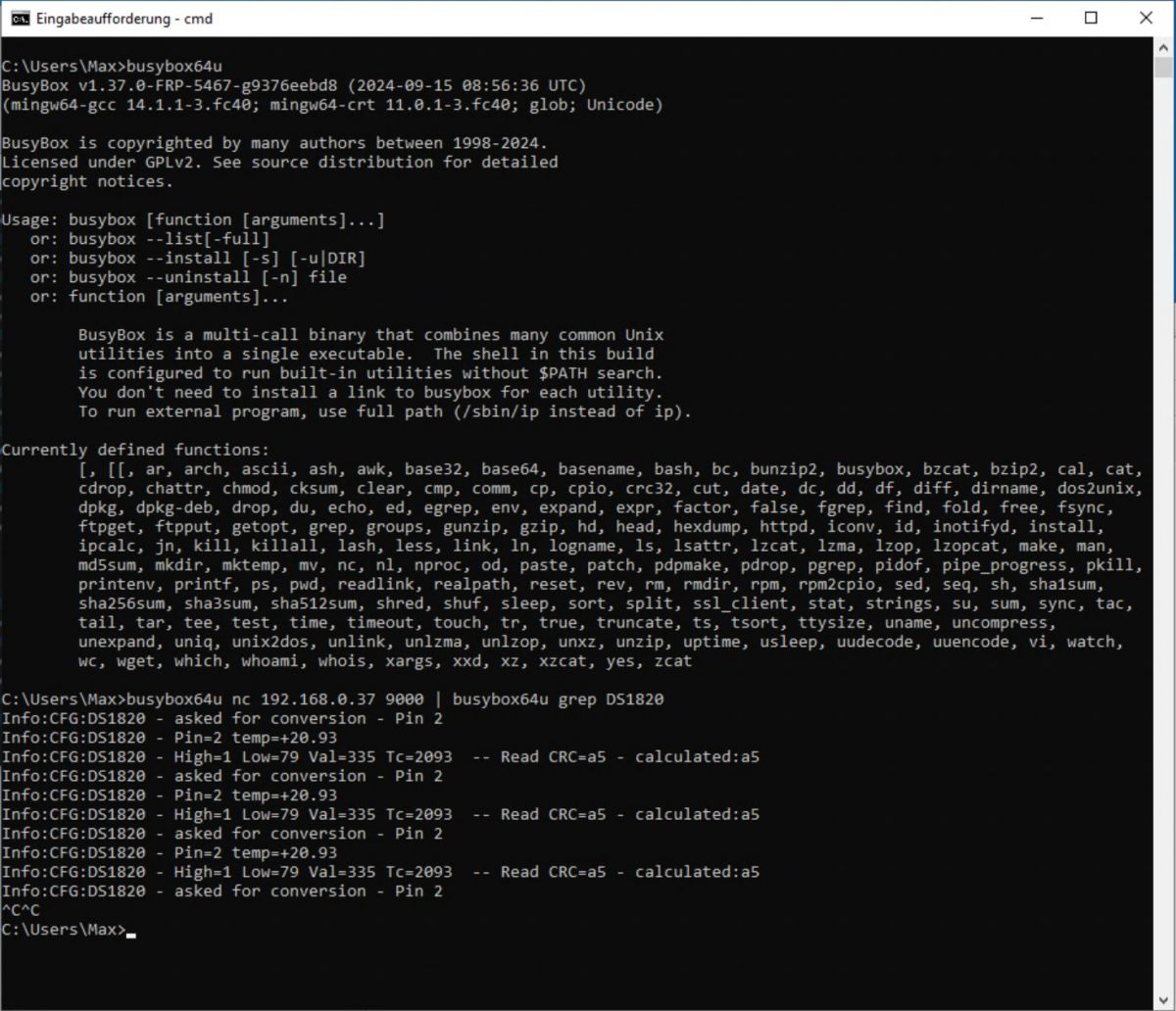

  • Sometimes I like a short look in the logs of an OpenBeken device without starting the web app and open the "logs" menu.
    Or I like to save or filter the logs over a longer period.
    This can be easily achieved by the connecting to port 9000 of the device.
    I learned about this feature from a comment from @miegapele on git and would like to share it here.
    On linux you would probably use nc/netcat. So, e.g. when working on the Driver for DS1820, I used:
    max@max-PC:~$ nc 192.168.0.37 9000 | grep DS1820
    Info:CFG:DS1820 - asked for conversion - Pin 2
    Info:CFG:DS1820 - Pin=2 temp=+19.37
    Info:CFG:DS1820 - High=1 Low=54 Val=310 Tc=1937  -- Read CRC=79 - calculated:79
    On Windows (if you didn't install WSL) my preferred "swiss army knife" for tasks like this is a windows port of "busybox" (I get the binary from here).
    So you can just start a "shell" there with "busybox sh" and simply use the same command as above :-).
    Screenshot of a Windows console showing the use of busybox to analyze device logs.
    And if there are times, when you miss md5sum, awk or sed - it's also there in this useful little binary.
    The access to the network log is not a full replacement for the log on the hardware UART. But I really like it, especially when "waiting" for entries in the log.

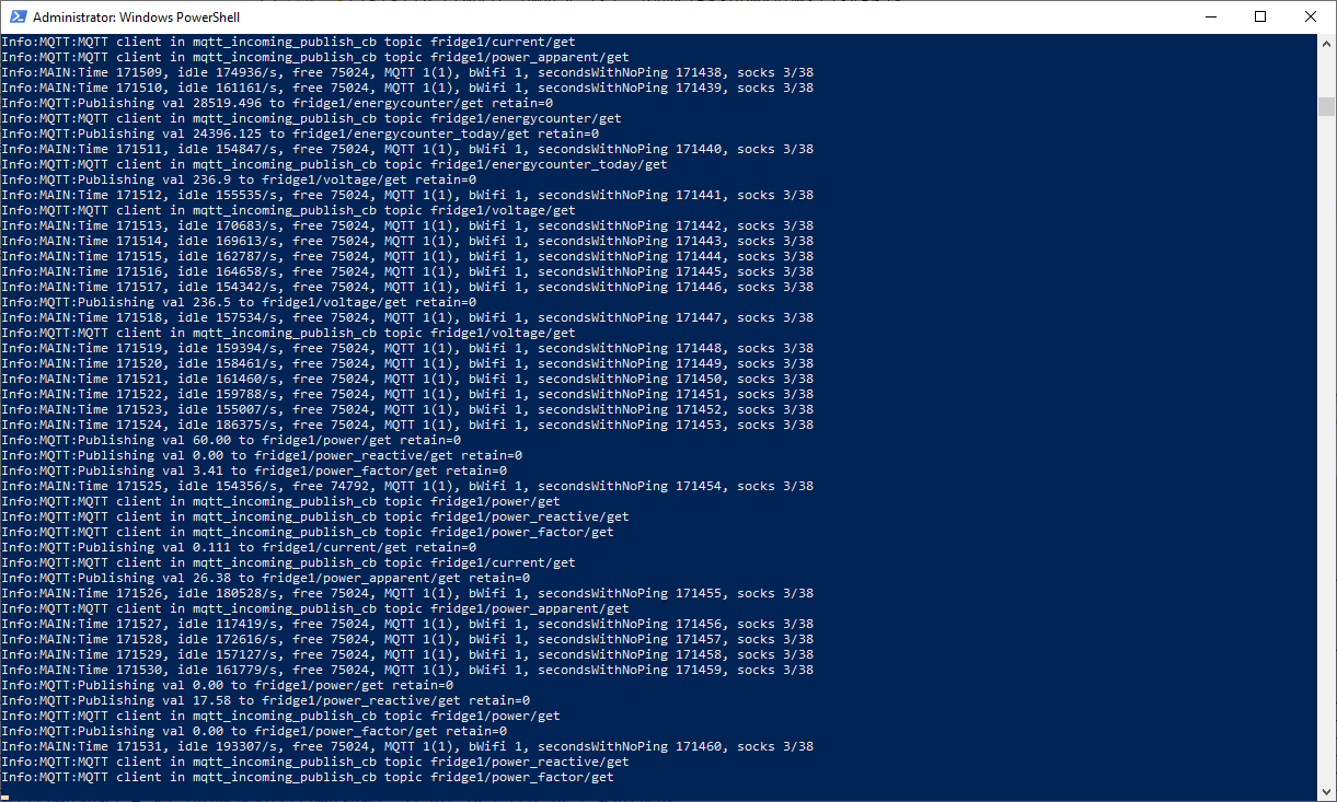

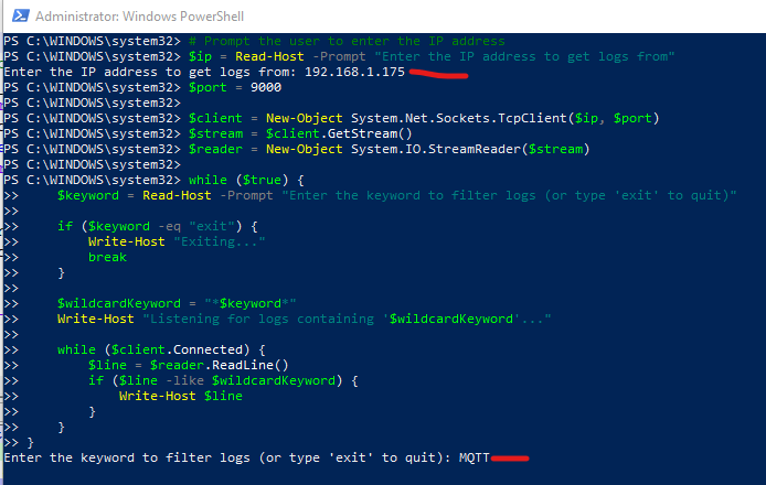

  • PowerShell script for filtering OBK logs
    #3 21246726
    Posts: 5195
    Help: 446
    Rate: 913
    Cool! You could also do it with PowerShell
    Code: Powershell
    Screenshot showing a PowerShell script for retrieving and filtering logs from a specified IP address and port. Screenshot of a Windows PowerShell window displaying MQTT logs.

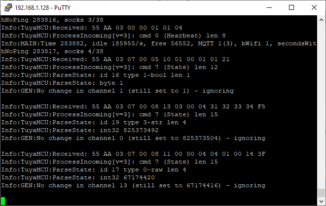

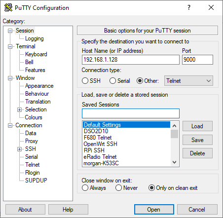

  • #5 21307105
    morgan_flint
    Posts: 251
    Rate: 63
    I've just tried this with PuTTy and works like a charm:
    Screenshot of PuTTY configuration with IP address and telnet port. Screenshot of a PuTTY session displaying TuyaMCU log data.
