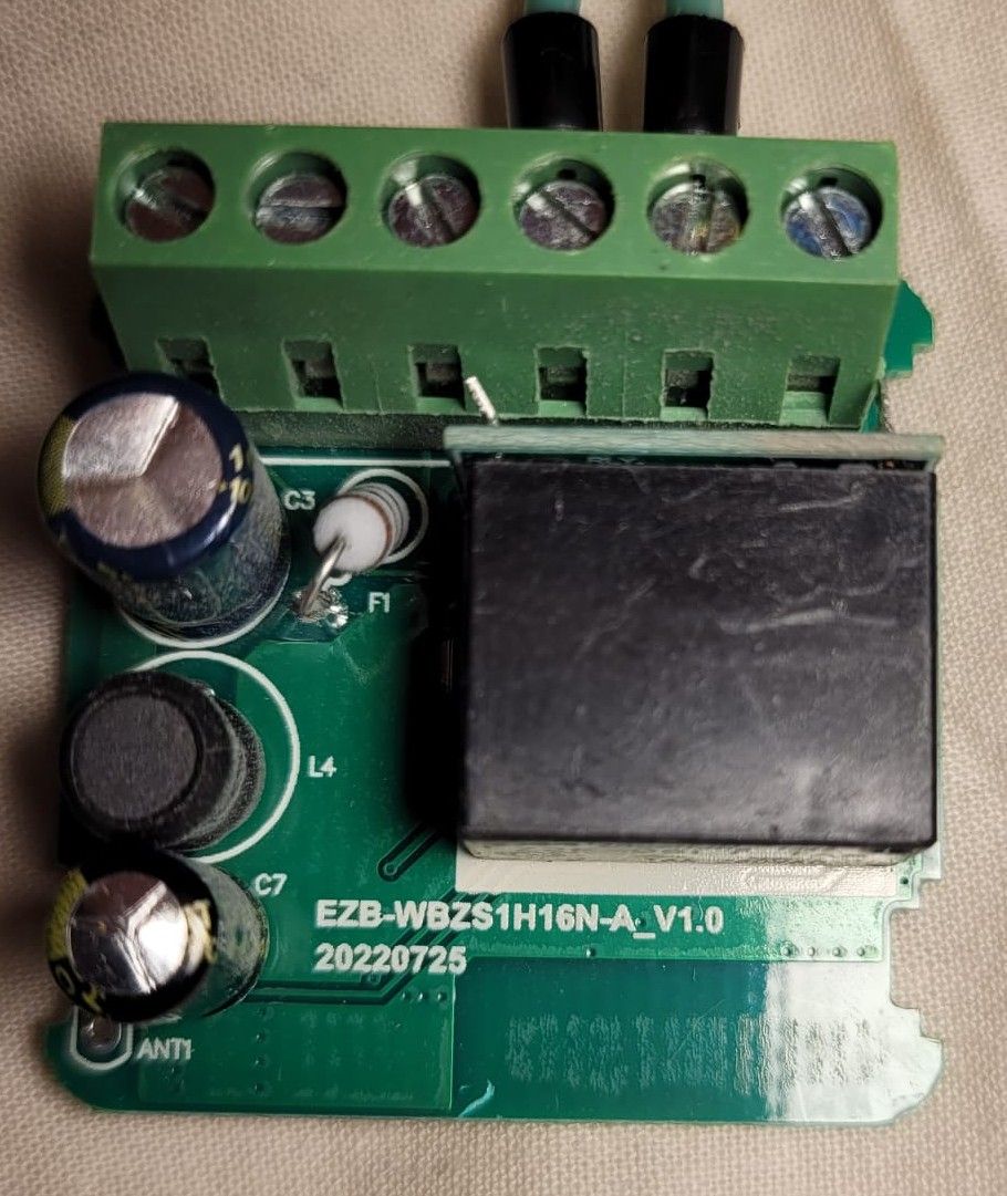

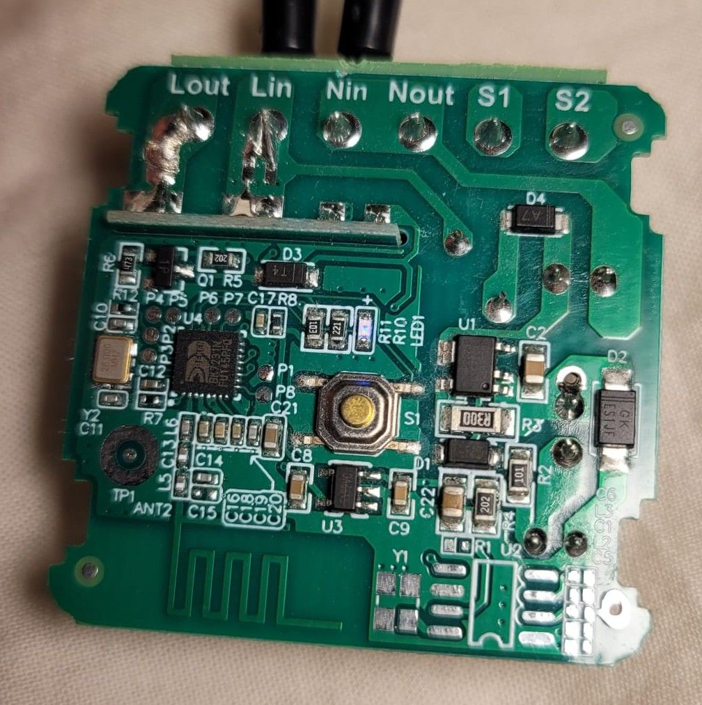

    [BK7231N] Aubess Mini Smart Switch 16A (EZB-WBZS1H16N-A V1.0) not working and LED1 blinks with irregular pattern (off, dim, off, dim several times, then off, bright, then again off, dim several times).
    Voltage on C8 is stable 3.3 V, voltage on C9 fluctuates around 4.5 V. I'm a noob, sorry if dumb questions will occur. What to check next?

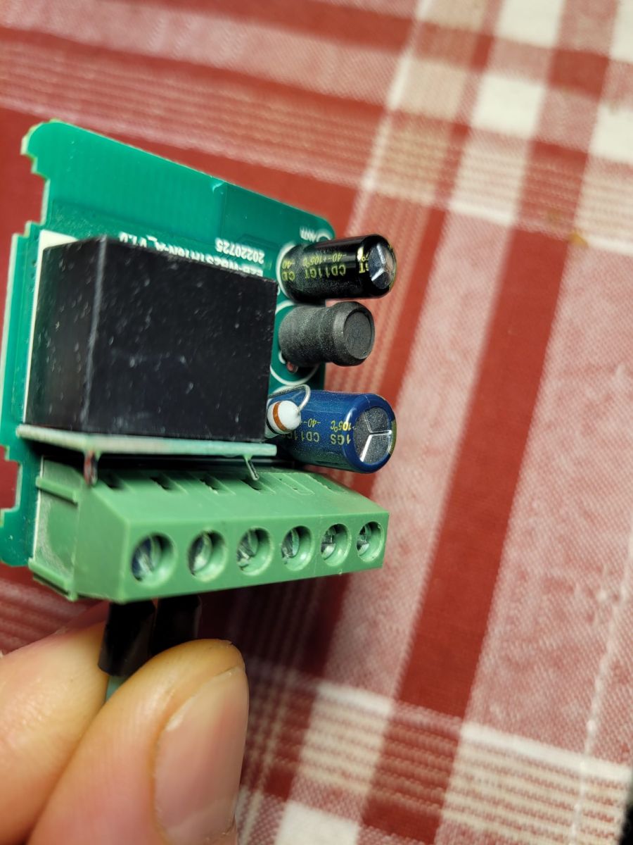

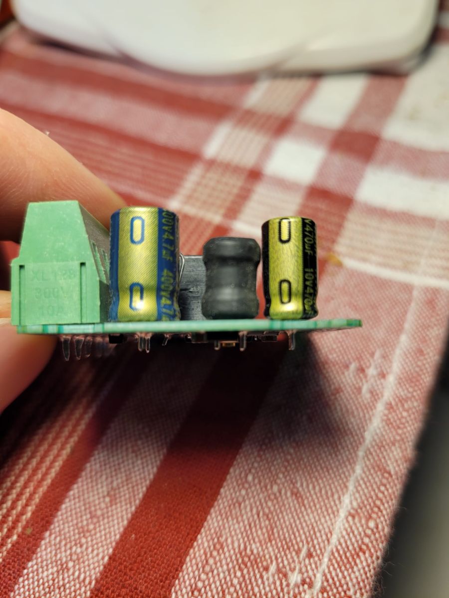

    Can you make a photo of capacitors from side? Probably faulty capacitor.

    As @p.kaczmarek2 said: The black capacitor on the lower left corner in the first picture: is the upside bulged (not flat)? The picture is not totally clear. Then you will probably need to replace it.

    Yes, it seems to be a little bulged. Will test and replace, if necessary, thanks.

    I replaced C7 - it was faulty. When I plugged in the device, LED1 was blinking fast, it connected to Wi-Fi, got IP address from DHCP server, but there was no ping. When I power-cycle the device now, it doesn't connect any more and LED1 doesn't blink. Voltage on C8 is stable 3.3 V, voltage on C9 is stable 4.78 V. If I press S1, LED1 changes its state as does the relay, so the device seems to be alive, just Wi-Fi doesn't work. It was running ESPHome before it broke.
