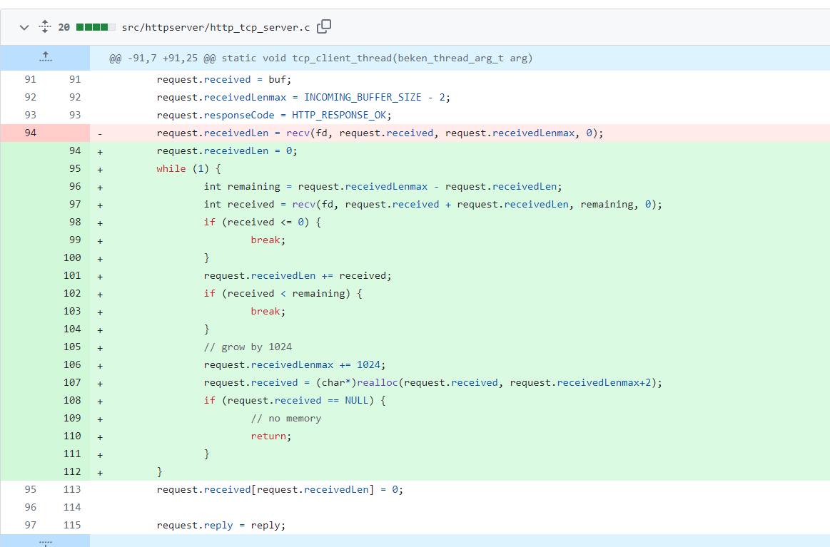

    I have changed some buffer handlings to support longer commands sent to OBK via HTTP and commands executed via alias in autoexec.bat.
    HTTP patch:
    Screenshot of a code editor showing changes in http_tcp_server.c, highlighting modifications in buffer handling and data length management.

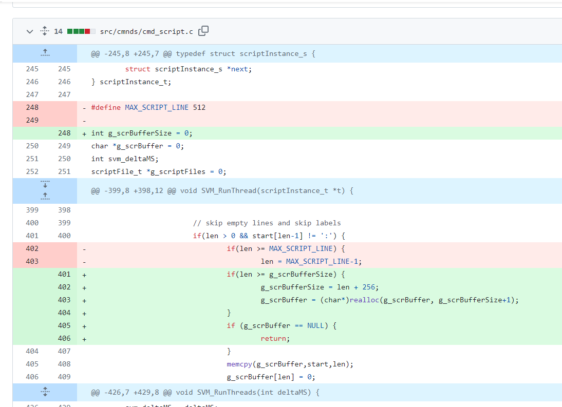

    Autoexec.bat parser patch:
    Screenshot showing changes in the source code of the cmd_script.c file in the OpenBK7231T_App project.
    I am, however, not sure if everything is indeed working correctly on other platforms.

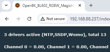

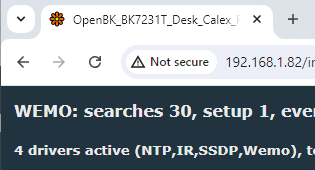

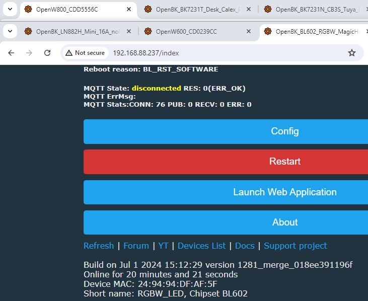

    well the good news is they all flash. OTA for all but W800 which was UART
    User interface with MQTT status information and configuration options.
    Added after 33 [seconds]:
    I am navigating around menus on all as normal so far
    Added after 35 [seconds]:
    my XR809 isn't ready to play yet
    Added after 20 [minutes]:

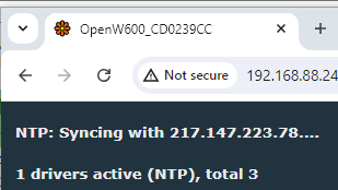

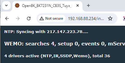

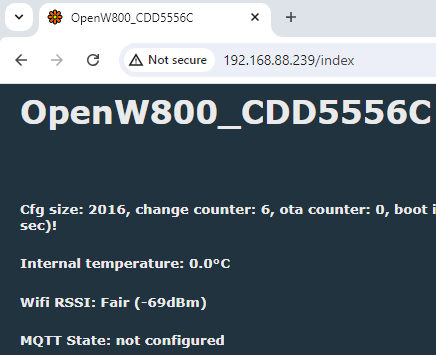

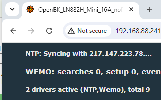

    startup command list of basic "backlog powersave 1;startdriver ntp; startdriver ir; startdriver wemo; startdriver ssdp" in all. Of course some platforms don't have all drivers.
    Screenshot of a webpage with a browser tab at the top and a fragment of text below. Browser window with OpenBK control panel showing NTP synchronization and active WEMO drivers. Screenshot of a browser interface showing OpenBK for BL602 with information on active drivers and channels. Screenshot of OpenW600 web interface showing NTP synchronization and number of active drivers. Web interface of OpenW800 displaying system information. Screenshot of the OpenBK software interface for the BK7231N device.
    Added after 3 [minutes]:
    results are identical clearing the startup command box and using autoexec.bat on LN, BL602, BK-N and BK-T

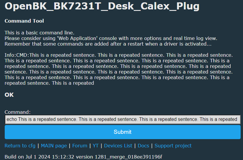

    something like this 500 character entry?
    Screenshot of the OpenBK command tool interface displaying repeated sentences.

    I've tried to support even 1500 or 4000 characters. The best way to test it is to use:

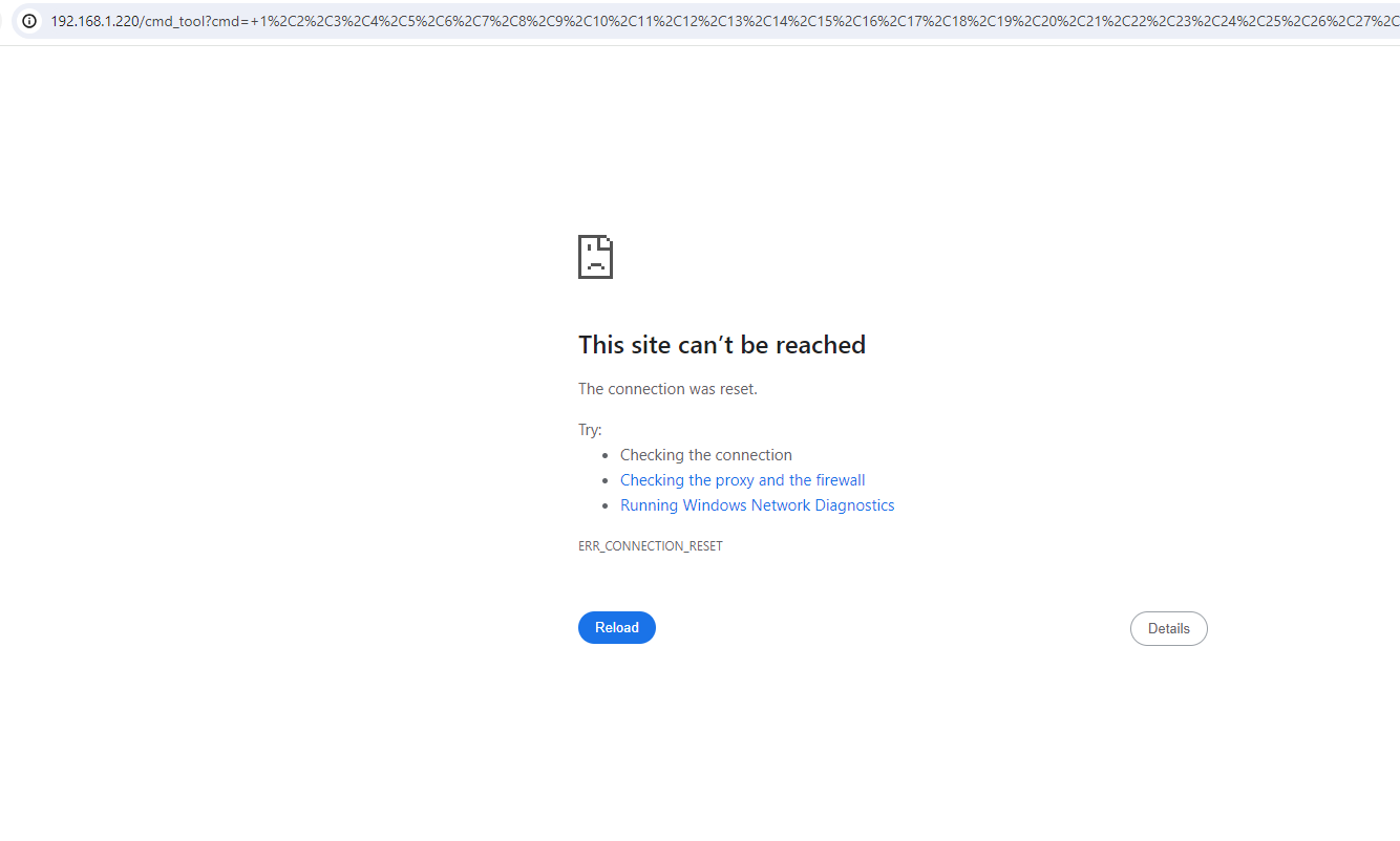

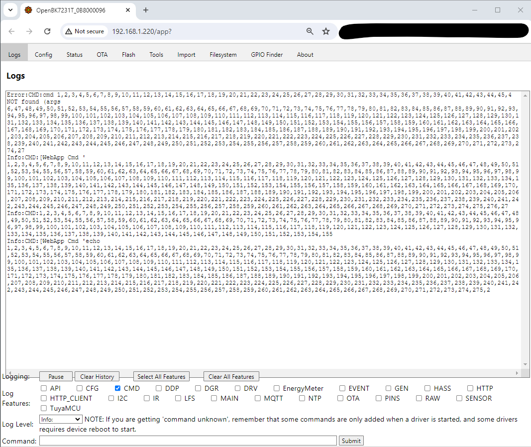

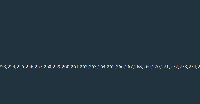

    BK-T first. Echo or not the submission limit seems to be ~1000 characters. or that's at least the limit of the return to log
    Screenshot of a webpage displaying logs from an OpenBKT device.
    if you use custom command page the device will bomb out and show:
    Browser error message indicating the site is unreachable.
    it also freezes requiring reboot.

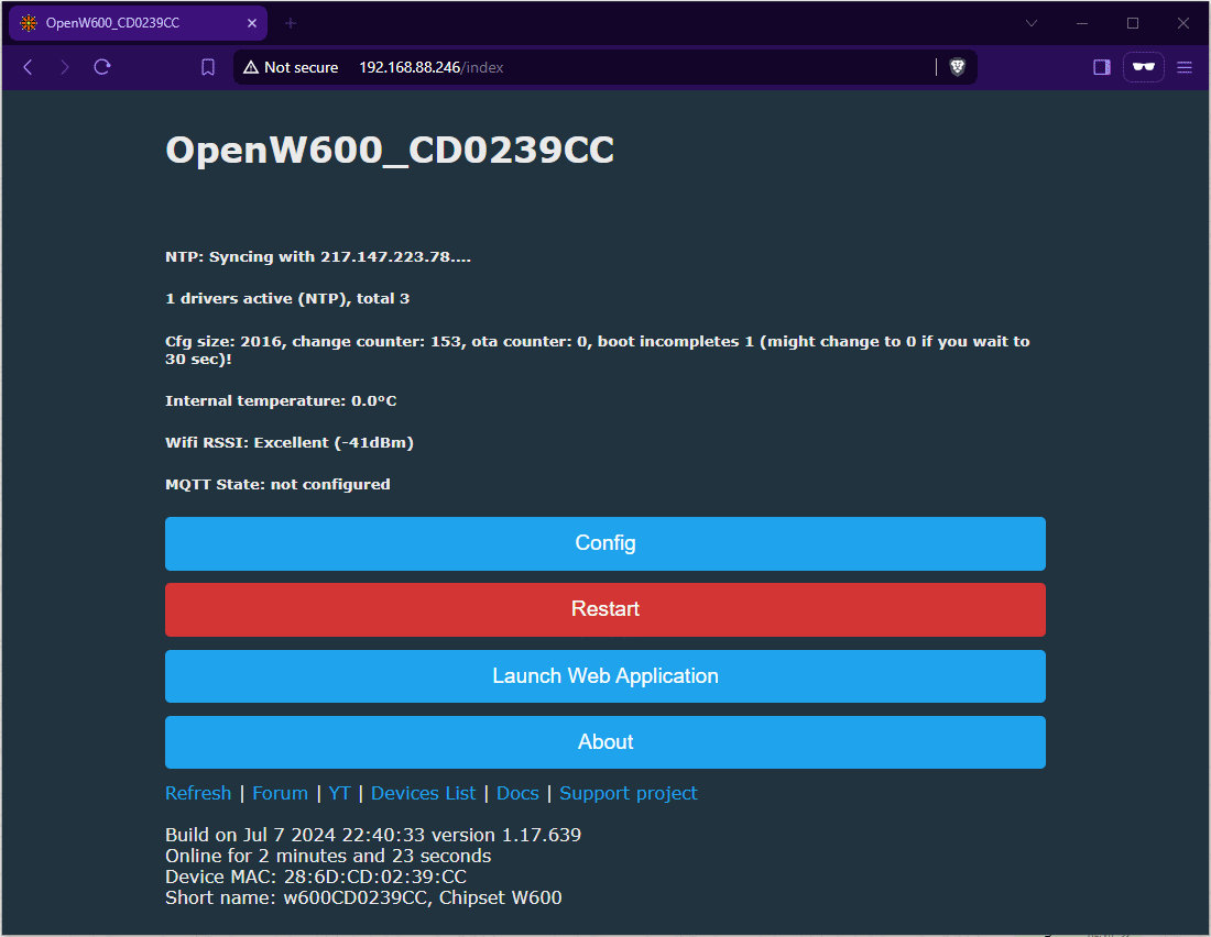

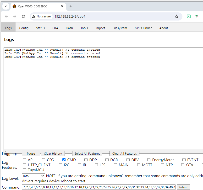

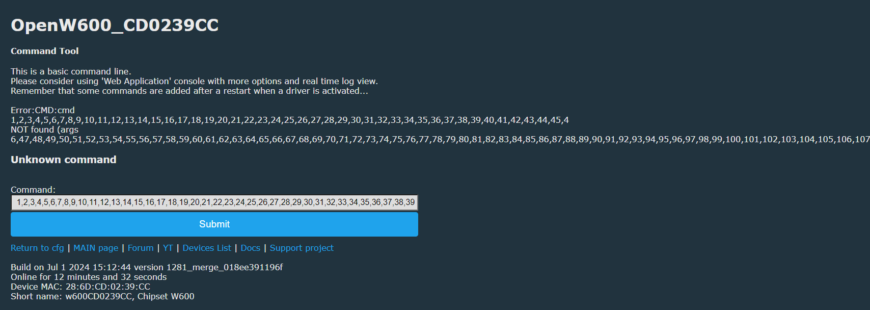

    W600 bombs but recovers but still only shows up to ~#274
    Screenshot of OpenW600_CD0239CC command tool showing command errors. Console screen with looping numbers from 253 to 274.
    and web app command doesn't return anything but 'no command entered' for w600
    Screenshot of the OpenW600 web interface with the logs tab open.

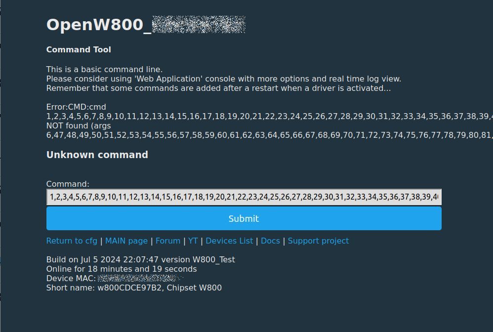

  • W800 handles long HTTP commands without crashing
    #7 21145386
    max4elektroda
    Posts: 758
    Help: 49
    Rate: 189
    Sorry, that I'm quite busy ATM.
    I tried on W800 and get a similar response, but user command GUI is working w/o crash:
    Screenshot of the OpenW800 tool interface with an unknown command error.
    Since the image is quite "small", here is the text
    Request:
    http://192.168.0.37/cmd_tool?cmd=1%2C2%2C3%2C4%2C5%2C6%2C7%2C8%2C9%2C10%2C11%2C12%2C13%2C14%2C15%2C16%2C17%2C18%2C19%2C20%2C21%2C22%2C23%2C24%2C25%2C26%2C27%2C28%2C29%2C30%2C31%2C32%2C33%2C34%2C35%2C36%2C37%2C38%2C39%2C40%2C41%2C42%2C43%2C44%2C45%2C46%2C47%2C48%2C49%2C50%2C51%2C52%2C53%2C54%2C55%2C56%2C57%2C58%2C59%2C60%2C61%2C62%2C63%2C64%2C65%2C66%2C67%2C68%2C69%2C70%2C71%2C72%2C73%2C74%2C75%2C76%2C77%2C78%2C79%2C80%2C81%2C82%2C83%2C84%2C85%2C86%2C87%2C88%2C89%2C90%2C91%2C92%2C93%2C94%2C95%2C96%2C97%2C98%2C99%2C100%2C101%2C102%2C103%2C104%2C105%2C106%2C107%2C108%2C109%2C110%2C111%2C112%2C113%2C114%2C115%2C116%2C117%2C118%2C119%2C120%2C121%2C122%2C123%2C124%2C125%2C126%2C127%2C128%2C129%2C130%2C131%2C132%2C133%2C134%2C135%2C136%2C137%2C138%2C139%2C140%2C141%2C142%2C143%2C144%2C145%2C146%2C147%2C148%2C149%2C150%2C151%2C152%2C153%2C154%2C155%2C156%2C157%2C158%2C159%2C160%2C161%2C162%2C163%2C164%2C165%2C166%2C167%2C168%2C169%2C170%2C171%2C172%2C173%2C174%2C175%2C176%2C177%2C178%2C179%2C180%2C181%2C182%2C183%2C184%2C185%2C186%2C187%2C188%2C189%2C190%2C191%2C192%2C193%2C194%2C195%2C196%2C197%2C198%2C199%2C200%2C201%2C202%2C203%2C204%2C205%2C206%2C207%2C208%2C209%2C210%2C211%2C212%2C213%2C214%2C215%2C216%2C217%2C218%2C219%2C220%2C221%2C222%2C223%2C224%2C225%2C226%2C227%2C228%2C229%2C230%2C231%2C232%2C233%2C234%2C235%2C236%2C237%2C238%2C239%2C240%2C241%2C242%2C243%2C244%2C245%2C246%2C247%2C248%2C249%2C250%2C251%2C252%2C253%2C254%2C255%2C256%2C257%2C258%2C259%2C260%2C261%2C262%2C263%2C264%2C265%2C266%2C267%2C268%2C269%2C270%2C271%2C272%2C273%2C274%2C275%2C276%2C277%2C278%2C279%2C280%2C281%2C282%2C283%2C284%2C285%2C286%2C287%2C288%2C289%2C290%2C291%2C292%2C293%2C294%2C295%2C296%2C297%2C298%2C299%2C300%2C301%2C302%2C303%2C304%2C305%2C306%2C307%2C308%2C309%2C310%2C311%2C312%2C313%2C314%2C315%2C316%2C317%2C318%2C319%2C320%2C321%2C322%2C323%2C324%2C325%2C326%2C327%2C328%2C329%2C330%2C331%2C332%2C333%2C334%2C335%2C336%2C337%2C338%2C339%2C340%2C341%2C342%2C343%2C344%2C345%2C346%2C347%2C348%2C349%2C350%2C351%2C352%2C353%2C354%2C355%2C356%2C357%2C358%2C359%2C360%2C361%2C362%2C363%2C364%2C365%2C366%2C367%2C368%2C369%2C370%2C371%2C372%2C373%2C374%2C375%2C376%2C377%2C378%2C379%2C380%2C381%2C382%2C383%2C384%2C385%2C386%2C387%2C388%2C389%2C390%2C391%2C392%2C393%2C394%2C395%2C396%2C397%2C398%2C399%2C400%2C401%2C402%2C403%2C404%2C405%2C406%2C407%2C408%2C409%2C410%2C411%2C412%2C413%2C414%2C415%2C416%2C417%2C418%2C419%2C420%2C421%2C422%2C423%2C424%2C425%2C426%2C427%2C428%2C429%2C430%2C431%2C432%2C433%2C434%2C435%2C436%2C437%2C438%2C439%2C440%2C441%2C442%2C443%2C444%2C445%2C446%2C447%2C448%2C449%2C450%2C451%2C452%2C453%2C454%2C455%2C456%2C457%2C458%2C459%2C460%2C461%2C462%2C463%2C464%2C465%2C466%2C467%2C468%2C469%2C470%2C471%2C472%2C473%2C474%2C475%2C476%2C477%2C478%2C479%2C480%2C481%2C482%2C483%2C484%2C485%2C486%2C487%2C488%2C489%2C490%2C491%2C492%2C493%2C494%2C495%2C496%2C497%2C498%2C499%2C500%2C501%2C502%2C503%2C504%2C505%2C506%2C507%2C508%2C509%2C510%2C511%2C512%2C513%2C514%2C515%2C516%2C517%2C518%2C519%2C520%2C521%2C522%2C523%2C524%2C525%2C526%2C527%2C528%2C529%2C530%2C531%2C532%2C533%2C534%2C535%2C536%2C537%2C538%2C539%2C540%2C541%2C542%2C543%2C544%2C545%2C546%2C547%2C548%2C549%2C550%2C551%2C552%2C553%2C554%2C555%2C556%2C557%2C558%2C559%2C560%2C561%2C562%2C563%2C564%2C565%2C566%2C567%2C568%2C569%2C570%2C571%2C572%2C573%2C574%2C575%2C576%2C577%2C578%2C579%2C580%2C581%2C582%2C583%2C584%2C585%2C586%2C587%2C588%2C589%2C590%2C591%2C592%2C593%2C594%2C595%2C596%2C597%2C598%2C599%2C600%2C601%2C602%2C603%2C604%2C605%2C606%2C607%2C608%2C609%2C610%2C611%2C612%2C613%2C614%2C615%2C616%2C617%2C618%2C619%2C620%2C621%2C622%2C623%2C624%2C625%2C626%2C627%2C628%2C629%2C630%2C631%2C632%2C633%2C634%2C635%2C636%2C637%2C638%2C639%2C640%2C641%2C642%2C643%2C644%2C645%2C646%2C647%2C648%2C649%2C650%2C651%2C652%2C653%2C654%2C655%2C656%2C657%2C658%2C659%2C660%2C661%2C662%2C663%2C664%2C665%2C666%2C667%2C668%2C669%2C670%2C671%2C672%2C673%2C674%2C675%2C676%2C677%2C678%2C679%2C680%2C681%2C682%2C683%2C684%2C685%2C686%2C687%2C688%2C689%2C690%2C691%2C692%2C693%2C694%2C695%2C696%2C697%2C698%2C699%2C700%2C701%2C702%2C703%2C704%2C705%2C706%2C707%2C708%2C709%2C710%2C711%2C712%2C713%2C714%2C715%2C716%2C717%2C718%2C719%2C720%2C721%2C722%2C723%2C724%2C725%2C726%2C727%2C728%2C729%2C730%2C731%2C732%2C733%2C734%2C735%2C736%2C737%2C738%2C739%2C740%2C741%2C742%2C743%2C744%2C745%2C746%2C747%2C748%2C749%2C750%2C751%2C752%2C753%2C754%2C755%2C756%2C757%2C758%2C759%2C760%2C761%2C762%2C763%2C764%2C765%2C766%2C767%2C768%2C769%2C770%2C771%2C772%2C773%2C774%2C775%2C776%2C777%2C778%2C779%2C780%2C781%2C782%2C783%2C784%2C785%2C786%2C787%2C788%2C789%2C790%2C791%2C792%2C793%2C794%2C795%2C796%2C797%2C798%2C799%2C800%2C801%2C802%2C803%2C804%2C805%2C806%2C807%2C808%2C809%2C810%2C811%2C812%2C813%2C814%2C815%2C816%2C817%2C818%2C819%2C820%2C821%2C822%2C823%2C824%2C825%2C826%2C827%2C828%2C829%2C830%2C831%2C832%2C833%2C834%2C835%2C836%2C837%2C838%2C839%2C840%2C841%2C842%2C843%2C844%2C845%2C846%2C847%2C848%2C849%2C850%2C851%2C852%2C853%2C854%2C855%2C856%2C857%2C858%2C859%2C860%2C861%2C862%2C863%2C864%2C865%2C866%2C867%2C868%2C869%2C870%2C871%2C872%2C873%2C874%2C875%2C876%2C877%2C878%2C879%2C880%2C881%2C882%2C883%2C884%2C885%2C886%2C887%2C888%2C889%2C890%2C891%2C892%2C893%2C894%2C895%2C896%2C897%2C898%2C899%2C900%2C901%2C902%2C903%2C904%2C905%2C906%2C907%2C908%2C909%2C910%2C911%2C912%2C913%2C914%2C915%2C916%2C917%2C918%2C919%2C920%2C921%2C922%2C923%2C924%2C925%2C926%2C927%2C928%2C929%2C930%2C931%2C932%2C933%2C934%2C935%2C936%2C937%2C938%2C939%2C940%2C941%2C942%2C943%2C944%2C945%2C946%2C947%2C948%2C949%2C950%2C951%2C952%2C953%2C954%2C955%2C956%2C957%2C958%2C959%2C960%2C961%2C962%2C963%2C964%2C965%2C966%2C967%2C968%2C969%2C970%2C971%2C972%2C973%2C974%2C975%2C976%2C977%2C978%2C979%2C980%2C981%2C982%2C983%2C984%2C985%2C986%2C987%2C988%2C989%2C990%2C991%2C992%2C993%2C994%2C995%2C996%2C997%2C998%2C999%2C1000
    Response (the relevant part of HTML page):
    <h4>Command Tool</h4>This is a basic command line. <br>Please consider using 'Web Application' console with more options and real time log view. <br>Remember that some commands are added after a restart when a driver is activated... <br><br>Error:CMD:cmd 1,2,3,4,5,6,7,8,9,10,11,12,13,14,15,16,17,18,19,20,21,22,23,24,25,26,27,28,29,30,31,32,33,34,35,36,37,38,39,40,41,42,43,44,45,4 NOT found (args 6,47,48,49,50,51,52,53,54,55,56,57,58,59,60,61,62,63,64,65,66,67,68,69,70,71,72,73,74,75,76,77,78,79,80,81,82,83,84,85,86,87,88,89,90,91,92,93,94,95,96,97,98,99,100,101,102,103,104,105,106,107,108,109,110,111,112,113,114,115,116,117,118,119,120,121,122,123,124,125,126,127,128,129,130,131,132,133,134,135,136,137,138,139,140,141,142,143,144,145,146,147,148,149,150,151,152,153,154,155,156,157,158,159,160,161,162,163,164,165,166,167,168,169,170,171,172,173,174,175,176,177,178,179,180,181,182,183,184,185,186,187,188,189,190,191,192,193,194,195,196,197,198,199,200,201,202,203,204,205,206,207,208,209,210,211,212,213,214,215,216,217,218,219,220,221,222,223,224,225,226,227,228,229,230,231,232,233,234,235,236,237,238,239,240,241,242,243,244,245,246,247,248,249,250,251,252,253,254,255,256,257,258,259,260,261,262,263,264,265,266,267,268,269,270,271,272,273,274,2
    <br><h3>Unknown command</h3><br>
    Looks like 127 chars are taken as command, 864 as argument (in sum 999 chars).

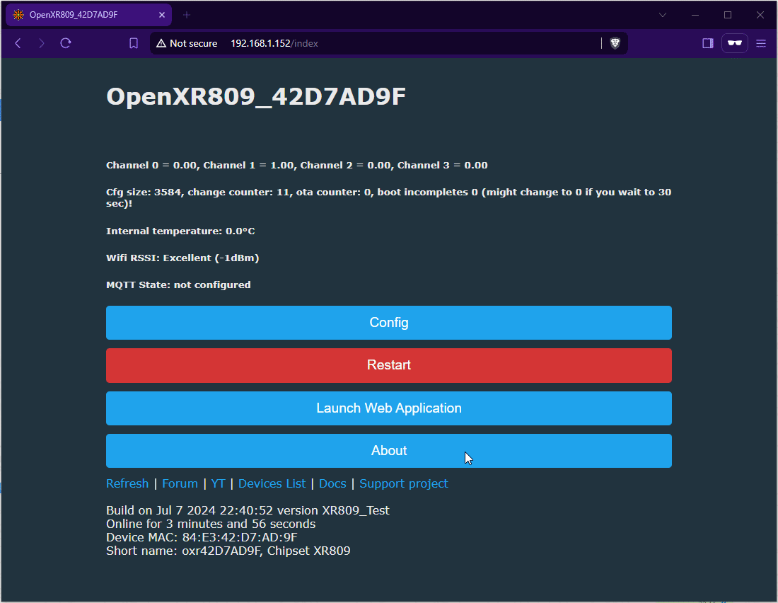

    XR809 GIF
    Web interface screen of OpenXR809_42D7AD9F showing configuration and node information.

    W600
    Screenshot of the OpenW600_CD0239CC web interface displaying NTP sync information, number of active drivers, and Wifi status.

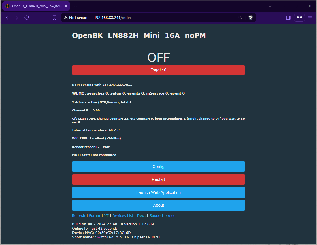

    LN882H less happy
    OpenBK_LN882H Mini 16A interface showing the OFF state.
