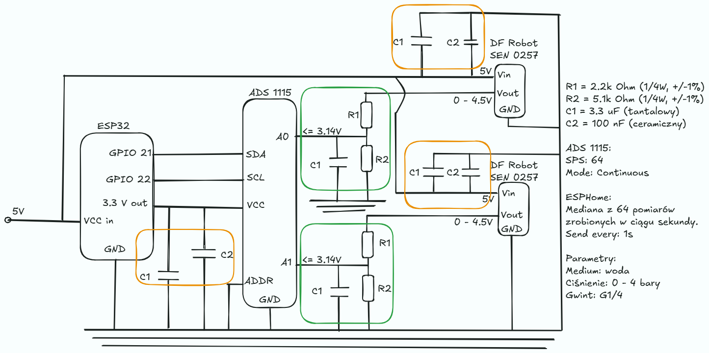

I'm building a water pressure sensor on ESP32 (MH-ET LIVE Development Board) ADS1115 (I2C) 2x DFRobot SEN0257 (cable to each sensor ~1m), and I want to take 64 measurements/s and send to Home Assistant (ESPHome) a value every 1 s, counting the median of the said 64 measurements.
Assumptions and components:
- SEN0257 powered from 5 V, analogue output 0.5-4.5 V goes to ADS1115 via divider: R1 = 2.2 kΩ (from signal), R2 = 5.1 kΩ (to GND), plus RC filter: C1 = 100 nF (ceramic capacitor, filter marked in orange in the picture) from measurement node to GND (capacitor as close as possible to AIN pin of ADS1115).
- ADS1115 supplied with 3.3 V from ESP32; on power supply at ADS1115 I give 100 nF (ceramic), 3.3 µF (tantalum) in parallel VDD-GND, following typical practice of decoupling close to power supply pins.
- at each SEN0257 (at the end of the 1 m cable) I plan 100 nF (ceramic), 3.3 µF (tantalum) between 5 V and GND, to stabilise the power supply on the long cable (marked green in the schematic).
Questions for verification:
1. Is the 2.2 kΩ / 5.1 kΩ divider well matched under the ADS1115 3.3 V (also in case of emergency, if 5 V would appear on the input)?
2. Does C1 = 100 nF make sense at 64 measurements/s, or is it better to give a different capacitance (I am concerned with the trade-off: electrical interference vs fast pressure spikes)?
3. Does the capacitor placement (bulk 'small' close to the circuits/sensors) and ground routing look OK, or should I change something?
Please check if my layout for pressure measurement is correct (I paste the schematic below).
Thank you for your help,
Viv
