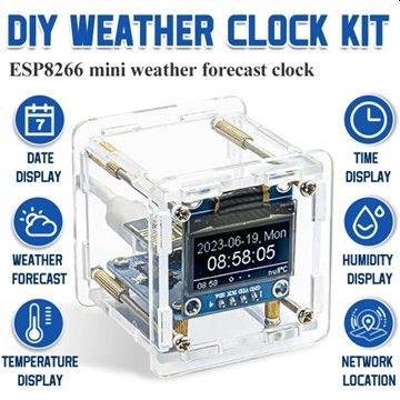

    DIY ESP8266 MINI WIFI Weather Clock. Procedure for setting up the assembled device
    DIY ESP8266 weather clock kit in clear case with OLED screen and feature icons around it
    If anyone is interested in this self-assembly toy from China, I suggest reading my description.
    Attached is my tried and tested method of configuration and some notes.
    BTW. it was not possible to configure this device with Openweather or IMGIW.

  • Added missing OLEDDisplay.h and Json_Streaming_Parser dependency
    #9 21900426
    cannawpz
    Posts: 52
    Welcome back to the topic...
    I have currently reworked the device based on sources from the website: https://www.hackster.io/john-bradnam/micro-weather-station-2b116b
    The description on the page is quite accurate, but the attempt to run ends with an error. I added the missing bit in the esp8266-oled-ssd1306-master.zip archive, the OLEDDisplay.h file, and it now compiles in the Arduino IDE.
    Importantly - the whole thing gets its data from OpenWeather, not a Chinese site. It does not broadcast its own SSID. It doesn't display the browser interface and it doesn't show the password for our Wi-Fi network in plain text. The code encourages modification. E.g.: number of content screens, how to change screens, location of the widget at the bottom of the screen, or changing the language. I add my code to the post (without private data)
    NOTE: You still need to add the Json_Streaming_Parser library to compile the code!
