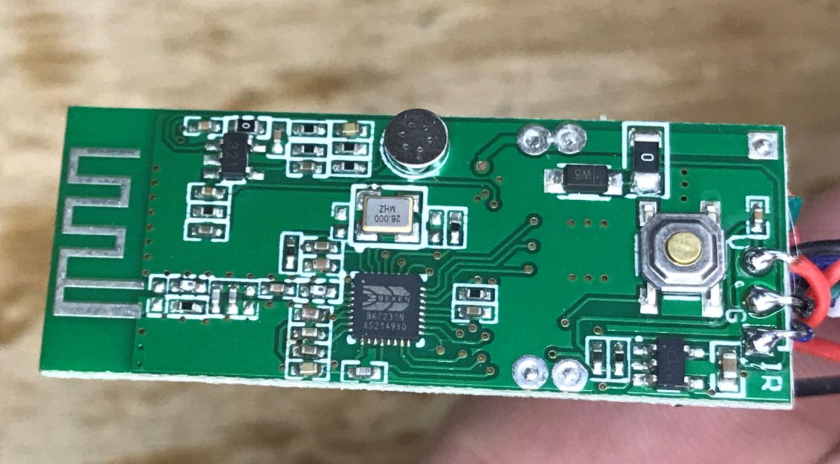

    Close-up of a green LED controller PCB with a trace antenna and a BK7231N chip
    The controller is based on the BK7231N chip located directly on the PCB. The antenna is also in track form. The bacen runs on 3.3 V, so we have a step-down converter here separately. In addition, we have a circuit with a microphone, for effects that react to the rhythm of the music.

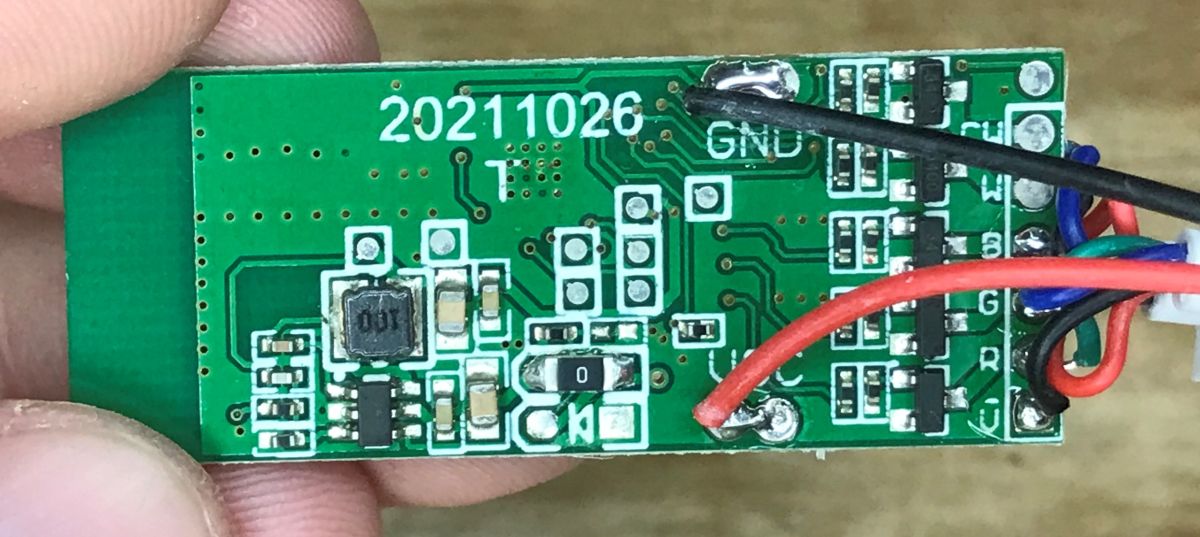

    Close-up of a LED controller PCB with wires and the printed markings “20211026” and “GND”
    On the other side, we also have five transistors, although this is an RGB strip. It looks like it could easily be converted to RGBCW (RGB+CCT), just by adding wires.

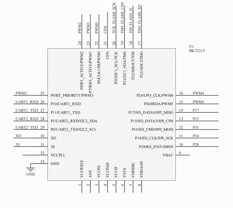

    However, we are interested in changing the firmware, and there are no pads described here. You need to check the BK7231 leads and trace the paths. We have the BK pinouts described in the topic:
    BK7231 datasheet, pinout, programming, specification, wiki (BK7231T, BK7231 [EN]
    Pin configuration diagram of BK7231T chip

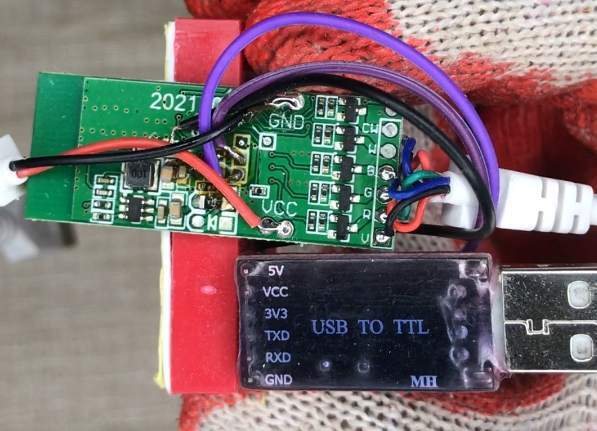

    In addition, you need to determine where the earth is - you can check with a multimeter.
    LED controller PCB with UART wires next to a USB‑TTL adapter; GND and VCC pads are visible
    For programming you need the UART (RX1, TX1) and a power supply, but since here we have a USB strip, you can just power it from USB. From the USB to UART converter, we only connect RX and TX and ground, because the BK7231 requires a power cut to be performed when we start flashing (called "get bus"). This is described in more detail in the instructions of our flashing tool:
    I also always say that you need a stable 3.3V power supply and that I use an external LDO AMS1117-3.3, but here this problem does not exist because the power supply is already on board the controller.
    NOTE: you can't see it here because it's a USB-powered device, but for other equipment, those powered by 230 V, you absolutely MUST NOT connect anything to it when it's plugged in. These types of devices often have uninsulated inverters and you can short-circuit and damage your computer.

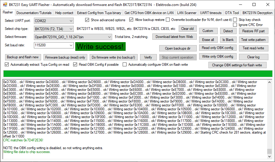

    First we read the batch in the BK7231 Easy UI Flasher, this will allow us to determine the GPIO roles:
    Screenshot of BK7231 Easy UART Flasher with a green “Write success!” message
    This way you don't have to guess later what is on which pin, where the PWM is, where the button is, where the IR receiver is

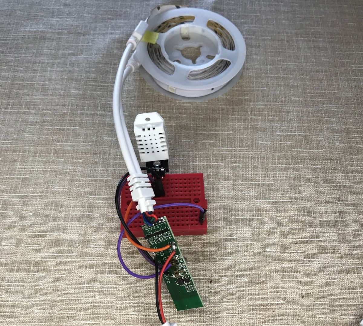

    LED strip controller wired to a DHT-style sensor on a red prototyping board

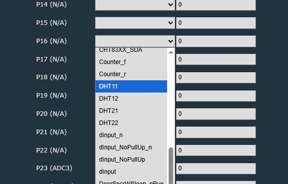

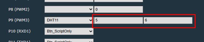

    Take this DHT22, for example. It's a simple and cheap temperature and humidity sensor. It requires one arbitrary pin for communication. We choose its role:
    Screenshot of GPIO pin configuration menu with options list; DHT11 sensor option highlighted
    We connect the DHT as we would to an Arduino, meaning we need a pull up resistor if we don't have one on the DHT board itself. Then we set the channels, simply, we enter the first free numbers. As we set the PWM to channels 1, 2 and 3 (to have RGB), we enter 4 and 5, etc.
    GPIO settings panel snippet with DHT11 selected and highlighted channel fields set to 5 and 6.

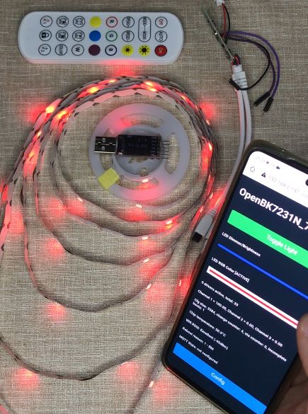

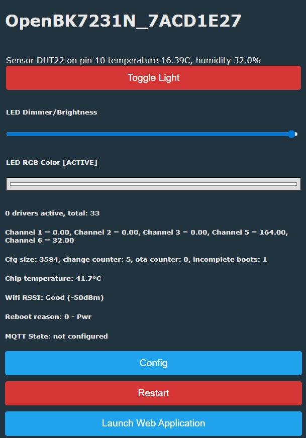

    We save and restart the device if necessary (depends on the controller). The measurements should show up in the panel.
    Screenshot of OpenBK7231N dashboard with Toggle Light button and DHT22 readings
    After performing HASS Discovery, the measurements will also propagate to the HA.
