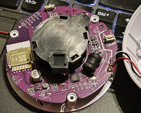

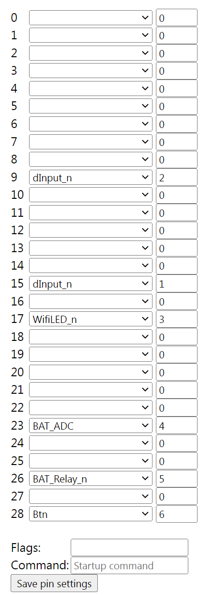

    I wanted to integrate our smoke detectors into Home Assistant (without cloud) and so I bought a bunch of the well known 'Wi-Fi Smoke detector YG400A'. I hoped I could use the configuration hints from this thread.

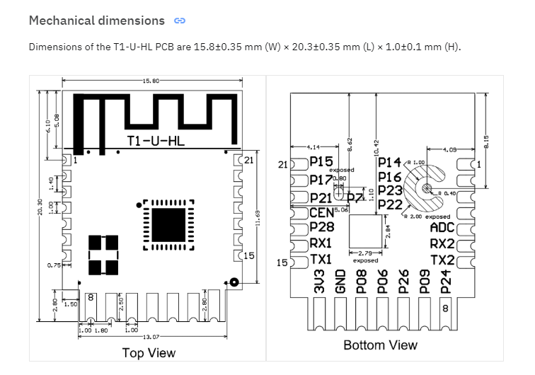

    But the PCB (YG400A-T A010) has another CPU T1-U-HL chip than expected.
    I found a thread in this forum with this chip and so I tried to flash the chip.

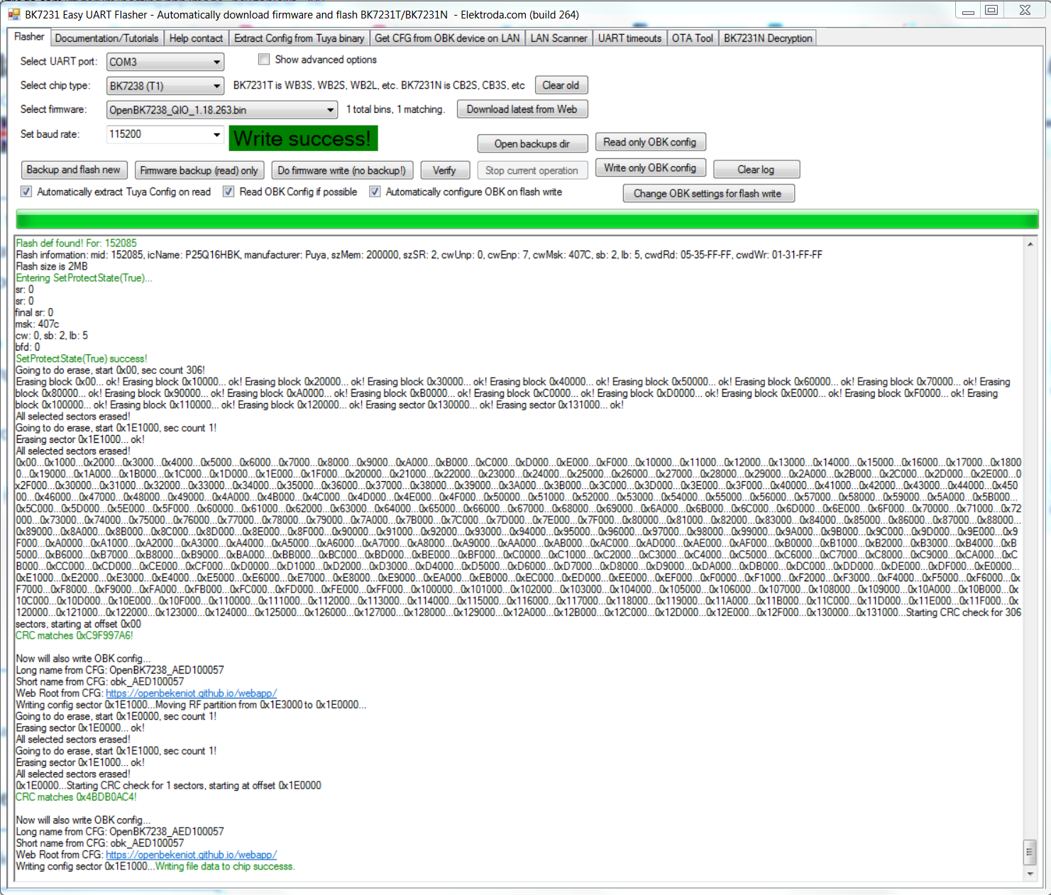

    The flash process with the 'Easy UART flasher' and this file 'OpenBK7238_QIO_1.18.263.bin' was successful.
    Wi-Fi is working and I could integrate the smoke detector into my local network.
    The configuration page looks newer than in the other thread (btn has now a second edit box, wifiled has no edit box).
    Now I need some help on how to proceed further to get the smoke detector to work.

    What exactly do you mean by configuration page looks different? We can certainly help but please provide more details for example did you try any of the autoexec files that are provided in that thread?

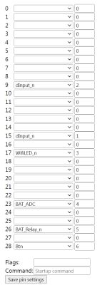

    I have done everything like in the other thread (Pin assignment, autoexec.bat).

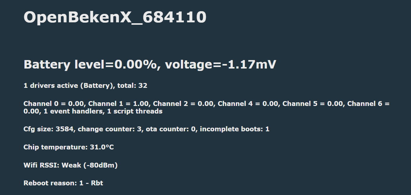

    But as you can see in the screenshot, the battery level is always 0% and also the voltage is not correct. I inserted new batteries.
    Also, I set channel 3 for the wifiled, but there is no channel 3 in the screenshot.

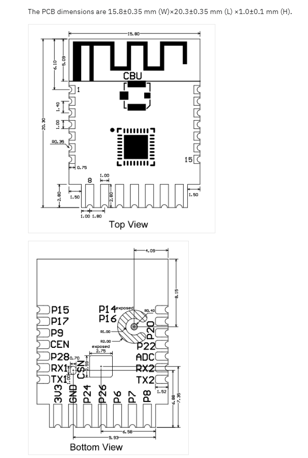

    there are some differences between CBU and T1U modules so you'll have to compare and figure out the right pin configuration
