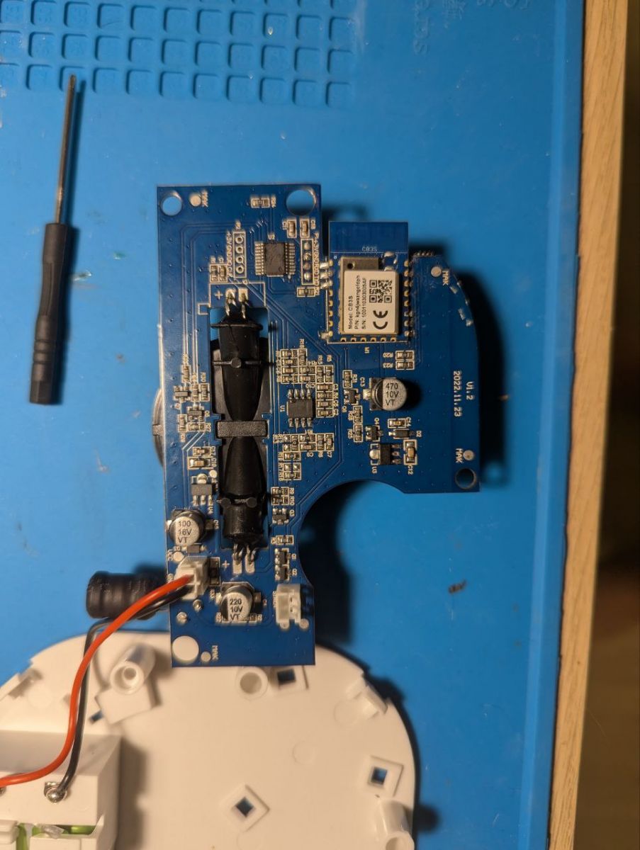

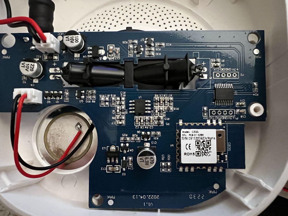

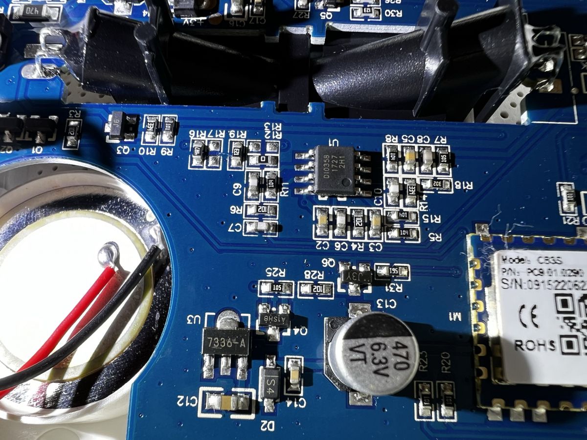

    arhismece

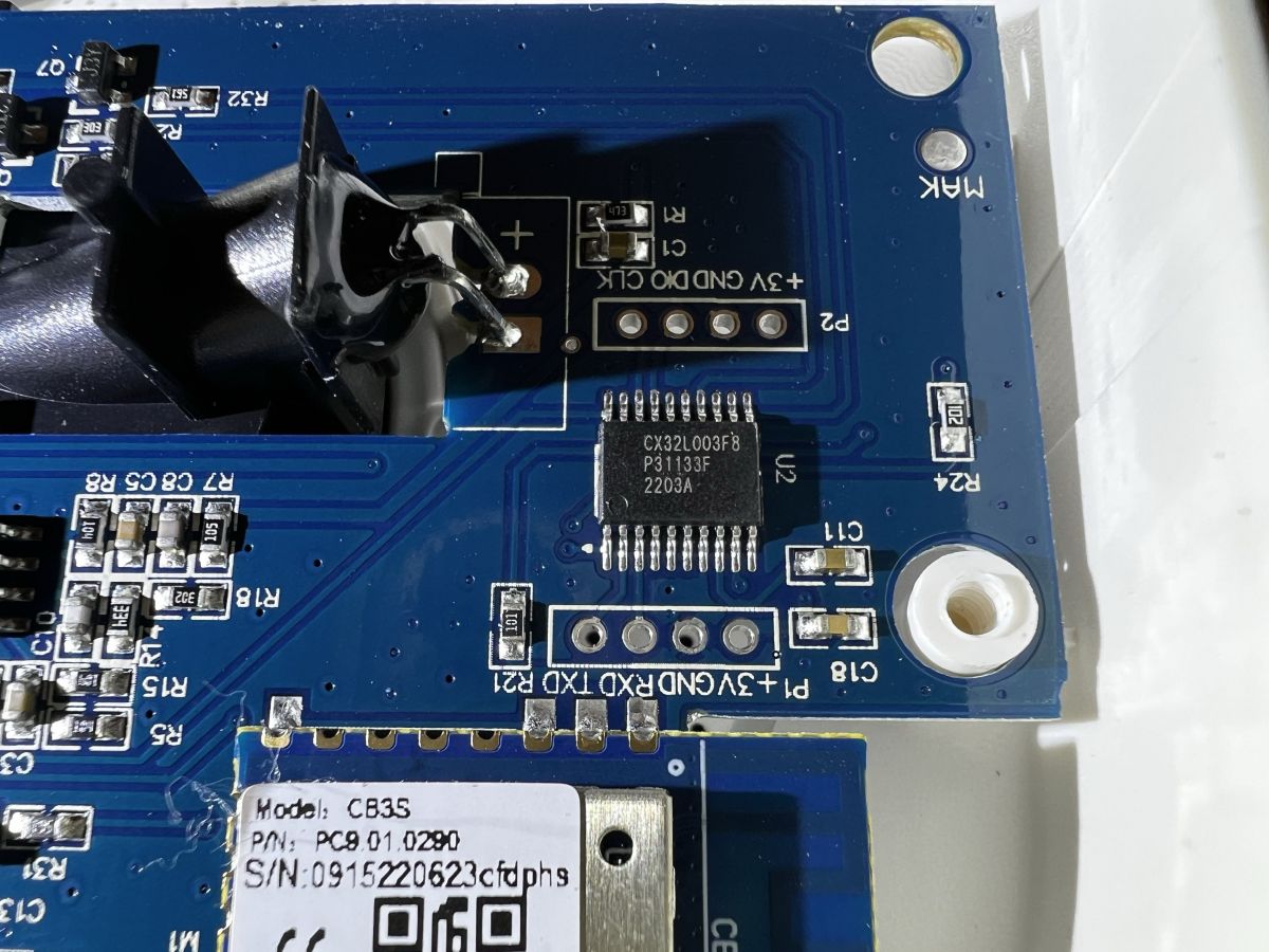

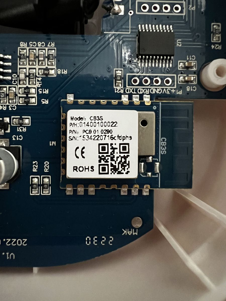

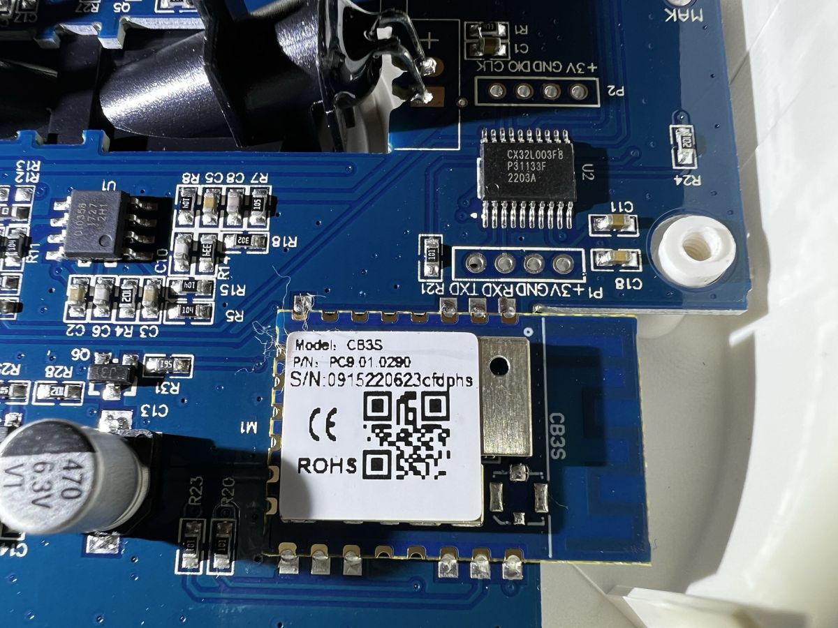

    WiFi module: CB3S
    Additional MCU: CX32L003F8

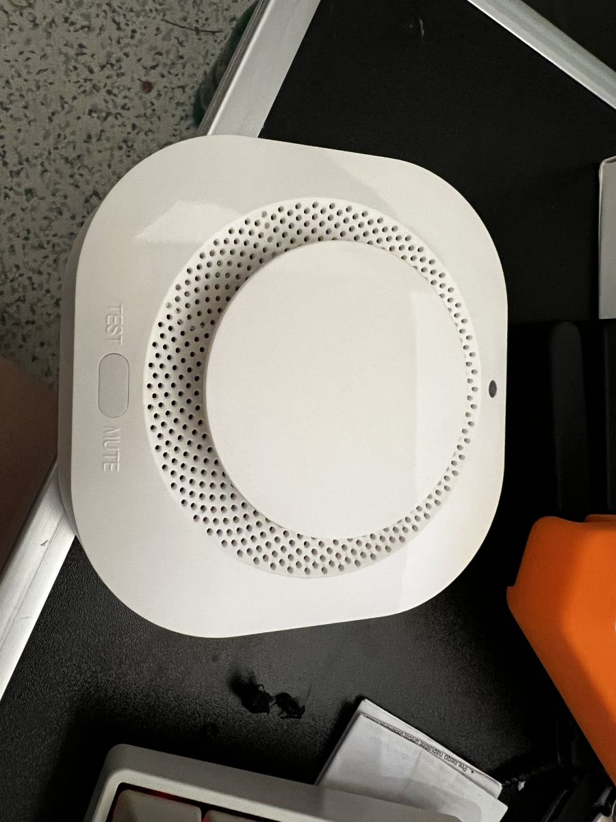

    Sensor type: optical smoke detector
    Optical smoke detector on a desk with TEST and MUTE buttons. Close-up image of a PCB module with visible electronic components, including a CB3S module. Opened optical smoke detector with visible internal electronic components. Electronic circuit with CB3S Wi-Fi module on a smoke detector PCB. Close-up of a PCB with CB3S and CX32L003F8 microcontrollers. Close-up of a PCB with a Wi-Fi module CB3S and a CX32L003F8 microcontroller. Close-up of a PCB with visible chips and CB3S module Close-up of a blue PCB with electronic components in an optical smoke detector. Printed circuit board with a smoke detector on a blue PCB. Close-up of a PCB with blue laminate and an optical smoke detector attached.
    same chips as on https://www.elektroda.com/rtvforum/topic3978070.html but PCB layout and maybe sensor look different

    Thanks, it looks like a TuyaMCU device. Have you tried to capture the TuyaMCU packets?

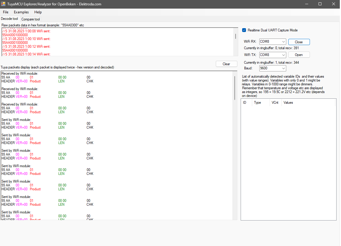

    TuyaMCU Explorer/Analyzer interface displaying WiFi packet data.

    It can't show nonsense, unless it's broken. Doing a full UART capture from both RX->TX and TX->RX lines certainly can help and should be done before flashing new firmware.
    We need to know dpIDs of variables, etc, which dpID is which variable, etc
    Try doing capture from the second UART lane.

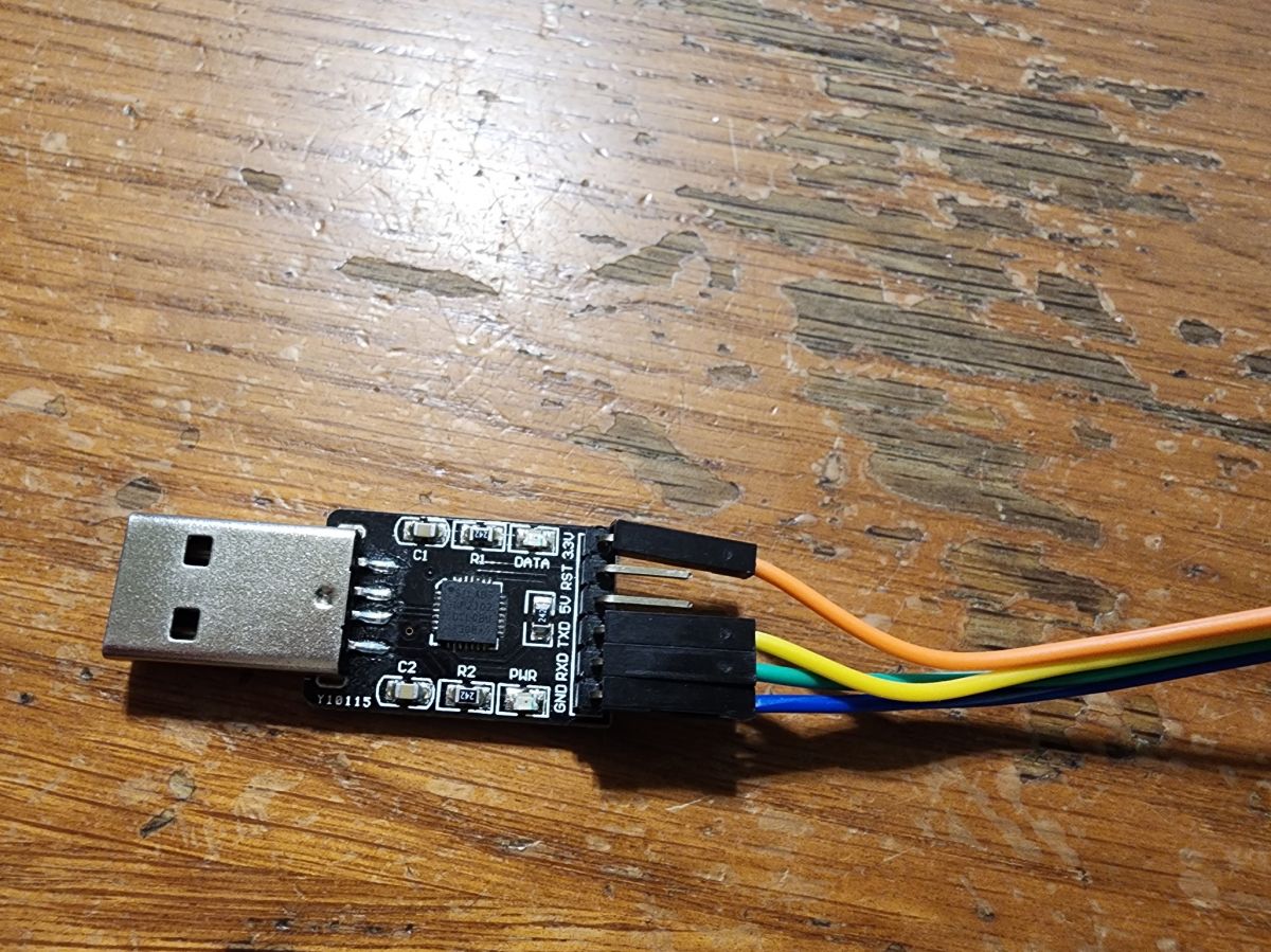

    This device is powered by 9V Wonder Silver battery standing next to a matchstick.
    Added after 11 [minutes]:
    Do I need device power or just 3V UART power?
    How to connect correctly?
    UART RX-TX only
    Main device power
    Added after 4 [minutes]:

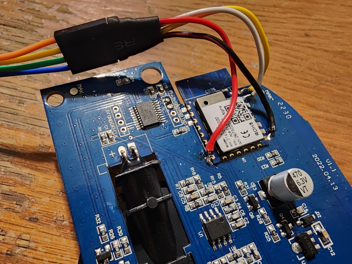

    Close-up of a circuit board with connected wires, showing electronic components. USB to UART adapter with connected wires
  • Need battery-powered UART capture to identify dpIDs

    In order to get a proper transaction capture, you need to power the device from the battery in a way that is powered during usage.
    Do not power WiFi module externally. Just connect GND and RX to get UART capture.
    First capture from RX, then from TX, I assume you know how UART works, if not, ask here and I will give more details.
    Powering WiFi module makes no sense here because MCU would be sleeping anyway so the transaction still won't happen.
    We need to know which dpIDs are present and what are their meaning. We are looking some data points like:

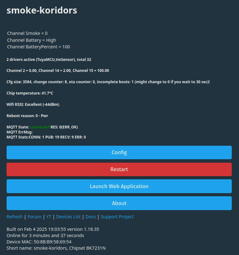

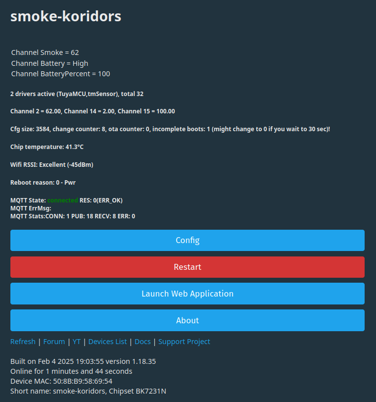

    I was prepared for logging and debugging, but surprisingly everything worked at first go. @wtv should have worked for you too. Maybe you had a different board version or bad module?
    I used 9600 baud and BK7231 did receive all the data. dpIDs are similar to other TuyaMCU smoke detectors seen on this forum. Smoke is a percentage on dpID2 exactly as you found out. There seems to be something on dpID1 (and perhaps other dpIDs), but it reports 1 all the time. Anyway it's not needed as Smoke % and battery status are present and shown in HA. There might be a siren silencer toggle on dpID16, should we maybe use it as a switch?

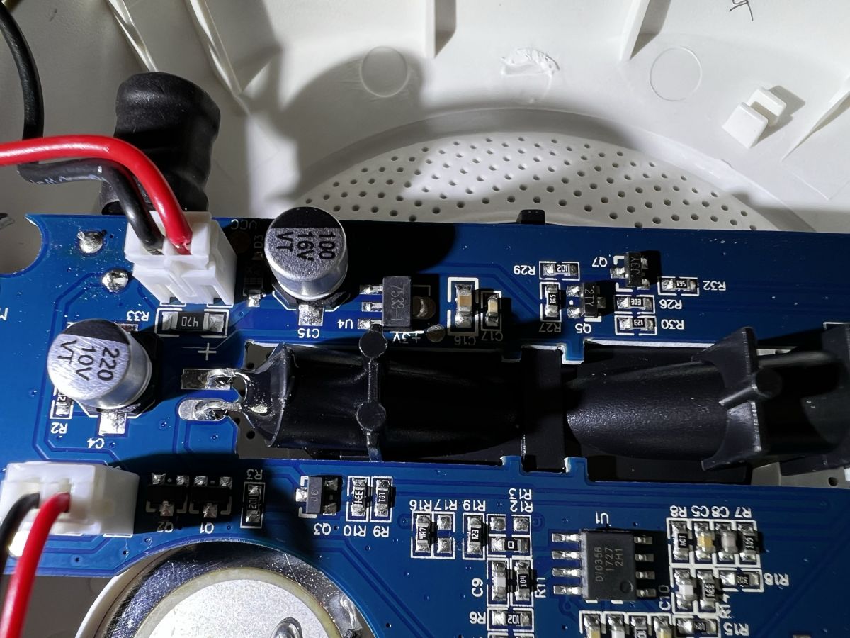

    My board:
    Circuit board with BK7231 module and electronic components.
    High amounts of smoke:
    Screenshot of control panel for smoke-koridors showing smoke data
    No smoke:
    Web application interface of a smoke detection device displaying metrics and configuration options.
    The autoexec is pretty much the exact same, I only added the channel types:
    startDriver TuyaMCU
    startDriver tmSensor
    tuyaMCU_setBaudRate 9600
    // smoke sensor value, Int value, dpID 2
    setChannelLabel 2 Smoke
    setChannelType 2 SmokePercent
    // Battery state lo-mid-hi, dpID 14
    setChannelLabel 14 Battery
    setChannelType 14 ReadOnlyLowMidHigh
    linkTuyaMCUOutputToChannel 14 enum 14
    // Battery state, 0-100 % value, dpID 15
    setChannelLabel 15 BatteryPercent
    setChannelType 15 BatteryPercent
    linkTuyaMCUOutputToChannel 15 val 15
    Additional info:
    When test button is pressed, the device connects to WiFi and stays for around 15-20s. There is enough time to launch the web application create the autoexec.bat quickly (or make some additional changes to the config). How often it broadcasts its status, I don't know yet.
    Also fully de-soldering CB3S can be avoided by removing R20 and R23 resistors when writing, which are on the TX and RX line.
    I bought a few of these devices quite a while ago, the 9V battery works for a long time and they are pretty cheap as well. Nice devices, smoke is also detected very quickly when compared to the round Tuya detector with 2xAAA batteries and no MCU.
    I saw the detector beeping at 20% of smoke. It then turned on and remained until the smoke cleared out. I also set the quick connect flag. I think this device can be marked as working.
