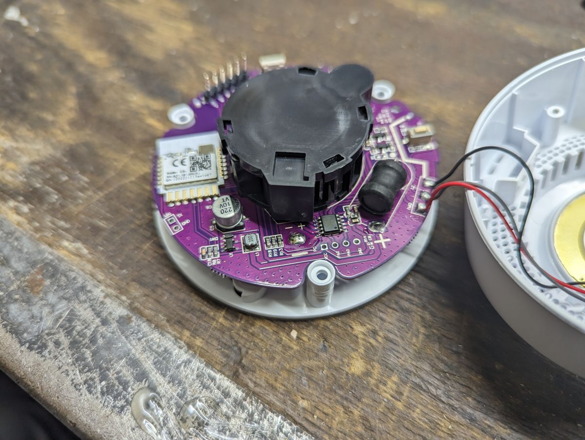

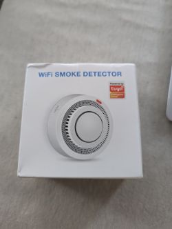

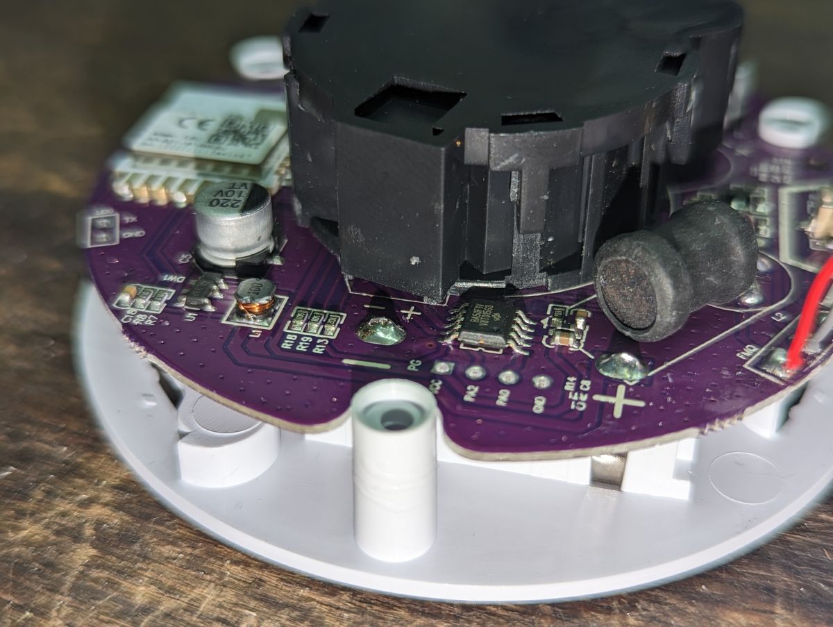

    I bought 4 Wifi Smoke detectors, hoping they would contain ESP8266, but they contain a different type of CPU. I was able to download openbeken successfully with uartprogram using OpenBK7231N_QIO_1.15.182.bin.
    Wifi and MQTT work, but the device is not in the supported devices list. How to proceed? The Tuya-Commands of older versions of this device can be seen here:
    https://templates.blakadder.com/YG400A.html
    How can I get the Smoke Detecting part running with openbeken?

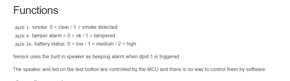

    Hello, this is related topic:
    Motion sensor with BK7231N
    but judging from that:
    OpenBeken on WiFi Smoke Detectors (Tuya CBU Chip) - ESP8266 Alternative, MQTT & Setup
    I'd suggest that autoexec.bat (create file in LittleFS):
    startDriver TuyaMCU
    startDriver tmSensor
    setChannelType 1 readonly
    // link dpid to channel 1
    setChannelType 4 readonly
    // link dpid to channel 4
    linkTuyaMCUOutputToChannel 4 val 4
    setChannelType 14 readonly
    // link dpid to channel 14
    linkTuyaMCUOutputToChannel 14 val 14
    Reboot and then remember that TuyaMCU only wakes up module when something happen.... (so WiFi module will go offline after some time).... and check what are the values?
    Also please post full log from Web App here so I can see if TuyaMCU communication happens...

    I did my best:
    I managed to find the following connections:
    Pin 6: RX2 (indicated on board) Pin 7: Log TX (indicated on board) Pin 15: TX (indicated on board) Pin 16: RX (indicated on board) Pin 17: Reset Button on side, accessible through hole Pin 18: RST on Pin-Header with RX/TX/RX2/VCC/GND Pin 19: Tamper-Switch on backside Pin 21: see below
    The Test-Button seems to be connected to the other 10pin chip only. The 10pin chip seems to also have connections to the LED and Photoreceptor inside the black smoke detection chamber.
    Probably the magic happens with Pin 21 on the CBU, it is the only connection between the 10pin chip and the CBU that I found (there is a 1k resistor in this connection).
    Hope that helps. Anything more I could check? Does anyone know what the black part with 3 connections might be?

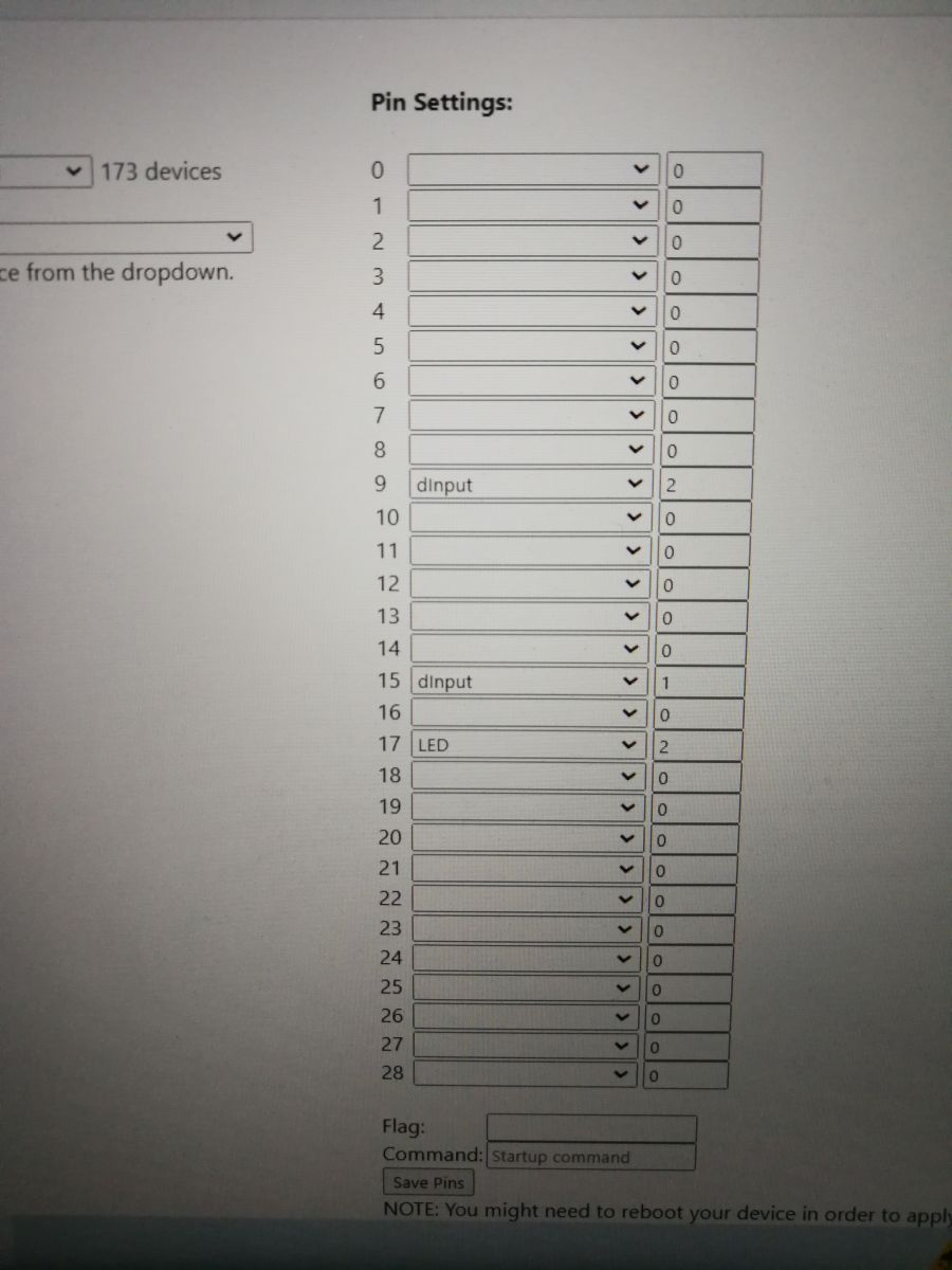

    Ipn00tic
    Posts: 17
    This equipment doesn't look like a tuyaMCU, it just has a 10-pin chip with the inscription BA50F1V V5K00KG3 .
    in pin settings:
    9 dinput (back cover button)
    17 LED (front red LED)
    15 dinput (high while smoke is inside)
    28 dinput (reset button, high but stays low after being pressed for 3 seconds. then it goes back to high)
    The front button doesn't seem to have a connection with the CBU chip, it just silences the buzzer and does the test. and it does it without needing configuration as well as the blue LED.
    I didn't find connection of the blue LED with the chip but it is doing its function without configuration.
    The red LED must be turned on with the lid button to warn that it is not well fitted??!??!
    I don't know what to do with the reset button, does it only reset the original firmware settings or does it have another function?
    The firmware does not automatically send the dinput to be read on the home assistant like it does with a relay or led, I don't know how to write the code in the home assistant discovery configuration for pin 15 dinput to appear on the home assistant when it detects smoke.

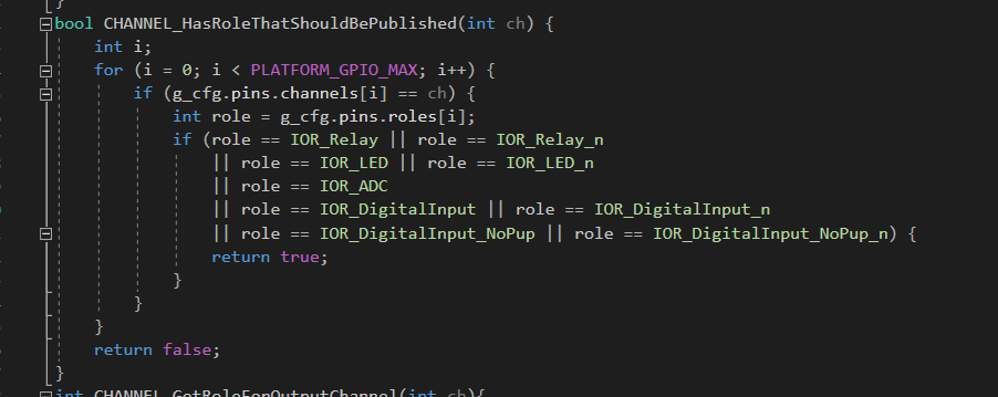

    Are you sure it doesn't publish dInput? From what I can see, it's enabled for both "broadcast self state every minute" and for onChange publishes:
    Added after 1 [seconds]:

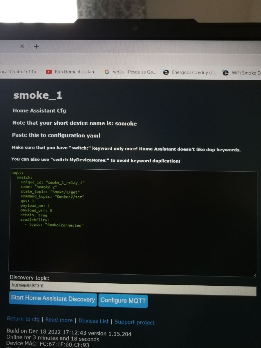

    in home assistant I only automatically discover the LED that appears as an on/off relay. or else I don't know how to look for the dinput in the home assistant....
  • #16 20343241
    Posts: 14753
    Rate: 12875
    @Ipn00tic it seems I now understand what you are asking for.
    If you are asking for automatic configuration, then it's just not implemented yet.
    You have to write the YAML yourself.
    OpenBeken will publish dInput value at the obkName/channelName/get topic, you can receive that value and handle it however you like.
