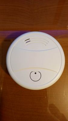

    Name : Tuya smoke detector
    Producer : MBG Line
    Model : VS-P443W

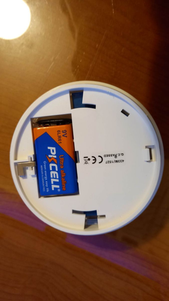

    Sensor purchased on Allegro for PLN 118. It has a smoke ppm indicator, battery level indicator and an alarm trigger if the smoke level is exceeded. Works with the Tuya app.
    teardown:
    [BK7231N /CB3S] Smoke detector MBG line VS-P443W Tuya - teardown [BK7231N /CB3S] Smoke detector MBG line VS-P443W Tuya - teardown [BK7231N /CB3S] Smoke detector MBG line VS-P443W Tuya - teardown [BK7231N /CB3S] Smoke detector MBG line VS-P443W Tuya - teardown [BK7231N /CB3S] Smoke detector MBG line VS-P443W Tuya - teardown [BK7231N /CB3S] Smoke detector MBG line VS-P443W Tuya - teardown [BK7231N /CB3S] Smoke detector MBG line VS-P443W Tuya - teardown [BK7231N /CB3S] Smoke detector MBG line VS-P443W Tuya - teardown [BK7231N /CB3S] Smoke detector MBG line VS-P443W Tuya - teardown [BK7231N /CB3S] Smoke detector MBG line VS-P443W Tuya - teardown

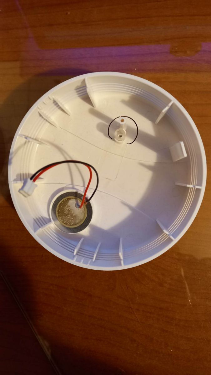

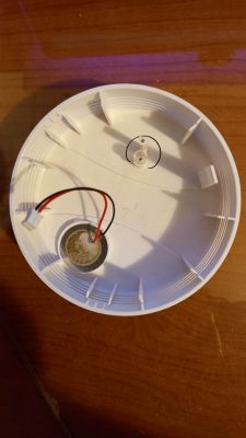

    Disassembly of the sensor is very easy - the housing is on plastic latches, and the PCB has only one screw. On the board, apart from CB3S, there is also CX32L003(F8) and it is to it, not to CB3S, that the pins RXD, TXD, GND and +3V and +3V, GND, SWC, SWD are visible.

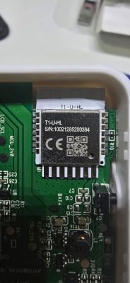

    PCB: PA-443W_V.1.1 (2021.06.15)
    Microcontroller: CB3S (BK7231N)
    Additional microcontroller: CX32L003F8 (ARM Cortex-M0+ 32-bit) ( data sheet )
    Below soldered to PCB pins from CB3S:
    Probably the main microcontroller here is ARM, and CB3S is used to receive data digitally and transmit it over Wifi. Given that it is not ESP, the only alternative may be OpenBeken, but at the moment I have no idea how to run this sensor on an alternative fw.

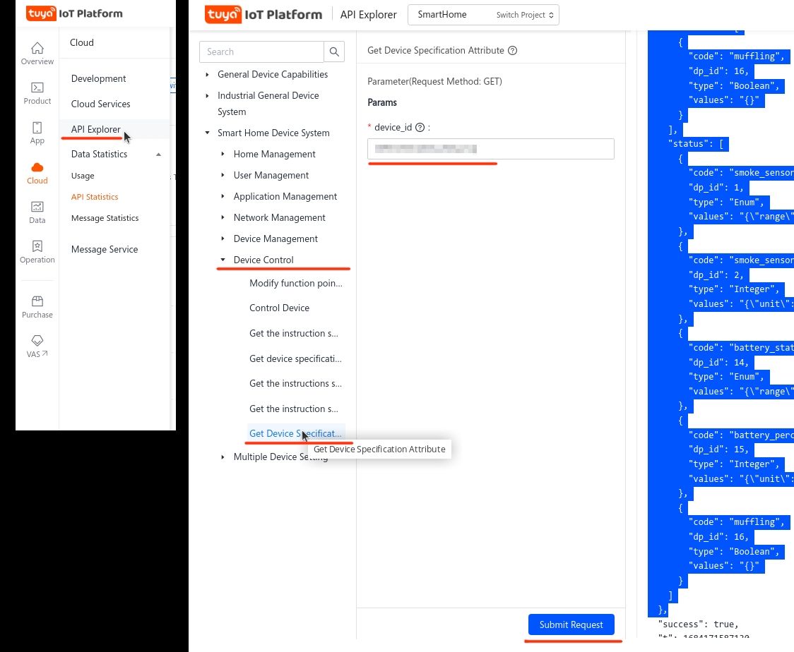

    I pulled the sensor data through Tuya IoT Platform using API Explorer → Smart Home Device System → Device control → Get Device Specification Attribute :
    Here is the dpID list for this device:

    Can you elaborate on how you got it, or write a mini-tutorial about it? One person already mentioned this, but I'm not familiar with this approach. Additionally, do you have this data in some JSON or XML pretty? Maybe it would be possible to automatically generate the OBK configuration.

    I edited the post and added info on how to extract dpID (you can also use Debug device in a more limited form, but API Explorer has all the info right away).
