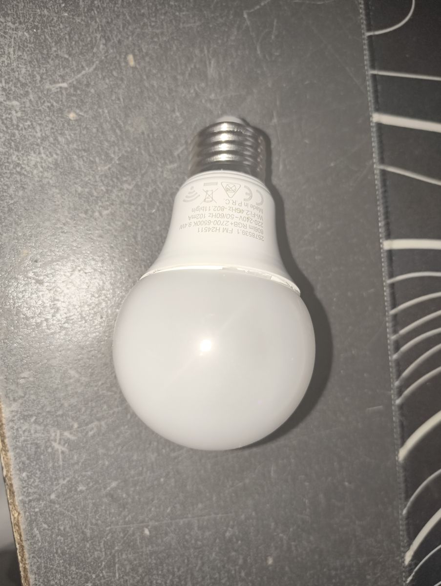

    Today we hack a LSC Smart Connect LED Smart Lightbulb A60 E27 RGB.
    White LED light bulb with E27 screw base lying on a dark, scratched surface

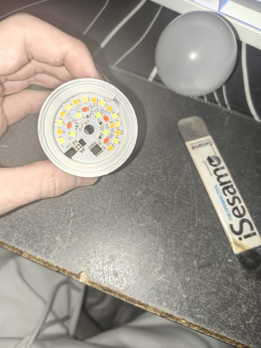

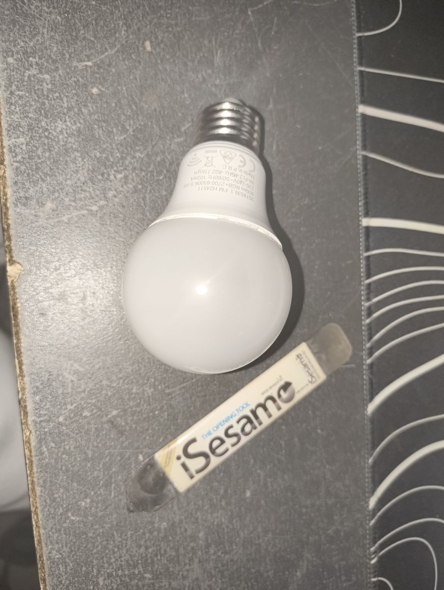

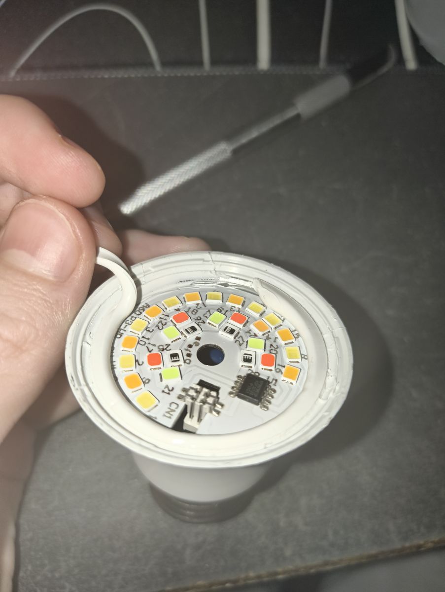

    First open the bulb with a spudger:
    White LED bulb with E27 screw base on a gray surface next to an “iSesame” sticker.
    Hand holds an opened LED bulb with a circular PCB and SMD LEDs; an “iSesamo” glue tube lies nearby.
    Next remove the joint with a cutter:

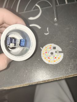

    Opened LED light bulb with a circular PCB and SMD LEDs, held in a hand
    And remove the Led board:
    Opened LED light bulb showing internal electronics, with a separate round LED board on the table

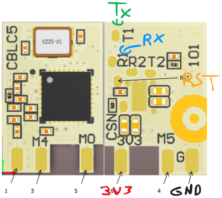

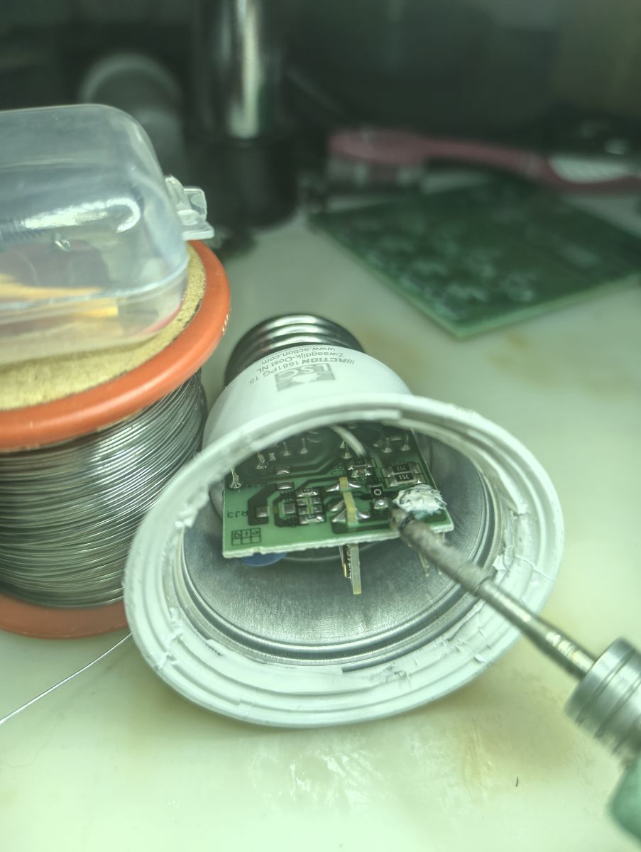

    Now we have to desolder the CBLC5 Chip (I didn't want to remove the board, but you do as you wish.)
    Disassembled LED bulb with exposed PCB, next to a solder spool and a soldering iron tip

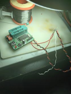

    Now take your Uart programmer and solder it as shown in the diagram.
    chip TX > RX programmer
    chip RX> TX programmer
    and solder a cable on RST
    UART wiring diagram on CBLC5 board with marked TX, RX, RST, 3V3, and GND pads
    Programmer PCB with a ZIF socket, next to a solder wire spool and connected leads

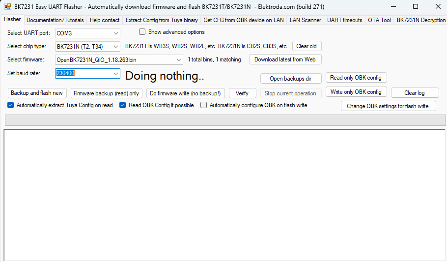

    Next connect the programmer to the pc and launch the Uart Flasher : Link
    Set the correct port, download the firmware, and make a backup.( The software will ask you to connect the pin rst to gnd. Do so and the backup will start.)
    Screenshot of BK7231 Easy UART Flasher showing COM3 selected and baud rate set to 230400
    Screenshot of BK7231 Easy UART Flasher reading firmware, showing “Reading…” and a log window
    Next Flash the Module with the firmware. (You may have to change the Baud rate.)
    Screenshot of BK7231 Easy UART Flasher showing “Writing…” and a log of flash sector erasing.

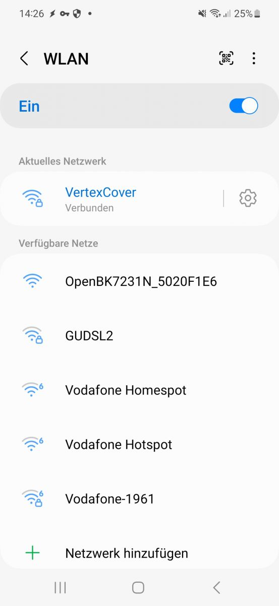

    Check for a Wi-Fi called OpenBK7231N_ XXXXXXX and connect to it, then set up the Wi-Fi.
    Desolder the module and clean it.
    Clean the pad on the motherboard and resolder the module.
    Clean the joints and replace the LED board.
    Do not replace the bulb, then connect the lamp to 230V and test it.

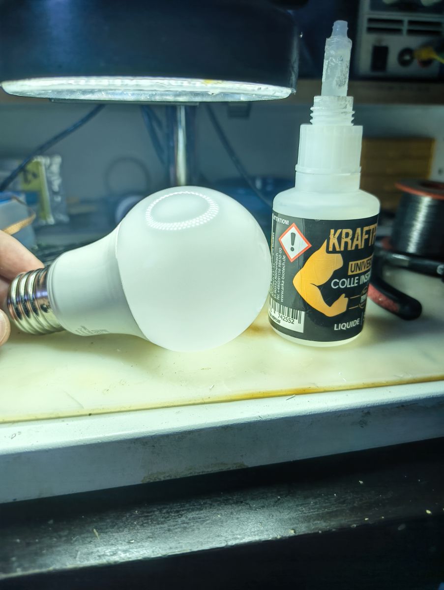

    Now test the color and white balance, and if it is good, glue the bulb.
    LED light bulb on a work surface next to a “KRAFT” glue bottle, tools in the background
    Voilaaa !!
    Now you have a functional Open Beken bulb.

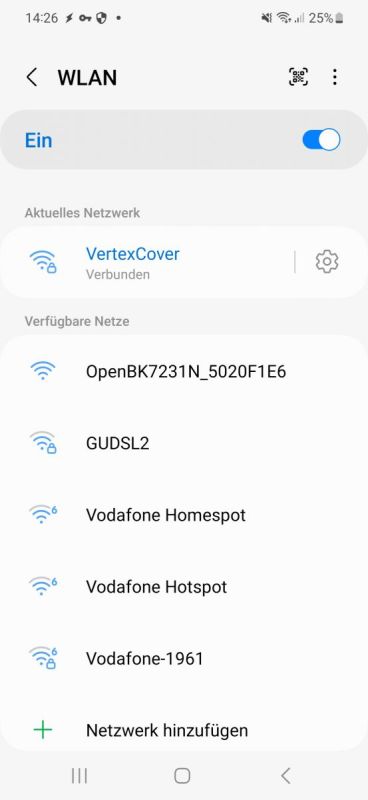

    Is this WiFi network to be called Open or has AI gone astray in the translation?
  • #3 21848778
    Posts: 14746
    Rate: 12842
    Translation error, Wi-Fi is called "OpenBK...":
    Screenshot of WLAN settings showing Wi‑Fi networks, including “OpenBK7231N_5020F1E6” and “Vodafone Hotspot”.
    (example from another post)
