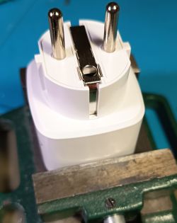

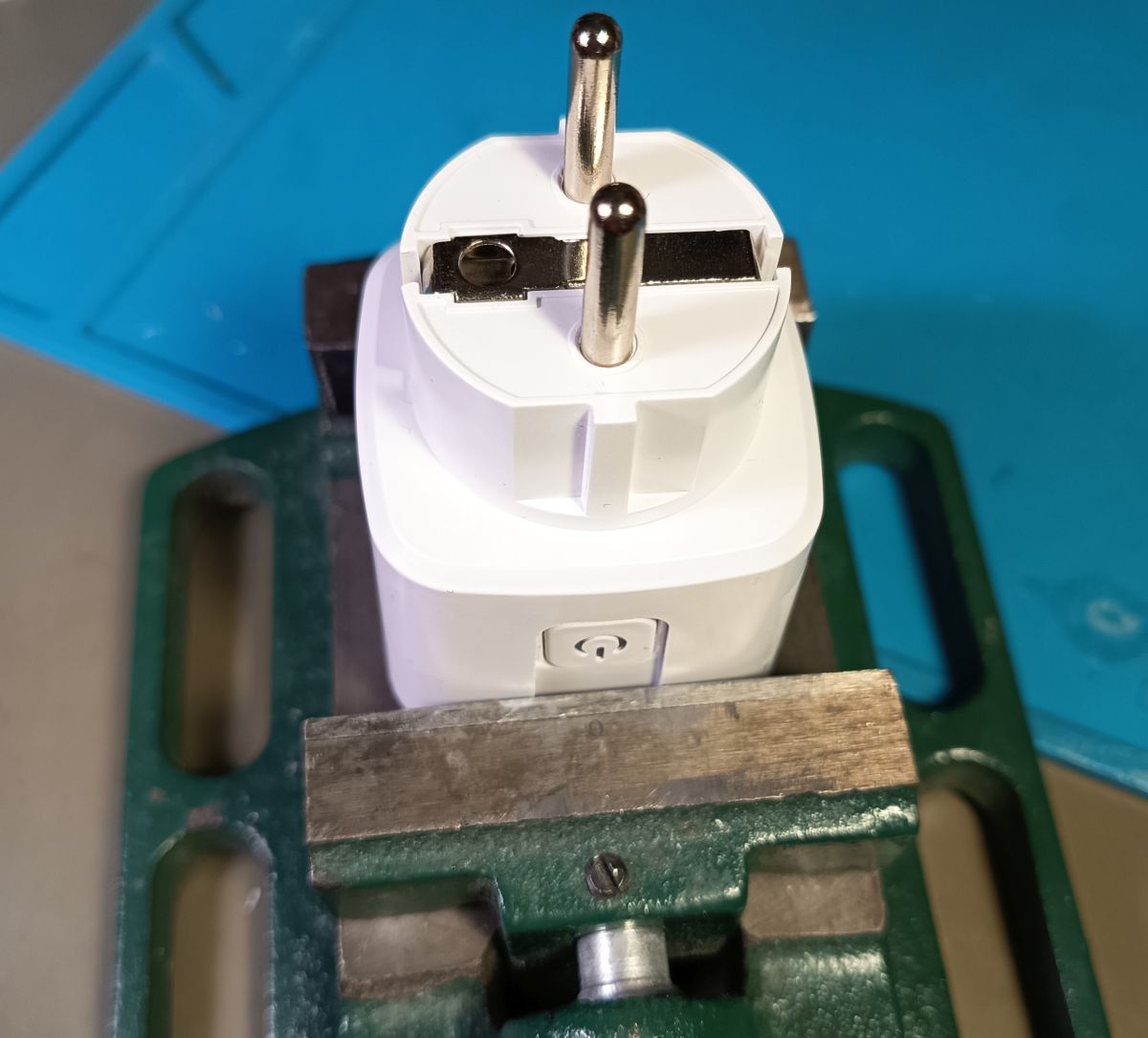

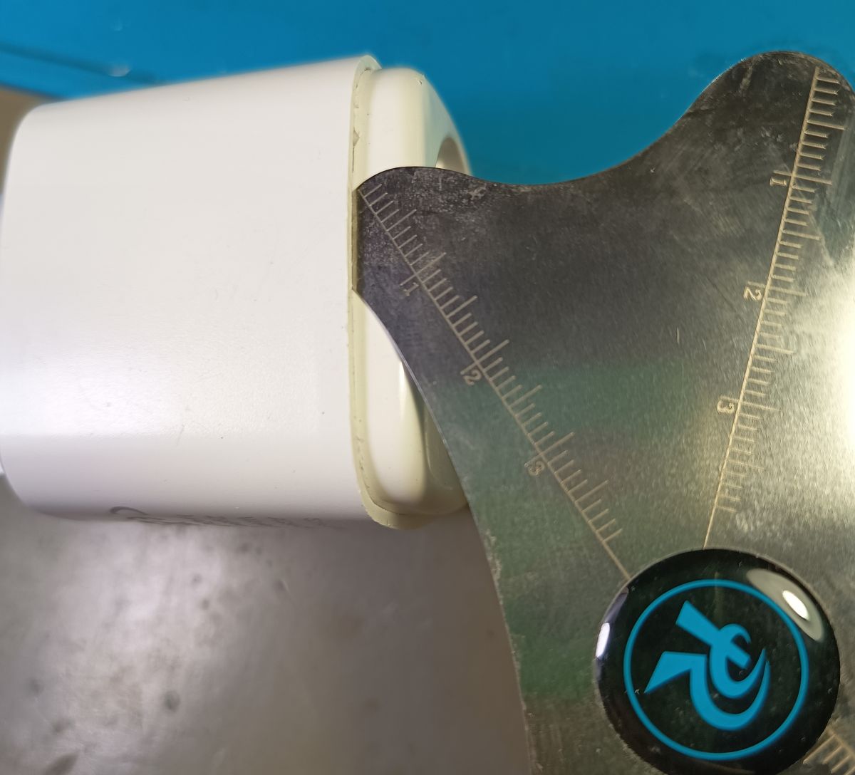

    Open the device by cautiously cracking the glued rim; eventually, pry it open.

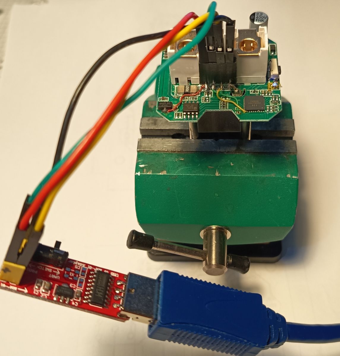

    Unscrew the inner PCB and wire 3.3 V (red), GND, Rx (yellow), and Tx (green).
    PCB close-up with two screw terminals, wires, and red “Tx Rx” labelClose-up of a green device with a PCB and wires; a red USB module with a blue plug nearby
    You need a 3.3 V USB-to-UART converter to connect to the T34 chip.
    Also, you may need to exchange the Rx and Tx lines depending on your USB-to-UART programmer.

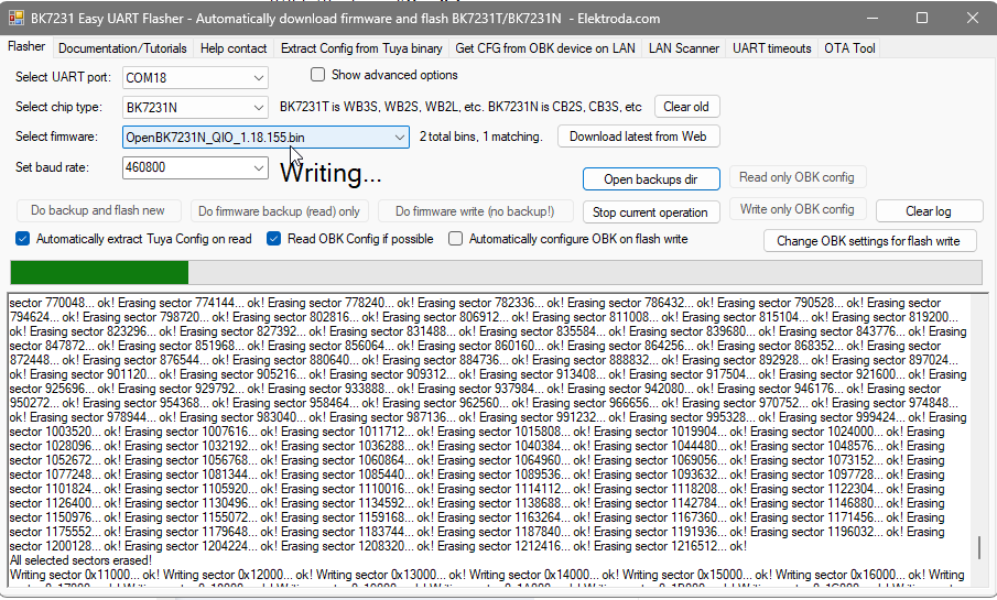

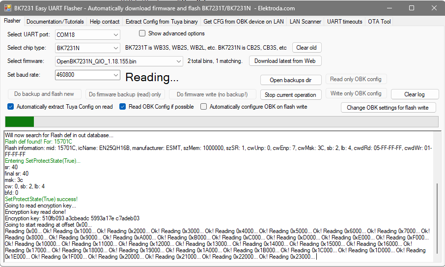

    Use the Openbeken flasher: set UART port and chip type (BK7231N), and test the connection by doing a firmware backup.
    Eventually, you need to re-power the module a few times until the chip enters the programming mode.
    Use a suitable baud rate that your PC handles without errors.
    Screenshot of BK7231 Easy UART Flasher reading flash memory from a BK7231N chip.
    After a successful backup, write the new firmware to the chip.
    Screenshot of BK7231 Easy UART Flasher showing “Writing…” and a log of erasing and writing memory sectors
