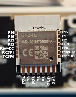

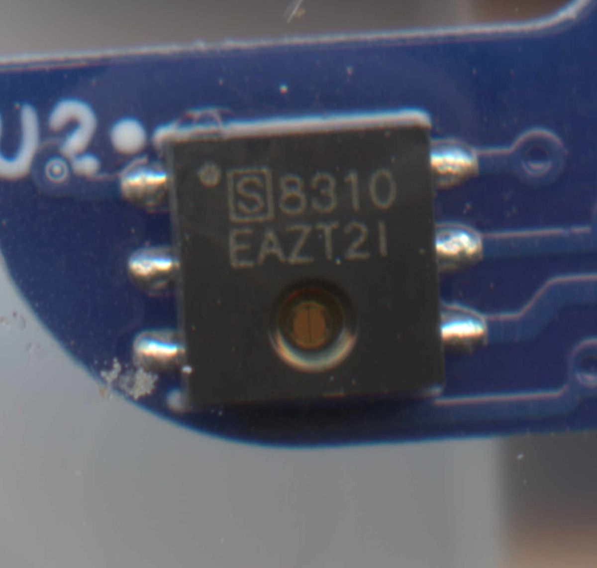

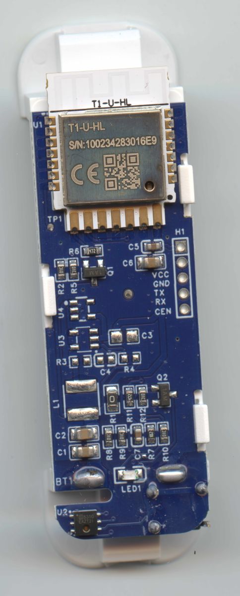

    Hello . Got those from temperature -humidity sensors from aliexpress . Seem based on the BK7238 chip . Dumped firmware and flashed obk . Will post results.
    Blue PCB with T1-U-HL module, QR code, and labeled pins VCC, GND, TX, RX, CEN Close-up of S3310 integrated circuit on a blue PCB with three leads on each side Blue PCB with printed traces and a mechanical push button labeled SW1, top-down view.
    Flattened temperature & humidity sensor box from AliExpress with a folded instruction sheet on a white desk
    Box and leaflet for a Wi‑Fi temperature and humidity sensor with specs table and a QR setup code

    the blue PCB with CHT8310 is new? the GV4 pic is from other thread with T1-CHL?

    Yes the board is new. Pic of the sensor is wrong. Will update it.

    Tuya T1-U-HL module with labeled pins around the metal shield, close-up front view on a PCB
