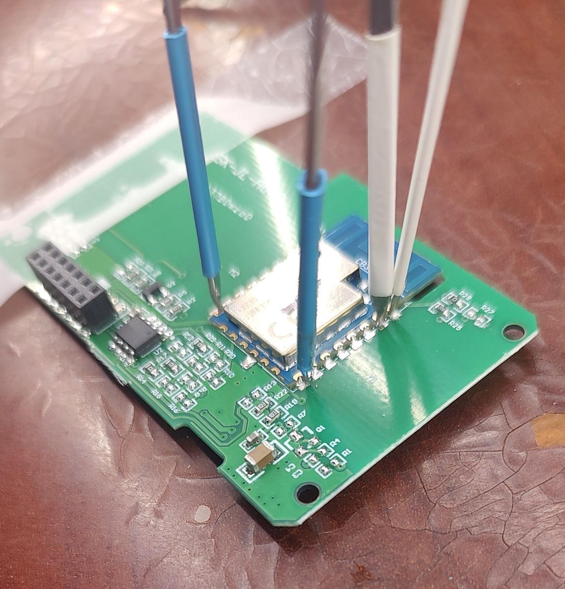

  • OpenBeken flashing via detached CPU board and UART pins
    #1 21849687
    stvrdl

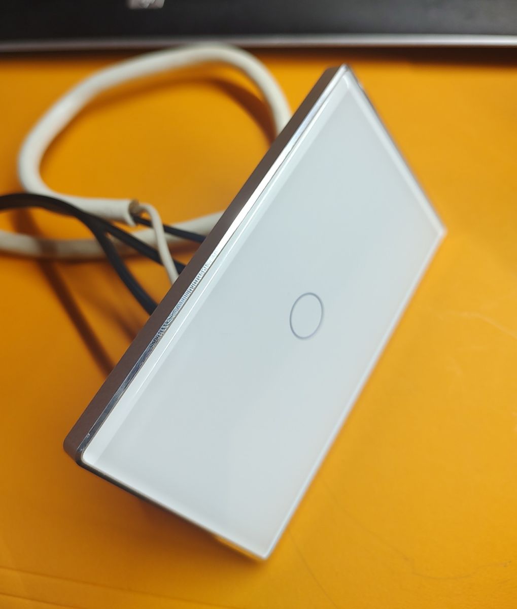

    Easy to convert from Tuya to OpenBeken.
    The CPU board simply pulls off the relay board.
    From there it's easy to upgrade the firmware.
    GND, VCC, TX, and RX.
    Power-cycle the device to begin programming.
    There is a BL0937 for power monitoring.
    White glass touch panel with a circular icon, lying on an orange surface with cables behind it
    .Close-up of a PCB with a soldered module and connected wires
