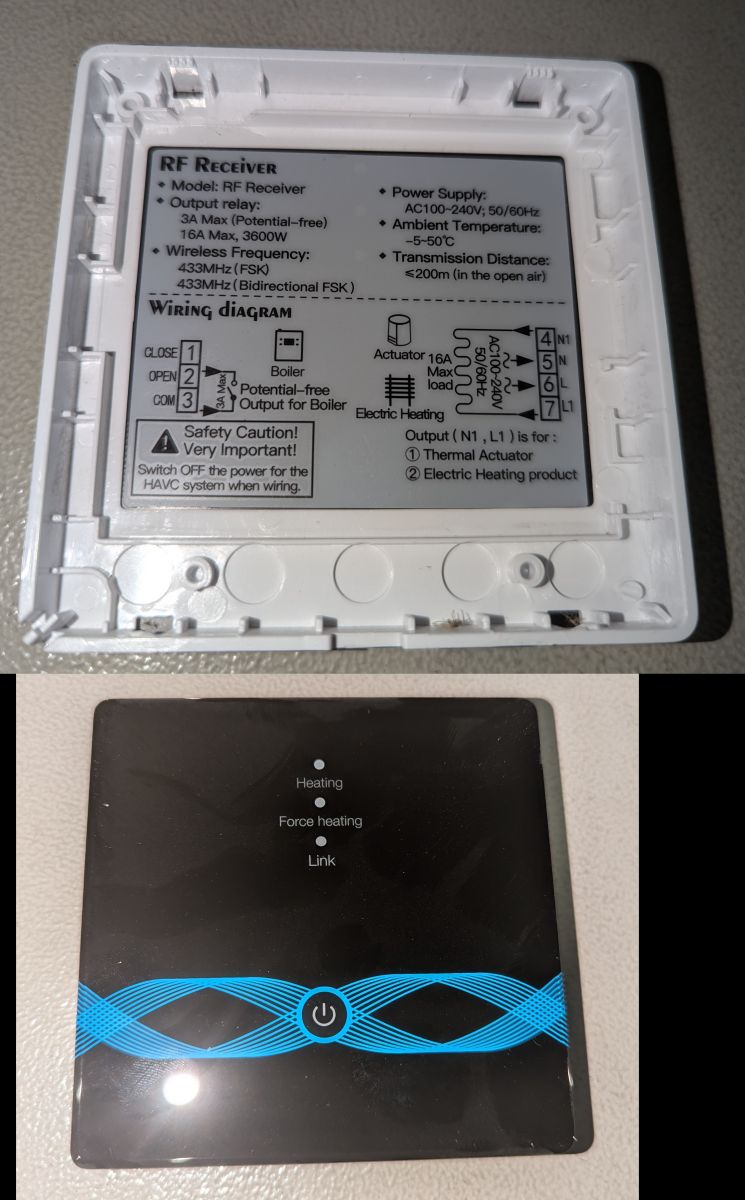

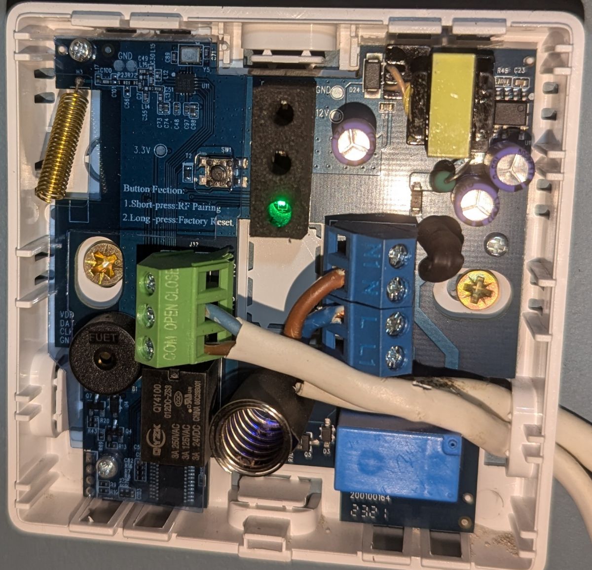

    There is one Tuya cloud device remaining at my home, and it is my thermostat. T9W 2.0 R9BW 2.0 (by EZAIOT, but possibly there are different "vendors" like SALCAR or others). Sold by the big Chinese market. It can't be controlled by LocalTuya (because of some weird protocol version), only cloud.
    My target is to make it locally controllable by flashing OpenBeken on it. I don't yet know what the chip is inside, but it seems to be at the room thermostat part. Also seems to be a TuyaMCU device (I extracted tons of dpIDs from iot.tuya.com portal, also there is a non-WiFi model which could be missing the WiFi chip entirely).
    It consists of 2 parts -
    * RF receiver part which is powered by mains power. RT-RC9PLUS 1.1_PCB v1.0 200100164
    * room thermostat with LCD screen, setting knob and WiFi, powers either by 2x AA 1.5v batteries or USB-C (or both)
    EZAIOT room thermostat with an LCD screen displaying a temperature of 21.9°C.
    The image shows the back panel of an RF receiver and the front of a room thermostat.
    RF receivers board in the picture below. There seems to be RF receiving part, relays, status LEDs, contacts COM, OPEN, CLOSE and power input. Pairing switch and some 20pin chip which has no initials on it. Doesn't seem to be any smart device, only RF receiver.
    Open RF receiver case with visible electronic components, LED, and connectors.
    More will follow!

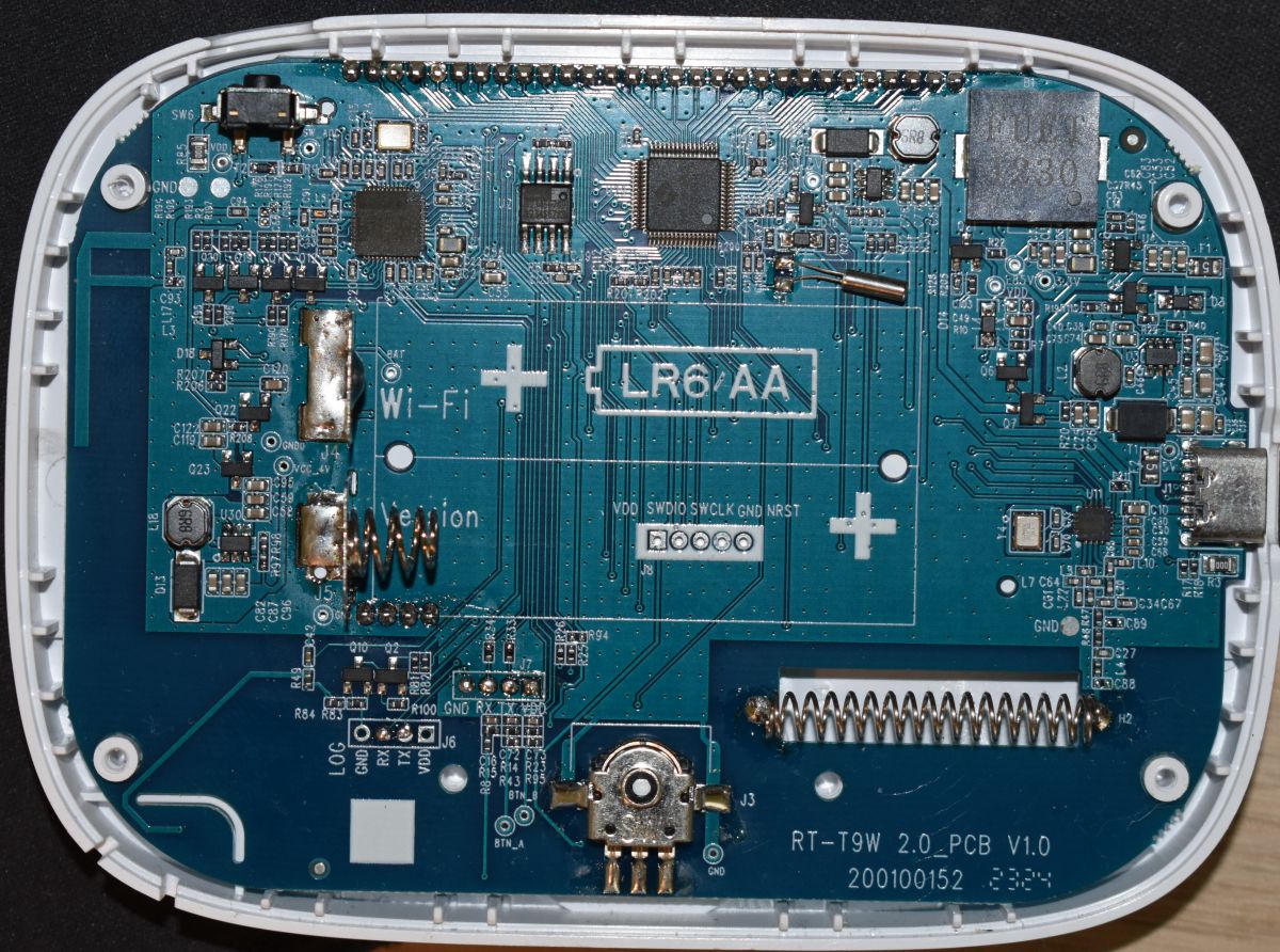

    Added after 1 [hours] 2 [minutes]:

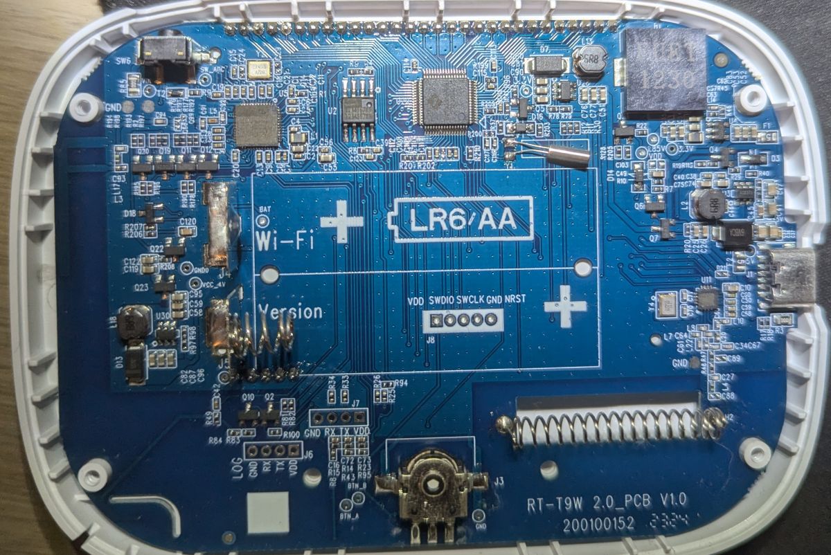

    The thermostat board looks like this:
    Circuit board with integrated circuits, battery springs, and connectors.
    On the other side is the LCD screen and not much else. The main WiFi chip looks to be the 48pin chip to the left. Is it some ESP32 variant? ESP-WROOM-03 perhaps? The board config looks similar to that. I also read the progress you are doing with OpenESP! Great work!
    Then there is BAT32G127GH 232101T, which looks to be some kind of LCD controller/MCU. Then there is some unmarked 8pin chip.
    Also 48pin LGA chip and 8pin SOIC chips have their labels removed and 123456789 can be seen printed on them.
    Any thoughts?
    Also there are 2 serial ports, one marked "LOG" and another to the right of it. And some pins (VDD,SWDIO,SWCLK,GND,NRST) right on the bottom of the battery place.

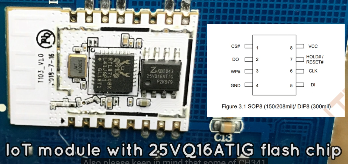

    There is at least one more Realtek with external flash chip. I saw it when making CH341 video:
    https://www.youtube.com/watch?v=z9uLPo9QAY8&t=81s
    IoT module with 25VQ16ATIG flash chip on a circuit board with a connection diagram.
    RTL8710BX + 25VQ16ATIG

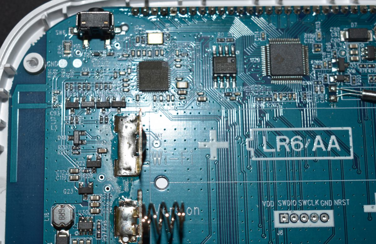

  • #10 21443456
    groove6j
    Posts: 50
    Rate: 13
    insmod wrote:
    Usually flash is about 4mb in DN devices, but in some devices it can be 8mb
    You mean the SOIC8 flash or the integrated flash in the chip? When entering flash mode which flash is read? Or maybe both are used? Sorry, I haven't learned about these chips much yet. It would even be easier for me to read the SOIC flash by clip or by desoldering.
    I also wonder what purpose there is for the Realtek MCU. I hope RF transmitting and RF pairing is done within the other MCU and Realtek chip only does the data receiving from the MCU and does the WiFi part.
    In the other case, it might be difficult to reprogram pairing stuff etc... That sounds pretty problematic for me :D

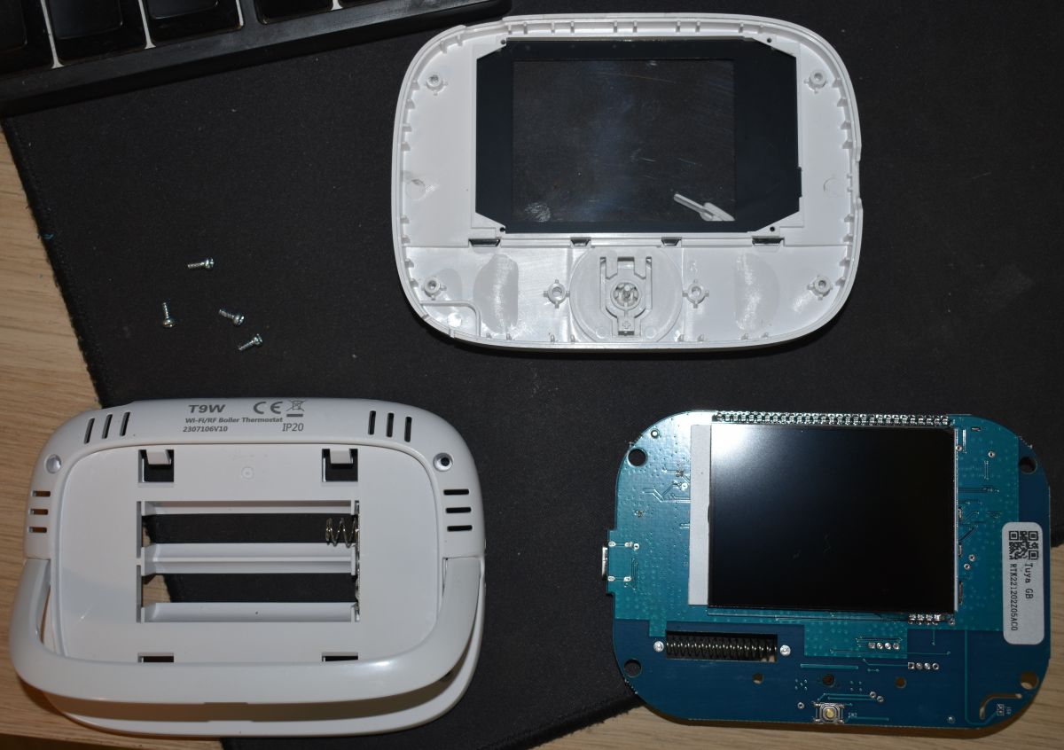

    And I took some better pictures. Maybe it will be easier to determine the chips.
    Disassembled T9W thermostat with visible internal components.
    Printed circuit board with various electronic components, including a space for LR6 AA batteries.
    Image of a circuit board with visible chips and electronic components.

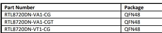

  • #11 21443701
    Posts: 5027
    Help: 438
    Rate: 891
    12 legs per side? QFN48? RTL8720DN is 48...
    Table with part numbers RTL8720DN and package type QFN48.

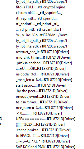

    Posts: 5027
    Help: 438
    Rate: 891
    getting this looping on RTL8720DN
    could it be RTL8721D?
    Screenshot of system code with errors related to RTL8721D.
  • #18 21444067
    groove6j
    Posts: 50
    Rate: 13
    >>21444049
    Yes, a lot of references of RTL8721D.
    This device communicates over 433MHz RF (Bidirectional FSK). I found some references to that in the dump. Wondering if this chip supports RF comms natively or relies on the other MCU.
    The flash size was 4MB, right?
    #19 21444230
    Posts: 5027
    Help: 438
    Rate: 891
    seems to be. cut the 8mb file in half and the two halves are identical
    Added after 29 [minutes]:
    >>21444049
    maybe not. the BW16E/RTL8720DN dev board firmware comes full of RTL8721D references too

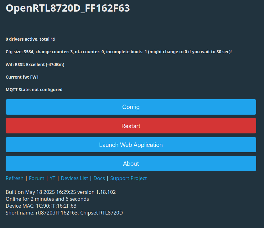

  • #26 21553227
    groove6j
    Posts: 50
    Rate: 13
    >>21553080
    Yes it works. I had to use the Windows tool, python script failed with wrong checksums after write.
    Configuration panel of the OpenRTL8720D device with large buttons for config, restart, and launching the web application.
    But when I disconnect my UART adapter, then it boots the stock firmware. When I connect UART, then it boots OpenRTL8720D. I can tell, because the display lights all the pixels when OpenRTL8720D is booted.

  • #28 21553239
    groove6j
    Posts: 50
    Rate: 13
    >>21553231
    Both slots are definitely not flashed. Ok, I'll try performing OTA.
    Yup - every time when the GND, TX and RX pins are connected to my FTDI adapter, it boots OpenRTL8720D, screen shows all pixels (like a screen test) and web-ui etc works.
    When it is disconnected, then temp. display works and there is no sign of OpenRTL8720D - no hotspot, no wifi connection.
    A guess now - the screen needs to be initialized somehow, maybe setting some DPids to some value? When the stock FW initializes, there are the same screen test, but after a second it initializes fully.
    update:
    OTA:
    Info:CMD:[WebApp Cmd 'loglevel 3' Result] OK
    Info:OTA:Current firmware index is 1
    Error:OTA:Get OTA header failed
    Error:OTA:OTA failed
    BTW when booting without serial adapter, it shows 02 in screen corner (it is usual behaviour), probably means that the FW2 is booted. How can I flash the other slot? I think that it boots FW1 when TX or RX is high at boot.
  • #29 21553285
    insmod
    Posts: 1388
    Help: 164
    Rate: 432
    That's not how it's supposed to work.
    Btw, what image are you using for ota? I just now used that one and it worked fine: https://github.com/openshwprojects/OpenBK7231...wnload/1.18.102/OpenRTL8720D_1.18.102_ota.img
    Perhaps try to add 'startdriver tuyamcu' to either autoexec.bat or startup command
    Added after 3 [minutes]:
    And just to be sure, are you powering the board via VDD pin? If so, remove it and leave just GND and TX.
  • #30 21553289
    groove6j
    Posts: 50
    Rate: 13
    I used the same file. I also tried OpenRTL8720D_1.18.101_ota.img . I tried both uploading it to webapp and pasting the link into the OTA page. Nothing - it doesn't do it at all.
    Already did that, nothing changed.
    Added after 4 [minutes]:
    Yeah, via VDD. Ok, I'll try right away.
    Added after 6 [minutes]:
    Okay. It boots the stock firmware. If I connect RX too, the same.
    I can boot FW1 when I connect GND, RX, TX and VCC. (which is OpenRTL8720D)
    Update:
    OTA worked from Chrome, from Firefox it somehow didn't work. Now when booted it shows that it's FW2 in OpenRTL8720 homepage. But still the old firmware boots when I remove VCC.
