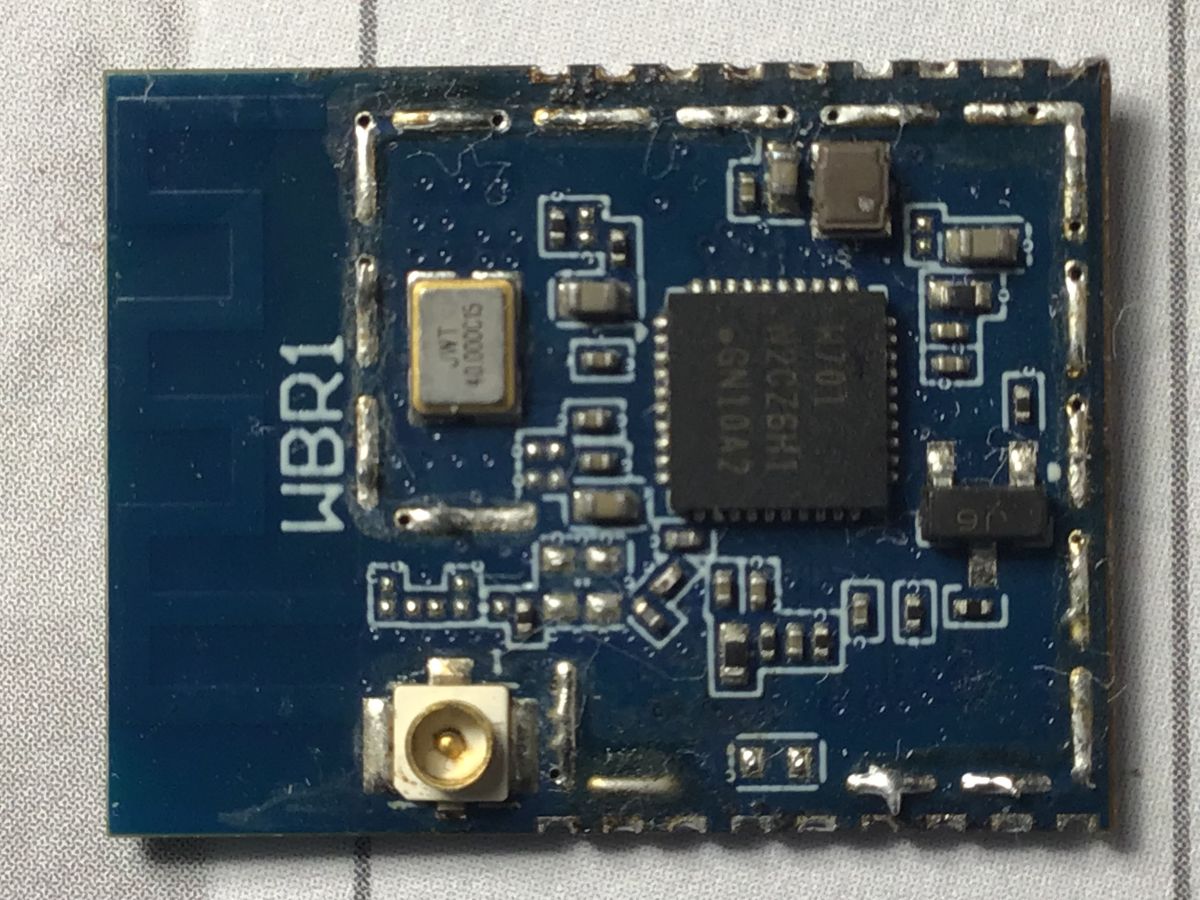

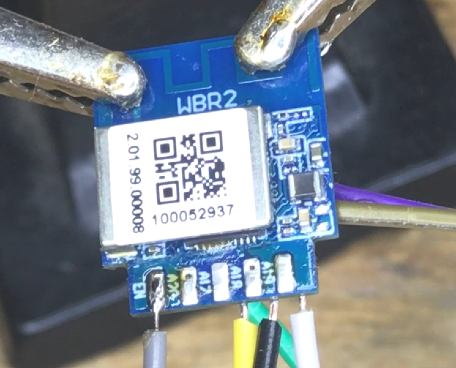

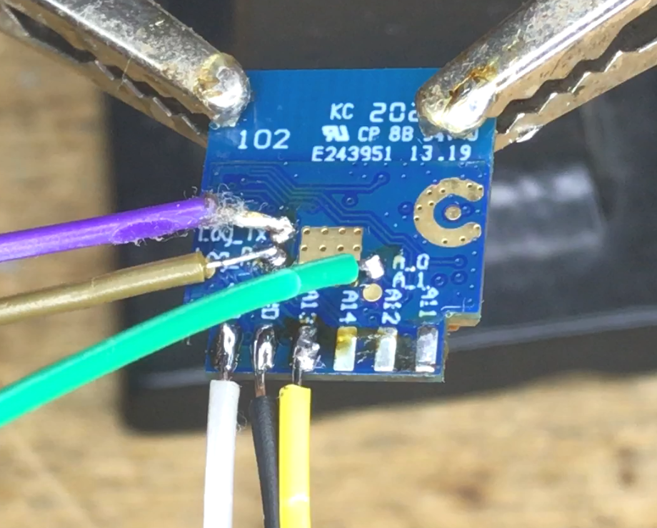

  • WBR2 module with wires connected to the pins

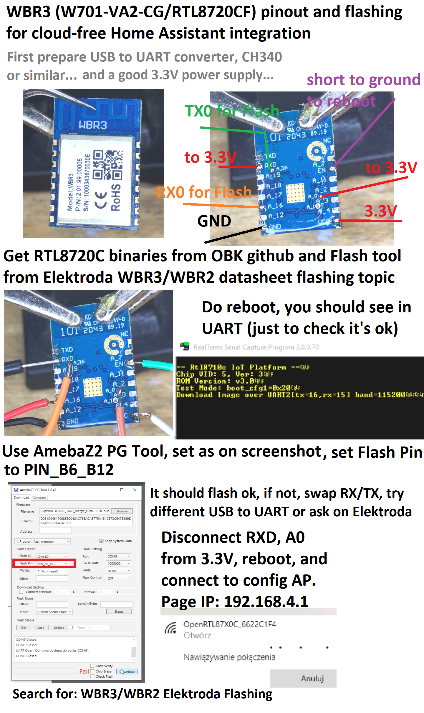

    Here's step by step flashing and HA Discovery guide for W701-VA2-CG (RTL8720CF)-based Tuya modules that can be programmed with AmebaZ2 PG Tool 1.2.47 (download included). This way you can run those devices cloud free, use it with Tasmota commands (Tasmota Remota app), and add new features like sensors, scripts, and so on.
    This guide is applicable to the following modules with the core chip of RTL8720CF or similar, so: WBR1, WBR2, WBR3, WBR2L, WBR3L, WBRU etc.

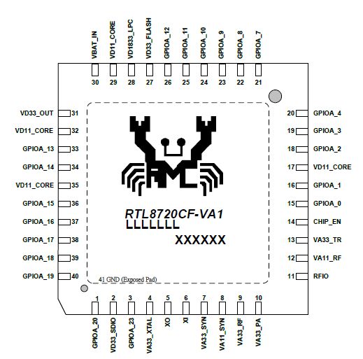

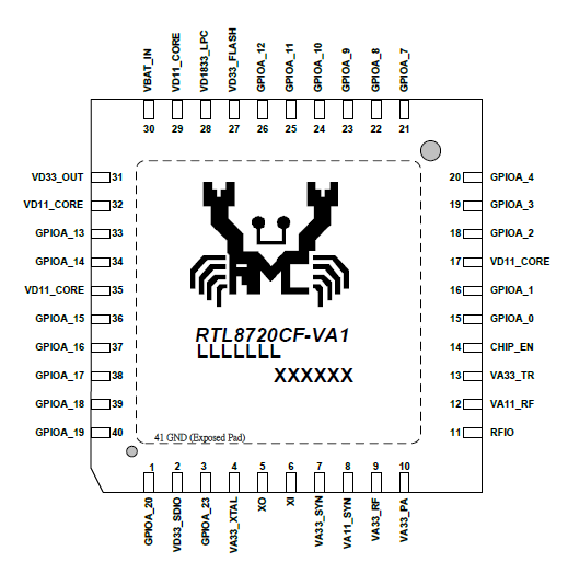

    Pin diagram of RTL8720CF-VA1 chip

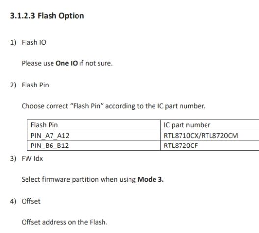

    Datasheet:
    RTL872xZ2 ...asheet.pdf (1.99 MB)You must be logged in to download this attachment.

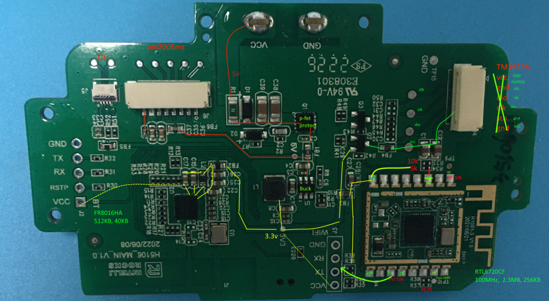

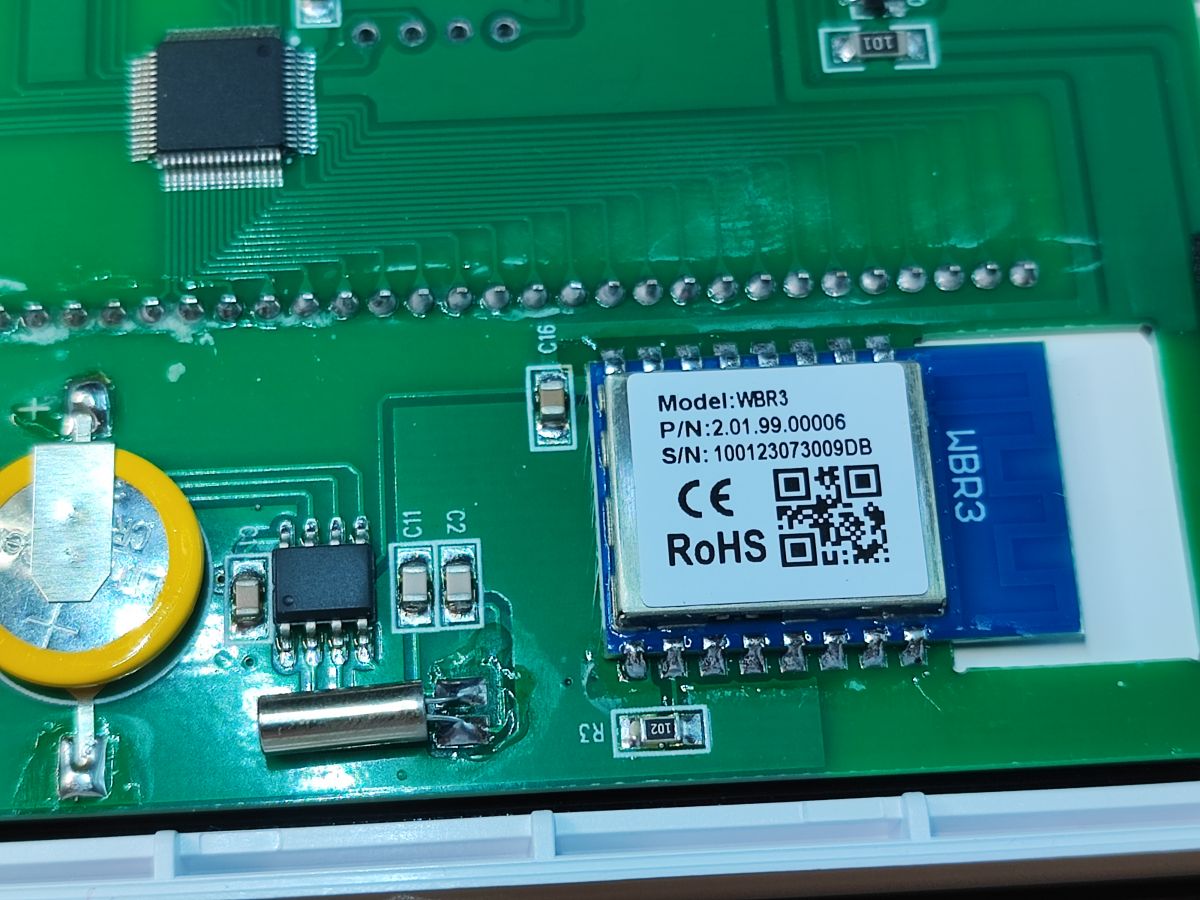

    See sample device teardown with WBR2: [WBR2/W701] Unsupported MaxCom Smart Breaker SHSB111W10

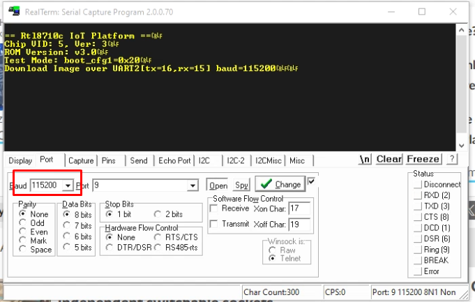

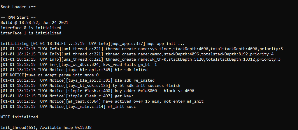

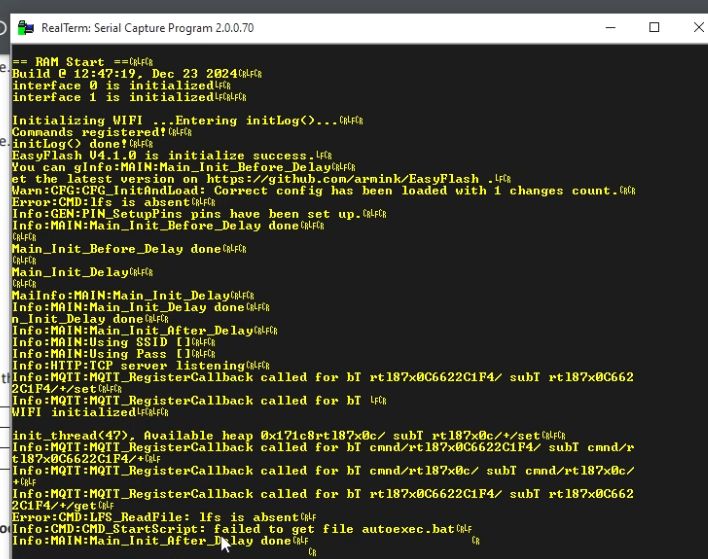

    Here is a sample boot log taken from Log UAR T pins of similar device:
    == Rtl8710c IoT Platform ==
    Chip VID: 5, Ver: 3
    ROM Version: v3.0
    Test Mode: boot_cfg1=0x20
    Download Image over UART2[tx=16,rx=15] baud=115200
    Chip VID: 5, Ver: 3
    ROM Version: v3.0
    == Boot Loader ==
    Dec  5 2019:14:02:18
    fwx SELE[fffffffe]
    fw SELE Bitidx 1, fw1 valid 1, sn 100, fw2 valid 1, sn 101
    fw2 USE, return sn 101
    Boot Loader <==
    == RAM Start ==
    Build @ 14:44:45, Jul 29 2020
     Create Task init, stack 0x1000fb28, len 5120
     Create Task app_init, stack 0x10010f88, len 8192
     Create Task IDLE, stack 0x10012fe8, len 768
     Create Task Tmr Svc, stack 0x10013640, len 2048
     Create Task TCP_IP, stack 0x10013fb8, len 4000
    interface 0 is initialized
    interface 1 is initialized
    In[01-01 18:12itializing :15 TUYA InfWIFI ...o][mqc_app.c:175] mqc app init ...
     Create Task sys_timer, stack 0x1001a800, len 4096
     Create Task cmmod, stack 0x1001eca8, len 4096
    [01-01 18:12:15 TUYA Info][sf_mqc_cb.c:42] register mqc app callback
    [01-01 18:12:15 TUYA Debug][mqc_app.c:118] mq_pro:5 mqc_handler_cnt:1
    [01-01 18:12:15 TUYA Debug][mqc_app.c:118] mq_pro:31 mqc_handler_cnt:2
    [01-01 18:12:15 TUYA Debug][log_seq.c:732] read from uf. max:0 first:0 last:0
    [01-01 18:12:15 TUYA Debug][svc_online_log.c:288] svc online log init success
     Create Task wk_th-0, stack 0x10023e18, len 5120
    [01-01 18:12:15 TUYA Err][tuya_ws_db.c:314] kvs_read fails gw_bi -1
    [01-01 18:12:15 TUYA Err][ws_db_gw.c:111] gw base read fails -935
    [01-01 18:12:15 TUYA Debug][tuya_bt_sdk.c:89] ty bt cmmod register finish 1
    [01-01 18:12:15 TUYA Notice][tuya_ble_api.c:301] ble sdk inited
    [01-01 18:12:15 TUYA Debug][tuya_hal_bt.c:1047] tuya_hal_bt_port_init
    [01-01 18:12:15 TUYA Debug][uni_thread.c:215] Thread:sys_timer Exec Start. Set to Running Status
    [01-01 18:12:15 TUYA Debug][uni_thread.c:215] Thread:cmmod Exec Start. Set to Running Status
    [01-01 18:12:15 TUYA Debug][uni_thread.c:215] Thread:wk_th-0 Exec Start. Set to Running Status
     Create Task rtw_recv_tasklet, stack 0x10025328, len 5936
     Create Task rtw_xmit_tasklet, stack 0x10026b68, len 1024
     Create Task rtw_interrupt_thread, stack 0x10027078, len 1024
     Create Task cmd_thread, stack 0x10027588, len 2048
    WIFI initialized
    init_thread(55), Available hea
     Createp 0x16be0 Task trace_task, stack 0x10027ef8, len 512
     Create Task UpperStackTask, stack 0x100287c8, len 3072
     Create Task HCI I/F, stack 0x1002b2b0, len 2048
    BT BUILD Date: Jul 29 2020, 16:17:09
    BT RESET LOG...
    [01-01 18:12:15 TUYA Debug][tuya_hal_wifi.c:575] read wifi mac:38:1f:8d:39:13:c2
    [01-01 18:12:15 TUYA Notice][tuya_hal_bt.c:893] BLE MAC: 0x38-0x1f-0x8d-0x39-0x13-0xc2
     Create Task tuya_bt_main_task, stack 0x1002c3d8, len 2560
    BT Reset ok
    bt_iqk_efuse_valid: has data
    hci_tp_phy_efuse[0]=0,
    bt_dump_iqk:    DUMP,
    the IQK_xx  data is 0x127,
    the IQK_yy  data is 0x3fe,
    the QDAC   data is 0x1a,
    the IDAC   data is 0x1b,
    the QDAC2  data is 0x19,
    the IDAC2  data is 0x19,
     Create Task rtw_coex_mailbox_thread, stack 0x1000fc08, len 1024
    hci_read_rom_check: rom_version 0x0003, bt_hci_chip_id 0x0004
    BT ADDRESS:
    38:1f:8d:39:13:c2:
     WRITE  physical FLATK=tx_flatk=ff00
    We use fw_buf=1002f128, fw_len = 13a0, config_buf = 10010128, config_len= 32
    Set baudrate to 921600
    hci_tp_config:BT INIT success 7
    Start upperStack
    [01-01 18:12:15 TUYA Debug][tuya_hal_bt.c:788] tuya_bt_app_profile_callback(), service_id:255, tuya_bt_srv_id:1
    [01-01 18:12:15 TUYA Debug][tuya_hal_bt.c:338] tuya_bt_handle_io_msg(), msg_type:0
    [01-01 18:12:15 TUYA Debug][tuya_hal_bt.c:239] app_handle_gap_msg: subtype 1
    [01-01 18:12:15 TUYA Debug][tuya_hal_bt.c:72] app_handle_dev_state_evt: init state 1, adv state 0, cause 0x0
    [BLE peripheral] GAP stack ready
    [01-01 18:12:15 TUYA Debug][tuya_hal_bt.c:72] app_handle_dev_state_evt: init state 1, adv state 1, cause 0x0
    [01-01 18:12:15 TUYA Debug][tuya_hal_bt.c:72] app_handle_dev_state_evt: init state 1, adv state 2, cause 0x0
    [01-01 18:12:15 TUYA Debug][tuya_hal_bt.c:91] GAP adv start
    [01-01 18:12:15 TUYA Notice][tuya_ble_api.c:337] ble sdk re_inited
    [01-01 18:12:15 TUYA Notice][tuya_bt_sdk.c:130] ty bt sdk init success finish
    [01-01 18:12:15 TUYA Notice][tuya_main.c:396] Base firmware: rtl8720cf_tls_common_iot_config:2.1.6 compiled at Date:Jul 29 2020 Time:16:17:40
    [01-01 18:12:15 TUYA Notice][tuya_main.c:397] reset reset reason num 0
    [01-01 18:12:15 TUYA Debug][tuya_device.c:19] < TUYA IOT SDK V:1.0.12 BS:40.00_PT:2.2_LAN:3.3_CAD:1.0.2_CD:1.0.0 >
    < BUILD AT:2020_07_28_19_56_28 BY embed FOR ty_iot_wf_bt_sdk_rtos AT rtl8720cf_ameba >
    IOT DEFS < WIFI_GW:1 DEBUG:1 KV_FILE:0 SHUTDOWN_MODE:0 LITTLE_END:1 TLS_MODE:2 ENABLE_LOCAL_LINKAGE:0 ENABLE_CLOUD_OPERATION:0 ENABLE_SUBDEVICE:0 ENABLE_ENGINEER_TO_NORMAL:0 OPERATING_SYSTEM:2 ENABLE_SYS_RPC:0 TY_SECURITY_CHIP:0 RELIABLE_TRANSFER:RELIABLE_TRANSFER ENABLE_LAN_ENCRYPTION:1 ENABLE_LAN_LINKAGE:0 ENABLE_LAN_LINKAGE_MASTER:0 >
    [01-01 18:12:15 TUYA Debug][tuya_device.c:20] rtl8720cf_tls_common_iot_config:2.1.6
    [01-01 18:12:15 TUYA Notice][simple_flash.c:430] key_addr: 0x1d8000   block_sz 4096
    [01-01 18:12:15 TUYA Notice][simple_flash.c:498] get key:
    0x52 0x32 0x7c 0x62 0xcc 0x45 0x99 0xbc 0x1f 0x80 0x21 0xa7 0xfa 0x6 0xbe 0x6c
    [01-01 18:12:15 TUYA Notice][tuya_main.c:447] have actived over 15 min, not enter mf_init
    [01-01 18:12:15 TUYA Notice][tuya_uart_common_api.c:118] ty_uart_common_main_components_version:1.0.5,memrory left:67400...
    [01-01 18:12:15 TUYA Notice][uart_common.c:238] pConfig = {low_sw:close,wifi_bdrate:115200,wifi_cofig_ver:1.0.0,crc:13,}---config len:62
    [01-01 18:12:15 TUYA Notice][flash_config.c:192] ty_uart_public_iot_table_read_component_version:1.0.0
    [01-01 18:12:15 TUYA Notice][flash_config.c:160] key:wifi_cofig_ver,value:1.0.0,len:5
    [01-01 18:12:15 TUYA Notice][flash_config.c:157] key:wifi_bdrate,value:115200,len:3
    [01-01 18:12:15 TUYA Notice][flash_config.c:167] key:low_sw,value:0,len:1
    [01-01 18:12:15 TUYA Err][flash_config.c:129] json key 'flow_sw' not exist!
    [01-01 18:12:15 TUYA Err][flash_config.c:129] json key 'ir_sw' not exist!
    [01-01 18:12:15 TUYA Err][flash_config.c:129] json key 'ir_tx' not exist!
    [01-01 18:12:15 TUYA Err][flash_config.c:129] json key 'ir_rx' not exist!
    [01-01 18:12:15 TUYA Notice][uart_common.c:122] get_config_flow_sw err.
    [01-01 18:12:15 TUYA Notice][uart_common.c:138] get_config_ir_sw err.
    [01-01 18:12:15 TUYA Notice][uart_common.c:170] uart badrate:115200
    [01-01 18:12:16 TUYA Notice][uart_common.c:171] flow_open:0
    [01-01 18:12:16 TUYA Notice][uart_common.c:172] lowpower_open:0
    [01-01 18:12:16 TUYA Notice][uart_common.c:173] ir_open:0
    [01-01 18:12:16 TUYA Notice][uart_common.c:174] ir_tx:2
    [01-01 18:12:16 TUYA Notice][uart_common.c:175] ir_rx:3
    [01-01 18:12:16 TUYA Notice][tuya_uart.c:134] 0   115200
     Create Task ty_uart_task, stack 0x1002f128, len 4096
    [01-01 18:12:16 TUYA Notice][uart_common.c:748] uart_task_init ok
    [01-01 18:12:16 TUYA Notice][weather_sever.c:348] ty_uart_public_weather_component_version:1.0.0
    [01-01 18:12:16 TUYA Notice][tuya_download_file.c:630] ty_uart_public_file_download_component_version:1.0.0
    [01-01 18:12:16 TUYA Notice][tuya_download_file.c:662] file_download_init OK
    [01-01 18:12:16 TUYA Notice][tuya_uart_common_api.c:186]  tuya_uart_common_init ok,memrory left:60624...
    [01-01 18:12:16 TUYA Notice][process_server.c:110] send jump_pack
    [01-01 18:12:18 TUYA Notice][uart_common.c:631] heart timer out clear all
    [01-01 18:12:19 TUYA Notice][process_server.c:110] send jump_pack
    [01-01 18:12:21 TUYA Notice][uart_common.c:631] heart timer out clear all
    [01-01 18:12:22 TUYA Notice][process_server.c:110] send jump_pack
    [01-01 18:12:24 TUYA Notice][uart_common.c:631] heart timer out clear all
    [01-01 18:12:25 TUYA Notice][process_server.c:110] send jump_pack
    [01-01 18:12:27 TUYA Notice][uart_common.c:631] heart timer out clear all
    [01-01 18:12:28 TUYA Notice][process_server.c:110] send jump_pack
    [01-01 18:12:30 TUYA Notice][uart_common.c:631] heart timer out clear all
    [01-01 18:12:31 TUYA Notice][process_server.c:110] send jump_pack

    Yes, I know it says Rtl8710c, rtl8720c is just 8710 with bluetooth.

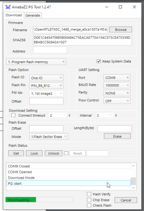

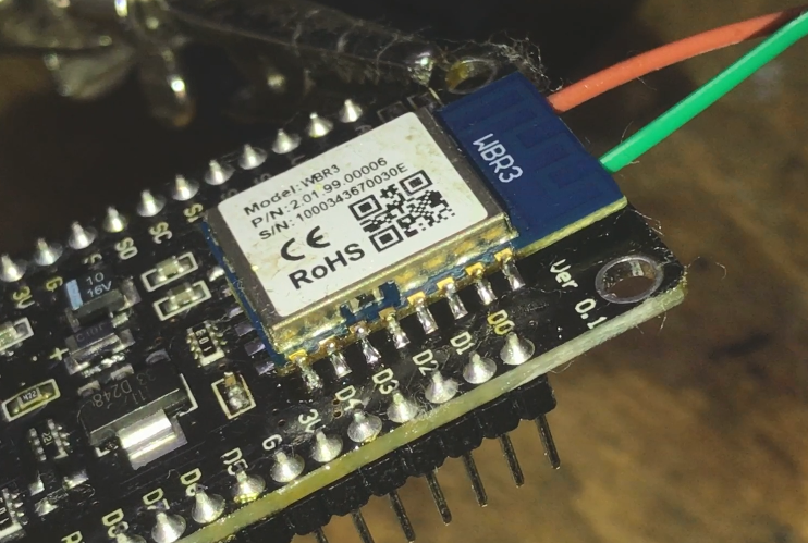

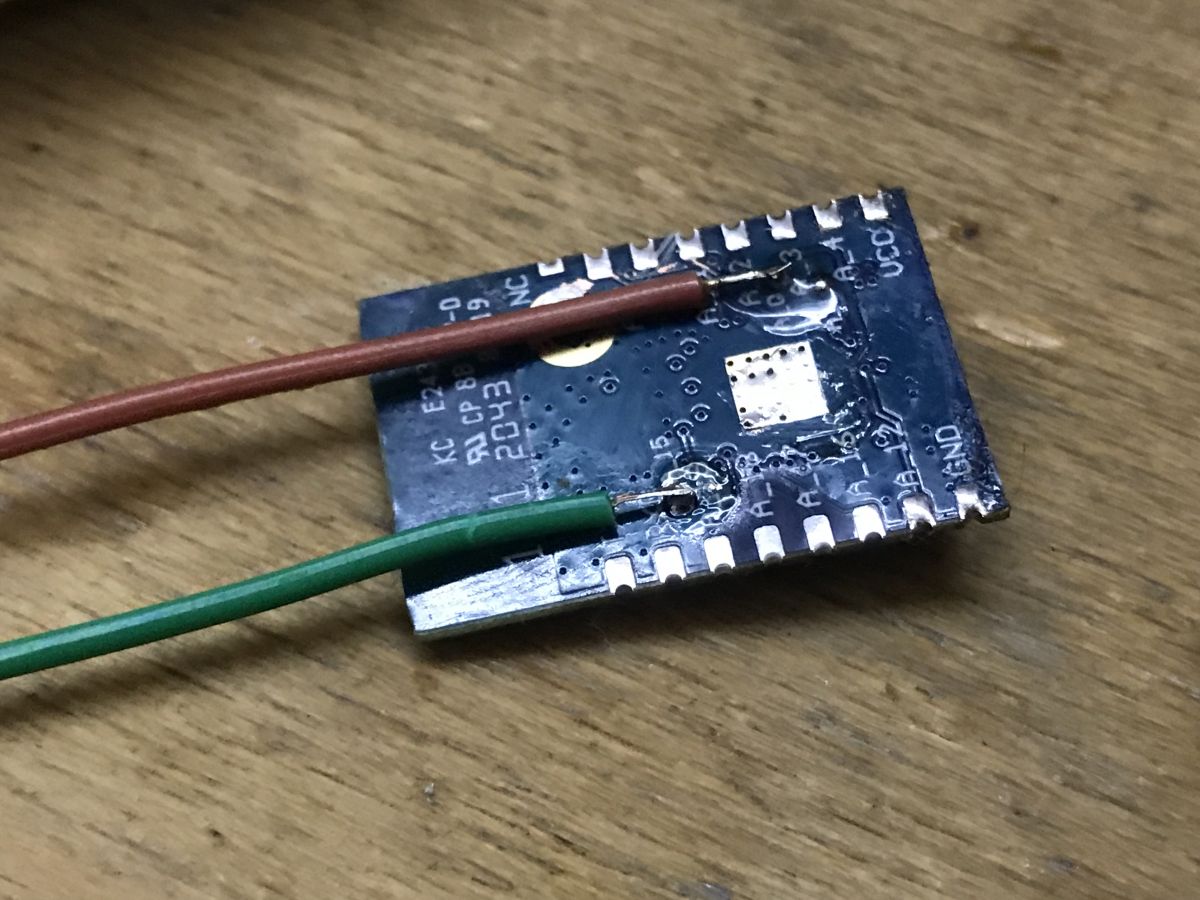

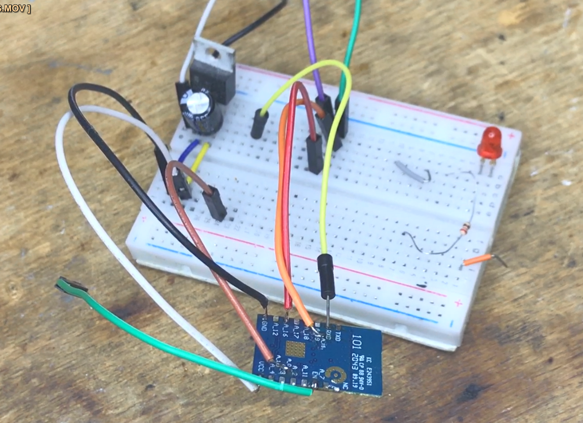

    For this guide, you will need to have some basic soldering skills and a USB to UART converter, like the CH340 one. It should have 3.3V voltage levels. So far, I've been using successfully this one for years:
    USB to UART converter with crystal and pins on the board.
    I am also often using external 3.3V LDO (like AMS1117-3.3V) as a better power supply. 3.3V directly from USB to UART may not work. The 3.3V pin on shown USB to UART converter is only used to select voltage levels.

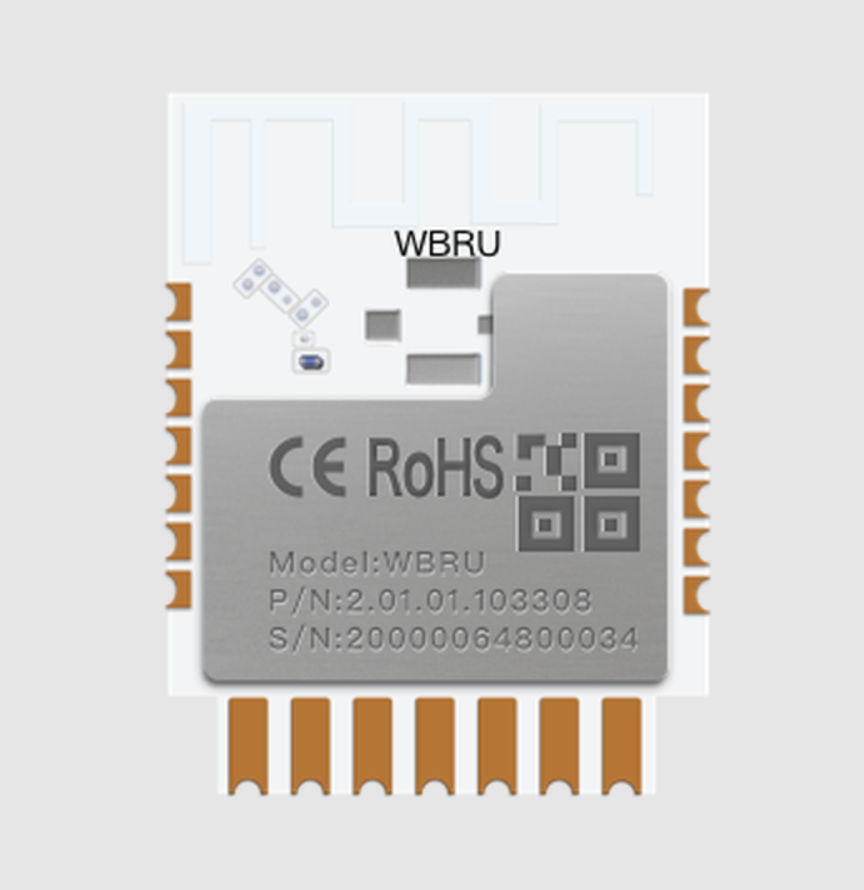

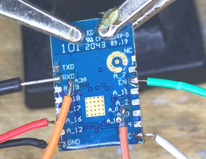

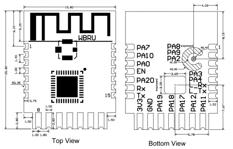

    W701-VA2-CG modules

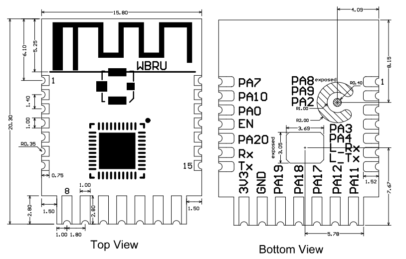

    Let's consider most popular W701-VA2-CG modules.

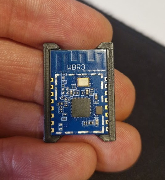

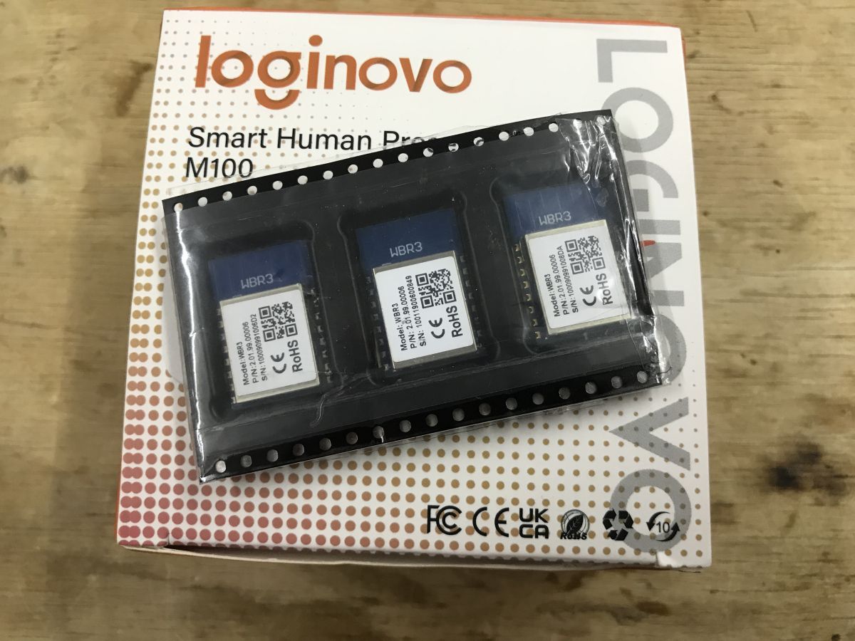

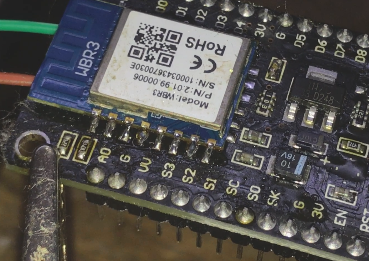

    WBR3 is a common Tuya module based on W701-VA2-CG. It has somewhat similar footprint to popular TYWE3S (ESP12) modules, so it also matches more or less with CB3S and WB3S.
    Diagram of the WBR3 module with pin labeling and top and bottom views.
    Pin numberSymbolI/O typeFunction
    1NC/The pin is pulled up to be compatible with other modules
    2A_7I/OGPIOA_7, hardware PWM, IC Pin 21
    3ENI/OEnabling pin, which works at the high level and is pulled up and controlled by a user externally
    4A_11I/OGPIOA_11, hardware PWM, IC Pin 25
    5A_2I/OGPIOA_2, hardware PWM, IC Pin 18
    6A_3I/OGPIOA_3, hardware PWM, IC Pin 19
    7A_4I/OGPIOA_4, hardware PWM, IC Pin 20
    8VCCPPower supply pin (3.3V)
    9GNDPPower supply reference ground
    10A_12I/OGPIOA_12, hardware PWM, IC Pin 26
    11A_16I/OGPIOA_16, UART_Log_TXD, which is used for displaying the module internal information and can be configured as a common GPIO
    12A_17I/OGPIOA_17, hardware PWM, IC Pin 38
    13A_18I/OGPIOA_18, hardware PWM, IC Pin 39
    14A_19I/OGPIOA_19, hardware PWM, IC Pin 40
    15RXDI/OGPIOA_13, UART0_RXD, which is used as a user-side serial interface pin
    16TXDI/OGPIOA_14, UART0_TXD, which is used as a user-side serial interface pin
    There is also A_15 (UART_Log_RXD) available on the back of the module.
    WBR3 Modul...atform.pdf (619.05 kB)You must be logged in to download this attachment.

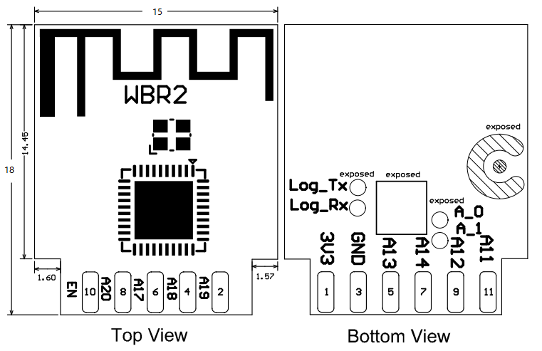

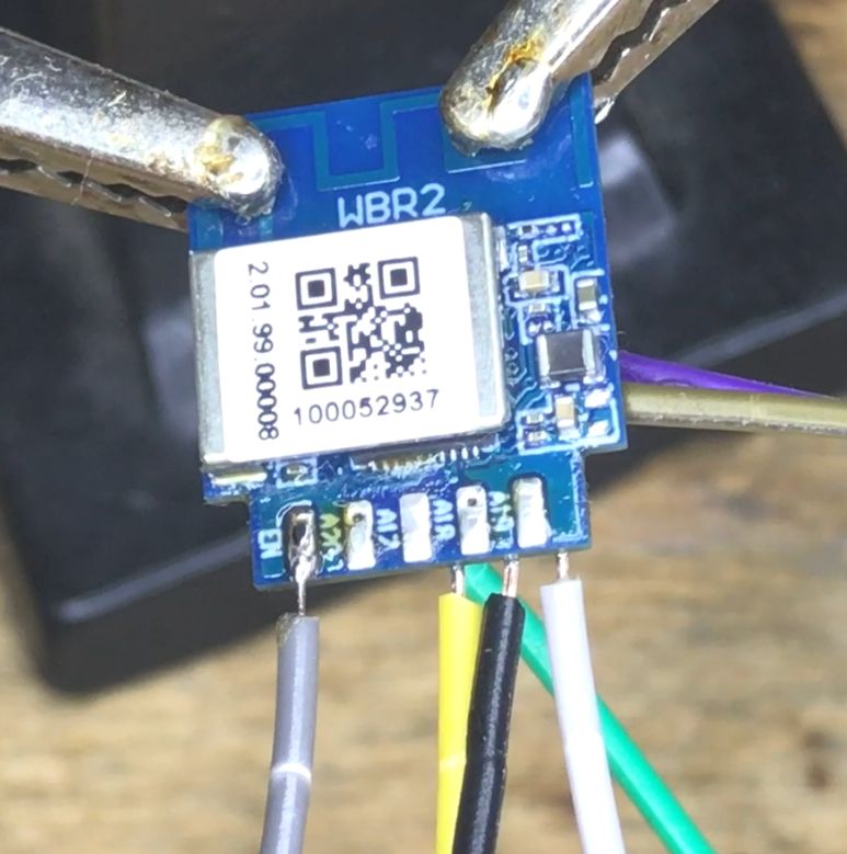

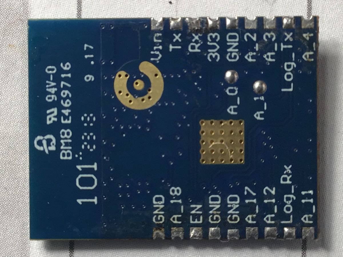

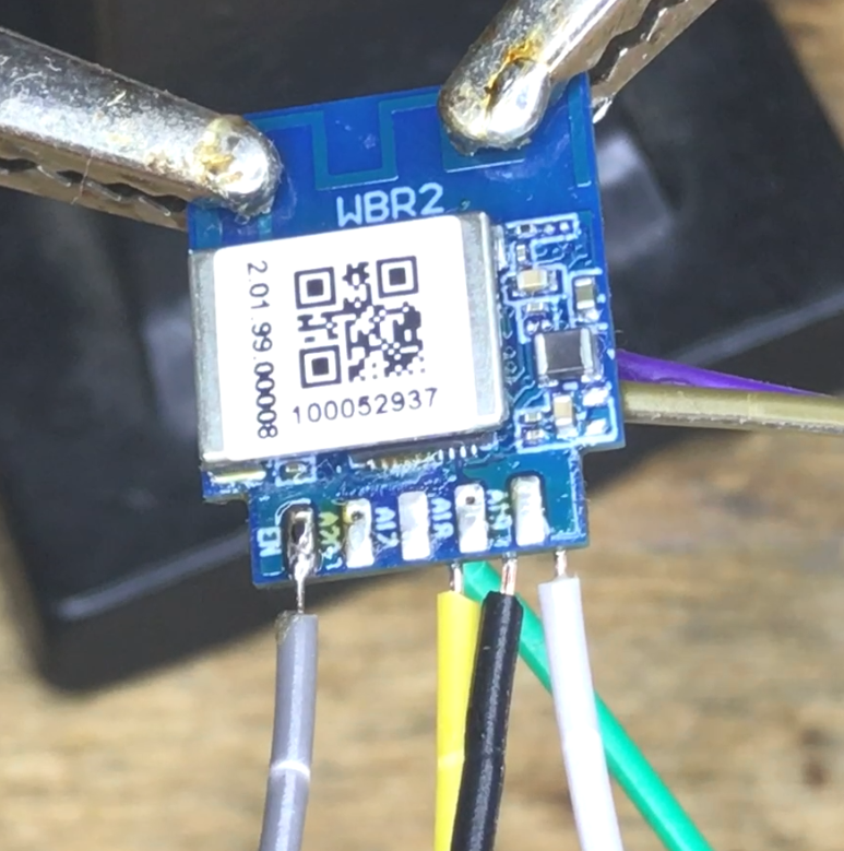

    WBR2 is a common Tuya module based on W701-VA2-CG. It has somewhat similar footprint to popular TYWE2S (ESP8266) modules, so it also matches more or less with CB2S and WB2S.
    Top and bottom view of the WBR2 module.
    Pin numberSymbolIO typeFunction
    13V3/Power supply pin (3.3V)
    2A19I/OGPIOA_19, hardware PWM, IC Pin40
    3GNDPPower supply reference ground
    4A18I/OGPIOA_18, hardware PWM, IC Pin39
    5A13I/OGPIOA_13, UART0_RXD, which is used as a user-side serial interface pin
    6A17I/OGPIOA_17, hardware PWM, IC Pin38
    7A14I/OGPIOA_14, UART0_TXD, which is used as a user-side serial interface pin
    8A20I/OGPIOA_20, common GPIO, IC Pin1
    9A12I/OGPIOA_12, hardware PWM, IC Pin26
    10ENI/OEnabling pin, which works at the high level and is pulled up and controlled by a user externally
    11A11I/OGPIOA_11, hardware PWM, IC Pin25
    There is also A_15 (UART_Log_RXD) and A_16 (UART_Log_TXD) available on the back of the module.
    WBR2 Modul...atform.pdf (581.57 kB)You must be logged in to download this attachment.
    WBRU is a common Tuya module based on W701-VA2-CG. It has somewhat similar footprint to CBU, with both UART ports available on sides.
    WBRU electronic module with CE and RoHS markings.
    Diagram of WBRU module with top and bottom view
    Pin numberSymbolII/O typeFunction
    1PA8I/OGPIOA_8, common GPIO, which can be reused as SPI_SCK and corresponds to Pin 22 of the IC
    2PA9I/OGPIOA_9, common GPIO, which can be reused as SPI_MOSI and corresponds to Pin 23 of the IC
    3PA2I/OGPIOA_2, hardware PWM, correspond to Pin 18 of the IC
    4PA3I/OGPIOA_3, hardware PWM, correspond to Pin 19 of the IC
    5PA4I/OGPIOA_4, hardware PWM, correspond to Pin 20 of the IC
    6L_RXI/OGPIOA_15, UART_Log_RXD (used to receive the external logs of the module), which can be configured as a common GPIO
    7L_TXI/OGPIOA_16, UART_Log_TXD (used to send the internal logs of the module), which can be configured as a common GPIO
    8PA11I/OGPIOA_11, hardware PWM, correspond to Pin 25 of the IC
    9PA12I/OGPIOA_12, hardware PWM, correspond to Pin 26 of the IC
    10PA17I/OGPIOA_17, hardware PWM, correspond to Pin 38 of the IC
    11PA18I/OGPIOA_18, hardware PWM, correspond to Pin 39 of the IC
    12PA19I/OGPIOA_19, hardware PWM, correspond to Pin 40 of the IC
    13GNDPPower supply reference ground
    14VCCPPower supply pin (3.3V)
    15TXI/OGPIOA_14, UART0_TXD (user serial interface)
    16RXI/OGPIOA_13, UART0_RXD (user serial interface)
    17PA20I/OGPIOA_20, common GPIO, correspond to Pin 1 of the IC
    18ENI/OEnabling pin, active at the high level. The module has been pulled to the high level and the user can control the pin externally
    19PA0I/OGPIOA_0, not recommend to pull it to the high level. If it is pulled to a high level, it will enter the test mode. Correspond to Pin 15 of the IC
    20PA10I/OGPIOA_10, common GPIO, which can be reused as SPI_MISO and corresponds to Pin 24 of the IC
    21PA7I/OGPIOA_7, common GPIO, which can be reused as SPI_CS and corresponds to Pin 21 of the IC
    WBRU Modul...atform.pdf (963.69 kB)You must be logged in to download this attachment.
    NOTE: A_15 (UART_Log_RXD) and A_16 (UART_Log_TXD) are used as debug log output and as flashing port. A_13 (UART0_RXD) and A_0 must be pulled high to enable bootloader.

    Flashing guide

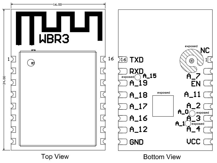

    Those WBR3/WBR2 modules are strange, in case of WBR3 you need to access pin from under module. You can desolder it with hot air.
    You need to connect:
    - GND and 3.3V to a good 3.3V power supply
    - A_16 to USB to UART RX
    - A_15 to USB to UART TX (it's on module back)
    - RXD and A0 to 3.3V (to enable bootloader mode)
    To reset module, connect EN to ground (it's like RESET, CEN pin)
    This is how it looks like for WBR3:
    Close-up of Tuya W701-VA2-CG module with soldered wires.
    And for WBR2:
    - LOG_TX to USB to UART RX
    - LOG_RX to USB to UART TX (it's on module back)
    - A13 (RXD) and A0 to 3.3V (to enable bootloader mode)
    Tuya module with soldered wires for flashing
    Tuya WBR2 module with connected wires for flashing.
    Here is my setup, as you can see I am using TC1264 (similar to AMS1117-3.3V) LDO for power supply:
    Breadboard with connected wires and a module.

    Now, if you run any UART to USB converter, you should be able to see this message after doing reboot (shorting EN to ground for a moment):
    RealTerm program showing UART connection settings.

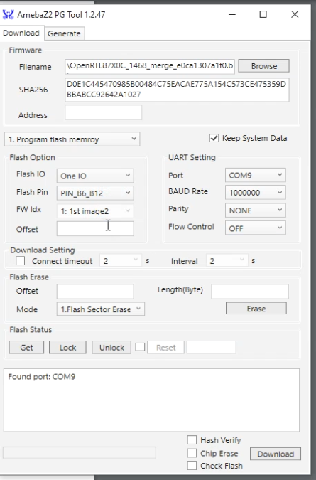

    Now you can use AmebaZ2 PG Tool 1.2.47:
    User interface of the AmebaZ2 PG Tool 1.2.47 for programming.
    Set Flash Pin as in Docs:
    Flash options for Tuya modules with flash pin selection
    Start flashing:
    User interface of the AmebaZ2 PG Tool 1.2.47 during flashing.
    Remember that you need to disconnect booting pins from 3.3V (all except 3.3V pin itself) and reboot in order for new firmware to start.
    To sum up - flashing infographics, WBR3:
    Guide for connecting and flashing WBR3 (W701-VA2-CG/RTL8720CF) module for Home Assistant integration.
    WBR2:
    Guide for flashing WBR2/RL8720CF modules.

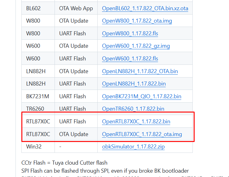

    Binaries and flash Tool download
    Get binaries from our repository:
    Navigate to Releases tab:
    https://github.com/openshwprojects/OpenBK7231T_App/releases
    Binaries are marked as RTL87X0C, OpenRTL87X0C, they should run on RTL8710C/RTL8720C:

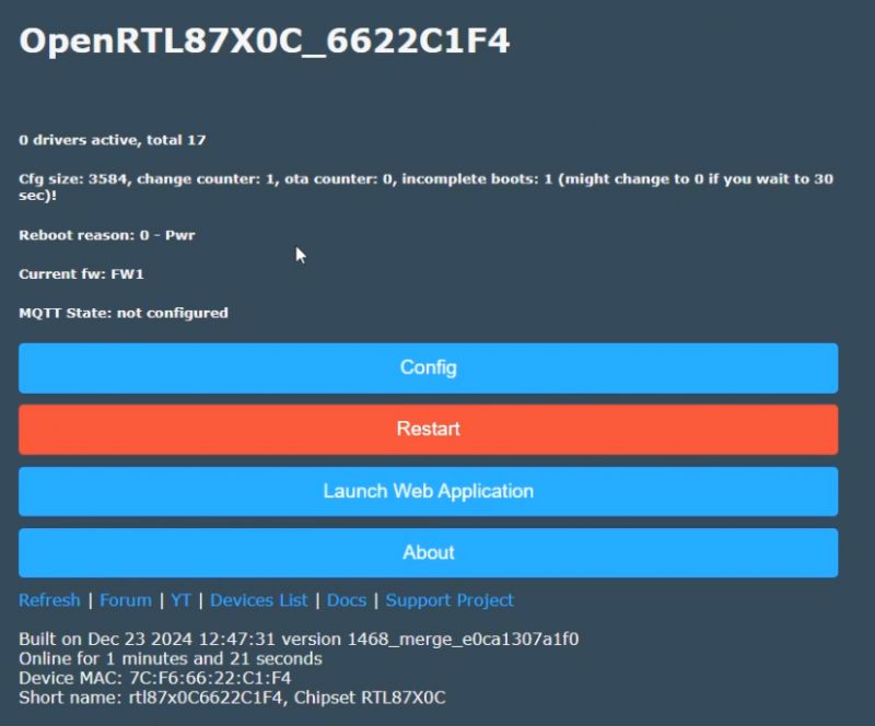

    First configuration
    So now you have flashed your device and disconnected pulled up signals from 3.3V. Of course, the main 3.3V pin still should be connected, because your device needs power. Short EN to ground to reboot. Then first thing to check is the UART log output. It should print OBK log correctly:
    Screenshot from RealTerm showing boot log of an IoT module.

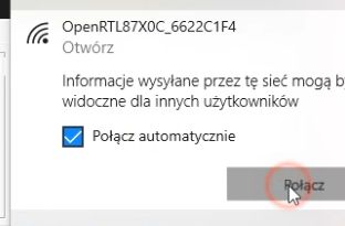

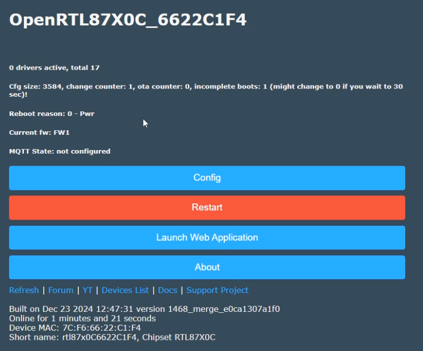

    OBK access point should appear:
    Wi-Fi network connection window for OpenRTL87X0C
    Connect to this AP and go to 192.168.4.1:
    OpenRTL87X0C configuration interface

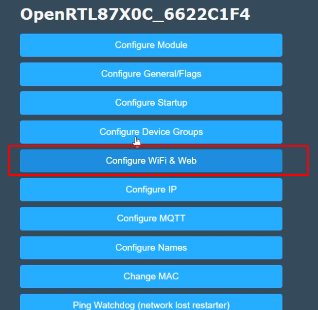

    Go to config, WiFi:
    OpenRTL87X0C configuration interface with Configure WiFi & Web highlighted

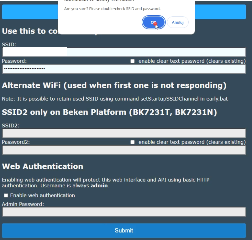

    Configure your WiFi SSID/password there.
    Device will reboot and connect to your network. You can use your router DHCP clients list to discover new device IP.
    Popup window asking to confirm SSID and WiFi password.

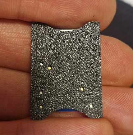

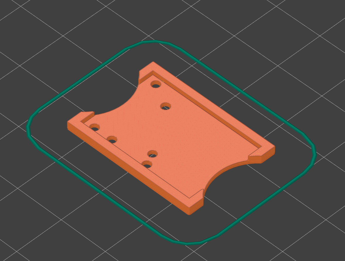

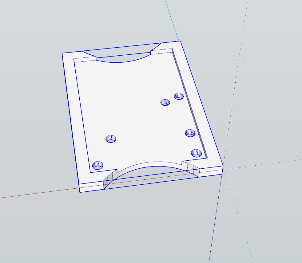

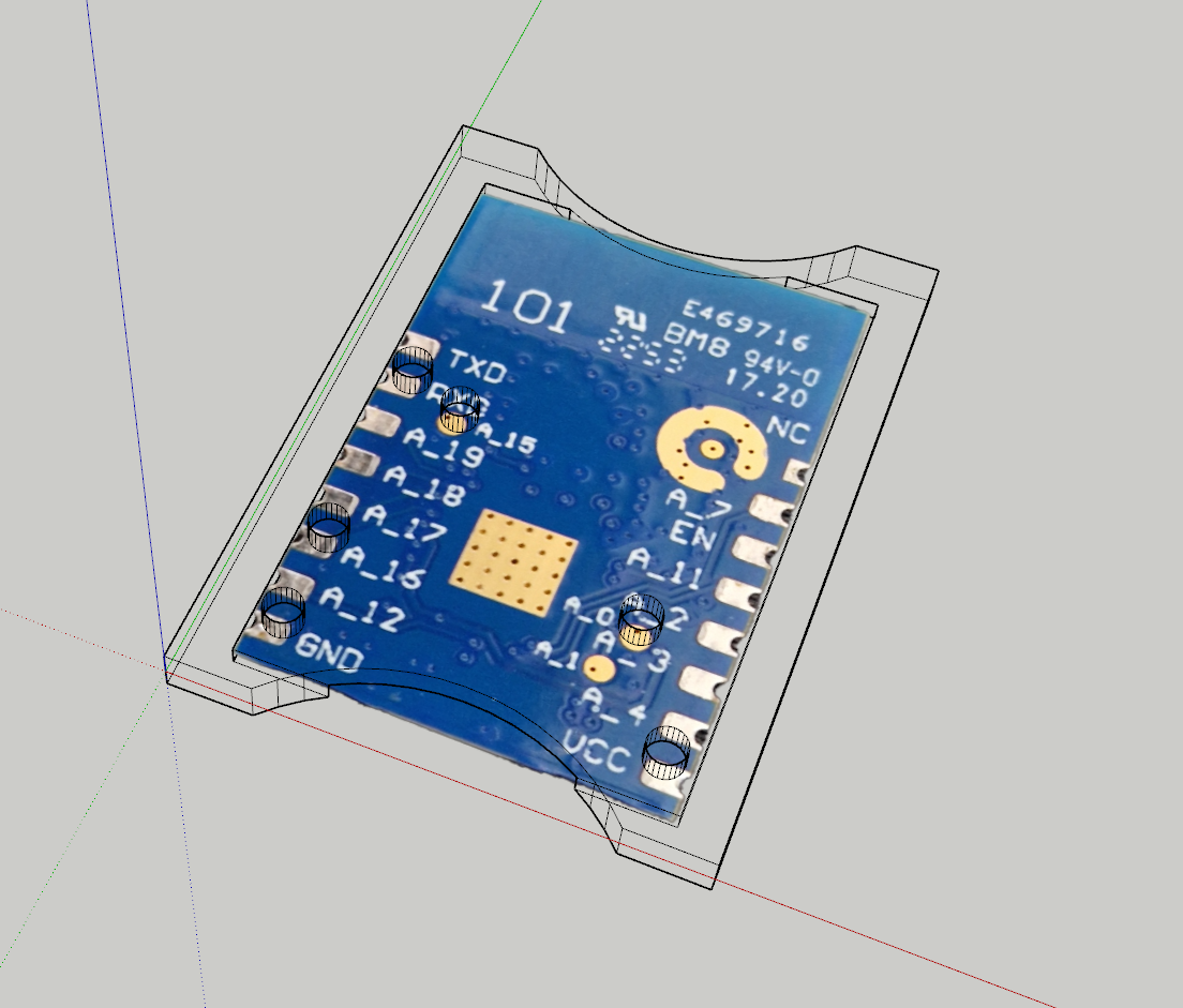

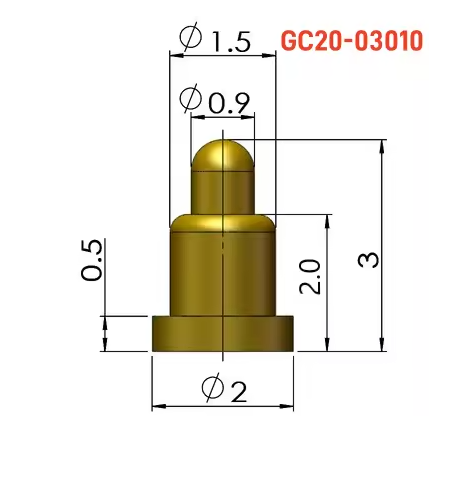

    Here is a quick preview of the flashing jig for WBR3 modules that is being in the works now.
    View of the WBR3 electronic module with pin markings.
    3D model for flashing WBR3 modules
    3D model of a case with holes on a grid.
    WBR3 module held in hand.
    WBR3 module held in hands with visible pins.
    I am planning of using these pins for it that can be found here - https://www.aliexpress.com/item/4001036082221....order_list.order_list_main.11.71c91802RZ11DZ
    Schematic drawing of pin GC20-03010 with dimensions in millimeters.
    Once completed all files will be available here to download.

    Help: 654
    Rate: 12614

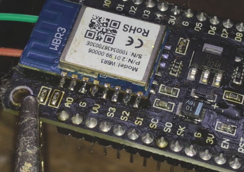

    Very interesting idea, I wonder how reliable it will be.
    I've recently started working on a simple NodeMCU to WBR3 hack, and it seems to turned out well. I've managed to solder WBR3 with a two wires for flashing below it:
    WBR3 module with two soldered wires on a wooden surface.
    WBR3 module soldered onto a board using two wires.
    Close-up of an electronic module with a soldered WBR3 chip and connected wires.
    Now, flashing it via UART does not work currently, but we have OTA, and maybe I could just lift CH340 traces and connect them to correct UART port?
    I hope to receive more WBR3 modules soon from a reader, so it might be worth to try it.

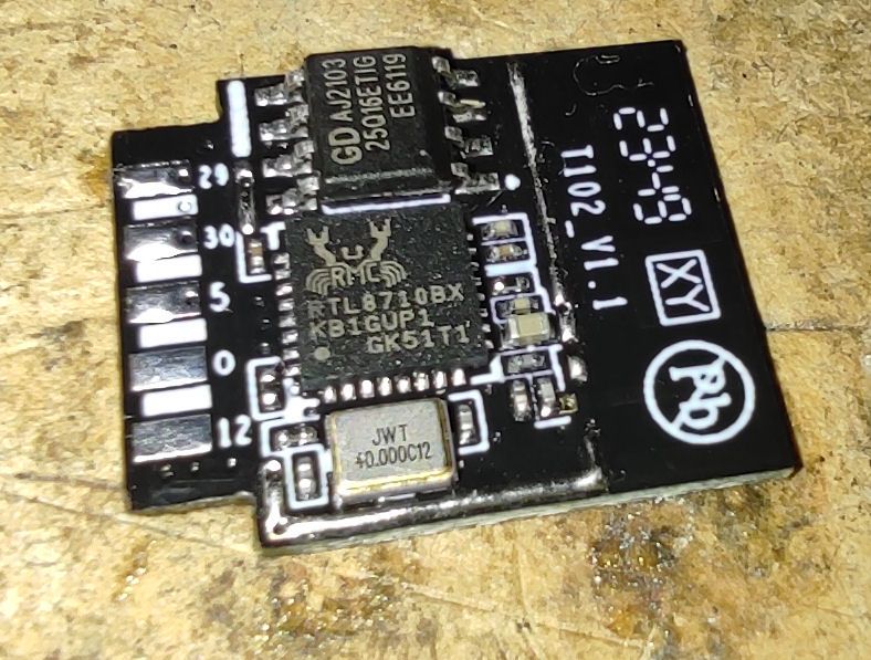

    WBR3 is an interesting module. BW15 and vanilla RTL8720CFs (the one I have anyway) only require PA0 to be pulled to 3.3V.
    I am lead to believe that WBR3s have, as seen in your boot log
    whereas
    is seen in non-Tuya RTL8720CF modules. It'd be good to see this confirmed (or debunked) in future captures of boot logs from other devices/WBR3s
    With PA0 high and PA13 low for me on BW15 this is the output. Some other boot mode.
    Added after 56 [minutes]:
    I lifted the table from here and added Modules/Other Names column because I was losing track of what was what. It's a work in progress. Perhaps DM me for anything wrong/missing and I'll fix.
    RTL P/NSeriesBLProtocolCPUMhzSRAMBTUARTSPII2SADC/DACModules/Other Names
    RTL8710BNAmeba ZRTL8195AWiFiARM M4125M258KB-11NY/NW302/T103_V1.0, T112_V1.1, WR1, WR1-IPEX, WR2, WR2, WR2E, WR3, WR3E, WR4, WR5E
    RTL8710BXAmeba ZRTL8195AWiFiARM M462.5M256KB-11NY/NWR3L, WR3LE, BW12, BW14, T102_V1.1
    RTL8710CXAmeba Z2WiFiARM M4100M256KB-31NN/N
    RTL8710CMAmeba Z2WiFiARM M4100M256K+4M-31NN/N
    RTL8720CNAmeba Z2WiFi+BLE4.2ARM M4100M256KBBle4.221NN/N
    RTL8720CFAmeba Z2RTL8710CWiFi+BLE4.2ARM M4100M256KBBle4.221NN/NW701-VA2-CG, WBR2, WBR3, WBRU, W701H, BW15
    RTL8720CMAmeba Z2WiFi+BLE4.2ARM M4100M256KBBle4.221NN/N
    RTL8720CSAmeba CSWiFi+BLE5 MeshM0+M4200M512KBBle5.0 mesh22YY/Y
    RTL8721CSMAmeba CSWiFi+BLE5 MeshM0+M4200M512K+4MBle5.0 mesh32YY/Y
    RTL8722CSMAmeba CSWiFi+BLE5 MeshM0+M4200M512K+4MBle5.0 mesh42YY/Y
    RTL8720DNAmeba D2.4G+5G+BLE5M0+M4200M512KBle5.0 mesh21YY/YW701D, BW16
    RTL8721DMAmeba D2.4G+5G+BLE5M0+M4200M512K+4MBle5.0 mesh32YY/Y
    RTL8722DMAmeba D2.4G+5G+BLE5M0+M4200M512K+4MBle5.0 mesh42YY/Y

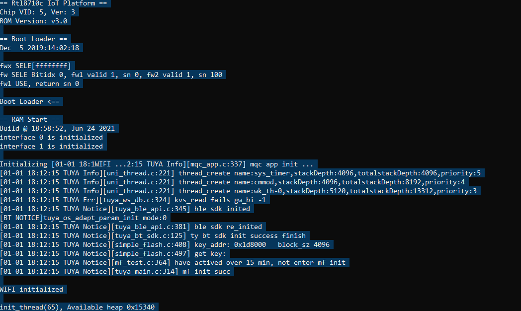

    divadiow wrote:
    @DeDaMrAz do you have a Tuya RTL8720CF to hand?
    Same result, I recall that @insmod mentioned something wrong with flash tool writing (I guess reading may have the problem as well)
    Chip VID: 5, Ver: 3
    ROM Version: v3.0
    == Boot Loader ==
    Dec  5 2019:14:02:18
    fwx SELE[ffffffff]
    fw SELE Bitidx 0, fw1 valid 1, sn 0, fw2 valid 1, sn 100
    fw1 USE, return sn 0
    Boot Loader <==
    == RAM Start ==
    Build @ 18:58:52, Jun 24 2021
    Initializing [01-01 18:1WIFI ...2:15 TUYA Info][mqc_app.c:337] mqc app init ...
    [01-01 18:12:15 TUYA Info][uni_thread.c:221] thread_create name:sys_timer,stackDepth:4096,totalstackDepth:4096,priority:5
    [01-01 18:12:15 TUYA Info][uni_thread.c:221] thread_create name:cmmod,stackDepth:4096,totalstackDepth:8192,priority:4
    [01-01 18:12:15 TUYA Info][uni_thread.c:221] thread_create name:wk_th-0,stackDepth:5120,totalstackDepth:13312,priority:3
    [01-01 18:12:15 TUYA Err][tuya_ws_db.c:324] kvs_read fails gw_bi -1
    [01-01 18:12:15 TUYA Notice][tuya_ble_api.c:345] ble sdk inited
    [BT NOTICE]tuya_os_adapt_param_init mode:0
    [01-01 18:12:15 TUYA Notice][tuya_ble_api.c:381] ble sdk re_inited
    [01-01 18:12:15 TUYA Notice][tuya_bt_sdk.c:125] ty bt sdk init success finish
    [01-01 18:12:15 TUYA Notice][simple_flash.c:408] key_addr: 0x1d8000   block_sz 4096
    [01-01 18:12:15 TUYA Notice][simple_flash.c:497] get key:
    [01-01 18:12:15 TUYA Notice][mf_test.c:364] have actived over 15 min, not enter mf_init
    [01-01 18:12:15 TUYA Notice][tuya_main.c:314] mf_init succ
    WIFI initialized
    init_thread(65), Available heap 0x15340
    Information about IoT platform Rtl8710c with initialization messages and TUYA errors.

    this Govee H5106 Air Quality Monitor fw from device with second MCU does
    Printed circuit board with labels and electronic components.
    • Govee_H5106_Air_Quality.bin (2 MB) You must be logged in to download this attachment.

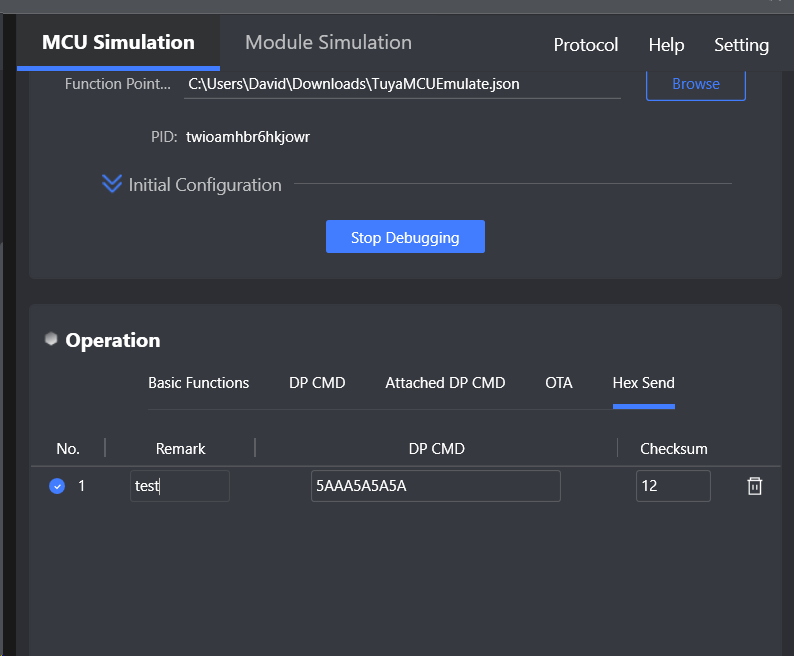

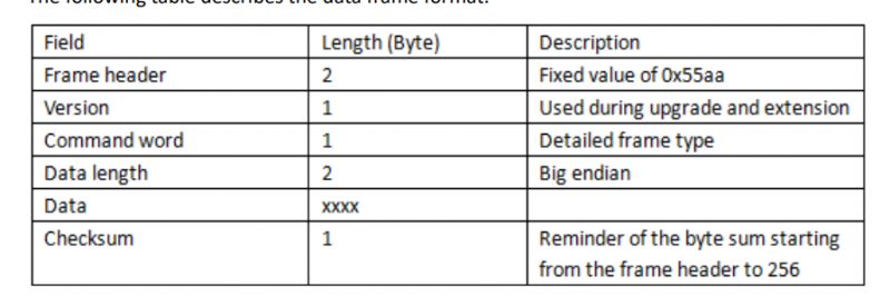

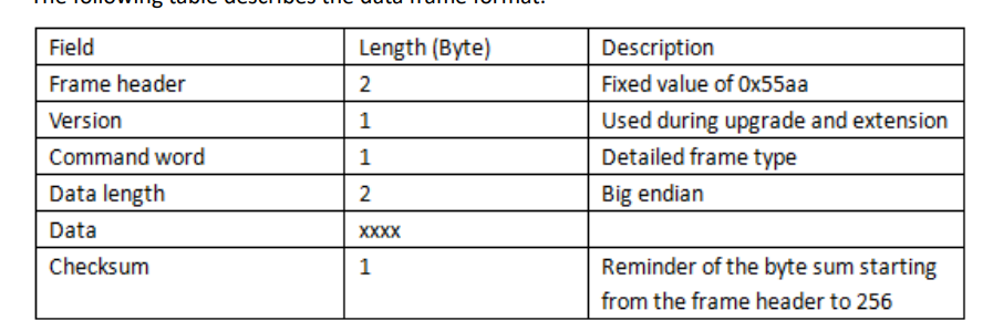

    Are you sure about that packet? TuyaMCU header is 0x55AA, not just 0x55. By the way, with some simple software on PC, we could simulate MCU to "talk" with that WiFi firmware.
    Table describing the data frame format with fields, their lengths, and descriptions.
  • #12 21375902
    Posts: 5042
    Help: 438
    Rate: 892
    I don't think it's TuyaMCU. Govee isn't Tuya based? And the tell-tale sign also that no Tuya storage area is found in fw. I think whoever made that pic and labelled it TuyaMCU is wrong.
    This is boot log
    TuyaMCU simulator isn't acknowledging anything received by it.

    yes. WBR3 pads on the underside would need to be accessed
    >>21375933
    true. that MCU is a Freqchip FR8016HA
    https://github.com/search?q=FR8016HA&type=code
    the device owner posted FR8016HA boot log too

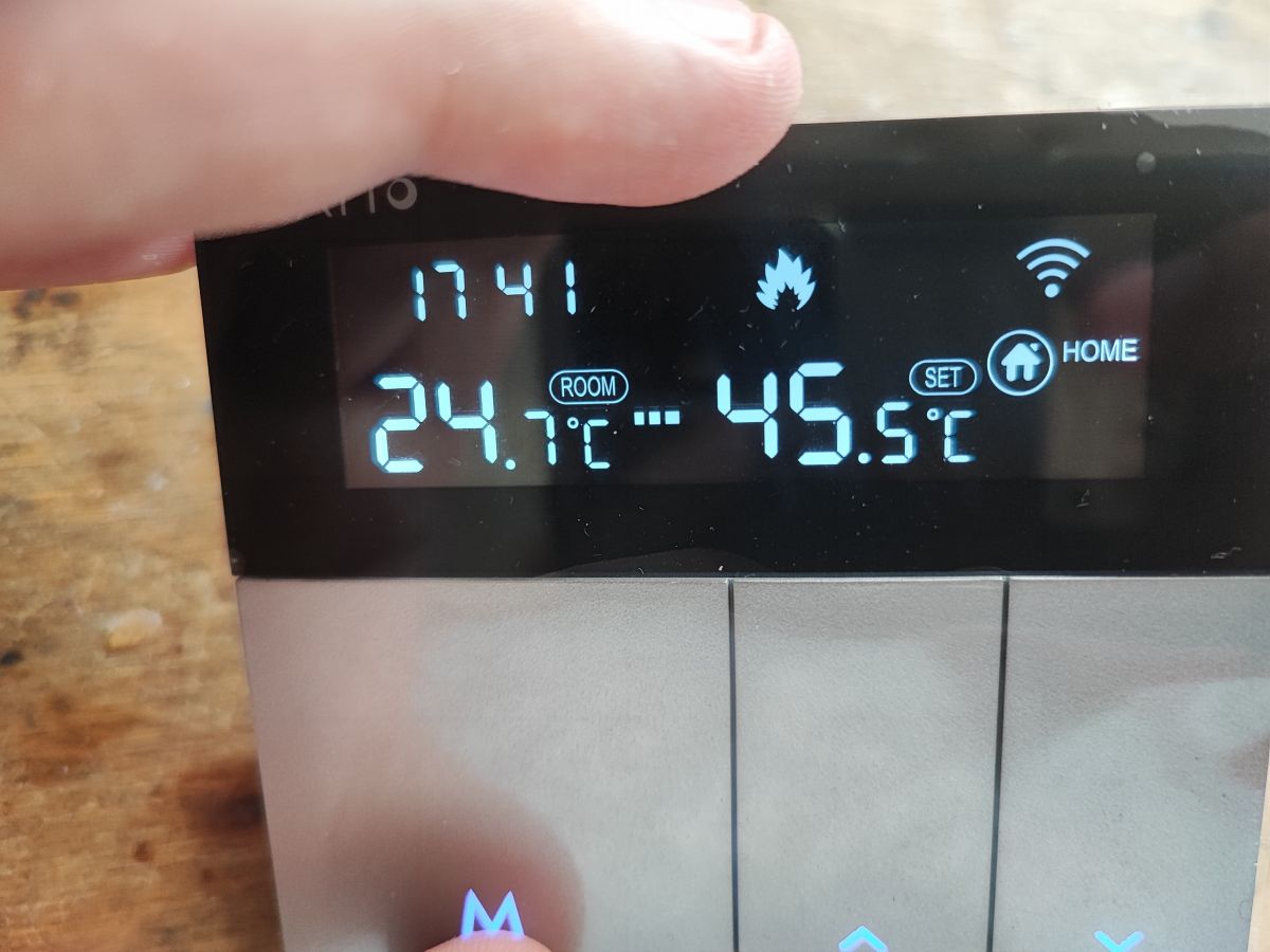

    anthonythomas wrote:
    Is it right to say it isn't possible to flash the WBR3 without removing it from the board to gain access to the reverse pads?
    I think you need to desolder it to gain access to the pads on the back side.
    I've tried to flash via the other serial port, because I saw it mentioned here:
    https://developer.tuya.com/en/docs/iot/burn-and-authorize-wbr-series-modules?id=Ka78imt8pf85p
    but I couldn't get it to work, it may require already having a bootloader? Anyway, we're using method as shown in first post, it's tested and reliable.
    By the way, WT50-WH-3A, WT100-WH-3A and WT200-16A-W thermostats are WBR3 based. I already have their dpIDs, but I don't have those devices on hand, because the user who borrowed them to me so I can investigate them have already installed them. Still, I will post a separate teardown soon, but for now without flashing.
    Electronic thermostat display showing room temperature and set temperature.
    WBR3 module on a circuit board with informational label.
    I've already did some basic tests and it seems that UART is working on OpenRTL:
    https://www.elektroda.com/rtvforum/topic4093142-60.html#21363681
    I wonder if we could somehow test Realtek with TuyaMCU, @divadiow if I remember correctly, you had some tool that can simulate TuyaMCU while running on PC? Maybe if we connected RTL to PC via that port and run TuyaMCU driver....
    Yes. I have already sought to try with some TuyaMCU/RTL firmwares but getting the backups to boot is hampering efforts.
    I used pk in the Aleco dehumidifier backup though and got the dpIDs that way after pairing with BK-N firmware. But yeh, that's not MCU simulation...
    Added after 16 [minutes]:
    https://www.elektroda.com/rtvforum/topic4085796.html
    Added after 9 [minutes]:
    I'm thinking of something else of course- RTL factory firmware with fake MCU.
    Yes, TMDA could be used to test OpenRTL I guess
    Screenshot of MCU simulation tool interface showing the operation section.

    Uploaded to WBR1-IPEX
    Electronic module labeled WBR1 .
    Electronic module with pin labels on a blue board. .
    The first problem is that it does not accept changing to its own IP and disabling DHCP.
    The first template from OBK theoretically works. Theoretically, because apart from the power supply I have nothing plugged in.
    As for the change of IP: it displays a message that it has accepted and that you should restart but after a while refreshes the page and the changes disappear. After the restart, DHCP works.
    The OTA update to the new version went through in a flash with no messages on the reboot page.
    The info about the start was displayed and the page no longer refreshed as in OBK with BK7231 but the software loaded correctly.
    It is still not possible to disable DHCP.

    Rate: 367
    Will this version of OBK for Realtek also work with this module?
    Close-up of an electronic module with an RTL8710BX chip on a PCB. .
    They put them in the sockets, so far I have replaced them with ESP02 but somehow Tasmota does not suit me, I prefer OBK in action.
  • #24 21378249
    Posts: 14599
    Help: 654
    Rate: 12614
    This module is still being worked on, it is not the RTL8720CF but the RTL8710BX. There will be a separate forum topic about the RTL8710BX.

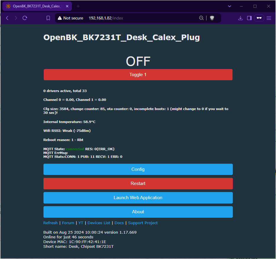

    that's good news. feel free to post your OpenRTL template from the web GUI so it can be added to the device list (assuming you have it configured 100% working as intended)
    OpenBK BK7231T Desk Calex Plug user interface with diagnostic information.
    if you have more info, pics etc, consider posting your findings into a new thread dedicated to the Kasa HS200.

    I've received WBR3s today from a reader:
    Package of three WBR3 modules placed on a Loginovo branded box.
    Added after 38 [seconds]:
    Expect more testing soon. Maybe another NodeMCU hack?
