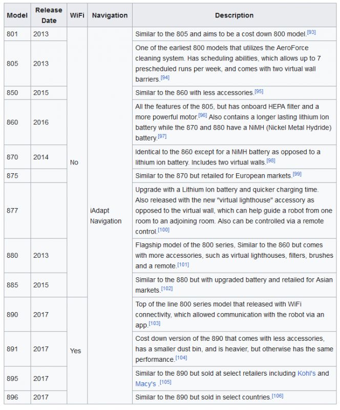

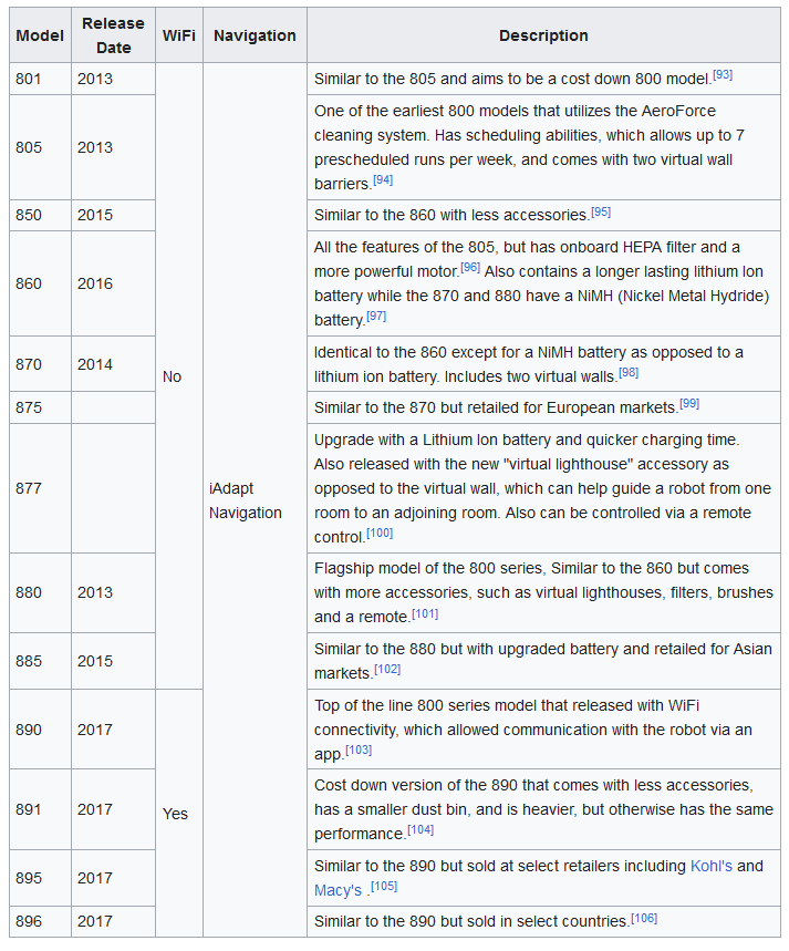

    This topic was based on the Roomba 780 model, but the solution was also tested on the 500 and 600 series. It is worth mentioning here that not every Roomba model has WiFi from the factory, so it might make sense to play with it...
    Table of Roomba vacuum models with information on release date, WiFi, navigation, and description.
    Source of the table: https://en.wikipedia.org/wiki/Roomba

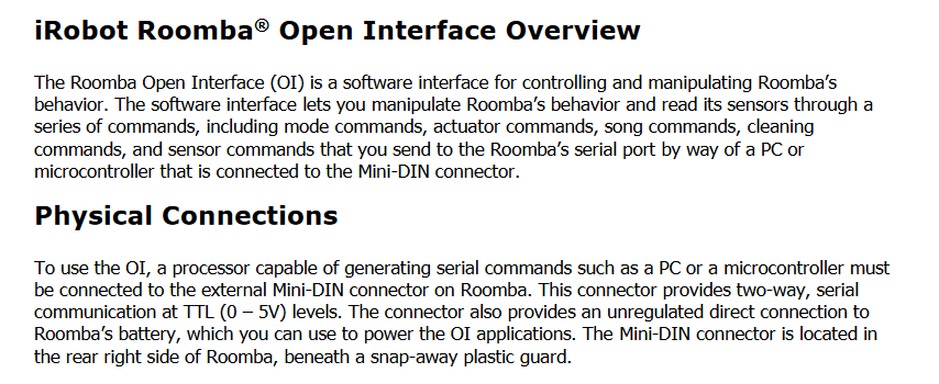

    The adventure begins, of course, with reading the documentation. Everything is available on the web, which makes the project shown here ideal fun for beginners. No need to play around with reverse engineering, yes as itself this sometimes I do .

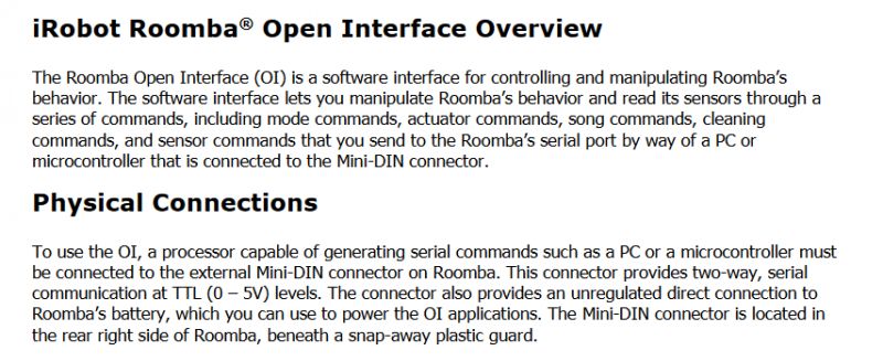

    We start by reading the introduction:
    Screenshot of iRobot Roomba Open Interface documentation.
    Then we learn the technical details.

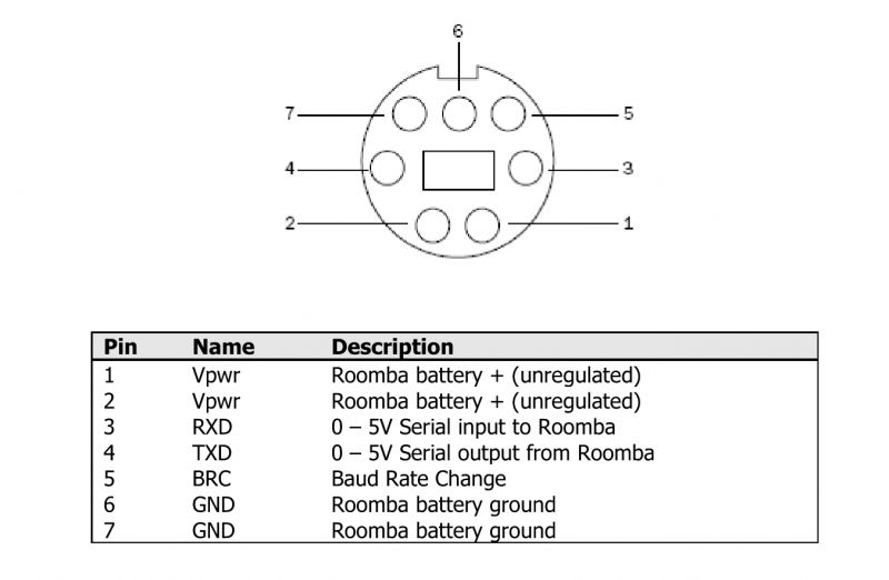

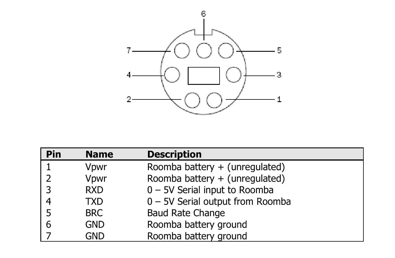

    So let's consider the connector offered to us by the hoover:
    Diagram of Roomba connector with pin descriptions

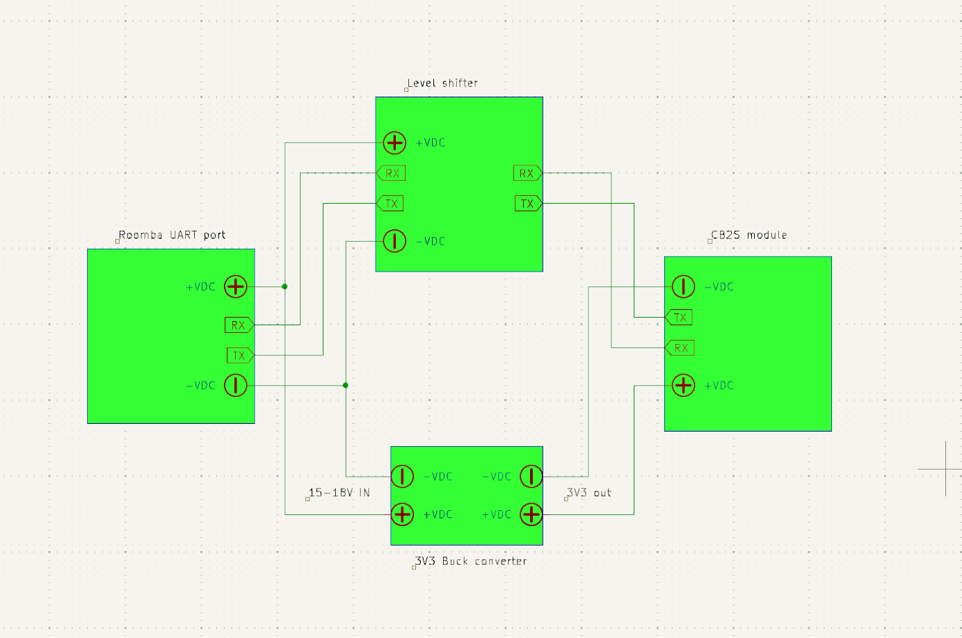

    We have here primarily a power supply and a UART serial port. This can be used, but the devil is in the details. The power supply here is far from the 3.3V required by our WiFi module. It would be tempting to put an LDO regulator here, for example an AMS1117-3.3V, but the WiFi module can draw quite a lot of current (even more than 100mA) and the regulator, even allowing for a high input voltage, could heat up. It would be better to proceed more efficiently - find some kind of step-down converter. The choice on the web is wide.
    With the UART itself, there is a similar problem - if our WiFi module only supports 3.3V levels and not 5V, you will need to add a logic level converter. But again, this is no problem, there are ready-made modules for everything. Schematic:
    Connection diagram for Roomba integration with CB25 module
    (Small note - we connect RX to TX and TX to RX, send to receive and receive to send, unless someone has already swapped the labels in place before....)

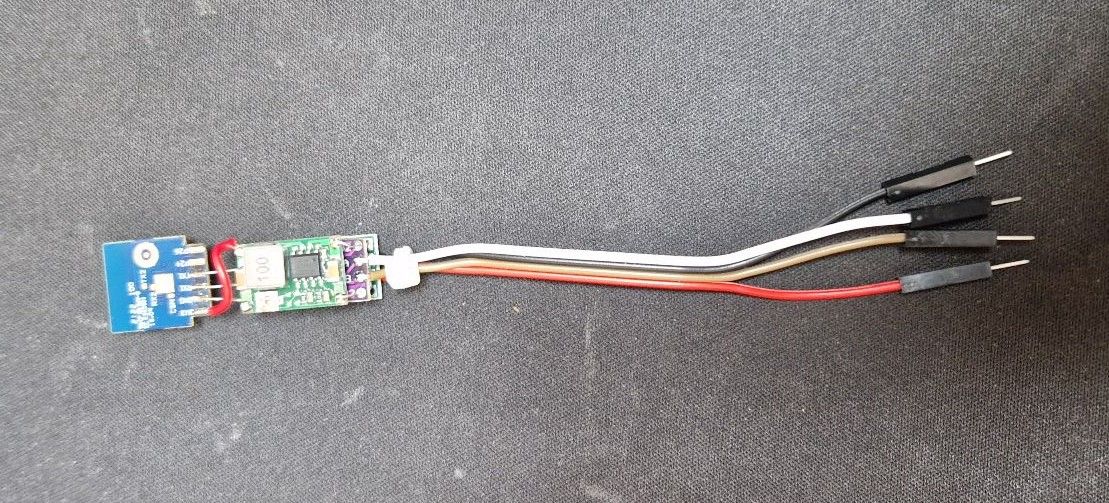

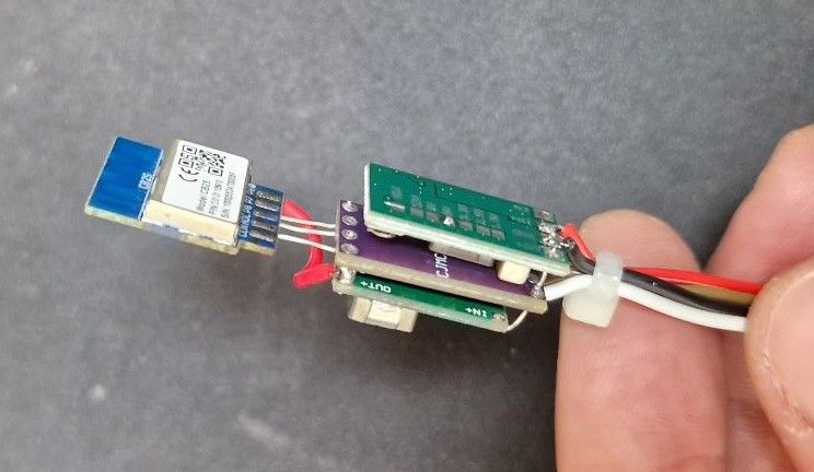

    Practice: Electronic modules and wires on a black background
    In the photo above is a CB2S module with BK7231N as we have such in abundance. We run OpenBeken on it to be able to encode the UART without programming and compiling the batch.
    The specific model of inverters and converters doesn't matter, we used an ADUM1201, which also isolates, but this is not needed here.

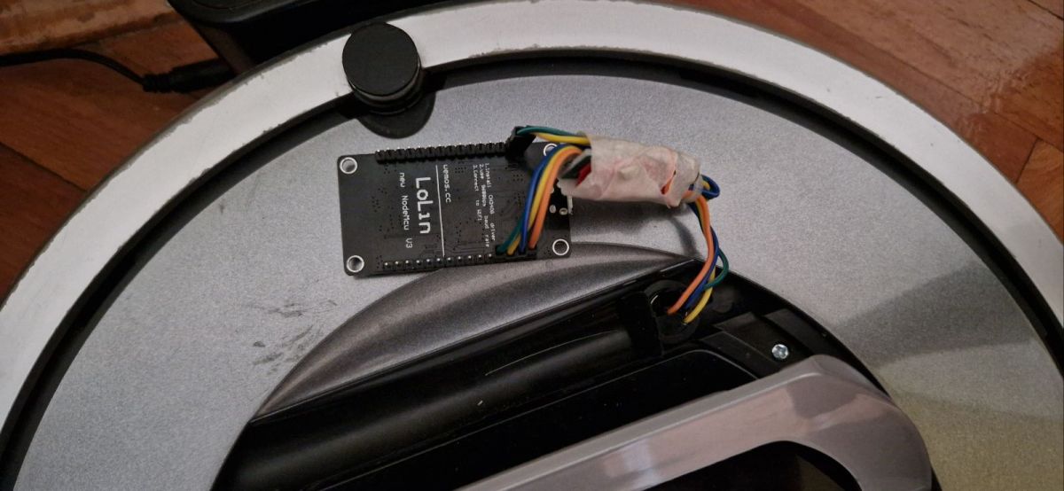

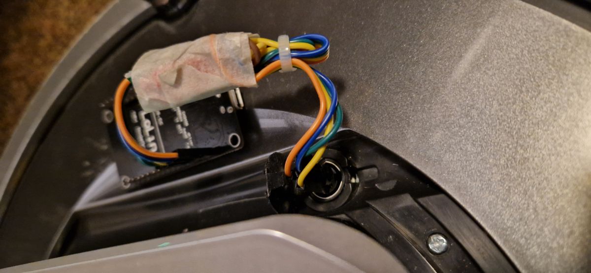

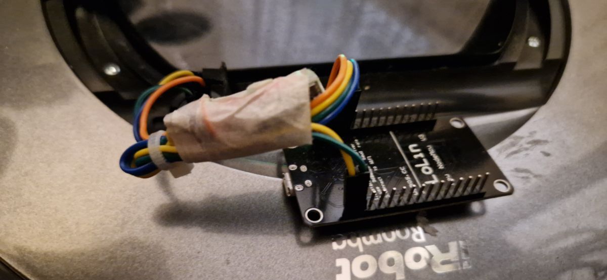

    Here's a photo from testing, still without CB2S, but with our BK7231 development board ( translate NodeMCU ):

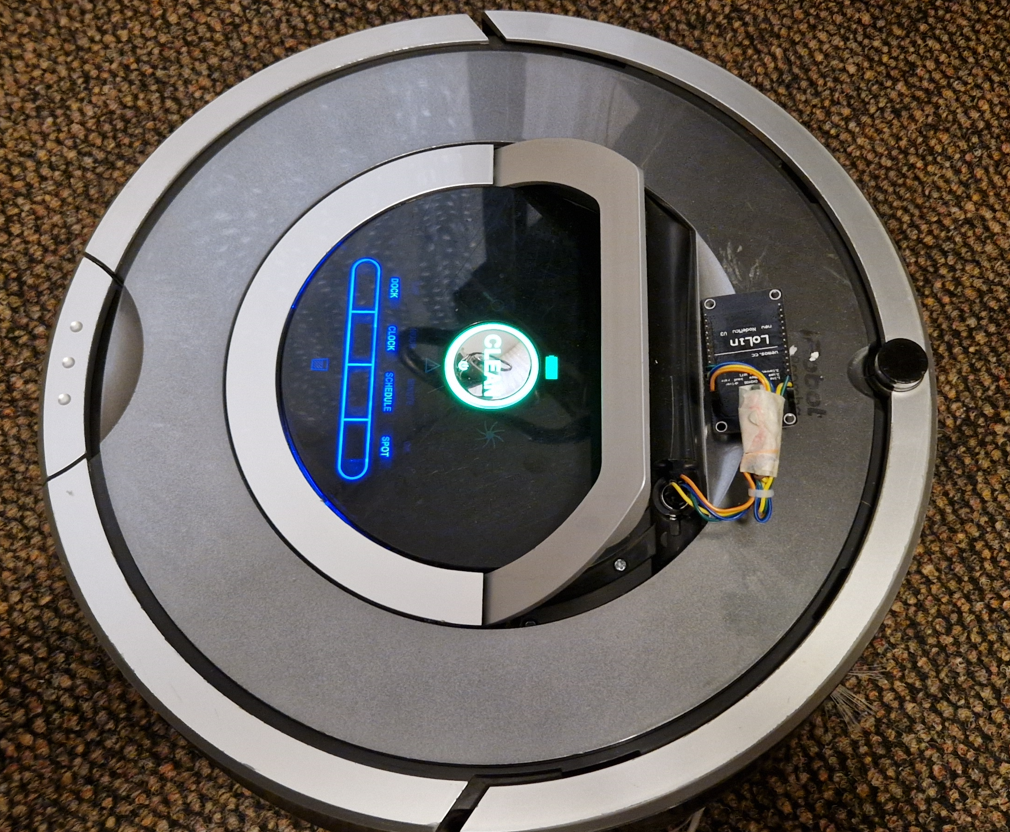

    Image of the internal part of an iRobot Roomba vacuum with a NodeMCU LOLIN module installed. Close-up of an electronic module connected to an iRobot Roomba. Close-up of the internal connector of an iRobot Roomba vacuum modified for integration with a WiFi module.

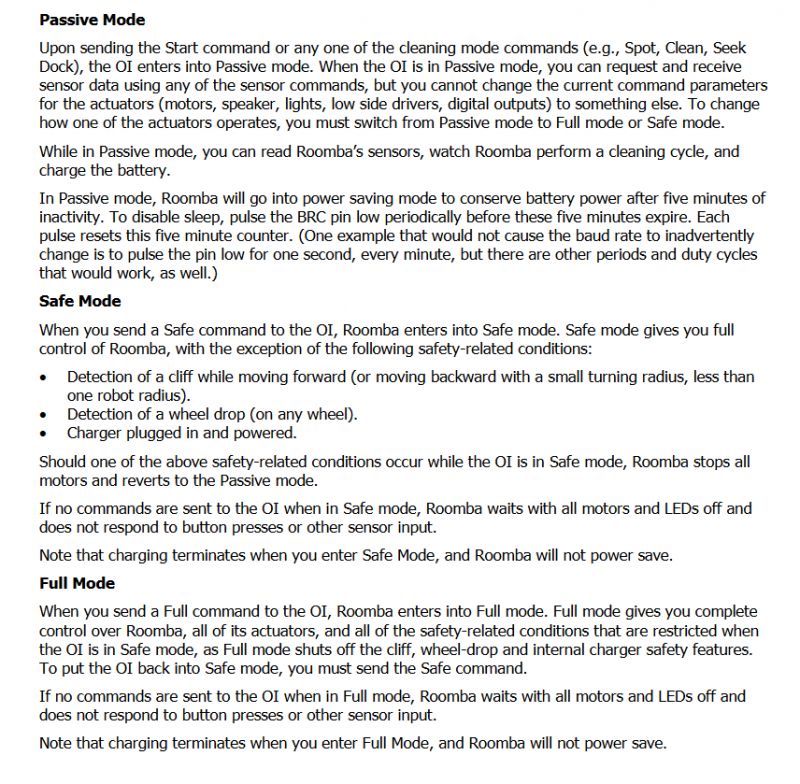

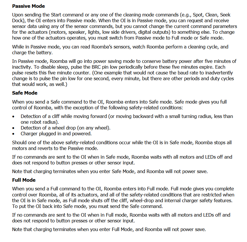

    For control, we also have several modes available, including a full mode, "Full Mode". It gives full control of the hoover, but I'll focus on that elsewhere...
    Screenshot of Roomba Open Interface documentation describing device operation modes.

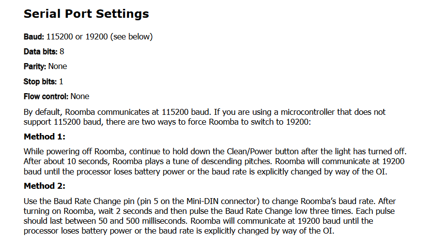

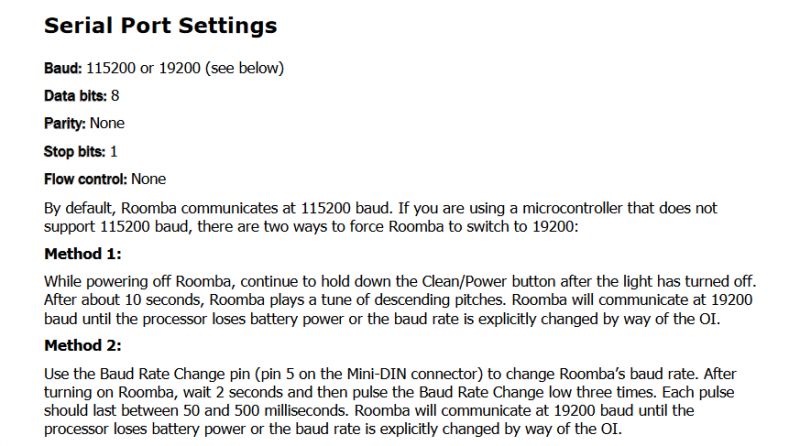

    Now let's look at the more software side. We have the hardware ready to go. The UART here also has fairly standard settings, baud 115200, parity and stop bits as in most applications I encounter...
    Serial port settings for the Roomba vacuum cleaner.

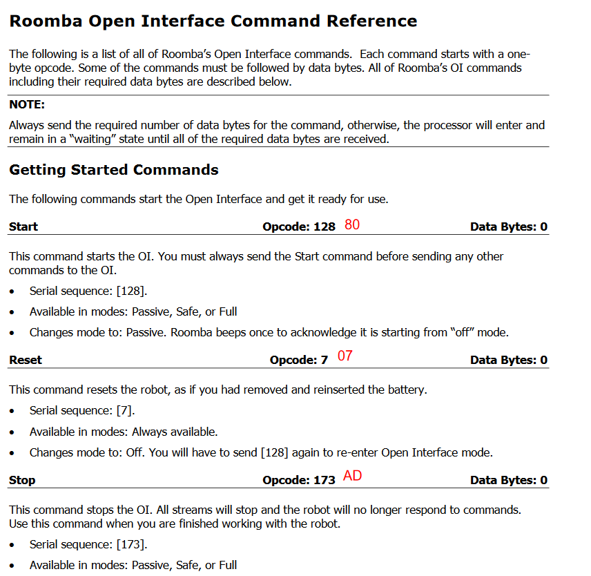

    You still need to know what to send, and it's surprisingly simple:
    Roomba Open Interface command reference section.
    Yes, there are not even headers here, no packet lengths, no checksums.... we just send individual bytes. There's not much to discuss here.

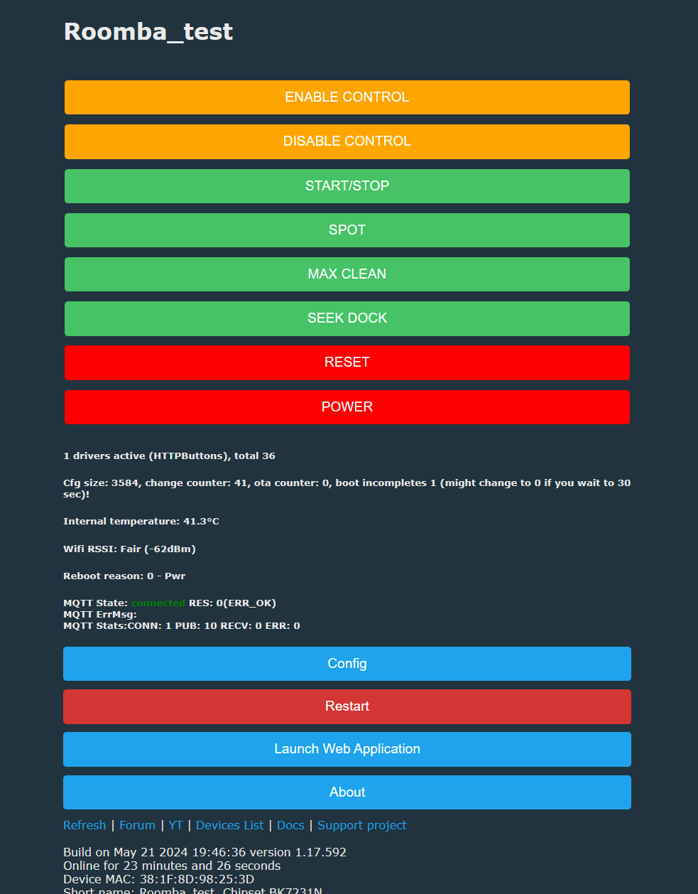

    It's certainly easy to do this on many platforms, but we chose OpenBeken . We already have OTAs, scripts, HA integrations ready there. We have written a simple script to create buttons on the HTTP panel to which we have plugged the upload. We have example scripts in this style on one of our documentation pages, more precisely on autoexec examples .
    Into the script we have moved the basic commands responsible for control and operation of the hoover.
    startDriver httpButtons
    setButtonLabel 0 "ENABLE CONTROL"
    setButtonColor 0 ORANGE
    setButtonEnabled 0 1
    setButtonCommand 0 "uartSendHex 8083"
    setButtonLabel 1 "DISABLE CONTROL"
    setButtonColor 1 ORANGE
    setButtonEnabled 1 1
    setButtonCommand 1 "uartSendHex ad"
    setButtonLabel 2 "START/STOP"
    setButtonEnabled 2 1
    setButtonCommand 2 "uartSendHex 87"
    setButtonLabel 3 "SPOT"
    setButtonEnabled 3 1
    setButtonCommand 3 "uartSendHex 86"
    setButtonLabel 4 "MAX CLEAN"
    setButtonEnabled 4 1
    setButtonCommand 4 "uartSendHex 88"
    setButtonLabel 5 "SEEK DOCK"
    setButtonEnabled 5 1
    setButtonCommand 5 "uartSendHex 8f"
    setButtonLabel 6 "RESET"
    setButtonColor 6 RED
    setButtonEnabled 6 1
    setButtonCommand 6 "uartSendHex 07"
    setButtonLabel 7 "POWER"
    setButtonColor 7 RED
    setButtonEnabled 7 1
    setButtonCommand 7 "uartSendHex 85"
    The script creates the following web panel:
    Screenshot of a web interface for controlling an iRobot Roomba.
    Of course the panel is accessible without any problem from a web browser.

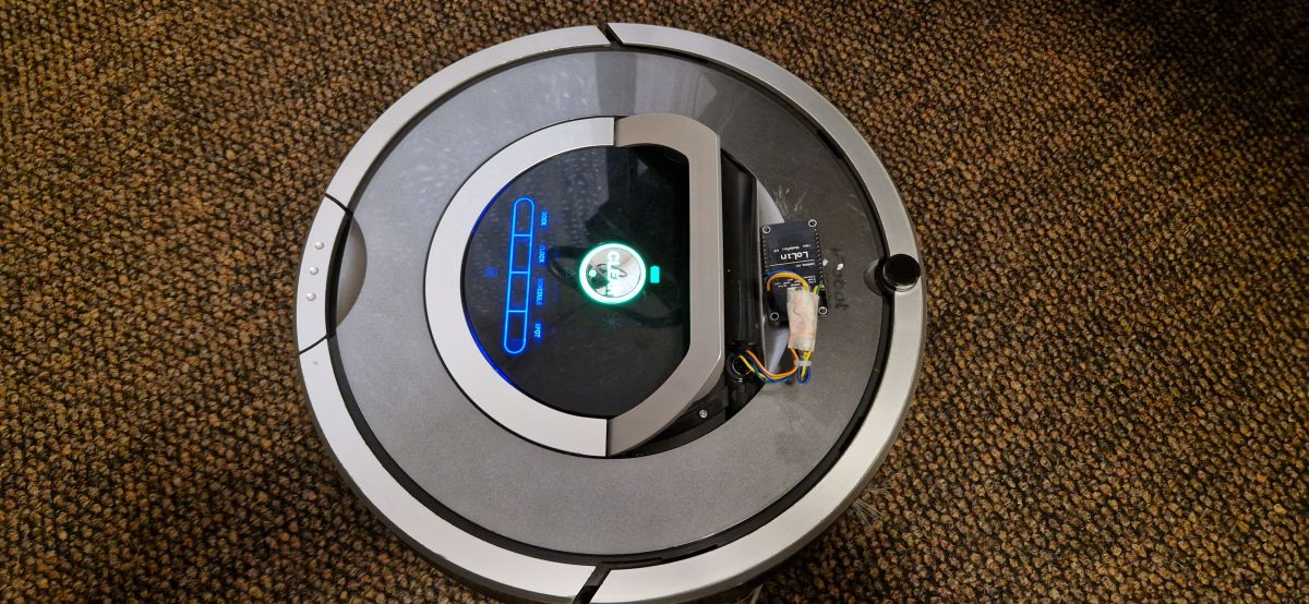

    It's time to fire up our hoover and see if it still works:
    iRobot Roomba 780 vacuum cleaner with an attached WiFi module on top.
    This is the final presentation:
    Everything works satisfactorily. That's it for now, but that was just the first part of the topic. In the second I will try to expand on the topic. Among other things, we are planning to:

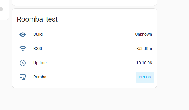

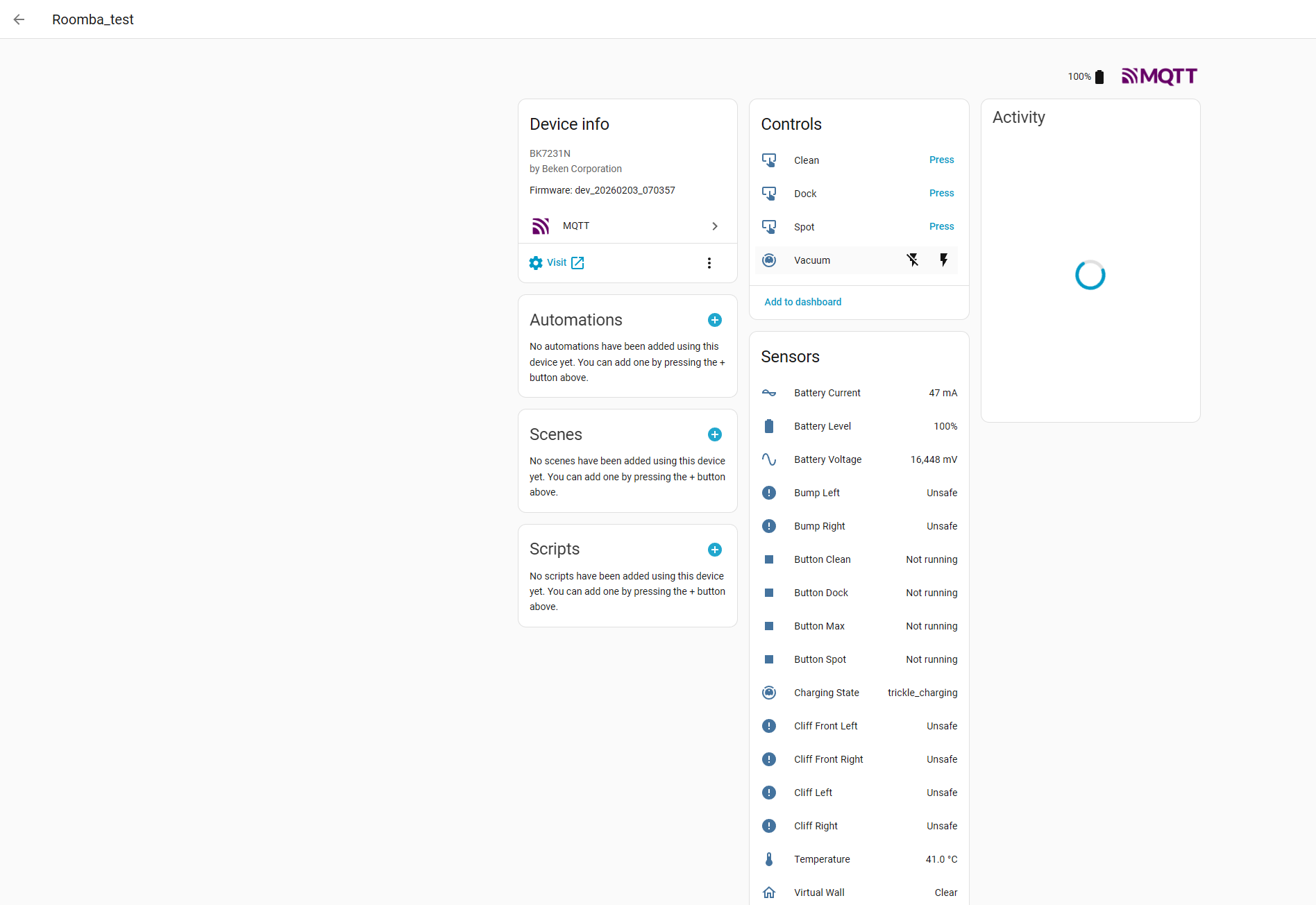

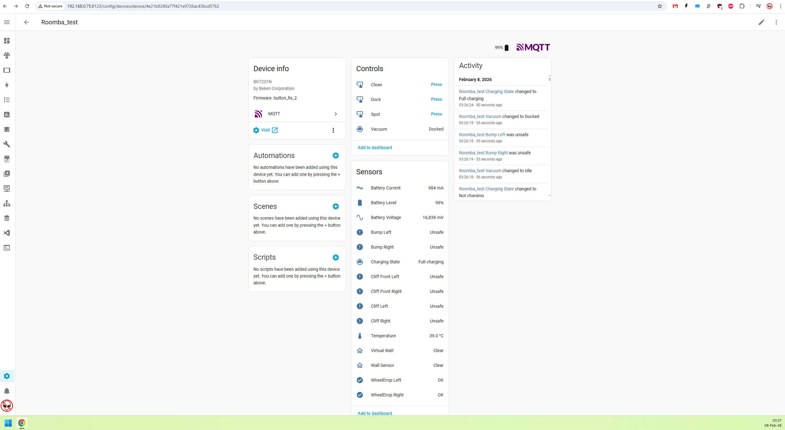

    - add integration with Home Assistant:
    Roomba_test user interface with device information.

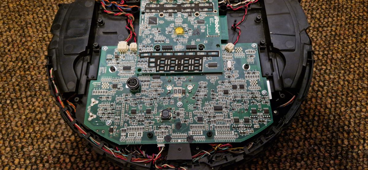

    PS: Still for the inquisitive - a photo of the hoover without the housing:
    Interior of iRobot Roomba vacuum cleaner showing electronic components
    You can well see here the mentioned connector we use.

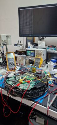

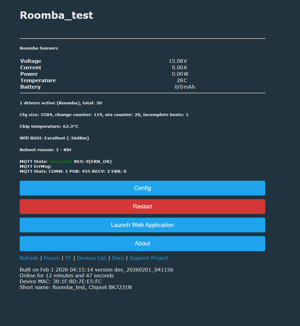

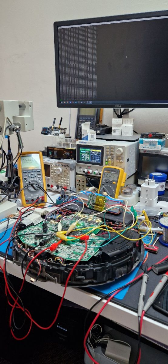

    Some more development on this topic.
    OBK can be useful to solve some issues with converting battery packs to Li-Ion by measuring new battery voltage and applying a "cutting" signal (basically telling Roomba it's full) but we need to integrate ADC battery measurement as well as temperature measurement for safety. Right now we are in the data collection stage and it looks something like this
    Disassembled Roomba vacuum on a workbench with meters and wires.
    We will update the progress and post here everything relevant. Goal is to fully control old roomba models that are cheep but still useful and integrate them into HA.
    Let us know if you would be interested in this kind of development.

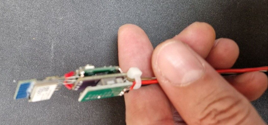

    Rate: 12914

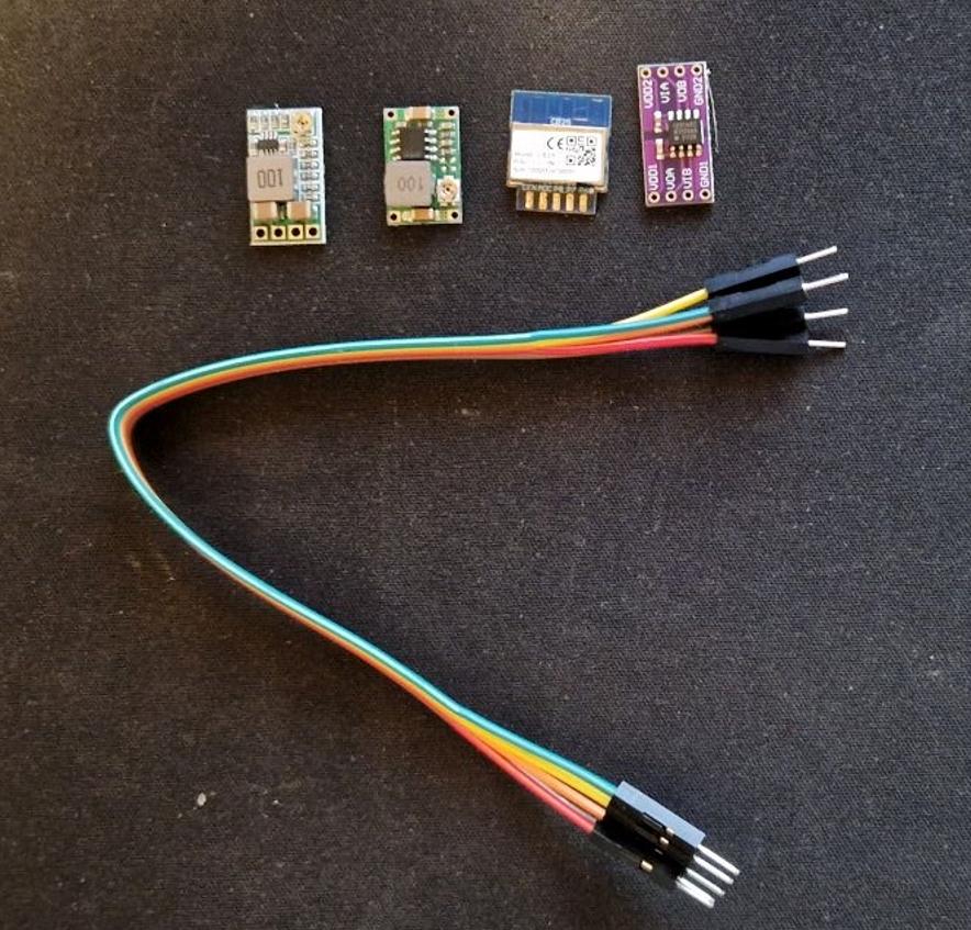

    The mentioned CB2S module together with additional boards (voltage level converter, step-down converter):
    Image of an electronic module held in fingers, including additional boards. CB2S module with step down converter and wires on a black background. Close-up of a CB2S module with additional level shifter and step-down converter boards. The used module is very similar to the ESP-based TYWE2S

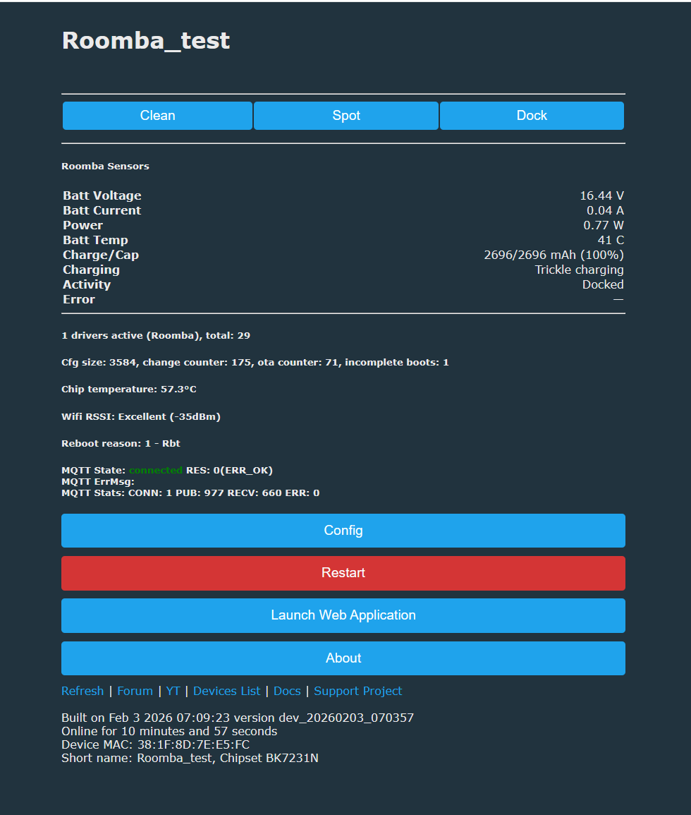

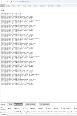

    Since I've been playing around with a lot of UART based devices lately I decided to revisit this one and create a complete Roomba OBK driver - mostly because the protocol is simple and well documented. Starting with some basics like temperature and voltage readings.
    Screenshot of Roomba device log interface showing voltage and temperature data
    Next thing is to create it in fashion similar to other UART like devices like BL0937 or BL0942 and present data on the index page
    Test panel for Roomba device showing sensor data and control buttons
    By doing it in small incremental steps I am familiarizing my self on how to parse data and send commands as that will come in handy with other projects that I have so I can contribute a bit more to the project and satisfy my lobotomized head (not any type of C programmer btw( !!! ) python is my forte).
    So maybe except some interesting stuff moving forward as I get a grip of these things :)
    My excuse is it's too early - enough said.

    Since I am the only one interested in this I'll power through it the only way I know - head first :)
    Screenshot of “Roomba_test” dashboard showing Device info, Controls, Activity, and Sensors with MQTT details
    Screenshot of “Roomba_test” web panel with Clean/Spot/Dock buttons, sensor readouts, and MQTT status

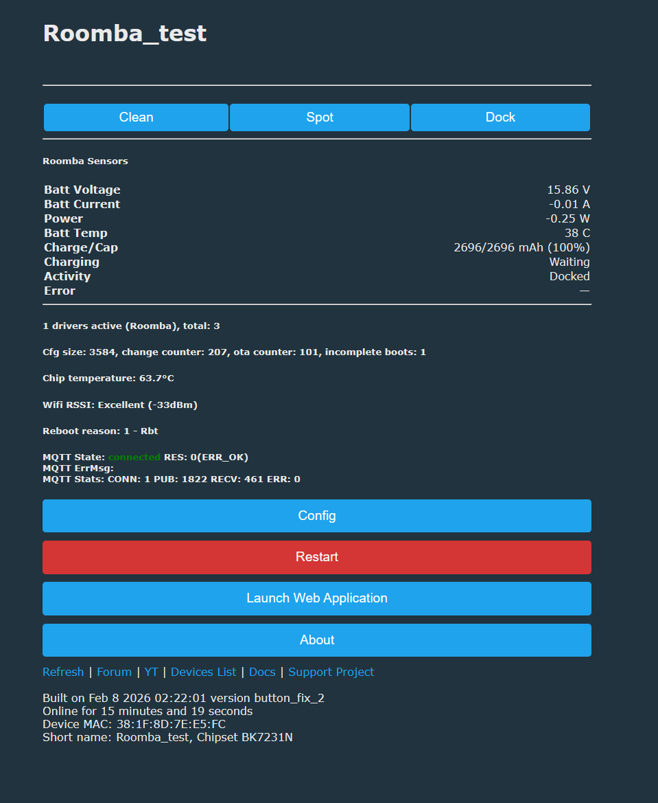

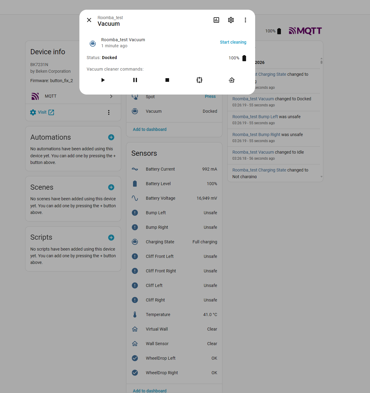

    Progress report:
    “Roomba_test” dashboard with Clean/Spot/Dock buttons and sensor readings plus MQTT status
    Screenshot of an MQTT dashboard showing “Roomba_test Vacuum” status “Docked” and 100% battery
    Home Assistant device page for “Roomba_test” with controls, sensor list, and MQTT activity log
    Driver is almost complete and will be published soon with details on how to connect OBK to older style Roomba robots., From documentation all 500-800 robots should be supported.

How do you add WiFi control to a Roomba 500, 600, 700, or 800 series using a CB2S module and OpenBeken?
You add WiFi by bridging the Roomba UART to a CB2S module running OpenBeken and powering that module from a proper 3.3 V supply. 1. Take power and UART from the Roomba connector. 2. Add a step-down converter and, if needed, a logic level converter. 3. Flash OpenBeken on CB2S, then send Roomba command bytes from its web panel or Home Assistant. The thread first tested this on 500, 600, and 700 series units, and later reported expected support for 500–800 robots. [#21832379]
Why is a step-down converter recommended instead of an AMS1117-3.3V LDO when powering a WiFi module from the Roomba connector?
A step-down converter is recommended because the WiFi module can draw more than 100 mA and an AMS1117-3.3V LDO could heat up badly from the higher Roomba supply voltage. The authors explicitly said the Roomba connector power is “far from the 3.3V required” by the WiFi module, so a more efficient converter is the safer choice for sustained operation and current spikes. [#21099471]
How should RX and TX be wired between a Roomba UART port and a 3.3V WiFi module, and when is a logic level converter needed?
RX and TX must be crossed: Roomba TX goes to module RX, and Roomba RX goes to module TX. A logic level converter is needed when the WiFi module only supports 3.3 V serial levels and the Roomba side is at 5 V levels. The thread also warns that labels can already be swapped on some boards, so verify the actual signal direction before final wiring. [#21099471]
What UART settings does the Roomba Open Interface use, and what problems show up if the baud rate or serial format is wrong?
The setup shown uses 115200 baud with ordinary serial framing, matching what the author described as standard parity and stop-bit settings. If the baud rate or framing is wrong, raw-byte commands will not decode correctly and readable logs such as “charger-wakeup” or battery lines like “16059 mV” will turn into garbage or fail entirely. That breaks both control and telemetry parsing. [#21099471]
Which Roomba commands were used in the OpenBeken web panel for enable control, start/stop, spot, max clean, dock, reset, and power?
The OpenBeken panel used these raw command bytes: enable control 8083, start/stop 87, spot 86, max clean 88, dock 8f, reset 07, and power 85. It also defined disable control as ad. Those values were mapped directly to web buttons, so pressing a button sent the corresponding byte sequence over UART without any packet header or checksum layer. [#21099471]

How does Full Mode in the Roomba protocol differ from the basic control modes, and what extra control does it unlock?
Full Mode gives full control of the robot, beyond the basic command set used for simple actions like clean, dock, reset, or power. The thread does not list every extra command, but it explicitly says Full Mode “gives full control of the hoover” and that the author planned to cover it separately. In practice here, the shown web panel stayed with basic raw-byte control rather than advanced mode-specific behavior. [#21099471]
AMS1117 LDO vs step-down converter for a Roomba WiFi mod: which is better for efficiency, heat, and current spikes from modules like CB2S?
The step-down converter is the better choice for this mod. The authors considered an AMS1117-3.3V LDO tempting, but rejected it because the WiFi module can pull more than 100 mA and the regulator could get hot with a high input voltage. A step-down converter wastes less power as heat and handles those current spikes more comfortably in a compact Roomba installation. [#21099471]
What is the ADUM1201 doing in this setup, and how is an isolated level shifter different from a simple logic level converter?
In this setup, the ADUM1201 was used as the serial interface device and also provided isolation, though the authors said isolation was not actually needed here. A simple logic level converter only changes voltage levels, such as 5 V to 3.3 V. An isolated device adds galvanic separation between sides, which can improve protection but also adds complexity that this Roomba mod did not require. [#21099471]
