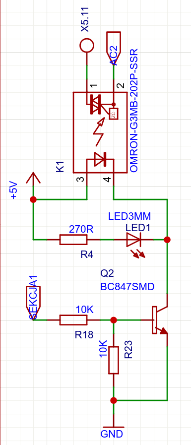

    I am building a garden irrigation controller the "heart" of which will be an ESP32 powered by 3.3VDC it will control two 74HC595. About 8 years ago I did something similar on an AVR but there the supply voltage was 5VDC. I have a question about controlling the popular OMRON G3MB-202P SSR relays. In the datasheet I found info that the control voltage for them is min 5VDC. Will the diagram below, which I had in my previous device and still works, also be correct here where the ESP32 pin has 3.3VDC and separately I would give 5VDC to power the SSR?

    should work.
    transformer ok
    the inverter must be able to withstand a minimum of 42V on the input e.g. R-78HB5.0-0.5L recom or LCW78_05-1.0 gaptec
    what is there to choose from https://www.tme.eu/pl/katalog/przetwornice-dc...71,2029188,2022980,2036169,2036166&page=5
    Link
    Unless it is to be insulated - e.g. SCWN06C-05 mean-well
    I would go from 5V to 3.3V with an LDO linear stabiliser.
