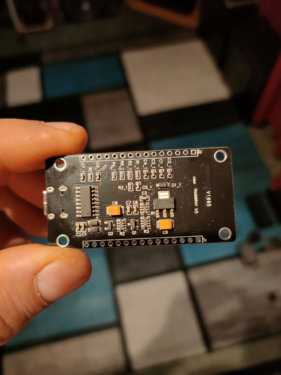

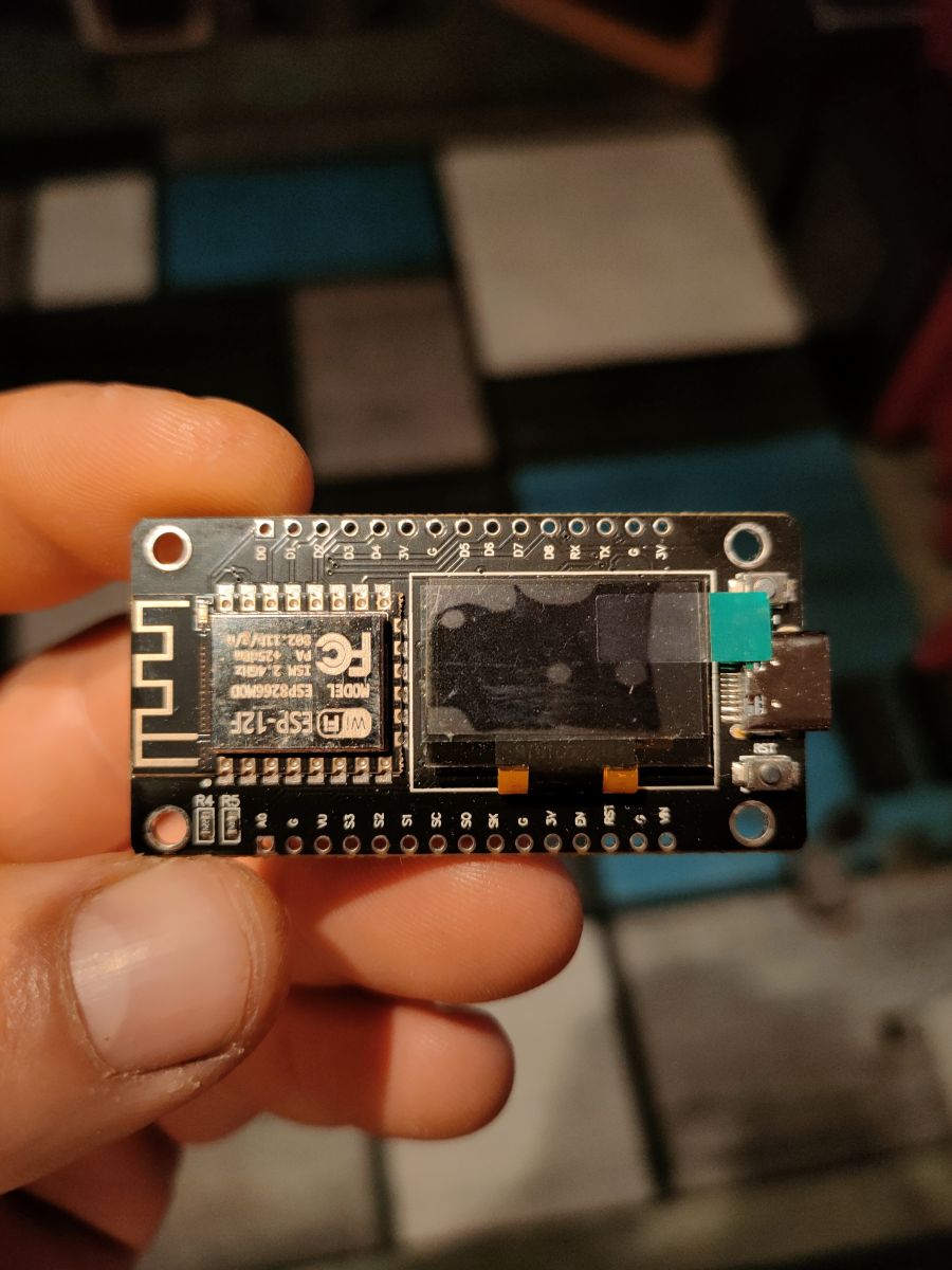

    Hello everyone, I have a problem with this board. I am completely unfamiliar with programming, but wanted to give it a try. I managed to upload the Deautcher program, the program works because there is Wi-Fi of this board on the phone, it connects the phone to the board through Wi-Fi and through the IP address it displays the program on the phone, but I have another problem. The built-in OLED display on the board does not work, I uploaded the program step by step according to this video: https://youtu.be/6tAm77G_AV0?is=SdE16GEiDdRd2a8u probably something needs to be changed in the code, but I have no idea what, when I bought the board, there was a demo program uploaded, the display worked.
    Bottom side of a PCB with SMD parts held between fingers; printed text “V660” and “NodeMcu v3”. NodeMCU ESP8266 development board with a small built-in OLED display, held in a hand
    What exact version of Deauther did you upload and where did you download it from - the finished .bin file or the project from the Arduino IDE/GitHub?
    The Deauther version from the link from the YouTube video given in the description, probably a .bin file.
    When uploading, did you select somewhere the board type or the OLED display settings (e.g. I2C pins/address 0x3C/0x3D), or did you upload everything quite "step-by-step" without any changes?
    Yes, I changed 0x3C to 0x3D and the SDA and SCL pins to 14 and 12, and it has the reverse and the Arduino IDE program, but it didn't do anything.

    Do you have this display enabled in the code and these pins set?

    Strange, it works for me?
    ESP8266 development board with small OLED showing menu: “SCAN, SELECT, ATTACK, PACKET MONITOR, CLOCK”
    arduino-cli upload --fqbn esp8266:esp8266:nodemcuv2 --port COM3 c:\Users\XYZ\Downloads\ESP8266_Deauther_SSD1306
    Added after 5 [minutes]:
    I compiled anew, did not change anything in the code, only the author to "Elektroda":
    ESP8266 board with small OLED showing “ESP8266 DEAUTHER” and “BY Elektroda”
    it comes out that:
    1. either by some miracle you have a different board - on different pins the display, but it doesn't look like it
    2. you changed something in the code before uploading, I uploaded it without changes and it works

    It worked, I changed SDA to D2 and SCI to D1 in the code and it works.

    That's interesting, after all, I can see in the pictures that our boards have D1, D2, and other pins in the same places. How do you compile it then? Maybe you picked the wrong board in Arduino or something?
  • #6 21903431
    pnowoczekPatryk90
    Posts: 40
    A good board I think I chose NODEMCU as in the video.
