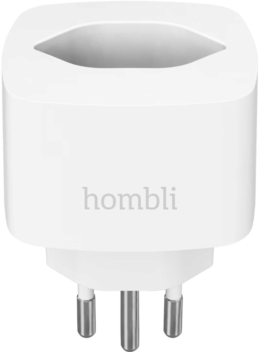

    A few days ago, a neighbour gave me three "hombli SmartSockets" for free. I wanted to use them in my smart home, but without the Tuya Cloud. Thanks to Gemini, a CachyOS laptop, and Cloudcutter, I was able to install OpenBK723IT. Quite easy and with no issues. The three sockets are now working perfectly with OpenBK723IT via MQTT with Home Assistant. Here is the configuration I worked out, along with a photo of the device.
      "vendor": "hombli",
      "bDetailed": "0",
      "name": "Hombli Smart Swiss Socket",
      "model": "HBSS-3109",
      "chip": "BK7231T",
      "board": "TODO",
      "flags": "1024",
      "keywords": [
        "TODO",
        "TODO",
        "TODO"
      "pins": {
        "6": "WifiLED_n;0;0",
        "7": "BL0937CF;0;0",
        "8": "BL0937CF1;0;0",
        "10": "Btn;1;1",
        "24": "BL0937SEL;0",
        "26": "Rel;1"
      "comman
    [url=https://obrazki.elektroda.pl/6593140100_1778769325.png][img]https://obrazki.elektroda.pl/6593140100_1778769325_thumb.jpg[/img][/url] d": "",
      "image": "https://obrazki.elektroda.pl/6593140100_1778769325.png",
      "wiki": "https://www.elektroda.com/rtvforum/viewtopic.php?p=21902971#21902971"
