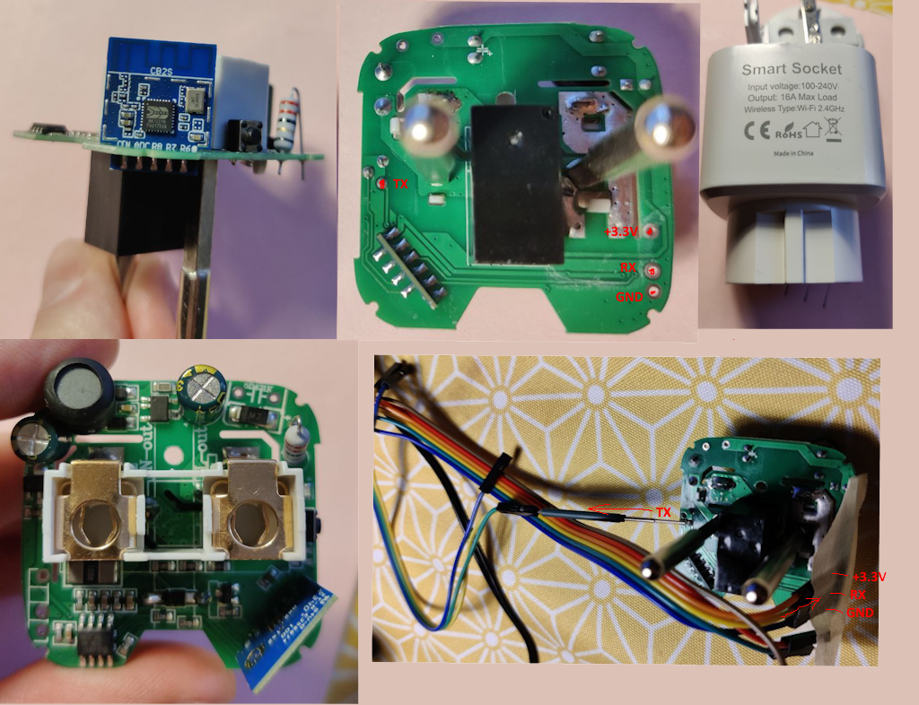

    Tuya pin map for CB2S BK7231N module
    #1 20996622
    chupakabra303
    Smart socket module with CB2S module and connections.
    - BL0937 SEL on P24
    - Button (channel 1) on P11
    - BL0937 VI on P6
    - WiFi LED on P8
    - BL0937 ELE on P7
    - Relay (channel 1) on P26
    Device seems to be using CB2S module, which is using BK7231N.

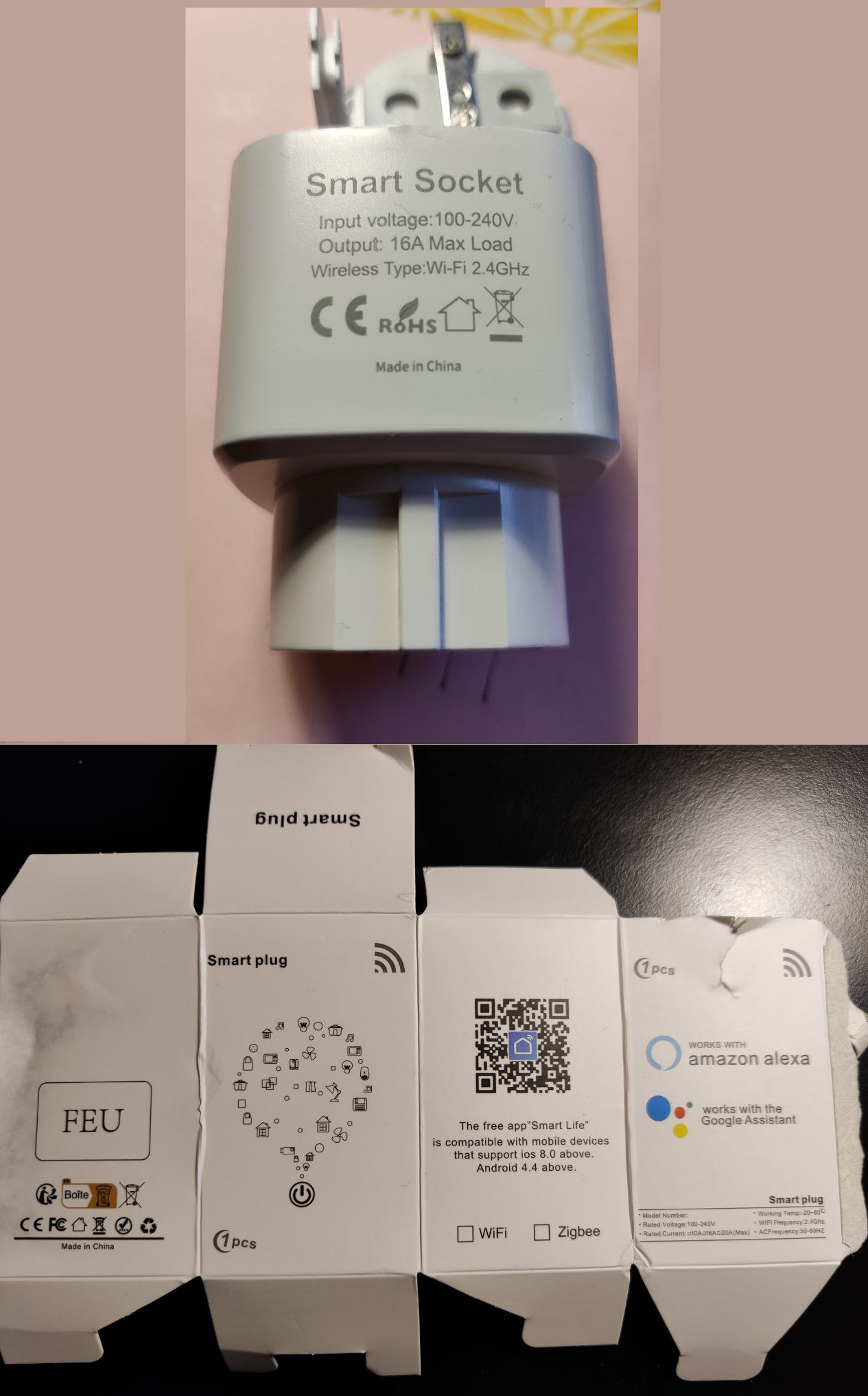

  • Pinout for nameless Tuya smart socket with BL0937
    #3 21000062
    chupakabra303
    Image of a smart plug and its packaging.
    This is a nameless socket. Smart Socket is written on the body. The only text shown on the photo. They also attach a photo of the packaging.
  • #4 21014530
    Posts: 14747
    Rate: 12846
    It's a shame they don't label those devices better. Still, I've submitted your template:
    https://github.com/OpenBekenIOT/webapp/commit/ebd9bcac516ee5e1eaaf95c56d4132458aaf4704
    It should be soon live at:
