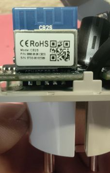

    Tuya pinout and config for CB2S BK7231N plug
    #1 21826477
    andreasd
    Beken BK7231N
       "sel_pin_pin":"24",
       "rl1_lv":"1",
       "bt1_pin":"10",
       "net_trig":"2",
       "jv":"1.0.7",
       "netled1_lv":"0",
       "netled_reuse":"1",
       "ffc_select":"0",
       "vi_pin":"6",
       "resistor":"1",
       "over_cur":"17300",
       "bt1_lv":"0",
       "reset_t":"3",
       "netled1_pin":"8",
       "chip_type":"0",
       "lose_vol":"100",
       "over_vol":"300",
       "module":"CB2S",
       "ele_pin":"7",
       "ch_cddpid1":"9",
       "ch1_stat":"2",
       "ch_num":"1",
       "ele_fun_en":"1",
       "rl1_pin":"26",
       "vol_def":"0",
       "ch_dpid1":"1",
       "sel_pin_lv":"1",
       "crc":"45"

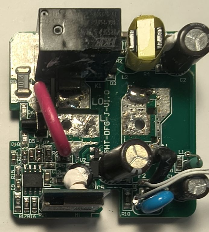

    - BL0937 SEL on P24
    - Button (channel 1) on P10
    - BL0937 VI (CF1) on P6
    - WiFi LED on P8
    - BL0937 ELE (CF) on P7
    - Relay (channel 1) on P26
    Device seems to be using CB2S module, which is using BK7231N.
    And the Tuya section starts, as usual, at 2023424 (0x1EE000)
