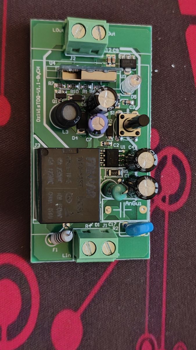

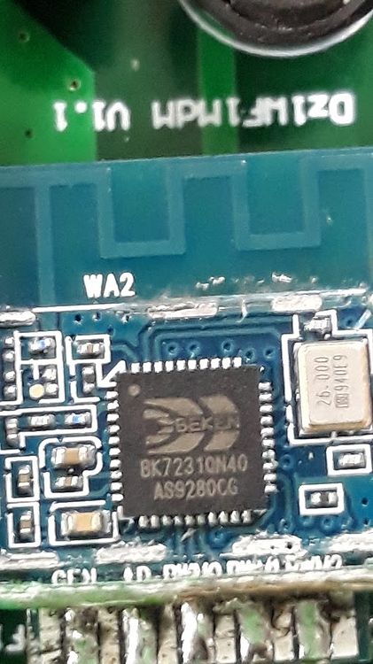

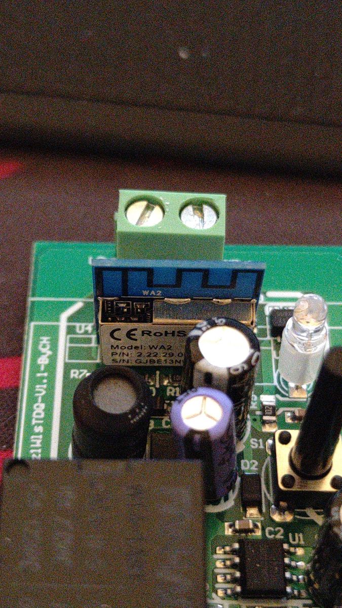

    Ola, I took out an old relay from the cupboards, opening it to try to put OBK in, the chip is called WA2.
    By searching on the net it would be under BK7231
    Close-up of an electronic chip labeled BK7231N40 with WA2 marking on the board. Electronic circuit board with components such as a relay and capacitors. Close-up of a circuit board with a module labeled WA2 and electronic components.
    I flashed the module everything went well, but after the first boot no AP is displayed. I don't understand
  • #2 21087510
    insmod
    Posts: 1430
    Help: 168
    Rate: 455
    This is not a BK7231N, but one known as BK7231Q. It is not supported anywhere afaik. There is only libretiny, but it has only minimal support done, not even wifi works.
    The only solution, i believe, is to swap it to WB2S, CB2S or ESP-02S.
