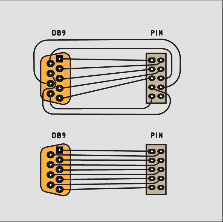

  • Incompatible serial header standards caused mouse failure
    #31 21918555
    bsw
    Level 22  
    Posts: 701
    Help: 5
    Rate: 732
    _ACeK_ wrote:
    What a surprise I had when I used the mouse from another computer. I plugged in the mouse and it didn’t work 🤔 I plugged it back into the first one – it worked 👀 I racked my brains trying to figure out why it wouldn’t work. After analysing the ribbon cable connections, it turned out that two different standards were being used :wink:
    Yes – there were two incompatible standards:
    https://pinoutguide.com/Motherboard/rs232_header_pinout.shtml
  • #32 21918567
    _ACeK_
    Posts: 205
    Help: 7
    Rate: 222
    :smile: Once I’d figured out what the problem was no there was a problem :lol: But I’d better not admit just how many strange ideas popped into my head, hehe :wink:

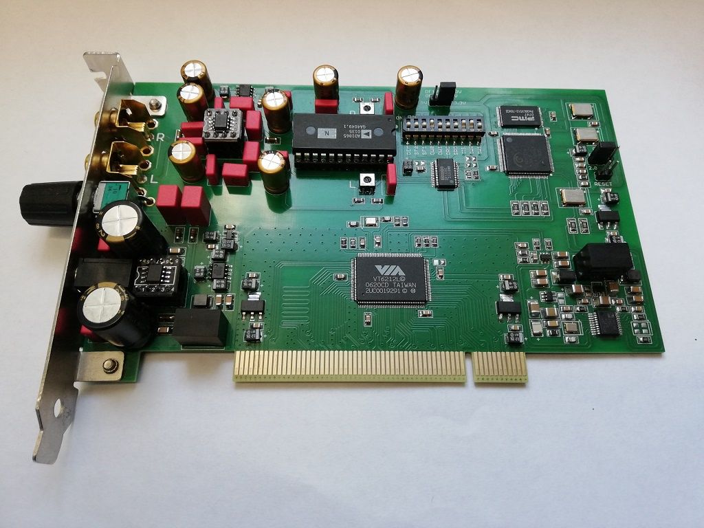

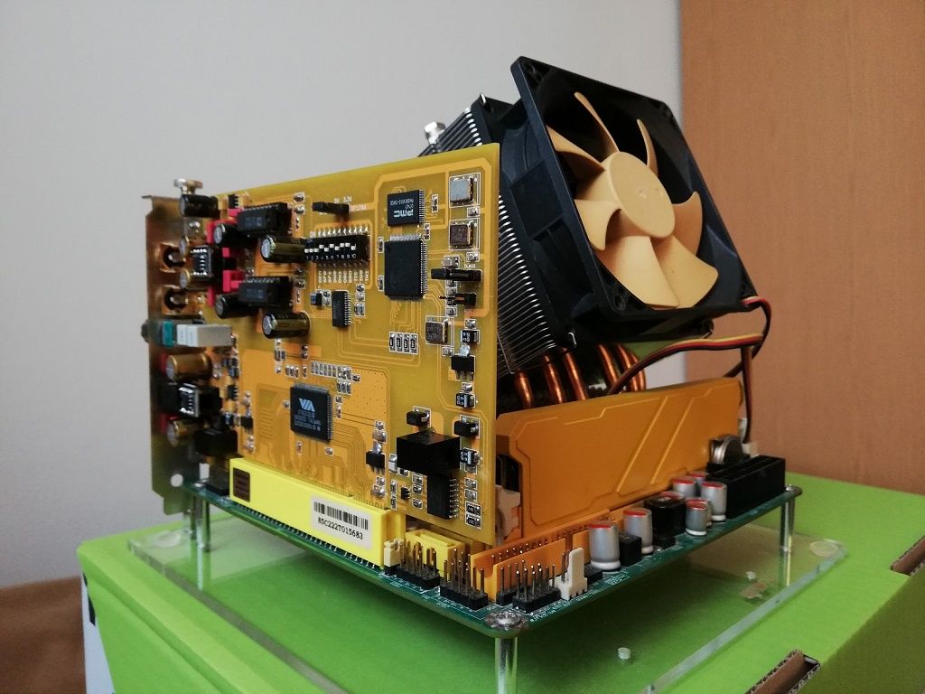

  • CM6631A-based PCI music player with AD1860/65 DACs

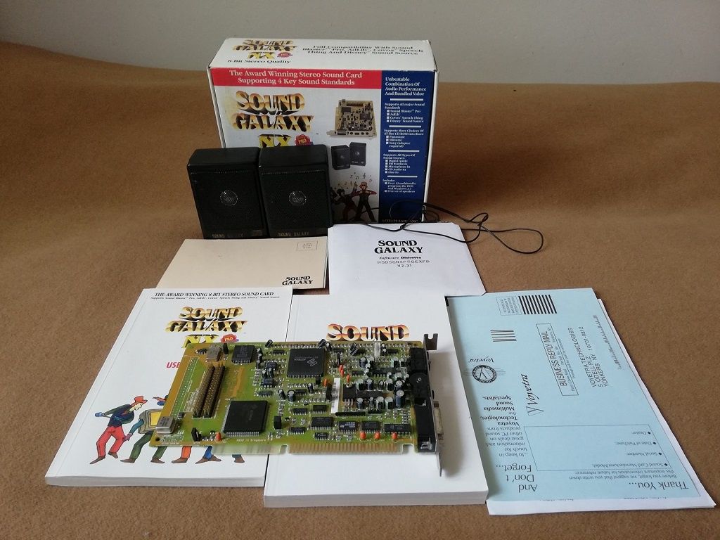

    #41 21920239
    _J23
    The card design is brilliant! I imagine the PCB must be quite expensive. My approach to an ‘audio card’ was a bit different. I was more interested in a music player (not MP3 :P ) for use on old systems/computers with a PCI slot. The priority was audio quality + the legendary sound of R2R converters… no, not Covox ;) ; the card is meant to sound good, not look good. I didn’t use the classic SAA7785 controller, VIA Envy24 or anything similar from that era, because I couldn’t find one to buy, and I didn’t want to desolder any components. In the end, I used a VIA USB controller – the CM6631A – with AD1860/65, and it sounds brilliant :) .
    Green PCI card with a knob, audio jacks, and many capacitors on a white background
    Expansion card with yellow PCB and a large fan on a heatsink, mounted on a clear standoff base
    Someone mentioned the company AZTECH. Here you go – it’s in the safe ;) , a complete box :D from the early ’90s.
    Sound Galaxy set: product box, ISA sound card, two speakers, and manuals on a beige background
  • CM6631A-based PCI audio card with AD1860/65 DACs
    #42 21920320
    CHOPIN66
    Posts: 657
    Rate: 252
    _J23 wrote:
    The card design is brilliant! I imagine the PCB must be quite expensive. My approach to an ‘audio card’ was a bit different. I was more interested in a player for listening to music (not MP3s :P ) on old systems/computers with a PCI slot. The priority was audio quality + the legendary sound of R2R converters… no, not Covox ;) ; the card is meant to sound good, not look good. I didn’t use the classic SAA7785 controller, VIA Envy24 or anything similar from that era, because I couldn’t find one to buy, and I didn’t want to desolder anything. In the end, I used a VIA USB controller – the CM6631A – with AD1860/65, and it sounds brilliant :) .
    75950cbcb0
    e2a8196540
    068a8242c5
    Normally the PCB would have been expensive, but as a new customer at Allpcb I got a $30 discount – the card ended up costing $15 instead of $45 – I had to extend it from 27 cm to over 33 cm in length. I had a riser for a Zenith motherboard made by the same company and paid $1.50.
    Blimey, that card of yours turned out really well, and it’s a PCI one :D
