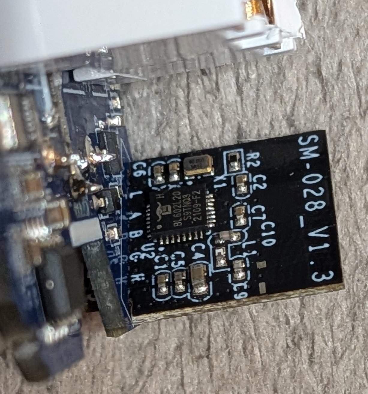

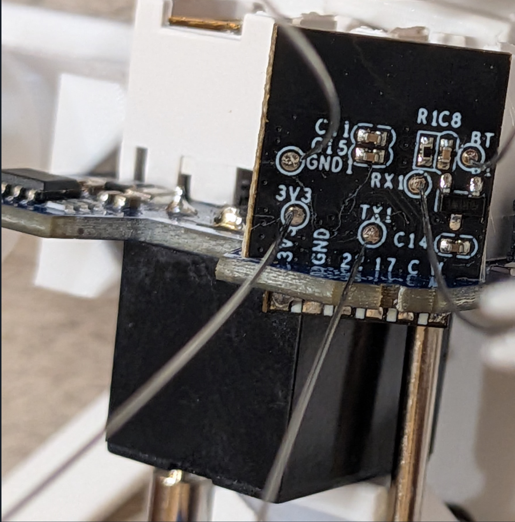

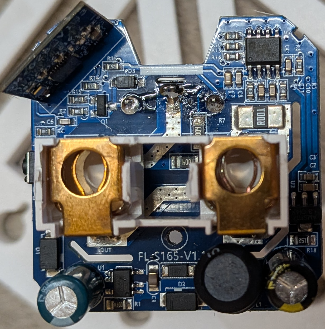

    Teardown and flashing of another smart plug:
    Elivco (eWElink);
    MB - FL-S165-V1;
    BL602L on SM-028_V1.3;
    BL0937
    The pins differ from similar models here:

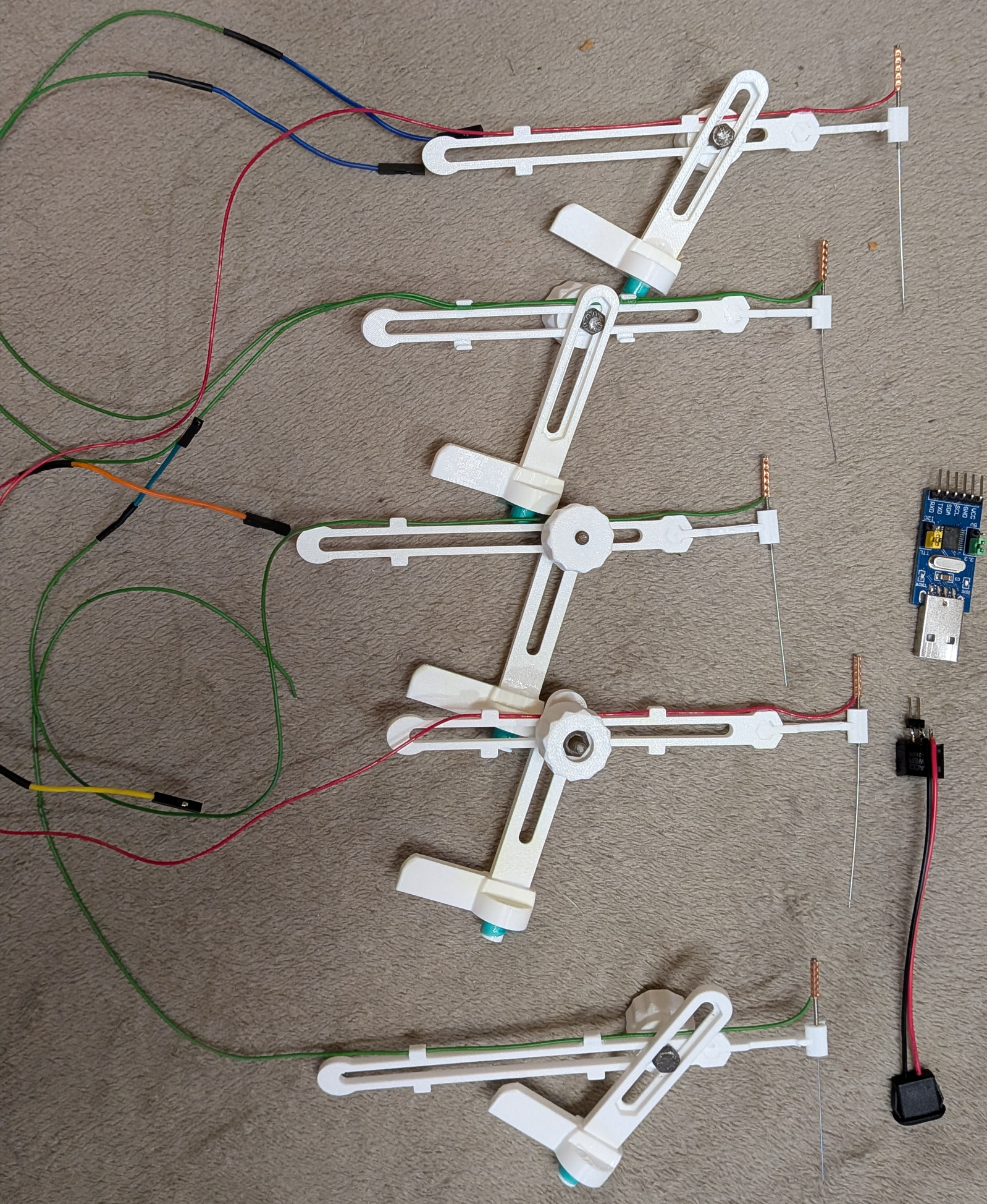

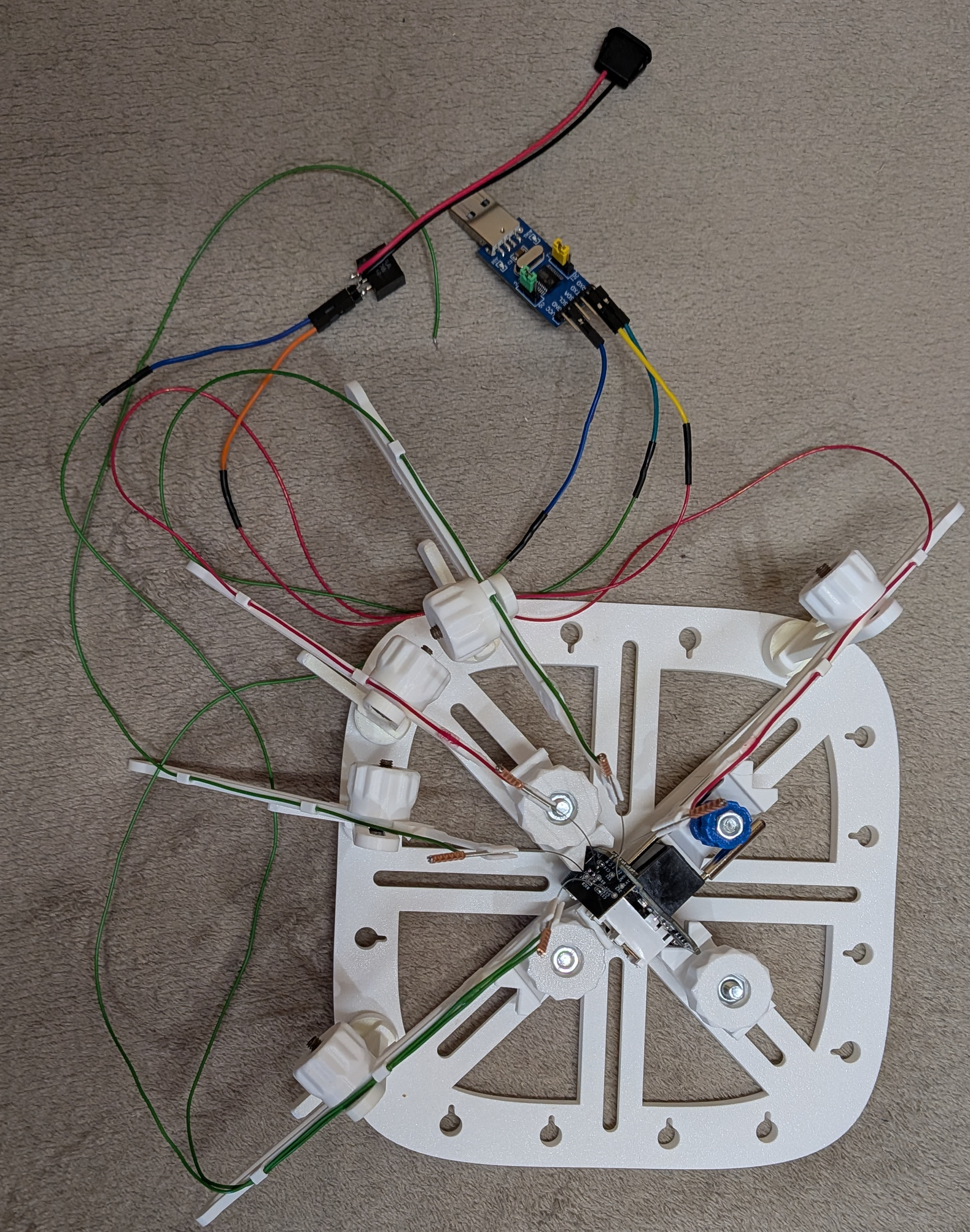

    Posts: 14770
    Rate: 12913
    It looks like you have a very nice setup with these probes. Still, take care - I can see that wires are very long, and that's not always reliable for IoT device flashing. I usually do my best to keep wires short, even keeping their less than 5 cm.
