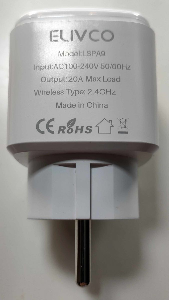

    The inside is exactly the same PCB as mentioned here with another socket case and a different relay.

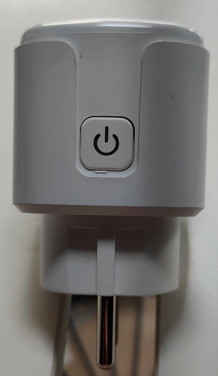

    ELIVCO LSPA9 smart plug with user manual and packaging ELIVCO smart plug with packaging.
    So, why another post? I think I might give some useful information here, so I hope it's o.k.
    (If there should not be a new post, for the same device, please move it into one of the other posts)

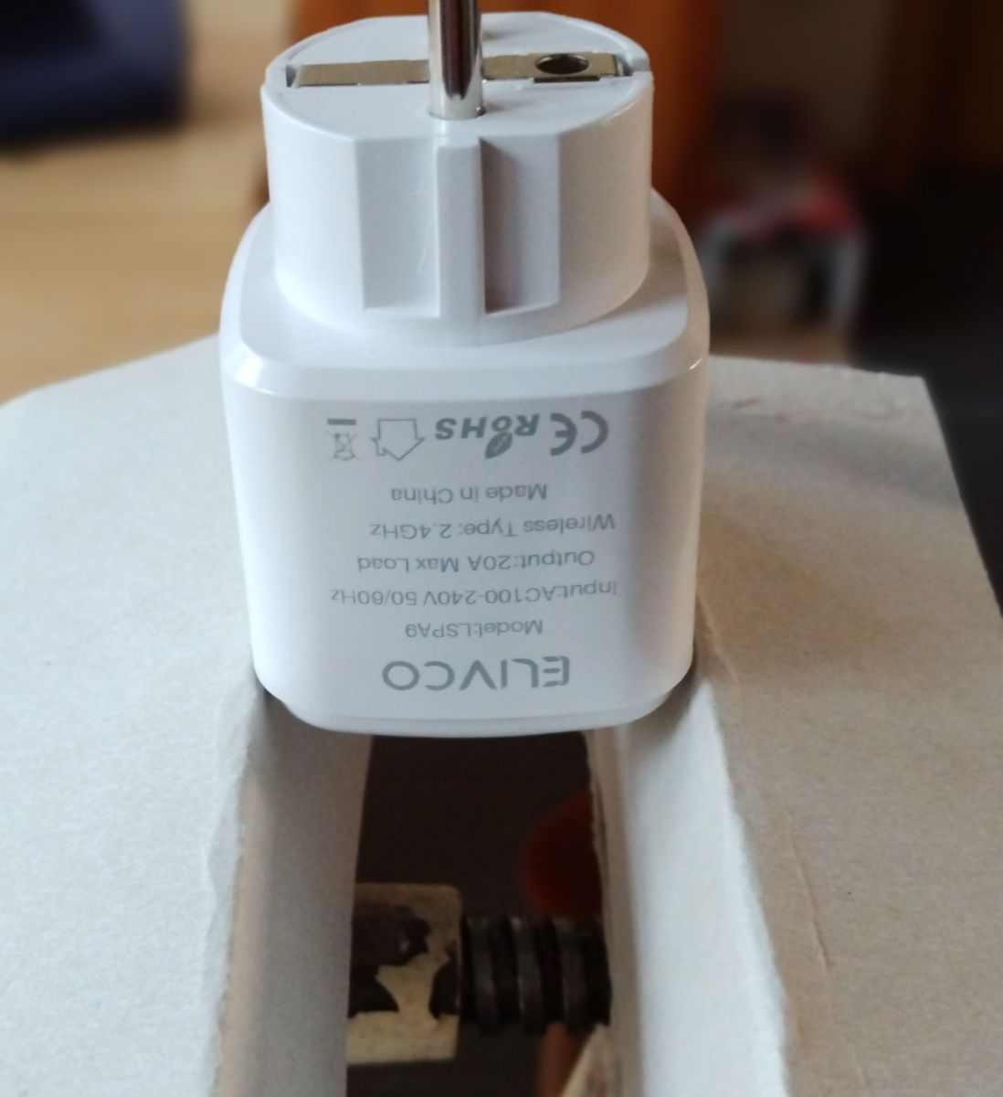

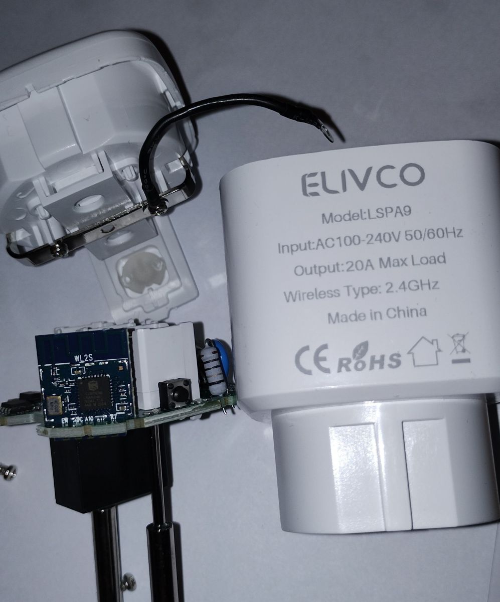

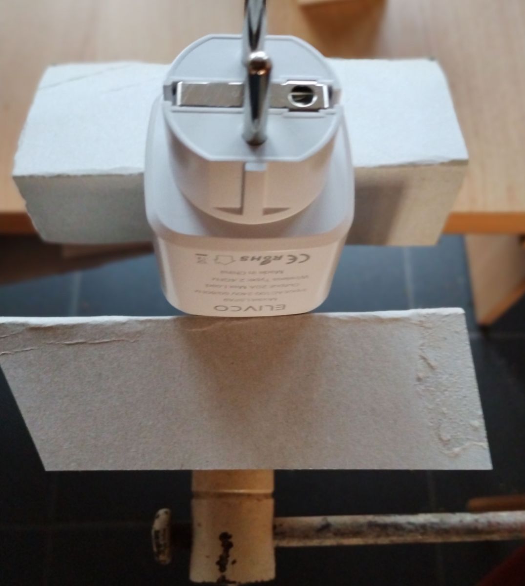

    First about opening the device:
    The upper and lower part are lightly glued together and the pressure on the sides should break it open.
    I opened the case with help of a vice, so you can apply pressure on the whole sides.
    Just use some thick paper or cardboard to avoid marks on the case.
    Electric plug placed between two wooden boards. ELIVCO plug held in a vise, viewed from the socket side.
    Turn the plug to put pressure on both sides. You will hear a light crack when glue is broken; you might also support the pressure by some light bending of the socket.
    (If you hear a loud crack, you probably applied to much pressure ;-) but I already opened five devices and never broke one...)
    Just keep pressing and turning the sides until the device pops open.

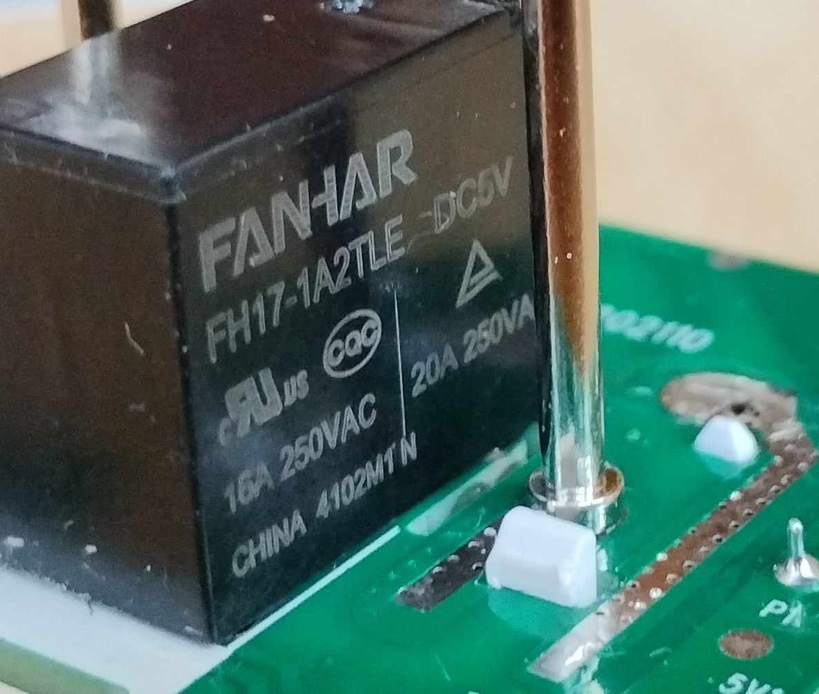

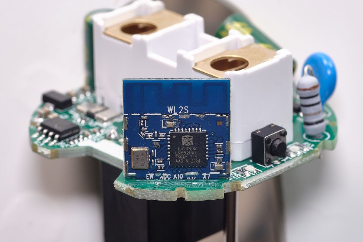

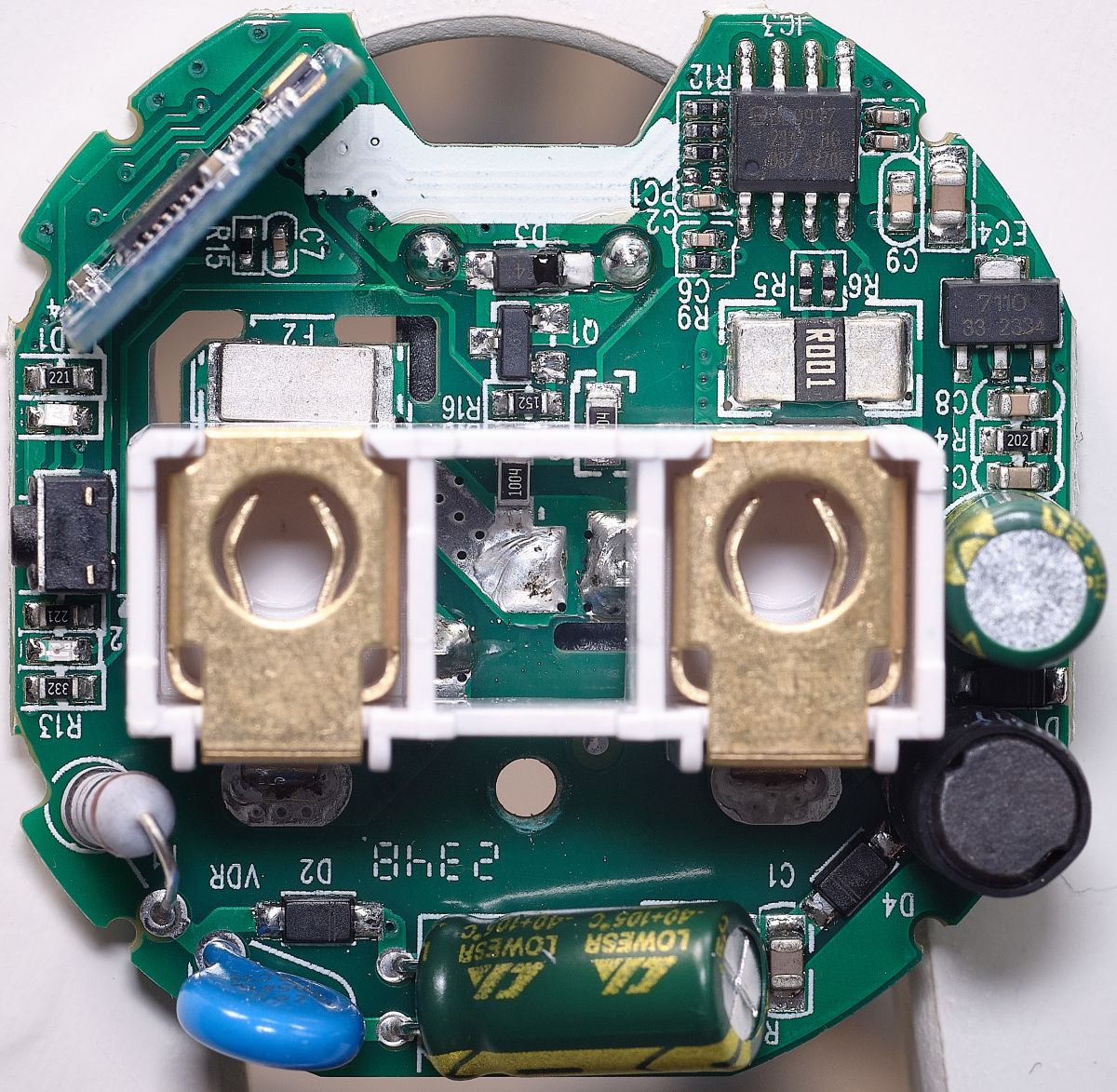

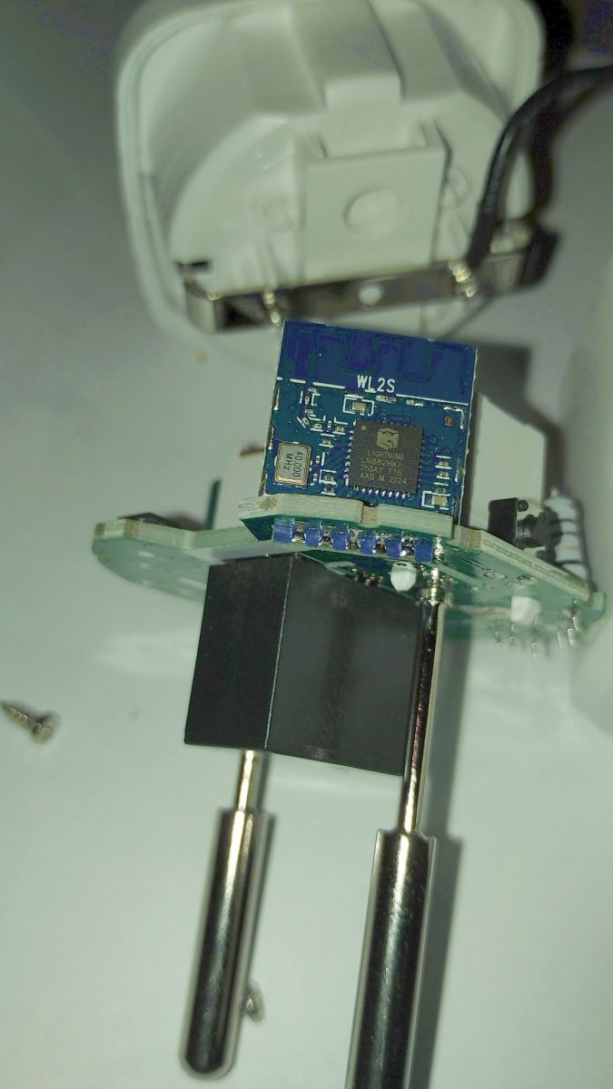

    The inside is a BSD342-2110 PCB with "WL2S" labeled LN882H module and BL0937 energy metering chip. The relay shows 16A and 20A, so it's your choice, what to believe ;-):
    ELIVCO model LSPA9 plug with removed casing, showing internal PCB with WL2S module.
    Close-up of PCB with LN882H module and markings. Image showing the inside of a device with a WL2S PCB. Image of a FANHAR FH17-1A2TLE-DC5V relay on a PCB.
    The bootlog for the shipped firmware is visible on Tx1 (UART1 is on the back side of the WL2S module), but flashing is done via Rx0/Tx0 (soldered to main PCB).

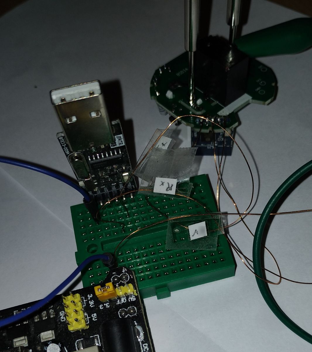

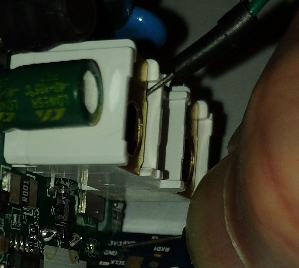

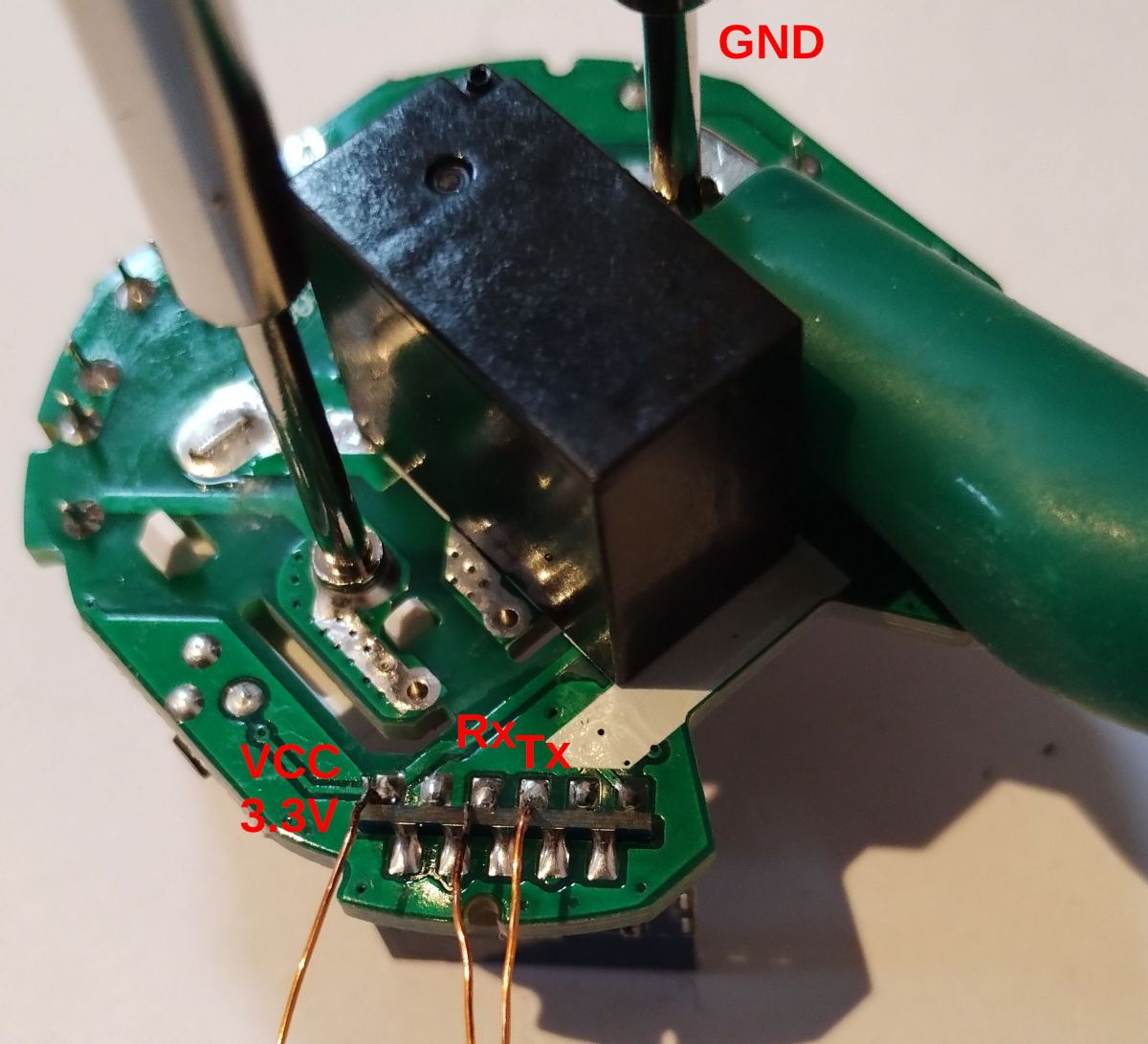

    Now to some new findings (I hope): As I am a lazy guy, let me tell you, that in fact you only need to solder three wires :-)
    VCC (3.3 V)
    RX
    TX
    You can use the plugs power pin opposite to the LN882H module as GND - no need to solder here!
    Close-up of a PCB with labels VCC, RX, TX, and GND Breadboard with connected wires and USB module..
    If there was any doubt, now you know for sure that you should never try to use the free GPIOs outside the plugs case: For at least GND will be connected to the high voltage live wires!
    Regarding flashing you need to short pin A9 to GND - but this was not necessary for the whole flashing process:
    I shortened A9 for some seconds after powering the device up - you will see if you missed the point, if the device starts flashing its LED.
    Close-up of electronic components on a PCB with wires soldered to them.
    It works o.k. with the shown wires from a breadboard, for other plugs I used a testing pin from a multi-meter, this won't bend so easy.
    It didn't work every time, I had to give it some tries, but was successful with all plugs in the end.
    Remember, since we used the power pin for GND, we have it present on the upper outlet socket, as you can see on the picture.
    For you might need to retry several times: If your PCs keyboard is not reachable from the plug while shortening the pin, I had a small batch file running to retry every five seconds.

    Then flashing with the speed of 115200 (I didn't manage to use 200000, that might be, because of too long wires, the PCB not desoldered but still in the plugs PCB, or some other reason).

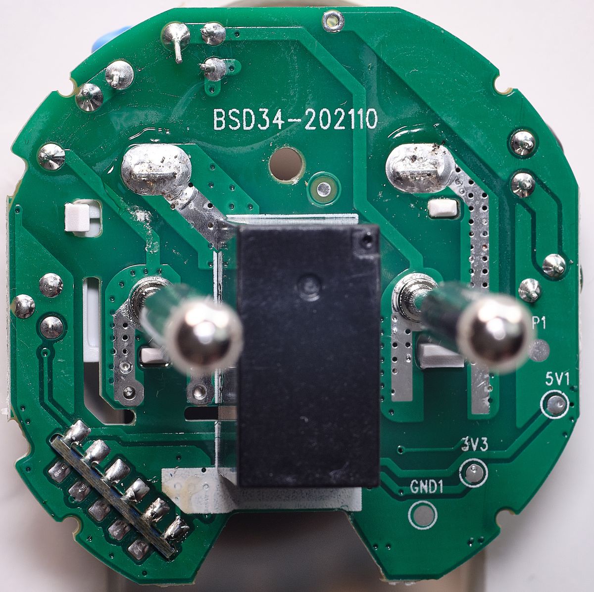

    I bought the same plug as OP. I can see on the order details that it is even the same item number on AliExpress.
    Here is my plug and package:
    Close-up of an ELIVCO smart plug with technical specifications. White plug with a power button on the front. Smart plug packaging with Amazon Alexa and Google Assistant information. Label of Tuya smart plug packaging with SKU, barcode, and manufacturer information. Smart plug packaging with technical specifications and manufacturer information.
    And some high res pics of the internals. Maybe useful for someone:
    Close-up of the interior of an electronic USB plug showing components. Close-up of an electronic module WL2S mounted on a printed circuit board. Image of the interior of an electronic plug with visible circuit components and marking BSD34-202110.
    Before flashing the Open Firmware i dumped the original one:
    LSPA9_o...bin (1 kB)You must be logged in to download this attachment. LSPA9_fl..h.bin (2 MB)You must be logged in to download this attachment.
    Until now, everything works well :)

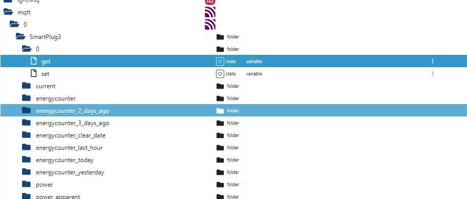

  • Create a writable mqtt set state in ioBroker
    #24 21064461
    io2345
    Posts: 273
    Rate: 7
    You're right, it does send MQTT message on button press, according to the Device's webpage log.
    The solution for ioBroker is much easier than expected: There is no need to have cmnd- and stat-tree in mqtt-adpater-tree at all.
    Instead, create a new entry in the same folder, where the "get" value is displayed, with the only difference that it says "set".
    So, all you do is create a new state with name "set" as type "number" and role "variable" (readable and writeable) under the objects-tree
    mqtt.0.<your_client_topic_name>.0.
    Screenshot of ioBroker folder tree highlighting the get and set states.
    The "set" value is used to actually switch the device remotely, whereas the get value reflects the current state of the plug, which can also be changed by pressing the hardware button on the plug.

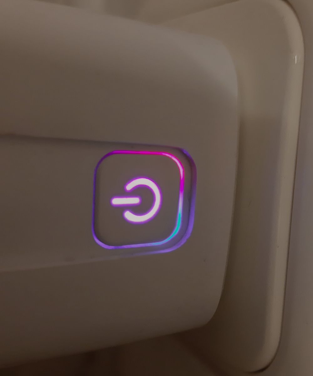

    Last (?) question: The LED on the plug is in Tuya-Version blue when plug is switched off and red when plug is on.
    In OpenBK version the LED is blue when off, but purple when on, because both blue and red LED inside are lit. Can this be changed to red?
    Power button icon on a plug with purple backlight.
  • #26 21067095
    rufus4
    Posts: 65
    Rate: 9
    You can set "WifiLED_n" to "WifiLED". Then WifiLED is only lit while connection process.
  • #27 21067125
    io2345
    Posts: 273
    Rate: 7
    Thank you, much better: LED off when Power off, LED red when Plug has Power. Perfect.

    ... or, if you like the Tuya style, you can set A10 to "LED" and it will be blue if power is off.
    (If you use the plug in place with low light, I like to find the button without turning on the light ...)
    That's the good point in using OpenBeken: Just configure it to fit yor needs ;-)
