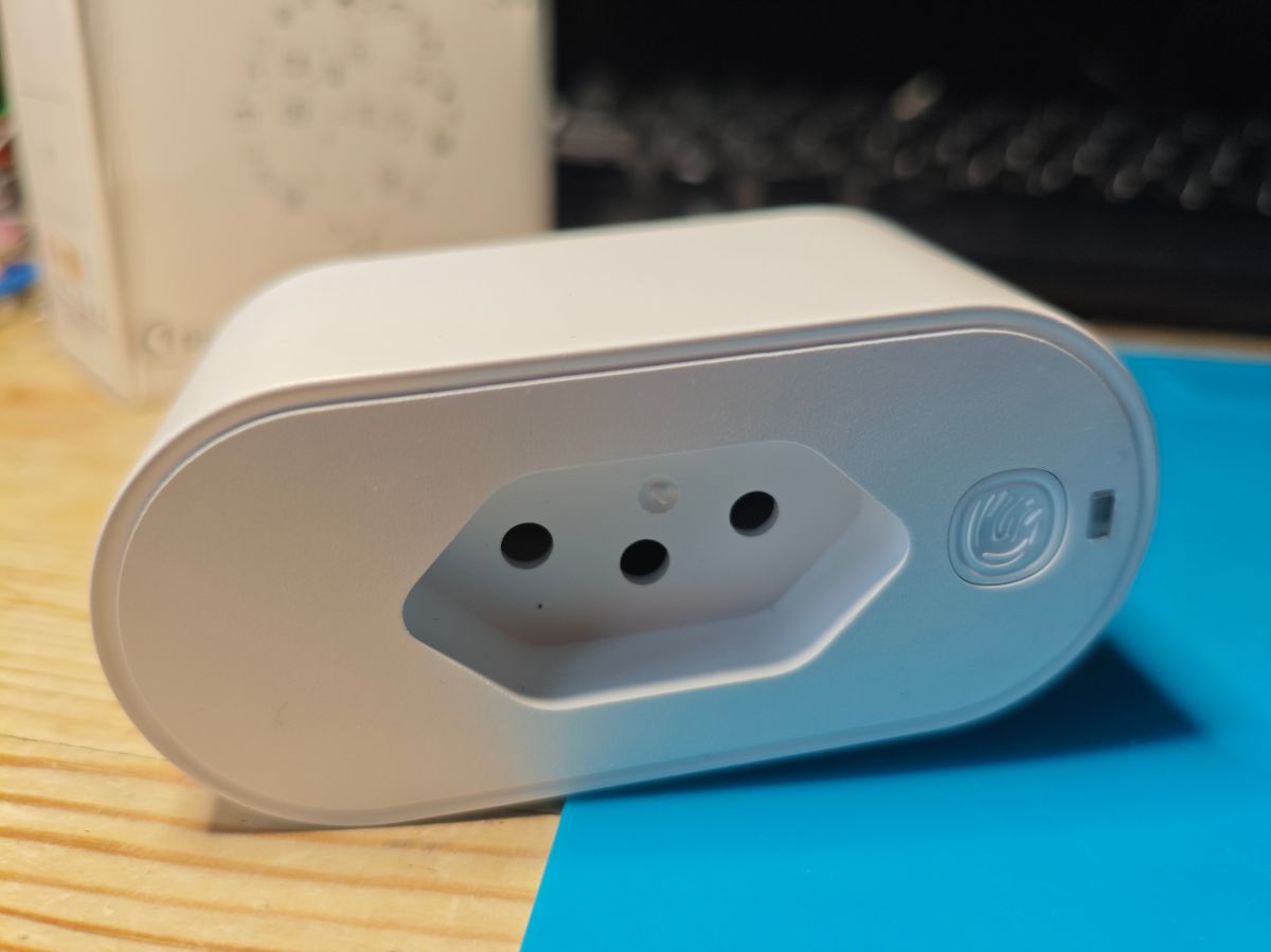

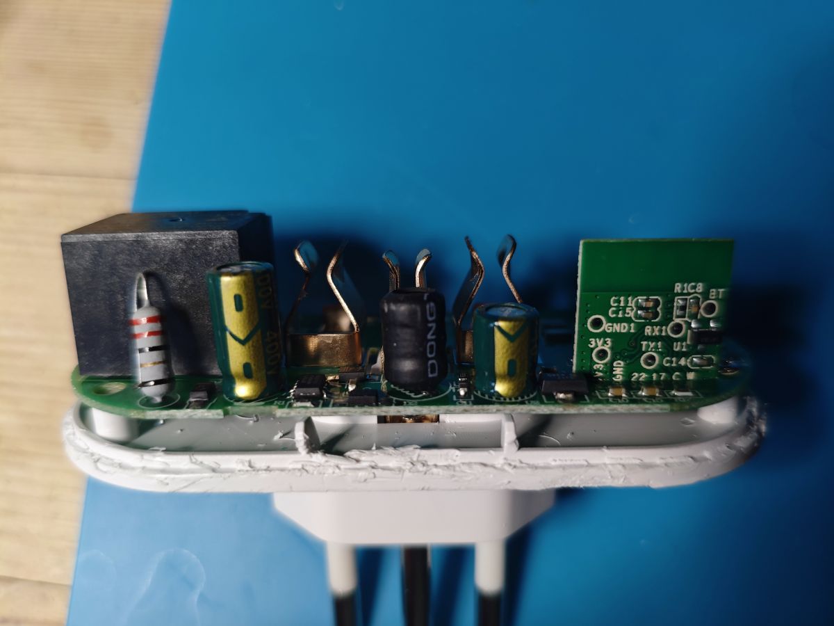

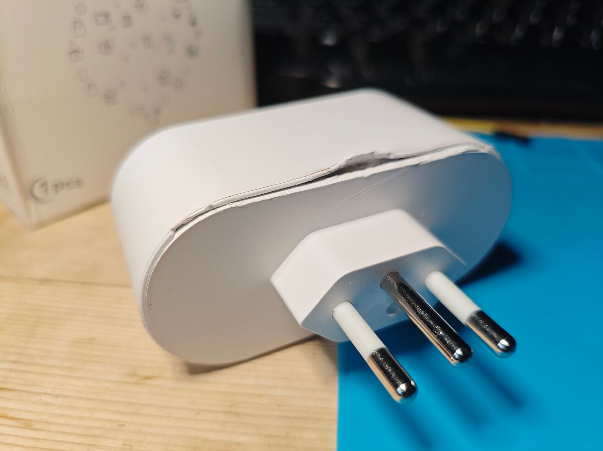

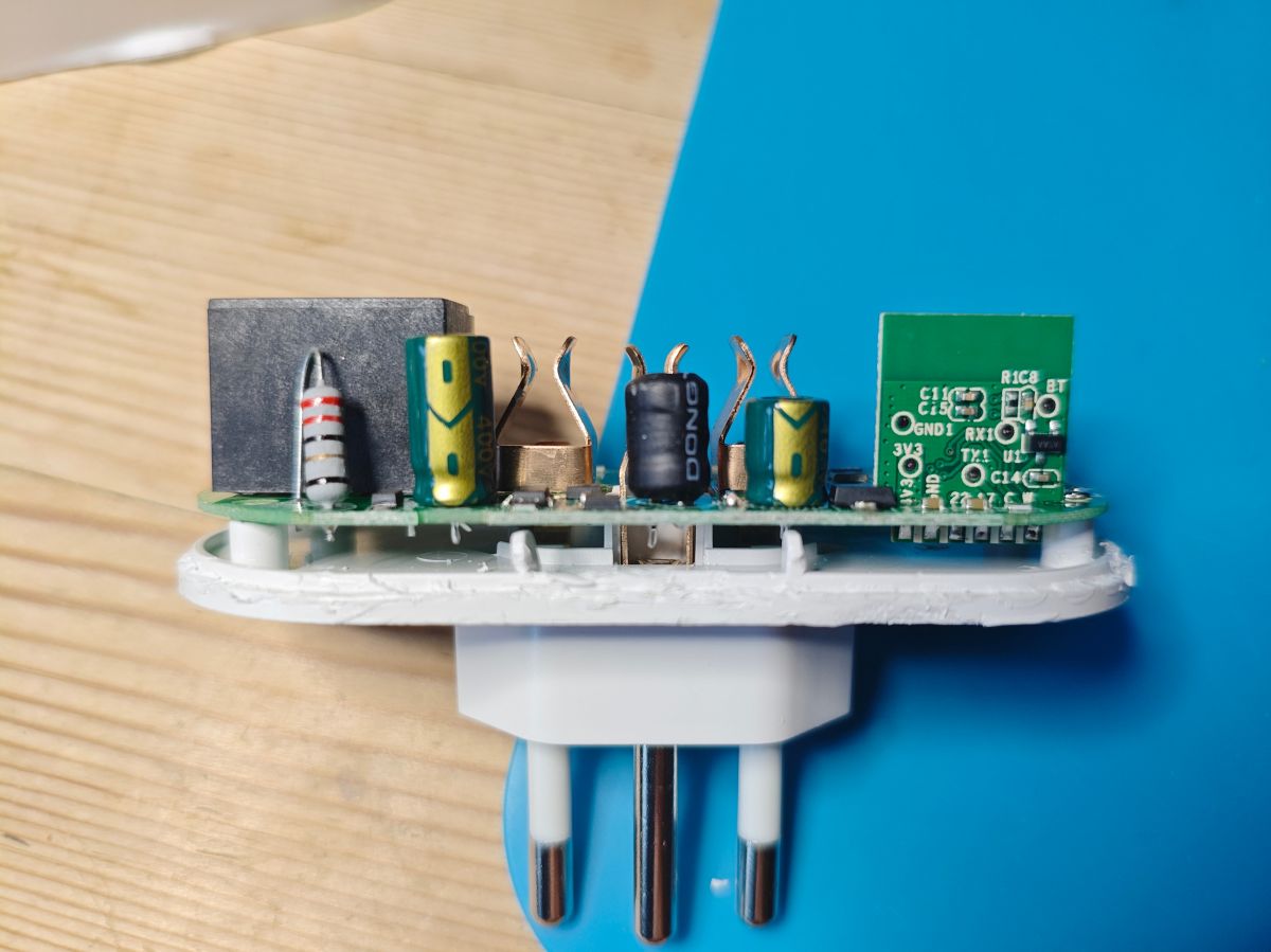

    Hello. Here's a quick look at a Brazilian/South American eWelink smart plug with power monitoring (BL0937) that I bought from Ali Express. I was looking for an SM-039, but instead got a standard SM-028_V1.3. A Bouffalo Labs BL602 module manufactured by Trolink.
    https://www.aliexpress.com/item/1005006023269137.html
    eWelink WiFi Smart Plug 16A with power monitoring feature.

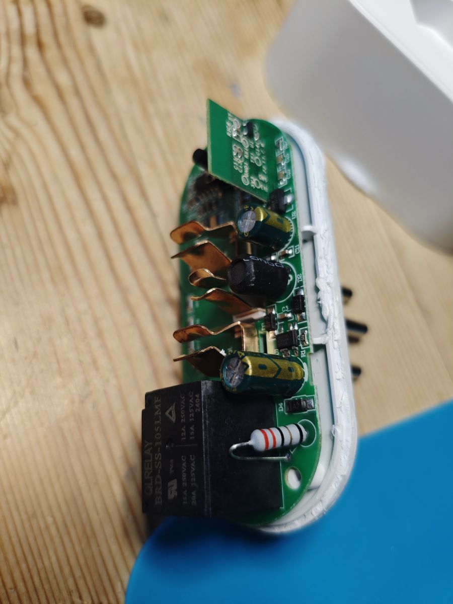

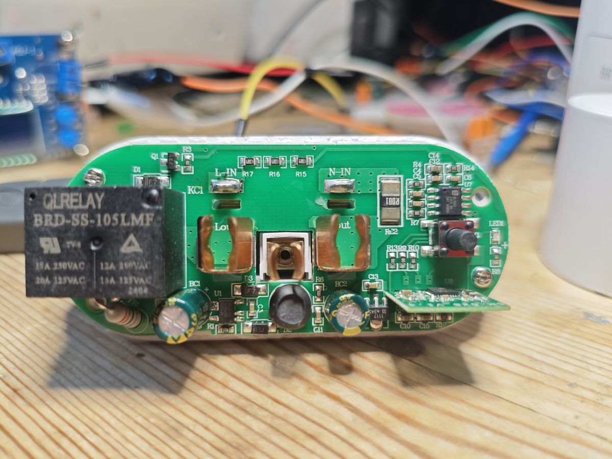

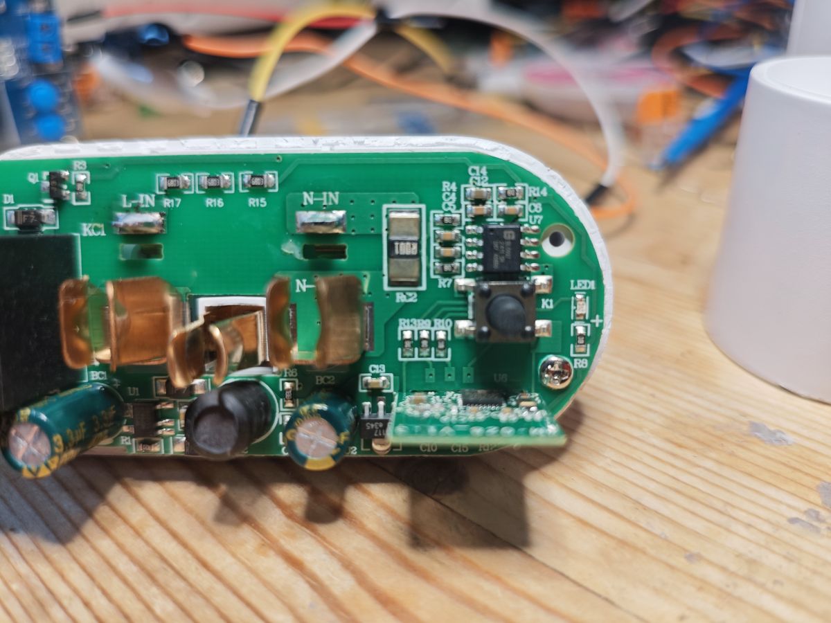

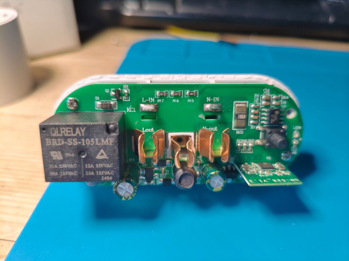

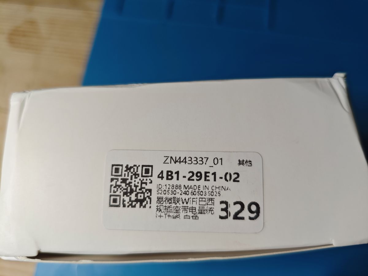

    External and internal pictures:
    Sticker with barcode and Chinese characters on a box. Box of a smart plug with various home appliance icons.
    Interior of eWelink smart plug with relay. Internal view of the eWelink smart plug with electronic components. White smart plug with Brazilian standard on a wooden surface. Brazilian eWelink smart plug with three holes on the front. Packaging of Brazilian eWelink smart plug. Packaging of the eWelink smart plug with power monitoring BL0937. Smart plug eWelink with open casing and wires. Interior of eWelink smart plug with power monitoring Interior of the eWelink smart plug showing electronic components on a circuit board. Interior of a smart plug with visible electronic components on a circuit board. Interior of an eWelink smart plug showing electronic components
    (pics are a bit naff. Might retake)

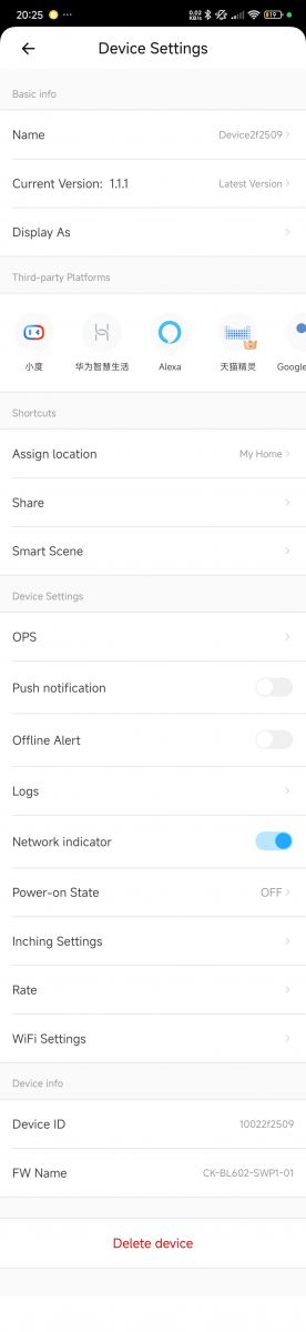

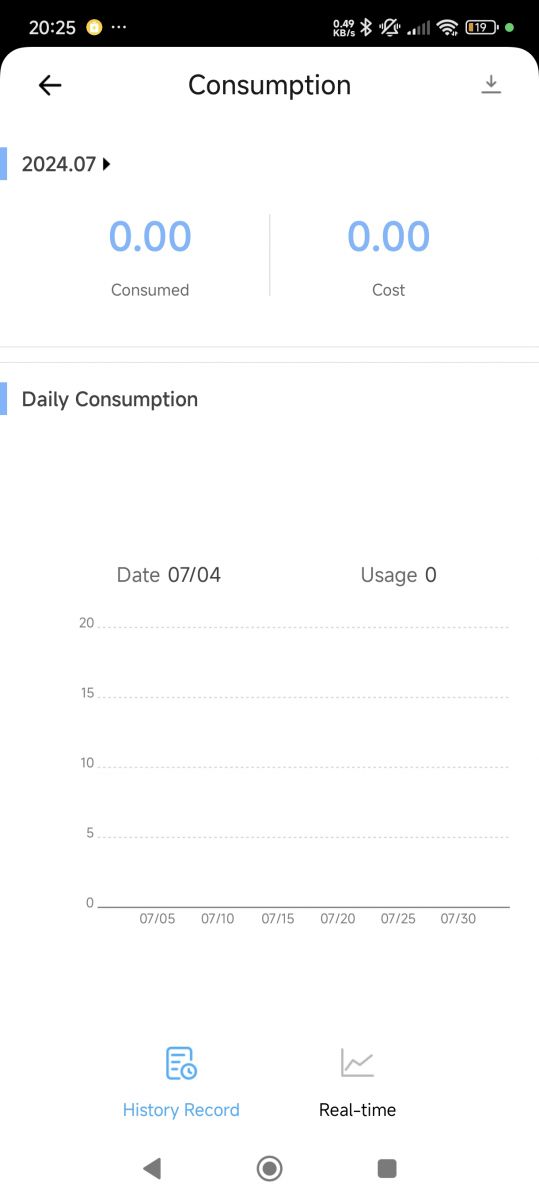

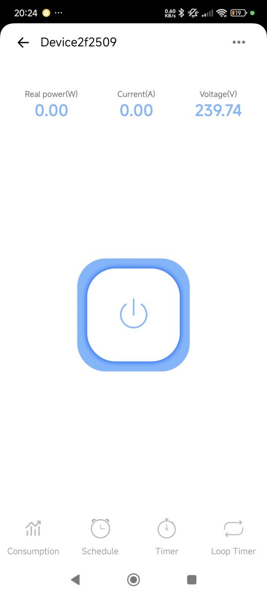

    eWelink app when paired:
    eWelink app screen showing energy consumption at zero. Screenshot of the device settings in the eWelink app. eWelink app interface displaying a smart plug device view.

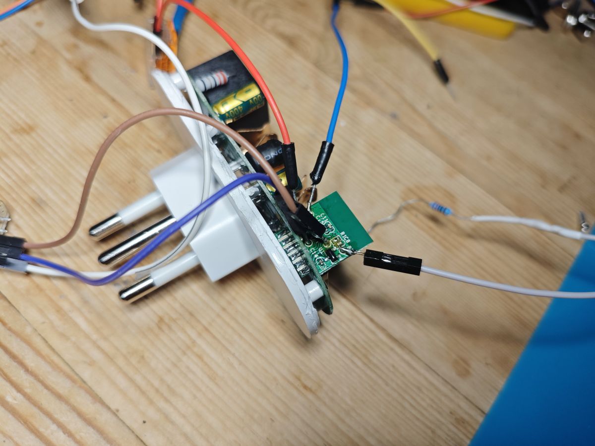

    After soldering TX. RX, 3V3 and GND, the boot log captured:
    And flashID read by BL DevCube 1.8.9
    Following the procedure in Backup and Restore of Factory Firmware on Bouffalo Lab BL602/LF686 IoT Smart Devices to backup the factory fw, I attach the result of that.
    One interesting thing was that I had no issues with power with this BL602. It was fine on factory and OBK at 3.3v and not using particularly short wires. I wonder if the later revision SDK/bootloader has anything to do with that.

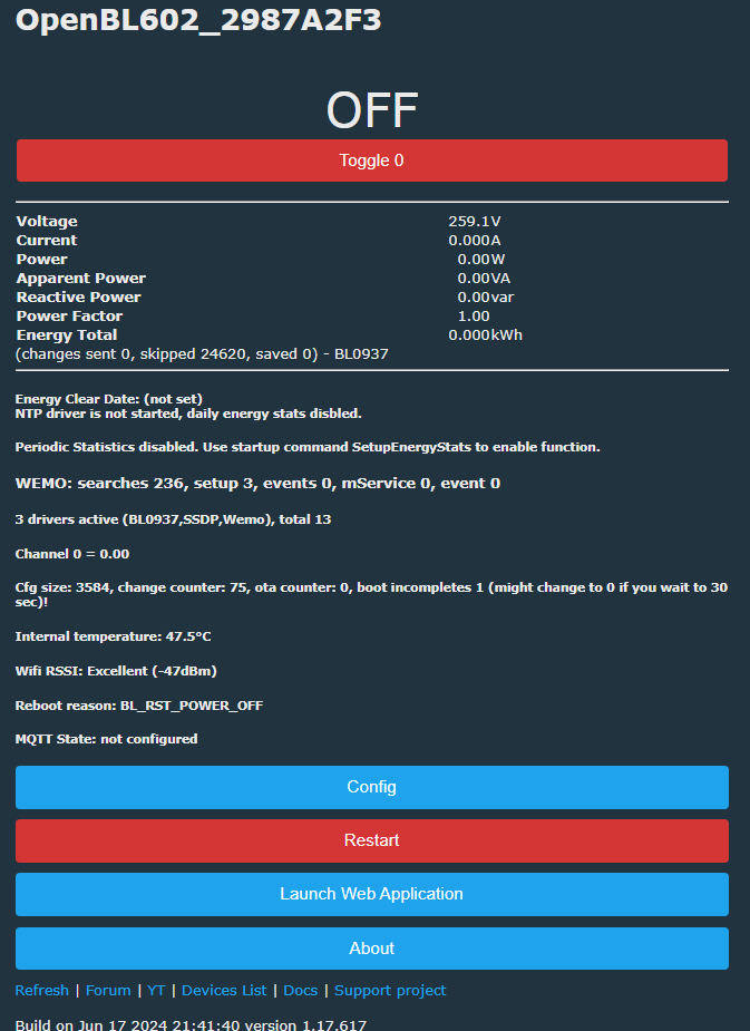

    After flashing to OBK I used the GPIO doctor to determine the below. Noting the limited number of GPIOs available on the SM-028_V.1.3 module helps to narrow the possibilities.
    "2": "Rel;0",
    "17": "Btn;0",
    "20": "LED_n;0",
    with that combination known we may not have to guess the 3 BL0937 GPIOs. Searching for "2": "Rel in https://github.com/OpenBekenIOT/webapp/blob/gh-pages/devices.json reveals 1 device that matches GPIOs 2, 17, 20 and has a BL0937 and is a BL602. This whole template does indeed match.
    OpenBL602 application screen with power monitoring details
    and so the template is:
    and PR to add to devicelist https://github.com/OpenBekenIOT/webapp/commit/ae832cd99f02c0495595845dfa297702005b9bf2

    Hey there. I bought one of this too, but I can't load the firmware OTA, and can't flash it.
    OTA the problem seems to be with the software, as it loads a page to enter the network credentials, but it always fails. I believe it may be some restriction in the eWeLink firmware (also in version 1.1.1).
    But when I try to flash it via UART, it doesn't complete the handshake.
    From what I've seen, this module doesn't need to have the boot "button" pressed (it's not mentioned in the link above), but I'm not sure if it's necessary to do some other procedure.

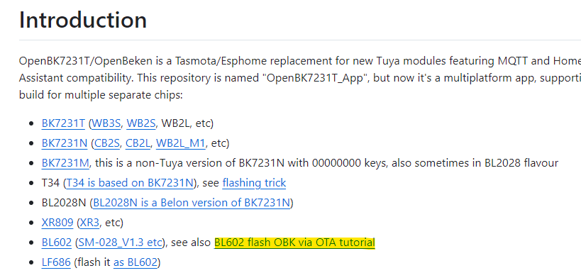

    not sure what you mean by this. I'm not aware of an OTA exploit for these to go from eWelink factory firmware to OpenBeken. You will have to UART flash to free from the cloud. The OTA exploit for Magic Home BL602 devices mentioned here https://www.elektroda.com/rtvforum/topic4050297.html does not apply to this device.
    This distinction could be made clearer for users who start their journey here and see that option.

    handshake failure will be down to the BL602 not being in UART download mode, the cables are not connected correctly or the cables are too long.
    To get into UART download mode the BL602 must have the BT/BOOT/GPIO8 pulled high with a 10k resistor to 3.3v.
    This is demonstrated and detailed:
    https://www.elektroda.com/rtvforum/topic3889041.html
    https://youtu.be/bs0ylC6xRs0?si=JeoRk_48GIZEWxxd
    full factory backup prior to conversion to OBK can be achieved using https://www.elektroda.com/rtvforum/topic4051649.html
    don't forget to use an external 3.3v PSU rather than rely on the USB-TTL adaptor's 3.3v
  • Poor solder joint fixed flashing issue; asks about separate LED control
    #5 21215409
    eph2
    Forget it, my problem was one of the cables that was very poorly soldered to the board.
    I was able to flash it using a CP2102, and without an additional external power supply. Everything worked perfectly.
    By the way, thank you very much for the template settings!
    You guys are awesome!
