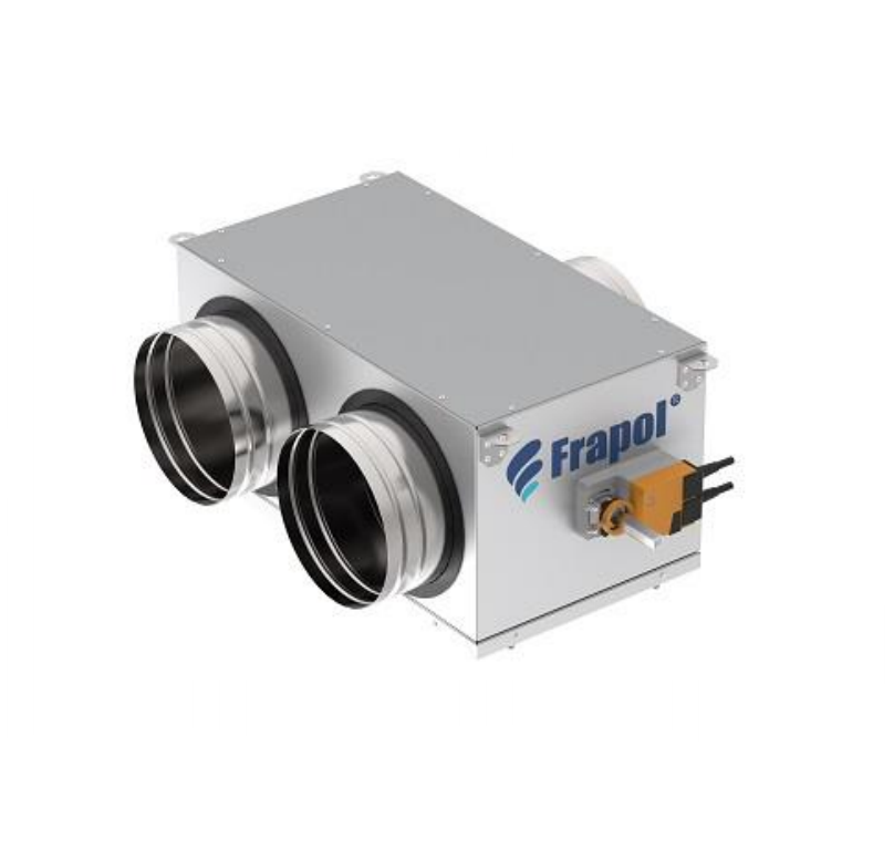

    kotbury wrote:
    But when it comes to heating – which is, after all, the main reason I bought it – there’s one snag. These portable units don’t have a defrost function at all (nor a built-in heater) and when drawing in outside air at, say, -10°C, the evaporator – which acts as a condenser when heating – will freeze over sooner or later
    Can it be upgraded?

    PS. What benefit might the shut-off damper mentioned above provide? And the smallest version costs more than my entire air-conditioning unit.

    kotbury wrote:
    PS. What benefits might the above-mentioned shut-off damper offer?
    This is just an example photo. You don’t need that much outside air to ventilate a small flat. You can draw some from the room and some from the duct. You can even automate this and set a mixed cycle, either on a timer or based on various factors.
