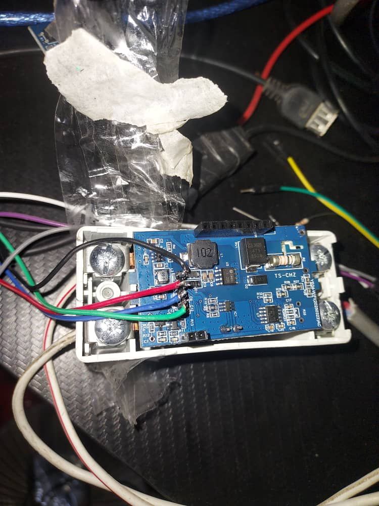

    1. Hardware and configuration
    Target device: Tuya smart prepaid switch (based on TuyaMCU, 9600 baud transmission speed).

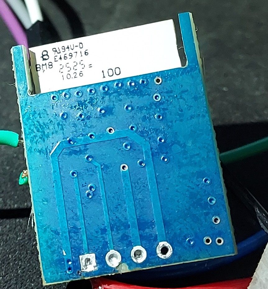

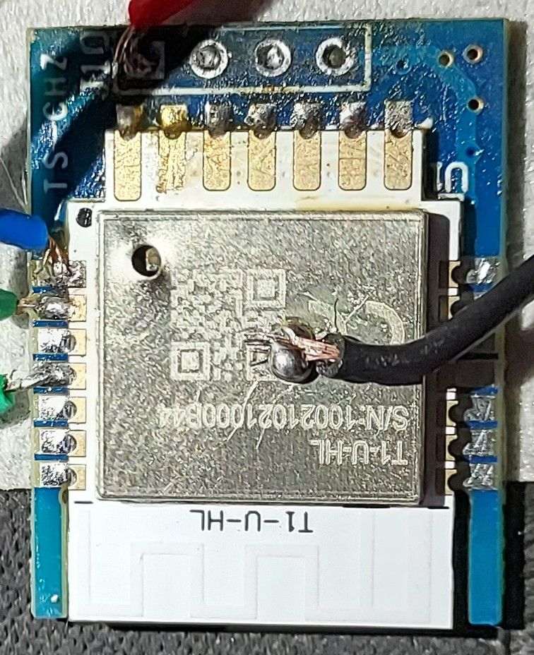

    Wi-Fi module: BK7238 (internal T1 platform).

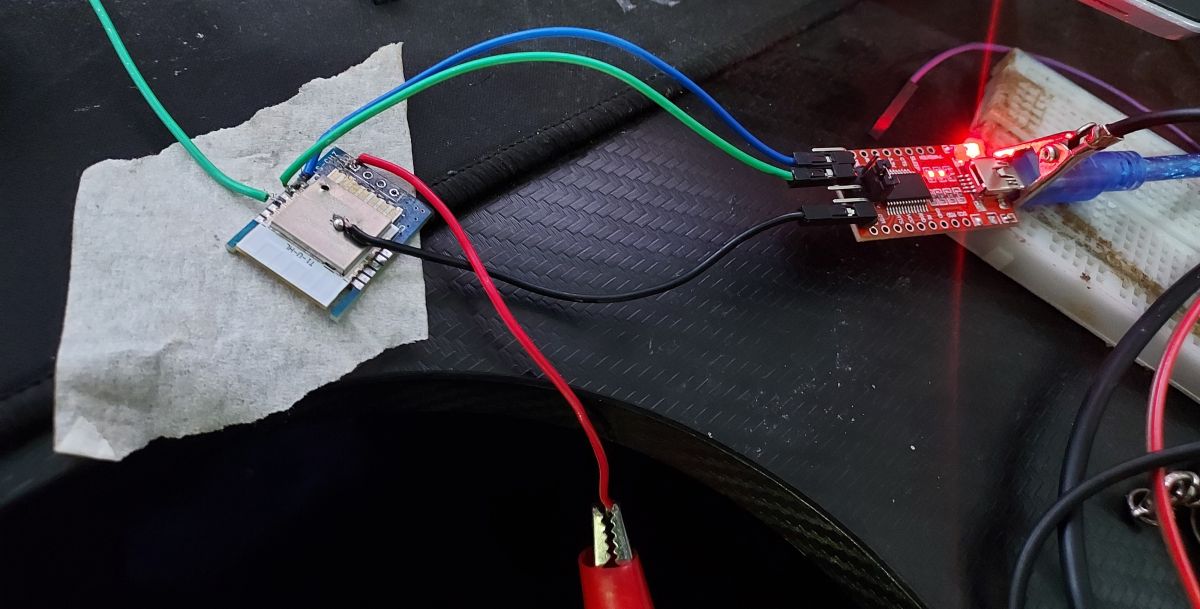

    Power supply: External laboratory power supply set to a stable 3.3 V (capable of delivering high current), monitored using an ammeter.

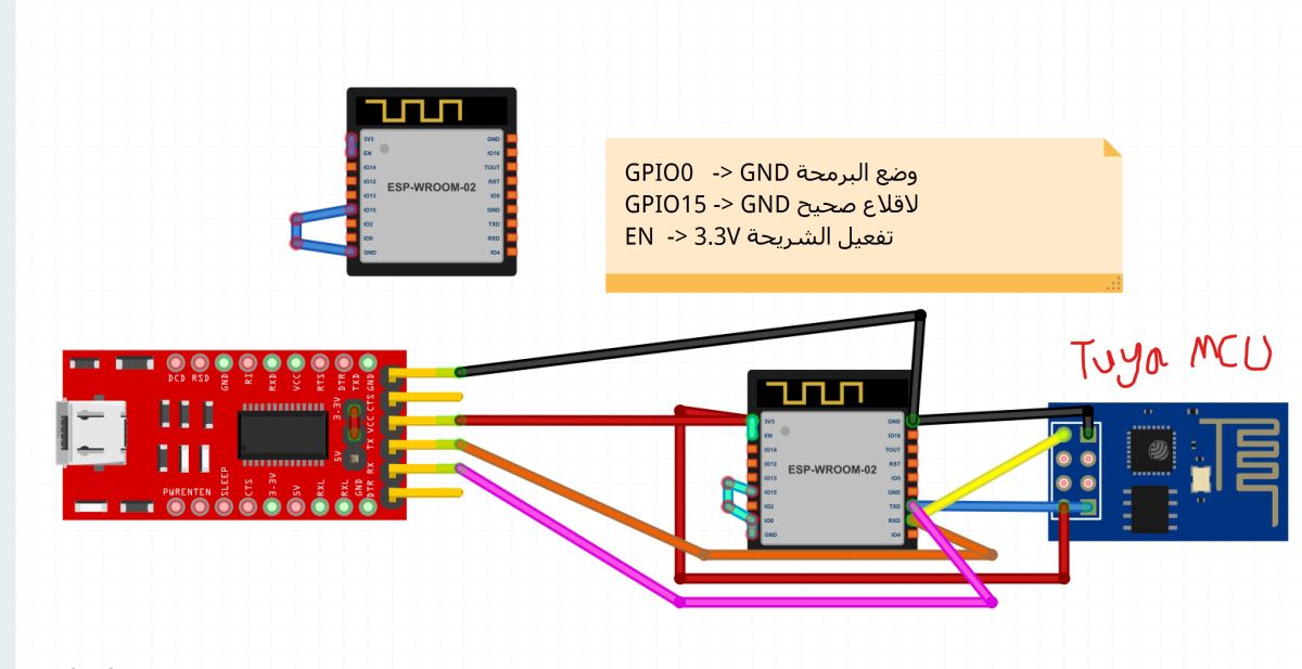

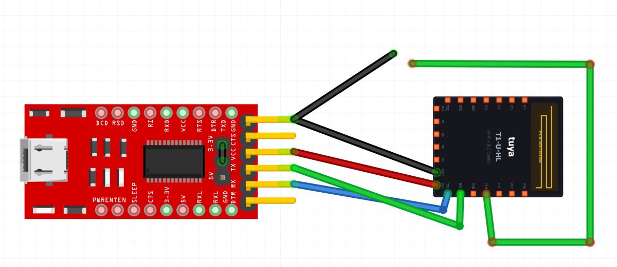

    UART adapter: Initially an FT232RL (which later failed the loopback test); I am currently using an Arduino Uno as a USB-TTL adapter in pass-through mode (the RESET pin connected to GND).
    Connections: The common ground (GND) is 100% correctly connected between the laboratory power supply, the circuit and the UART adapter.

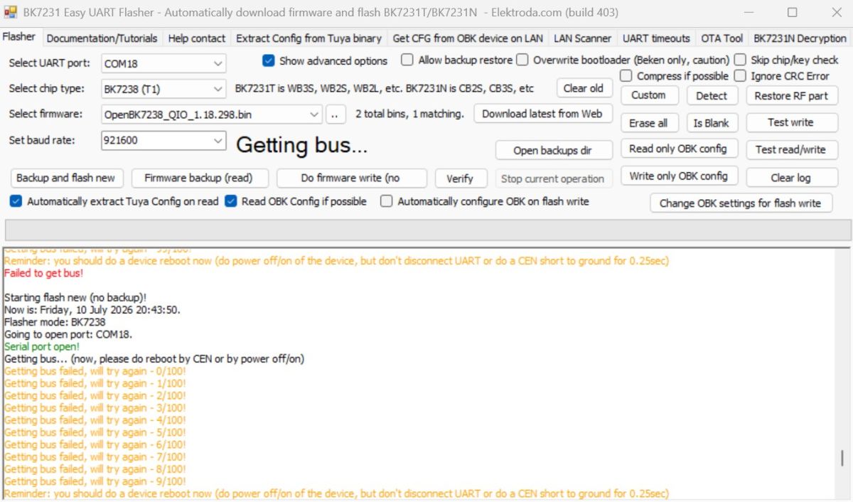

    I clicked the flash button to upload the OpenBeken firmware. The process began but ended in an error precisely during the first stage of memory erasure, with the following message:
    failed, will retry! Erasing block 0x00...failed with serial.BytesToRead 0 (expected 16)
    Phase 3 (Current status):
    Since this error occurred during memory erasure, the chip appears to be in a state of partial software failure (‘soft brick’). Every time I try to reprogram it, I get an endless loop of errors:
    Getting bus failed, will try again - 0/100!
    Getting bus failed, will try again - 99/100!
    Failed to get bus!
    3. Diagnostic steps already carried out (over 100 attempts!)
    To save you time, below are all the tests I have already carried out:
    Power cycle synchronisation:
    I left the 3.3 V cable disconnected, clicked the ‘Flash’ button in the GUI, and precisely at the moment the message appeared:
    Getting bus... 0/100
    I connected the 3.3 V cable to produce a sharp rising edge on the power supply. There was no response.
    Resetting the CEN pin:
    I left the power on, started the flashing process and, for about 0.5 seconds, shorted the CEN pin to GND during the “Getting bus” loop. I also tried the ‘Woodpecker’ method (rapid, repeated shorting of the pin to GND). To no avail.
    Diagnostics using an ammeter:
    The chip draws a normal current in the range of 30 mA to 80 mA during operation, which indicates that it has not been physically damaged. When I short-circuit the CEN pin to GND, the current draw drops to around 0 mA, which confirms that the internal reset circuit is functioning correctly.
    Baud rates:
    I tried changing the programmer’s baud rate to 115200 baud, and then setting it back to 921600 baud.
    Changing the UART adapter:
    After the loopback test on my FTDI adapter failed, I switched to using an Arduino Uno (RESET connected to GND) as a serial bridge. (Note: in this configuration, I connected TX to TX and RX to RX as required for this workaround).
