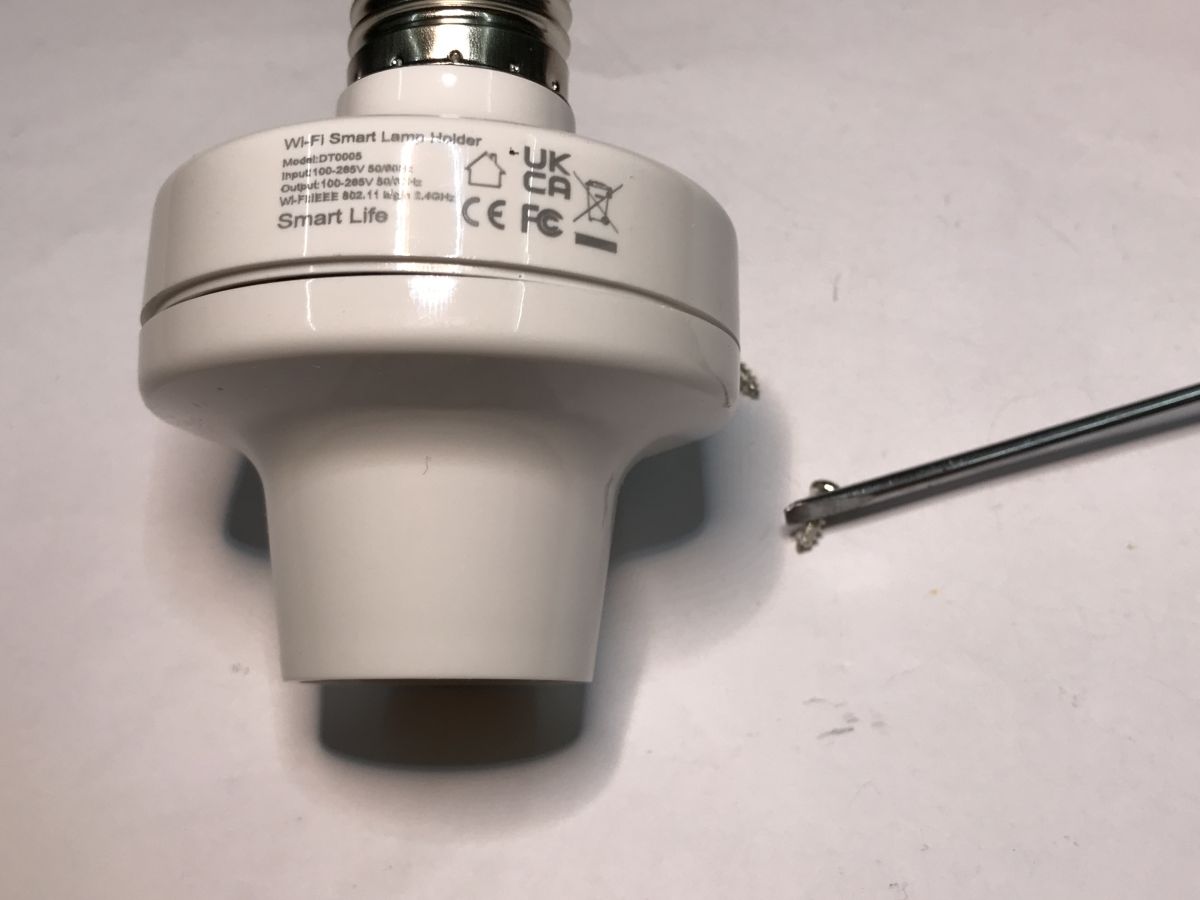

    The adapter shown here is fitted between the lamp holder and the bulb’s thread; it allows you to control the light via Wi-Fi and is built around a relay. It normally works with the Tuya app, but I’m going to flash its firmware, which will allow me to connect it to Home Assistant.

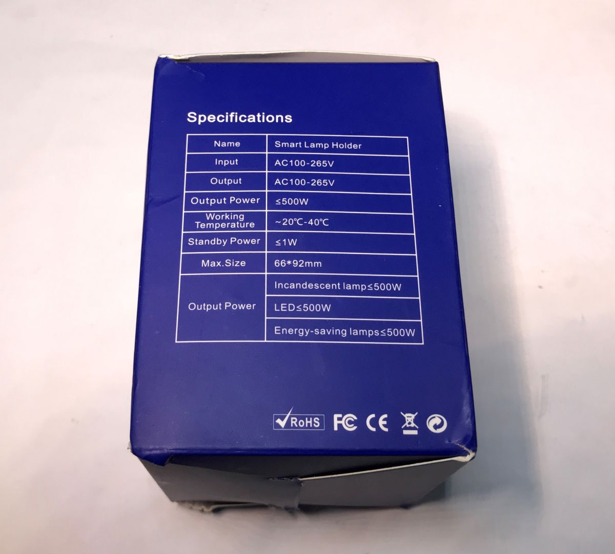

    Let’s start with the markings on the packaging. The product model is TYWI-BL-E27.

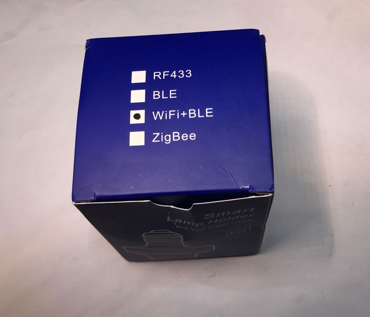

    The ‘WiFi + BLE’ marking suggests the presence of a BK7231 inside. If it were an ESP8266, the marking would simply say ‘WiFi’.

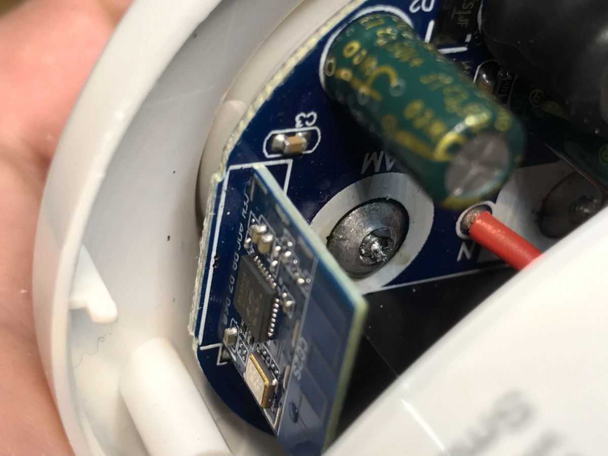

    Inside the TYWI-BL-E27

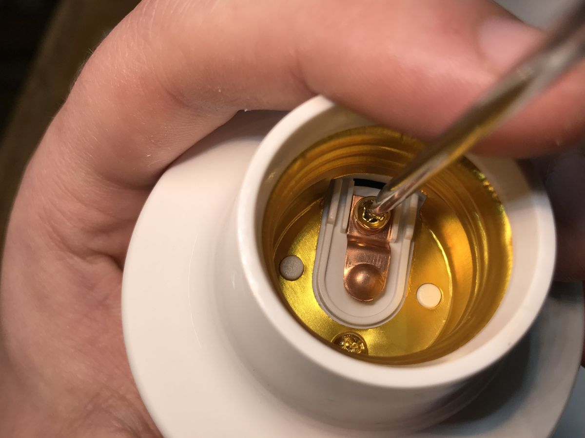

    The screws are in the base, but that’s not all.

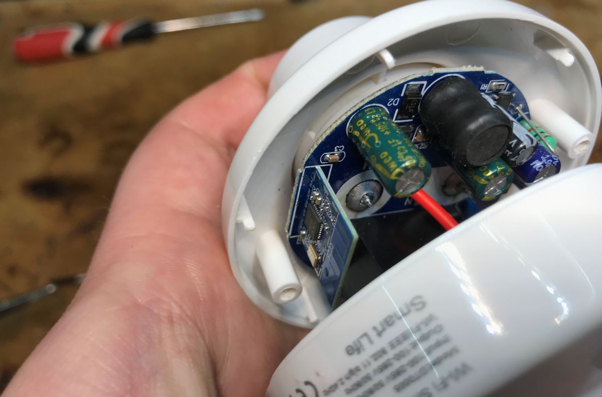

    You also need to free the PCB, and its screws are under the bulb:
    Remote control for a light bulb – TYWI-BL-E27 E27 adapter with Wi-Fi – firmware update

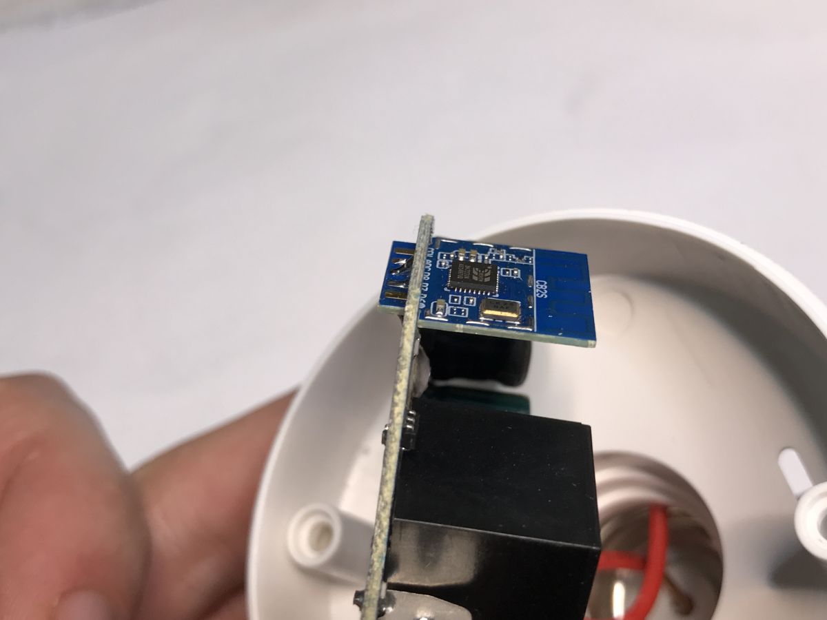

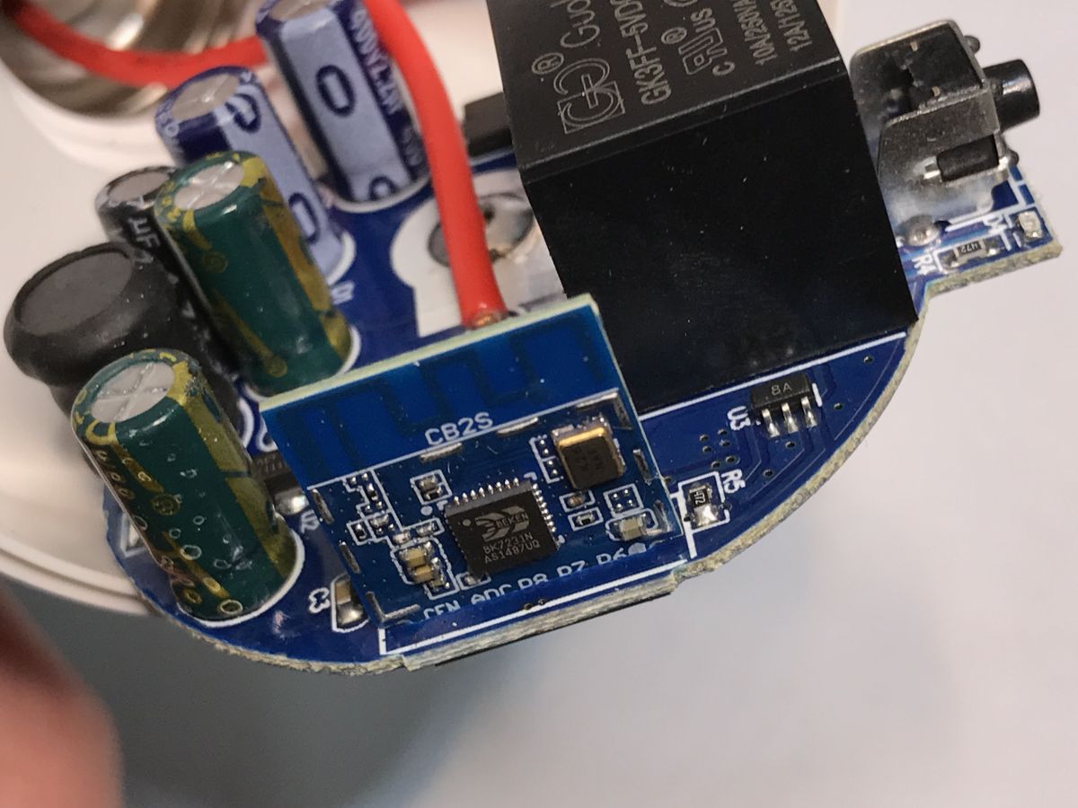

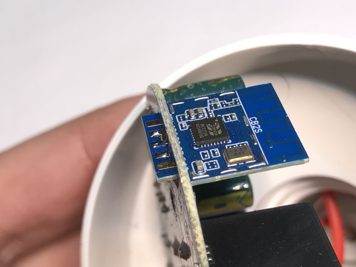

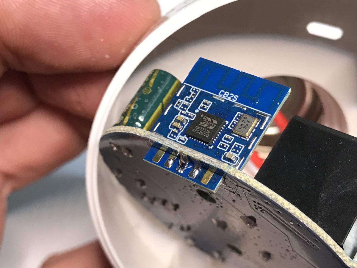

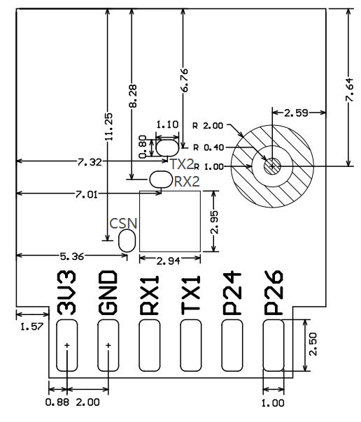

    Inside, the BK7231N module immediately catches the eye:
    BK7231 datasheet, pinout, programming, specifications, wiki (BK7231T, BK7231

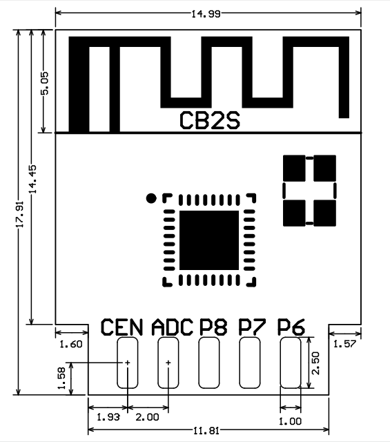

    Pins:

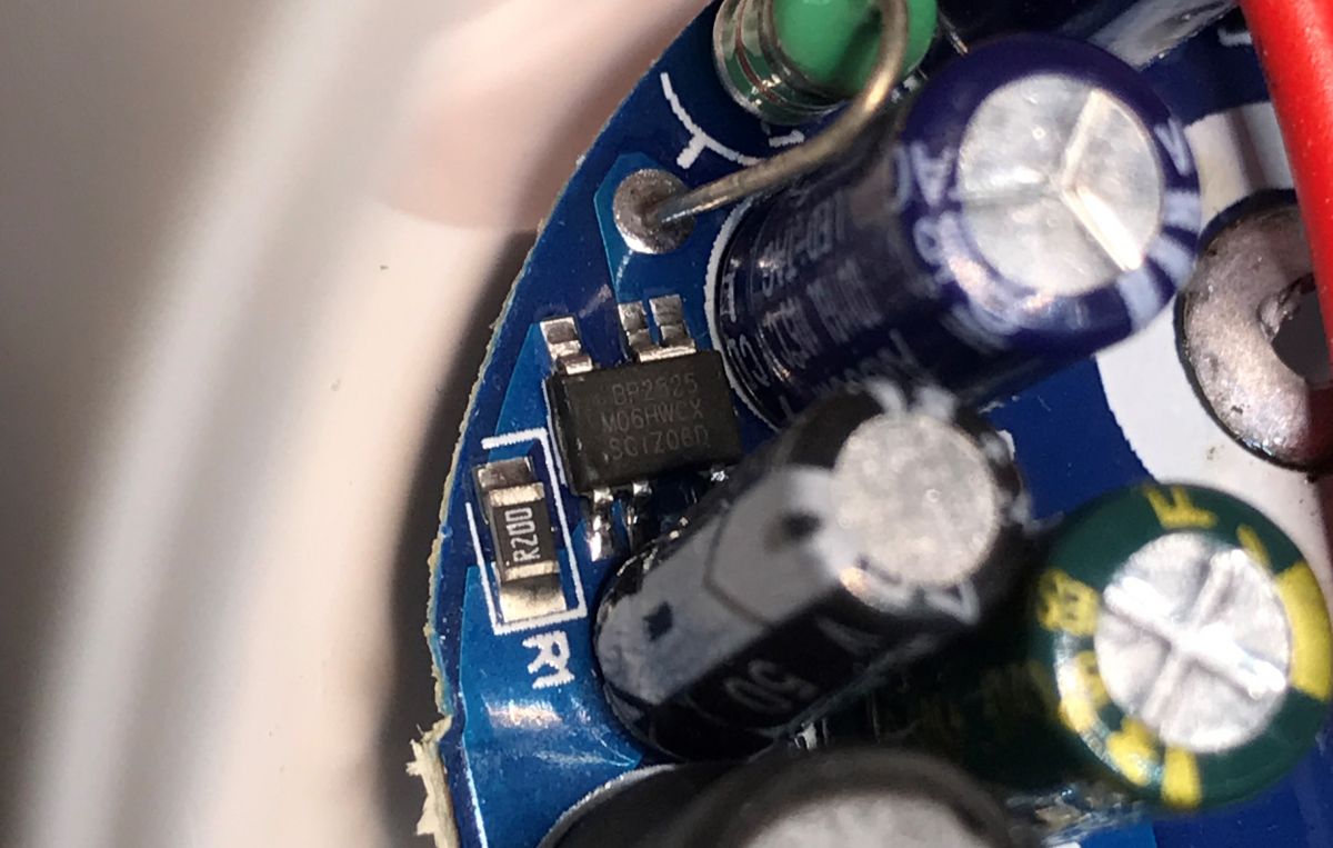

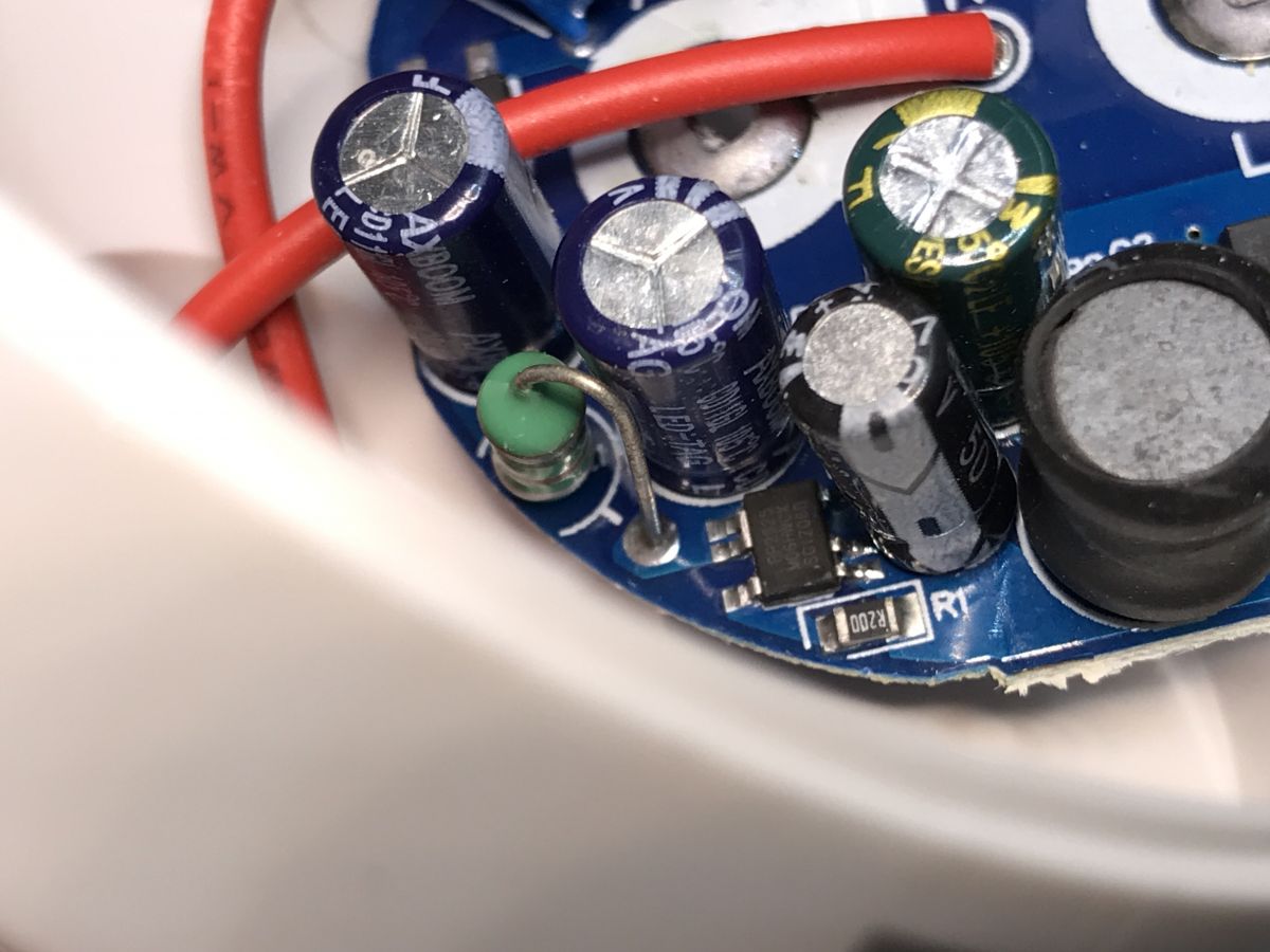

    In addition, the board features a relay and a non-isolated converter based on the BP2525. A typical circuit.

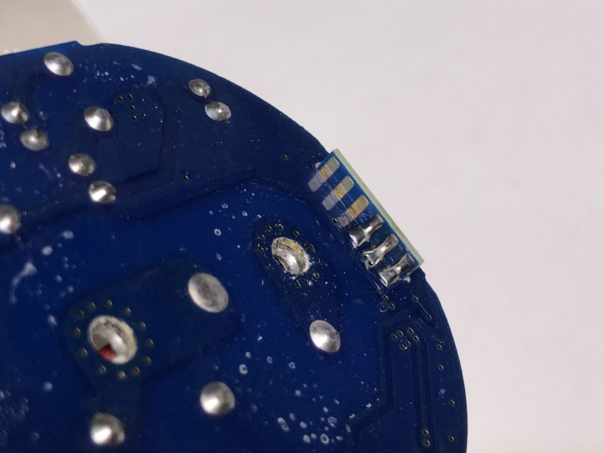

    There’s one thing I don’t like – those screws I unscrewed seem to be screwed into… the solder?

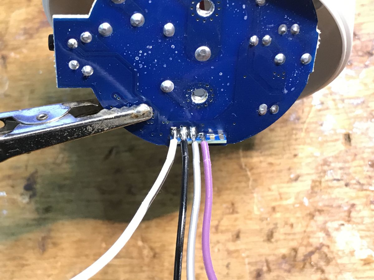

    Four wires to the CB2S pads are sufficient:

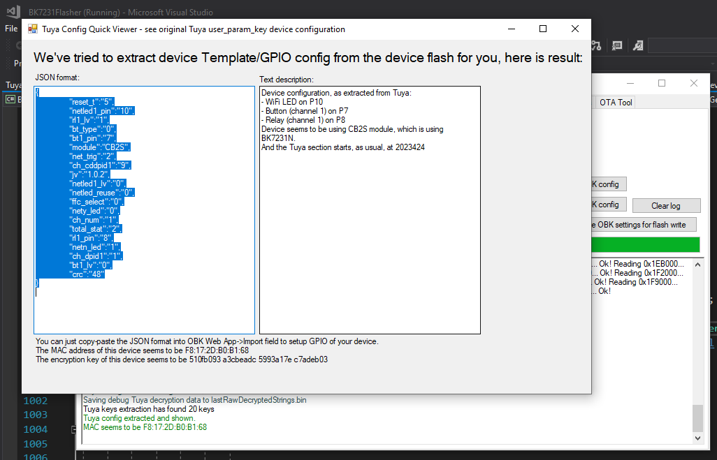

    The flasher correctly reads the GPIO configuration:
    Tuya JSON:
    Verbal description of GPIO:
    Device seems to be using CB2S module, which is BK7231N chip.
    - Relay (channel 1) on P8
    - WiFi LED on P10
    - Button (channel 1) on P7
    OBK template:
    Backup of factory firmware:
    https://github.com/openshwprojects/FlashDumps/commit/d33135ad5dce991f6668dd82a3bef810bdd762ac

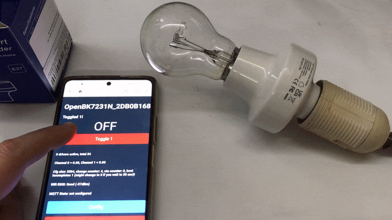

    After this operation, the product simply works 100% locally; there’s no need to fiddle about any further:
    Now you can even integrate it with HA, just as shown in our video:
