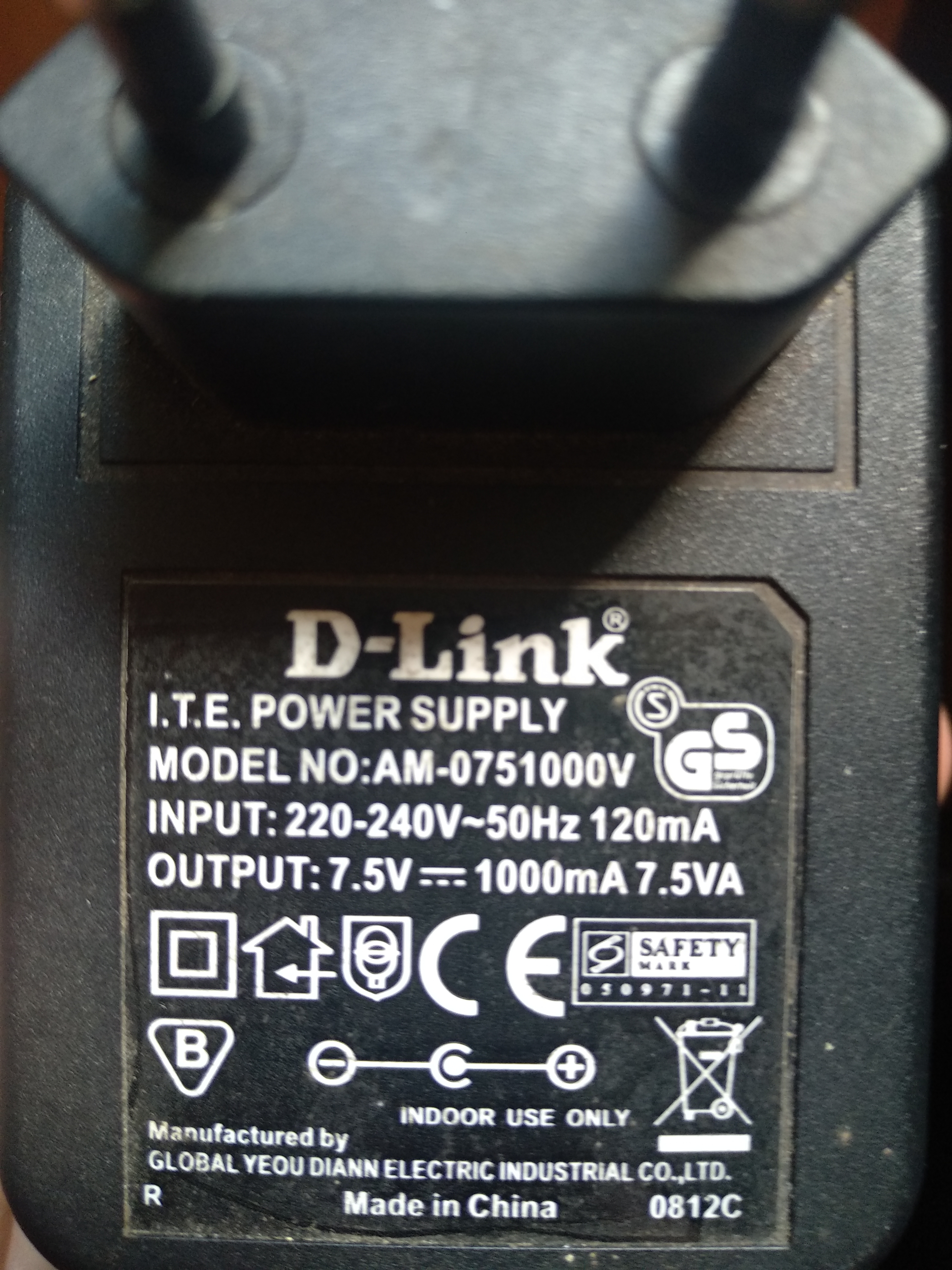

    Hello. i have a problem with the ESP8266 - 01 module, because when connected, neither the computer nor the smartphone can detect it. The module is connected to an Arduino Pro Mini 5V 16Mhz via a logic level converter. Firmware uploaded to the module according to the Elektroprzewodnik video on YT: https://www.youtube.com/watch?v=RaYZxqUTNWU
    To power the module I tried to use a CP2102 type converter and a power supply(parameters attached) and a LM2596S boost converter. I suspect a problem with the power supply here, as previously the module sometimes detected the mains, now it's a total caboodle. I tried soldering a 10uF capacitor to the inverter for the input and output and a 10nF capacitor between the vcc and gnd of the module but this had no effect. I have also tried other power supplies such as a load How do I power the ESP8266-01 correctly so that it detects networks? ovark for an old Nokia. So my question: how should I power this module ? use 2 alkaline 1.5V batteries ? change to another inverter ? use some sort of filter to eliminate the voltage ripple of the inverter ? design such a filter ? if so what components should I use ? or is it just a faulty ESP ?
    Please give me some advice from people who have had the best experience with this module.

    For your first start with the ESP8266 you would be better off buying a WEMOS MINI, NODEMCU or Witty module. They have a USB converter and all required capacitors right away. The video is from 4 years ago and nowadays it is rare for anyone to use these modules with AT commands in this way. Anyway, he doesn't quite explain correctly, because you can't power Arduino boards from 3.3V, only those that have a max clock of 8MHz. With a 16MHz clock it may or may not work, as the specification for such a clock is a minimum voltage of 4.5V. The ESP01 module draws an average of 80mA with peaks up to 250mA. To power it a 150mA linear stabiliser with 2000u capacitors is sufficient. This may seem like a lot, but on wires and contacts it is not at all, of course the higher the capacity of the stabiliser the smaller these capacitors can be. Plus that logic signal conversion. There are quite a few places where it's easy to trip, or maybe the module is broken and you're fighting windmills as a result. As you can see you rather have a stock current, where you make a mistake at the beginning is hard to figure out because you have everything new and you don't know from which side the dog is barking. There are also converters with a choice of 3.3V and 5V logic, a few zlotys more expensive. So it's better to spend 10 zloty for an ESP module with USB and get rid of these problems.

    I understand that you have uploaded the AT firmware. Which version specifically? How do you test the WLAN detection? I mean the AT command sequences. Sorry, but after 15 s of watching this video on YT I got a bit faint and stopped watching, hence my questions.

    The firmware version is v0.9.5.0 . I simply checked if the network card detects the module. Once it was detected, once it was not. When it was detected I went to serial monitor in arduino IDE and then typed "AT" I got "AT - OK" or "AT+GMR" command and version number appeared.

    That is, it is a firmware version from about 3 years ago. As a first step, I suggest you upgrade the AT firmware to version 1.6.2 available here:
    https://www.espressif.com/en/support/download/at?keys=&field_type_tid%5B%5D=14
    There are already several topics on the electrode about how to upgrade the firmware on the ESP-01. You will definitely need a UART/USB converter. Theoretically, you could do the upgrade over the internet, but I don't know if version 0.9.5 already had this possibility.
    When the AT firmware upgrade to version 1.6.2 is performed correctly, the result of the AT+GMR command should be as follows:
