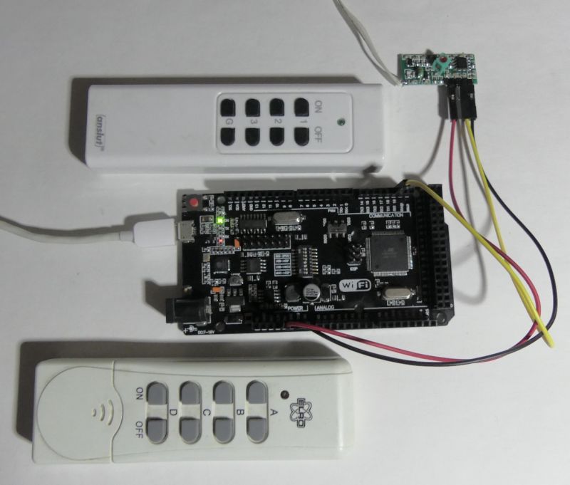

  • A practical test used the Mega side as an RFLink gateway, decoding 433 MHz OOK receiver traffic from remotes and wireless devices on the serial console.
  • The setup worked, but miniature switches are inconvenient to change modes, voltage-level differences matter, and the lack of an SMD capacitor is a quality concern.

As a practical test of the module, this time I tested the MEGA dedicated to Arduino RFLINK GATEWAY . The RFLink project allows the decoding of transmissions from very many wireless devices type weather station sensors, remote controls operating in ISM bands. I connected the data output of a very simple and cheap 433MHz OOK receiver to the D19 pin. The authors have prepared hints on which modules to use: http://www.rflink.nl/blog2/wiring I checked the operation of the cheap 5V 433MHz CZS-A receiver, and a slightly more complex 3.3V RFM210L receiver. The software for download on the project website http://www.rflink.nl/blog2/download uses the Arduino bootloader to upload the firmware, which simplifies the testing process. It turned out that two accidentally owned remotes are properly decoded and information about the number of the button I pressed on the remote appeared on the serial console (57600b / s). After attaching a better antenna, control commands sent by remote controls working for one of the neighbors on the estate began to appear. Maybe there will be data from recently popular weather station sensors? After connecting the transmitter, the design also allows you to send commands to wireless devices.
Having the ESP8266 board, we can forward the information using WiFi.

@pir In the assumption of the authors of RFlink, it was supposed to be used not so much as a joke, but to use remotely controlled sockets as actuators, remote controls as entry points to the control... [Read more]
