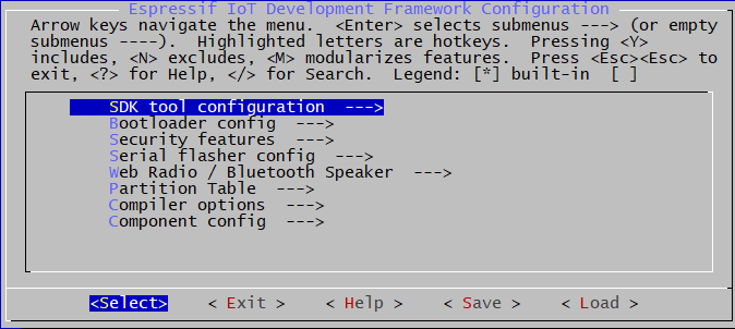

    We make the configuration:
    make menuconfig

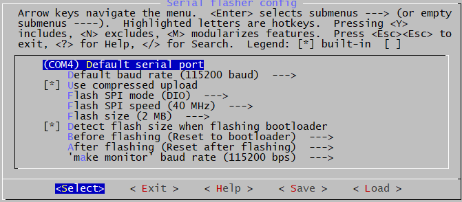

    WiFi module - ESP32 + DS18B20, internet radio and BT speaker
    In the serial flasher config section, we provide the COM port number on which the ESP32 connected is available (to be checked in the device manager or Arduino environment):
