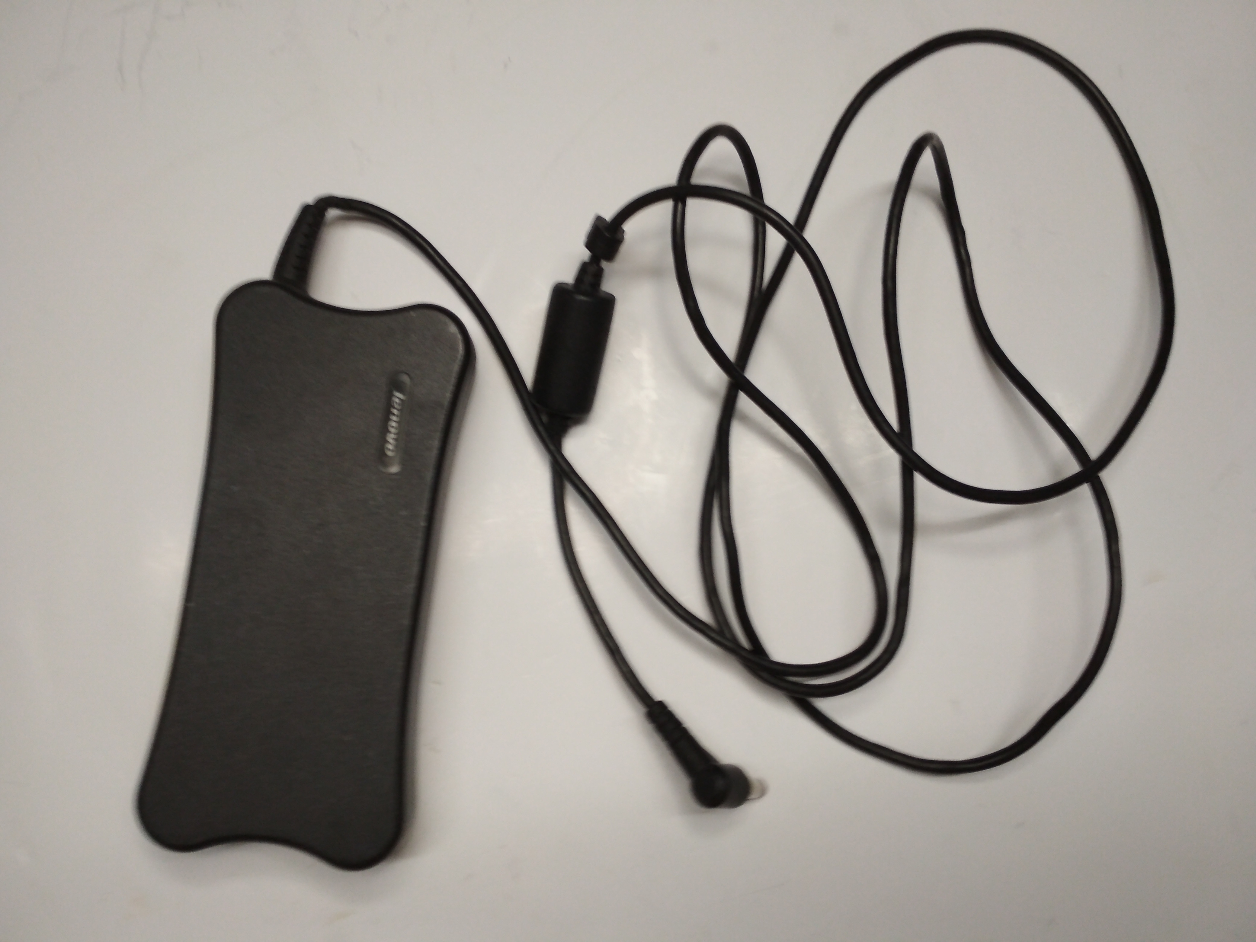

  • A Lenovo laptop power supply, ADP-90RH B, had a broken output cable that caused periodic charging interruptions.
  • The ultrasonically welded casing had to be opened by prying the seam with a knife and hammer, or optionally by softening it with a few drops of gasoline.
  • The blue LED can stay on for several seconds after unplugging 230V, and dangerous voltage may still appear on internal metal parts.
  • The cable was shortened, its screen twisted and heat-shrunk, then soldered to the PCB, but the hardest part is safely reassembling the plastic housing without shock risk.
In fact, I thought about publishing this material here on the forum for quite a long time. My concerns relate to the safety of such a repair. However, while browsing the internet, a dozen or so pages presenting a similar activity and the number of sold DC power cords for laptops, I decided that maybe it is worth including it, but at the same time sensitize to the danger of such an "operation". In my opinion, too few people paid attention to it in the materials I read. The danger I am writing about is the correct, later assembly of the plastic housing. It is worth mentioning at once that no manufacturer of a device equipped with such a power supply allows any interference, repair, etc. of this element. In the event of any damage, only complete replacement. No item, component or wire appears in the "part list" of the service manual. Of course, one can argue whether this is the right way, or is it not better to just use dismountable power supplies? It's just that the manufacturer does not have any interest in this, and we are left with what we have. :) Although a few times I have already encountered similar designs, where there were screws, but it's a rarity. If we do not find any screws under all stickers / feet, it only means that the housing of our power supply has been ultrasonically welded.
The power supply presented here comes from the Lenovo laptop model, its exact designations are: ADP-90RH B. Damage is the periodic interruption of charging. We have a blue LED here that indicates the presence of voltage. So you can immediately suspect that the problem may be somewhere at the output of the power supply. Of course, to suspect, because the voltage signaling by means of a lit diode does not always mean 100% power efficiency.
An in-depth examination, which must always be done first, shows our problem. A interrupting cable, unfortunately in the worst, but at the same time the most common place - right next to the bend at the housing. Sometimes it can happen that a damaged wire will short-circuit the two wires inside. Therefore, it is not worth "bothering" such a "patient" for too long in the event of a defect.
Another common place is at the plug itself - and in this case the repair is much simpler because we can replace the plug itself without having to take the whole thing apart.
Unfortunately, we have to separate the casing, because it cannot be done in another way.
We proceed to "disassembly". As mentioned earlier, let's first check if the manufacturer hasn't hidden any screws under the stickers or feet. If not, which is the vast majority, what you are about to see awaits us. :)
Of course, we disconnect the power cord. It is worth noting that the high voltage inside the power supply will persist even for several seconds after disconnecting the 230V cable. Check how long the LED is still on.
One of the methods I know, for a reasonably "nice" and correct disassembly of such a housing, is to position the blade of a knife, preferably a decent one, in the gap between the halves and hitting the knife with a hammer. You do not need to use a lot of force, piece by piece, this way we can open the non-dismountable housing. It should be remembered that the entire operation should be carried out on a stable, hard surface that will not spring due to impacts. A good place is the top right above the table leg. If we overdo it, we will damage the casing or the components inside.
As you can see, this method managed to open with virtually no damage. The only slight flaw visible in the marked place. After folding the two halves, everything will fold without a trace. We don't have any dents or broken pieces of plastic here.
Another way of demolition is to saturate the connection points with a small amount of gasoline. A few drops. Wait a while, then the seal "lets go" and you can easily separate the two parts. With this method, however, you should follow safety rules, remember about the flammability of the product and ensure adequate ventilation. It's best to wait some time before doing anything until everything evaporates outside the room. I also read about cases where gasoline began to react also with the plastic casing.

tomybb wrote 1710 posts with rating 1794 , helped 3 times. Been with us since 2006 year.
szeryf3 26 May 2021 10:59
I move the cable through the strain relief, using a little cream. [Read more]
tomybb 26 May 2021 11:12
How do you secure the cable later so as not to tear it out? [Read more]
Olkus 26 May 2021 11:29
Oil is better in my opinion. For me, the power supply (also Lenovo) had a blue diode inside, so that it was not visible outside whether it was lit or not :D The Chinese probably forgot to make a hole in... [Read more]
pier 26 May 2021 12:35
I only open such cases with a hammer. The housing is edged and lightly seamed. It comes off after a few hits and I stick such an open casing practically without a trace. After using a knife or screwdriver,... [Read more]
viwaldi1 26 May 2021 14:21
I mask the traces of opening / gluing with a strip of black heat-shrinkable self-adhesive foil. I used to buy one from the automotive one for wrapping thresholds, but I use it basically only for power... [Read more]
pier 26 May 2021 15:40
Show the effects. [Read more]
Jacekser 27 May 2021 07:03
I squashed, or rather swelled, the casing in a vice with feeling. The casing is grabbed by the sides at the corners and lightly squeezed so that the upset side is on top. You need a vise with a fairly... [Read more]
siewcu 27 May 2021 08:56
I took the replacement cables from other power supplies, also damaged ;) Visual inspection, checking the transition with a multimeter when bending in all possible directions and to the power supply. Although... [Read more]
PPK 27 May 2021 15:24
I would check if there is a breakdown of the primary voltage to the secondary one. In the customer's nice equipment, the neon lamp was on + 19V. Leakage current to PE, approx 8mA. Of course, the power... [Read more]
^ToM^ 28 May 2021 08:31
I open that too. When you hit the right place with a hammer, it opens itself without damage. At the beginning, I opened a few old power supplies for practice. [Read more]
Droga Meczna 28 May 2021 17:13
I used automotive epoxy for gluing. He's been holding on for six months now. [Read more]
romarcin 28 May 2021 19:40
This is a normal phenomenon in ungrounded power supplies ("eight" socket) and it depends in what position you put the plug into the 230V socket. In switched mode power supplies, the ground of the secondary... [Read more]
McMarycha 29 May 2021 22:05
You can also use agents such as "label remover", which dissolve the glue, to open the cases. Apparently gasoline also works, but I have no experience with it. [Read more]
William Bonawentura 30 May 2021 09:03
You can also transfer the electronics to the universal bolted housing. For example, https://www.kradex.com.pl/product/obudowy_do_zasilaczy/z16?lang=pl [Read more]
wesmar 30 May 2021 11:04
I professionally open power supplies, because I make modifications to the CC-CV with modifications to the voltage divider + hall, sometimes different and the best method for me is the appropriate proportions... [Read more]
^ToM^ 31 May 2021 08:31
After repair, most of the housings are permanently sealed with a regular droplet. If you had to open it again then there is no problem. Added after 3 [minutes]: You will. One shot with a hammer... [Read more]
jedrzej10 31 May 2021 12:25
Hello, My patent for opening the case is crushing in a vice. I place the power supply half in a vice and twist until the connection releases. Of course, I protect the edges from scratching. greet... [Read more]
wesmar 01 Jun 2021 13:13
True, they are minimally carcinogenic and genotoxic, but at such concentration and time of application, they are negligible with adequate awareness. Orlen oil is free of polychlorinated biphenyls (PCBs).... [Read more]
William Bonawentura 01 Jun 2021 22:20
Rubber gloves + ventilation. [Read more]
