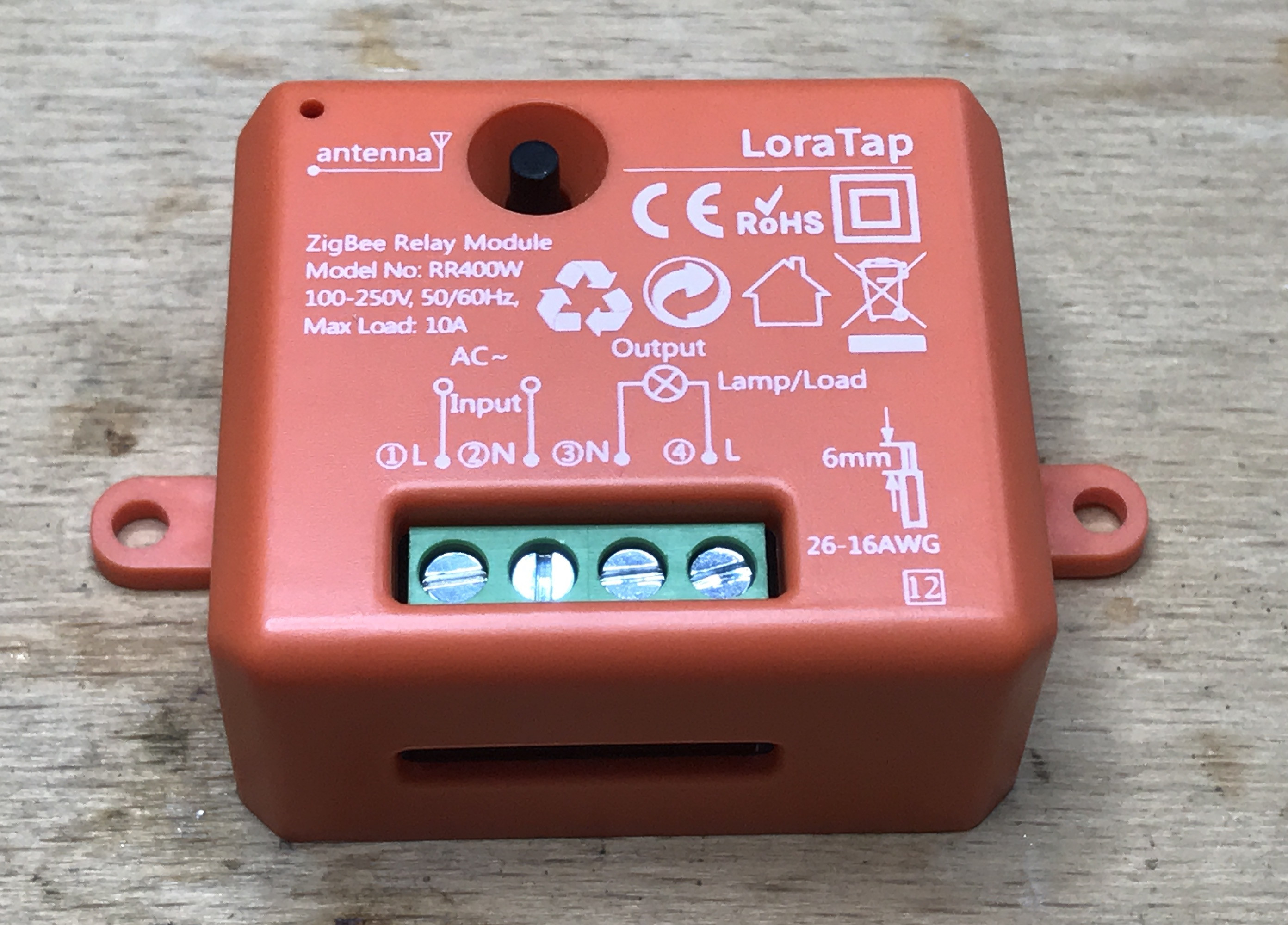

Set contents On the package is the full model name: RR400ZB. Although this name somewhat conflicts with the name from the case (RR400W), in my opinion, however, the former is correct. ZB stands for ZigBee versions, and W stands for WiFi versions. The product is available in two versions.
The kit turned out to be even richer than announced by the seller:
However, I don't know why these threaded caps are included:
The relay itself is slightly smaller and lighter than I thought. The low weight suggests there is no transformer inside.

. Teardown RR400ZB/TS011F It's time to look inside. The case is quite hard to open, you need to lift it with two flathead screwdrivers:
Then the electronics board already falls out from inside.
There is indeed no transformer. The power supply is transformerless, based on OB2222MCP.
