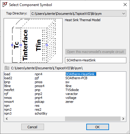

Heatsinks and the SOAtherm-HeatSink model
Any electronic power system requires a device that can allow a high heat exchange between the component container and the surrounding environment. This precaution avoids the destruction of the components if the relative junction temperature exceeds its physical limits. In an electronic simulation, LTspice provides a very useful and sophisticated model to simulate the behavior of a heatsink (see Figure 1), providing some essential operational parameters. It is important that the SPICE models of the devices are all equipped with the “Tc” terminal and, optionally, the “Tj” terminal. SOAtherm-HeatSink is the name of the model found in the software library.
Component symbol selection window with SOAtherm-HeatSink highlighted.
Figure 1: The SOAtherm-HeatSink model in the main LTspice library
After you’ve placed the model on the schematic, you need to specify the following information:
• The material of the heatsink can be either copper or aluminum, your choice through the relative dropdown menu.
• Rθ is the heatsink’s thermal resistance, as well as the air flow (˚C/W).
• Tambient is the ambient temperature, expressed in degrees Celsius.
• Area of contact between the electronic component and the heatsink is expressed in square millimeters.
• The total volume of the heatsink is expressed in cubic millimeters.
All of the above parameters must be entered into the properties of the heatsink, which can be accessed by pressing the right mouse button on the schematic component. They must be entered into the SpiceModel, Value, and Value2 fields.
