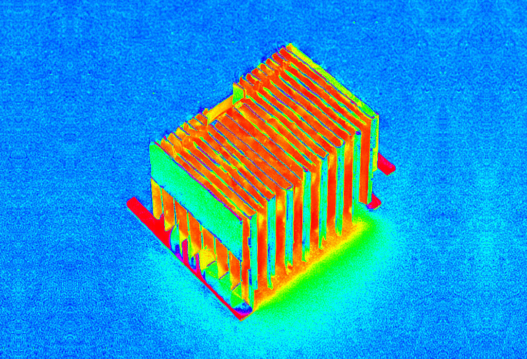

  • A SiC MOSFET in TO-220 package was tested with different aluminum heatsink forms to compare thermal performance and identify an efficient heat-dissipation solution.
  • The comparison varied exposed surface area, from no heatsink to a parallelepiped block and a finned complex shape, under 20°C ambient air and 30 mW/mm2 back-side power.
  • The finned heatsink exposed 41,080 mm2 and reached a 51.58°C maximum, while the 8,780 mm2 block reached 64.33°C and no heatsink hit 506.2°C.
  • Greater exposed surface area reduced temperature, and forced convection with a fan can lower thermal resistance further, but oversized heatsinks can obstruct airflow and raise cost.

The exposed surface area
The simulation tests carried out in this section concern the maximum temperature reached by the device, changing the heatsink surface (of aluminum) exposed to air with a thermal coefficient of 0.025 mW/mm2/°C and a temperature of 20°C. In addition, the device is subjected to a power of 30 mW/mm2 on the back surface. Figure 2 shows the results obtained from the simulations and, more importantly, the theoretical maximum temperatures reached by the devices during system operation. The simulations cover the following scenarios, with a temperature scale between 20°C and 100°C:
• Device operating under the above conditions without any heatsink. The maximum temperature reached is about 506°C, for safe destruction of the component.
• Device operating with a parallelepiped-shaped heatsink, with an exposed surface area of 8,780 mm2. The maximum temperature reached is about 64°C and the average temperature of the heatsink is about 36°C, for correct operation of the device.
• Device operating with a heatsink of complex shape, with many fins widening the exposed surface area by 41,080 mm2. The maximum temperature reached is about 51°C and the average temperature of the heatsink is about 26°C, for optimal device operation.
• Device operating with a parallelepiped-shaped heatsink, with an exposed surface area of 2,195 mm2. The maximum temperature reached is about 95°C and the average temperature of the heatsink is about 73°C, for good device operation.
Figure 2: The results of the simulations in relation to the exposed surfaces of the heatsinks.

To further lower the thermal resistance of the heatsink, it can be subjected to forced convection, using a fan. In this case, the thermal resistance is proportional to the air velocity, and the temperatures reached by the system are lower.
