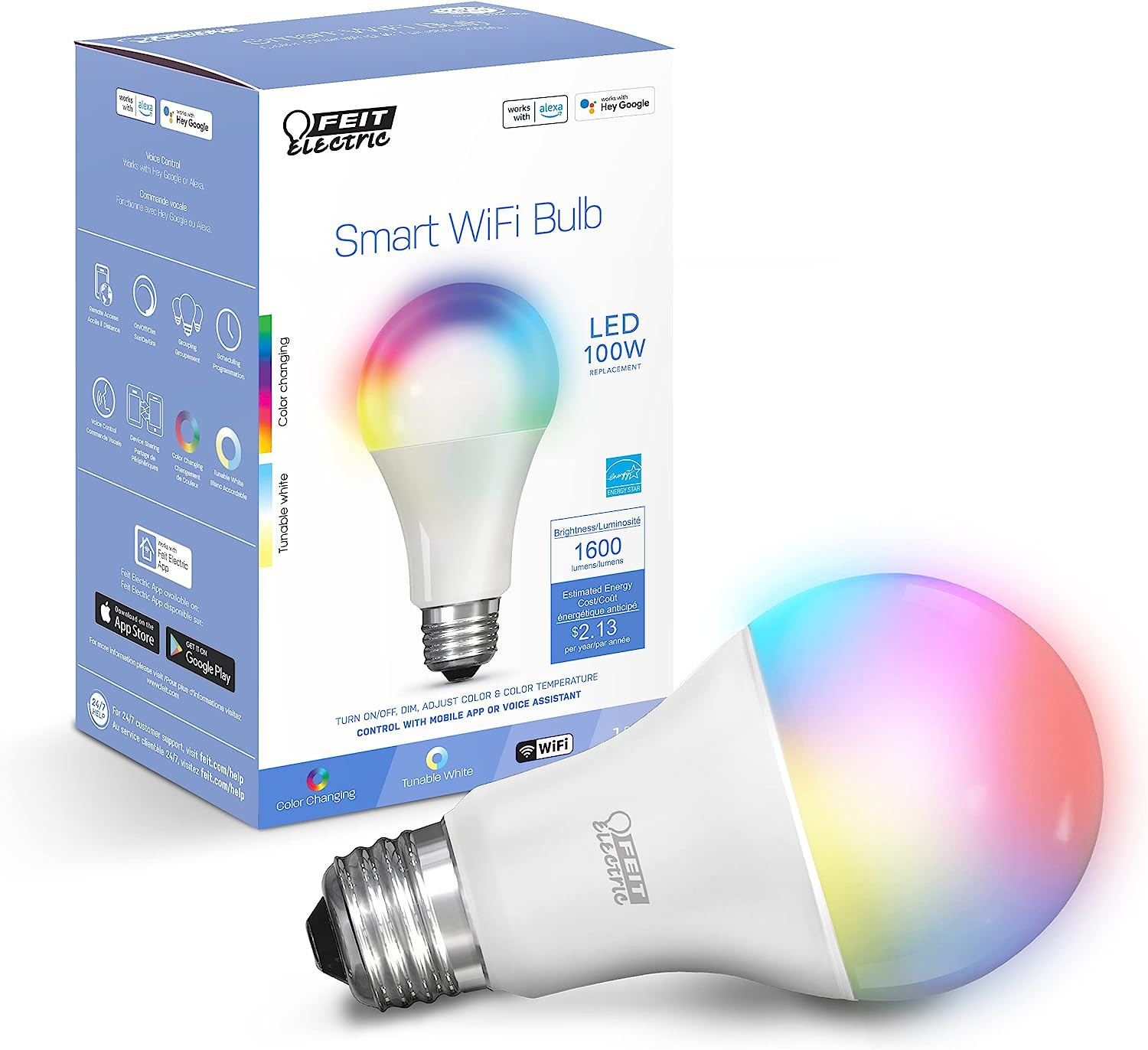

Another RGBCW bulb from Feit Electric... this one has a different configuration than those which have already been discussed here.
Amazon Listing: https://www.amazon.com/dp/B07X8QXR9L?psc=1&ref=ppx_yo2ov_dt_b_product_details
Specs:
* 100W Equivalent
* 18W actual
* 1600 lumen
* 90+ CRI
