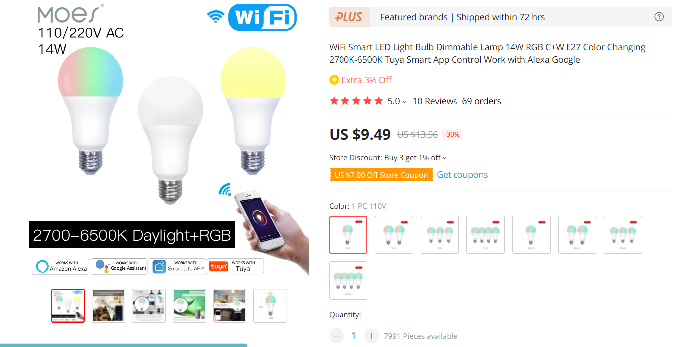

  • I received a new bulb from Moes, it costs $9.49 with free shipping
    https://www.aliexpress.com/item/1005003473033205.html
    This is a heavy bulb and it's indeed very bright

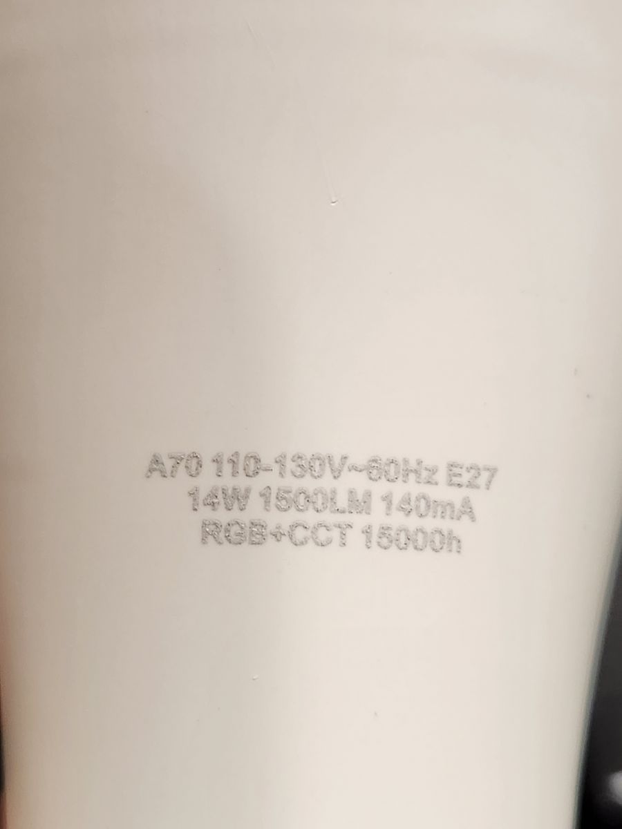

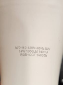

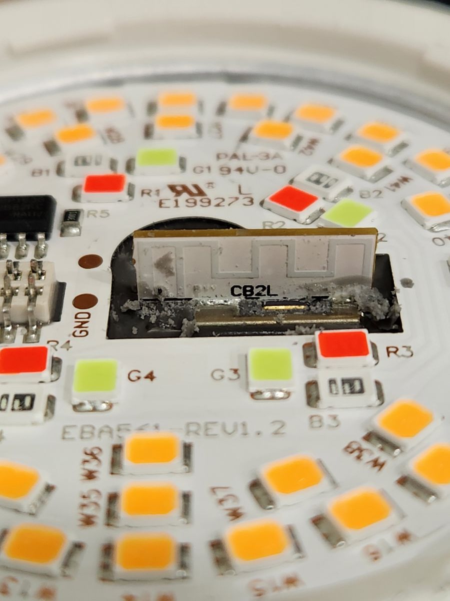

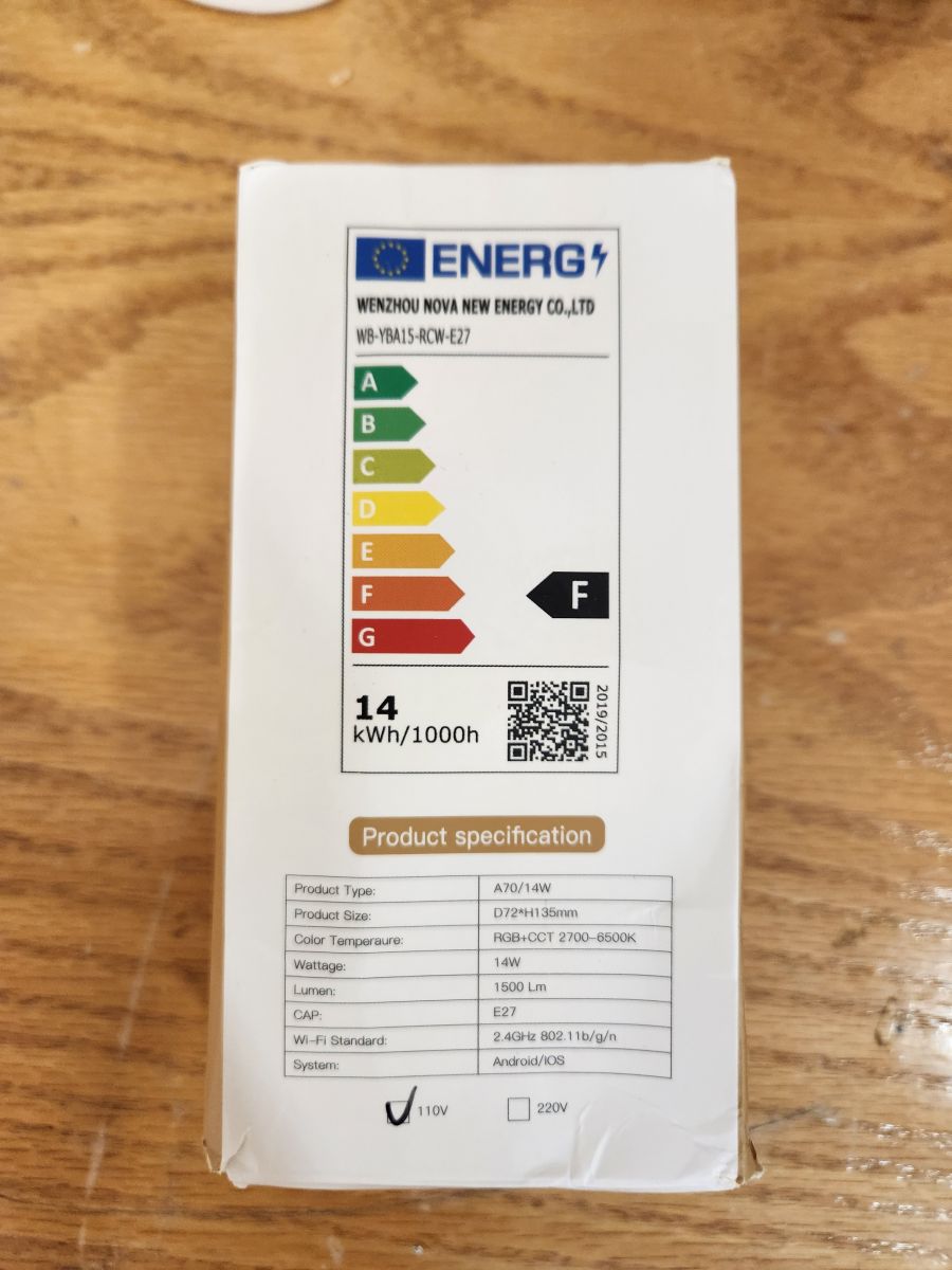

    [BK7231 - CB2L] Moes LED Light Bulb 14W RGB C+W E27

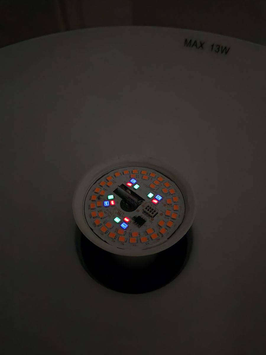

    The bulb uses BK7231 - CB2L but unfortunately Moes filled the bulb with epoxy and I couldn’t disassemble it without causing permanent damage.
    But thanks to Lightleak project I was able to get full dump of the chip without the need to open it further. I uploaded the .bin file to tuya-cloudcutter and it can be found under the profile with firmware version 1.3.1
    Here are some pictures of the bulb.

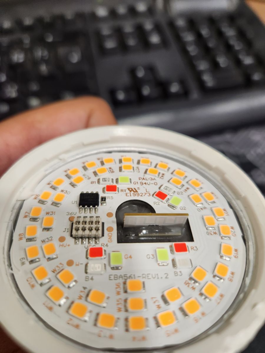

    [BK7231 - CB2L] Moes LED Light Bulb 14W RGB C+W E27 [BK7231 - CB2L] Moes LED Light Bulb 14W RGB C+W E27 [BK7231 - CB2L] Moes LED Light Bulb 14W RGB C+W E27 [BK7231 - CB2L] Moes LED Light Bulb 14W RGB C+W E27 [BK7231 - CB2L] Moes LED Light Bulb 14W RGB C+W E27 [BK7231 - CB2L] Moes LED Light Bulb 14W RGB C+W E27 [BK7231 - CB2L] Moes LED Light Bulb 14W RGB C+W E27 [BK7231 - CB2L] Moes LED Light Bulb 14W RGB C+W E27 [BK7231 - CB2L] Moes LED Light Bulb 14W RGB C+W E27 [BK7231 - CB2L] Moes LED Light Bulb 14W RGB C+W E27 [BK7231 - CB2L] Moes LED Light Bulb 14W RGB C+W E27

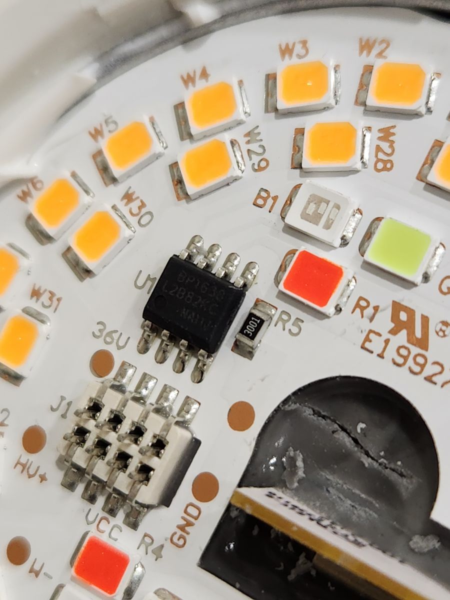

    As you can see the bulb was advertised as CW+WW+RGB but it only has WW+RGB diodes and it emulate the CW. That’s why Flag 24 must be enabled.

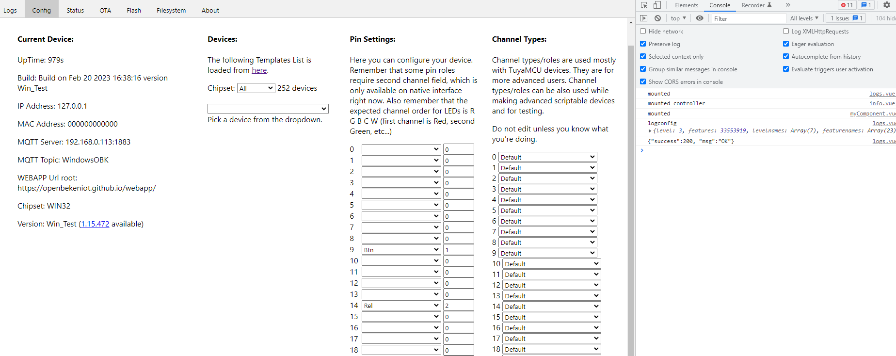

    After flashing Openbeken use the following configuration
    P6 - PWM 0
    P8 - PWM 4
    P24 - PWM 2
    P26 - PWM 1
    Also don't forget to enable Flag 24

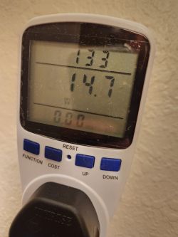

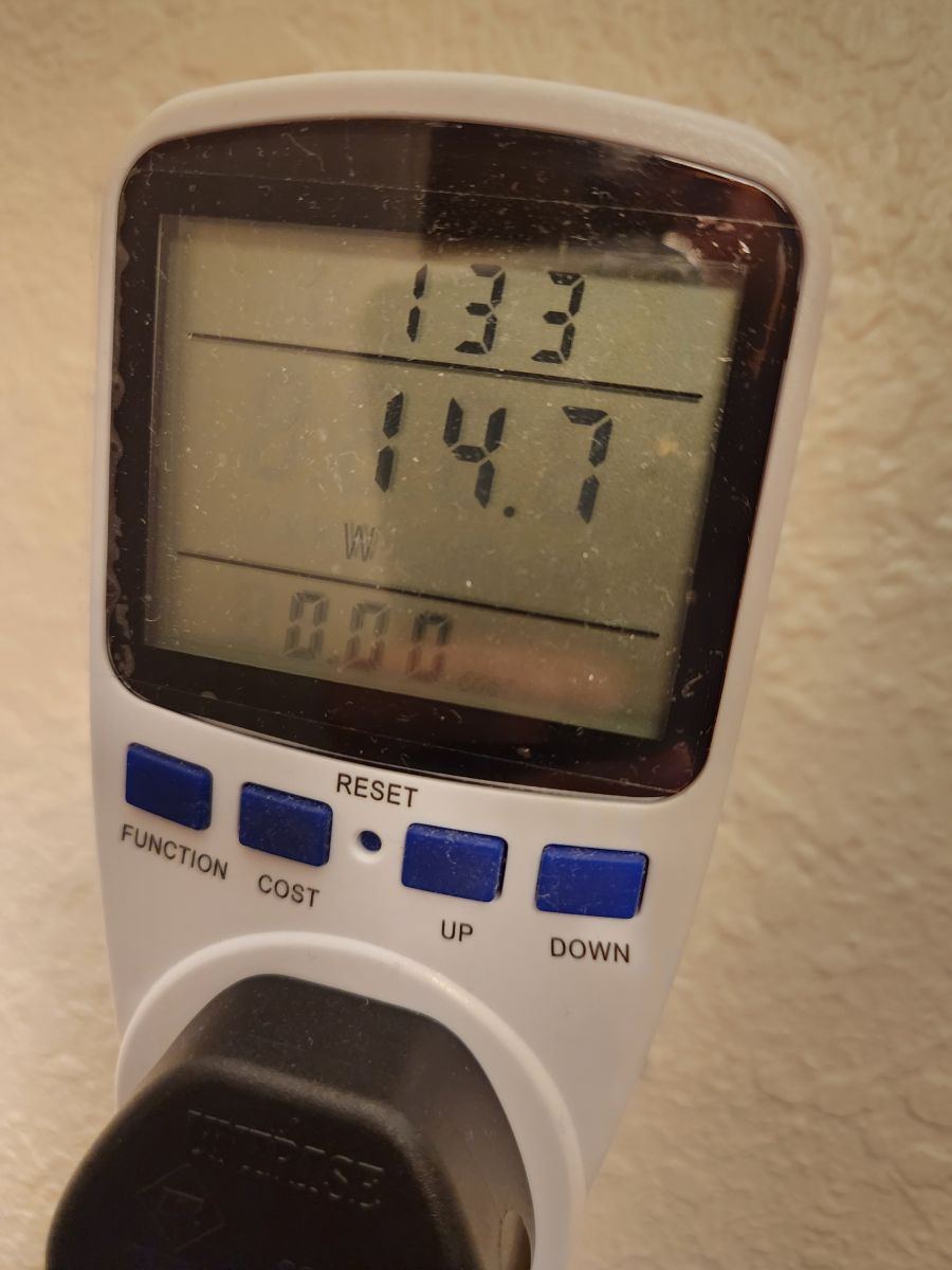

    Thank you, very useful review. I can also see that you have the same power metering util that I have. I have reviewed it on the polish side of Elektroda:
    https://www.elektroda.pl/rtvforum/topic3655635.html
    Hmmm does the "white emulation" gives good enough results?

    This meter is surprisingly accurate given its price
    I mostly use this bulb at 2700k, but I have noticed a flickering when using the emulation.
    https://youtube.com/shorts/6Ef-RvJqDAg
    https://youtu.be/ZUlcGBesySo
    Now, I haven’t done much testing with the original firmware so I don’t know if it’s a bulb issue or OpenBeken issue.
    What I noticed before flashing OpenBeken is the RGB diodes doesn’t turn off completely when turning the bulb off, I can see them run at very low brightness if I was in a dark room. I have contacted the seller about this issue but no respond yet.
    If I turn on RGB colors only I don't see any flickering.

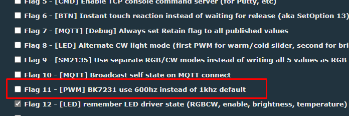

  • #6 20448960
    Posts: 14755
    Rate: 12880
    Ah, sorry, it's BK, I was confused.
    Ok, so maybe try this option:
    I am also considering adding frequency customization for PWM.
  • #7 20448967
    Zain00
    Posts: 61
    Rate: 20
    Flag 11 - ON, still flickering
