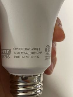

    Amazon Listing: https://www.amazon.com/dp/B07X8QXR9L?psc=1&ref=ppx_yo2ov_dt_b_product_details
    Specs:
    * 100W Equivalent
    * 18W actual
    * 1600 lumen
    * 90+ CRI

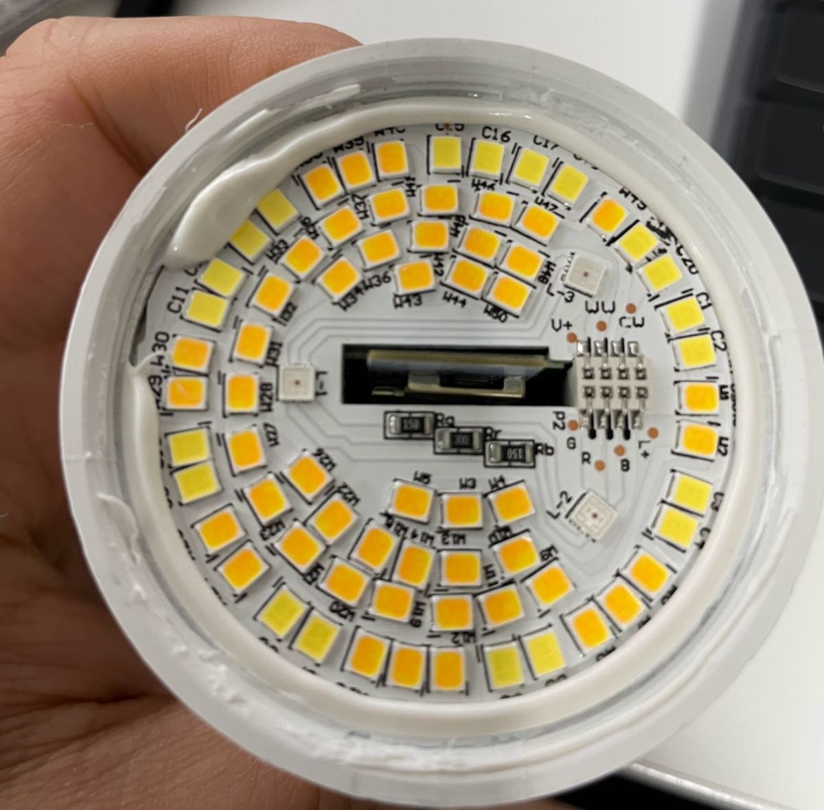

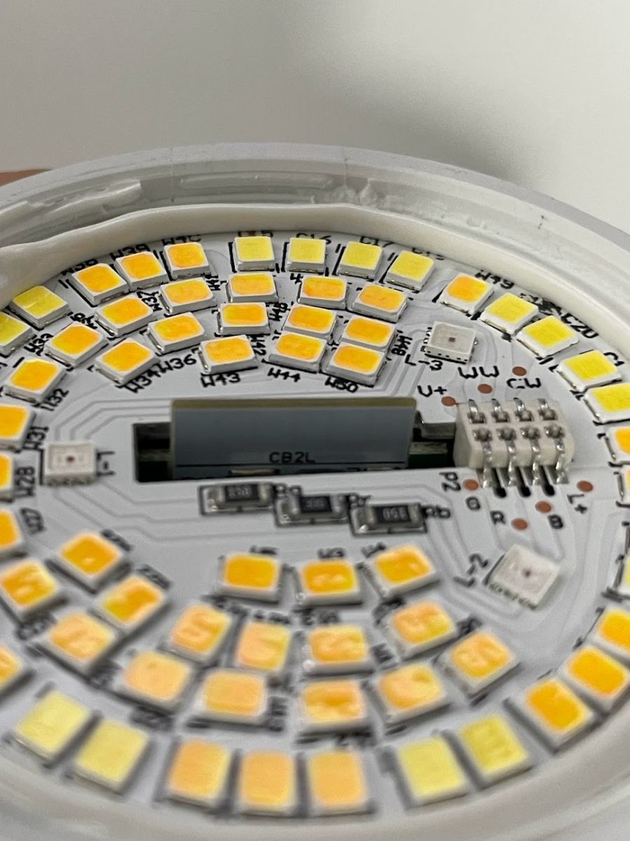

    Teardown (Partial):
    [BK7231N] Feit Electric - 100W (18W) A21/E26 RGBCW Bulb (OM100/RGBW/CA/AG) [BK7231N] Feit Electric - 100W (18W) A21/E26 RGBCW Bulb (OM100/RGBW/CA/AG) [BK7231N] Feit Electric - 100W (18W) A21/E26 RGBCW Bulb (OM100/RGBW/CA/AG)

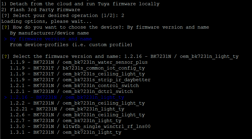

    Config:
    * Equipped with a CB2L (BK7231N)
    * 5 PWM control
    * Need to set Flag 8
    * Flashed with Tuya CloudCutter (FW Version: 1.2.16)
