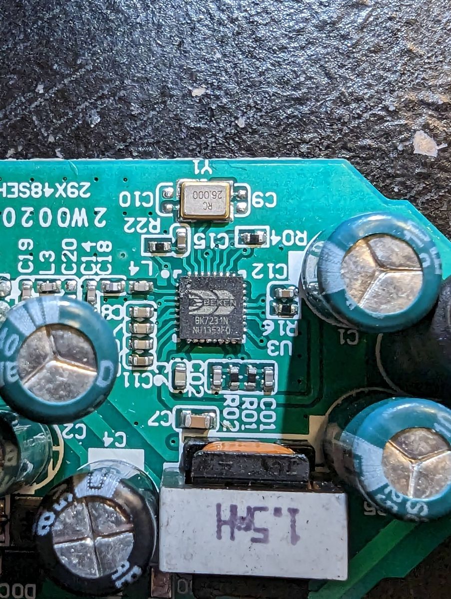

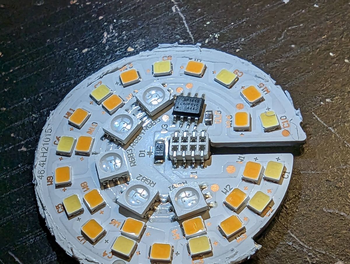

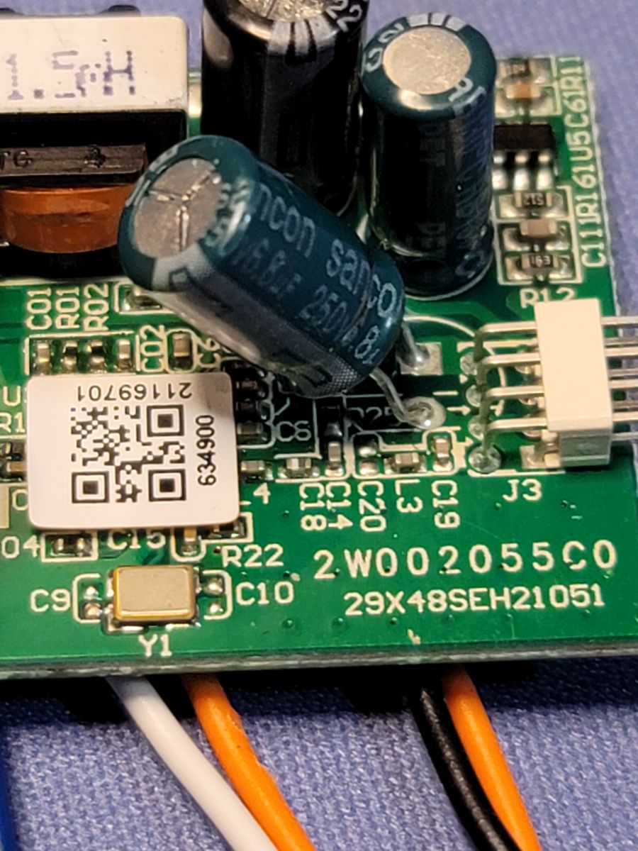

  • Teardown of the Feit OM60/RGB/CA/AG/3 bulb. This can be found in the US on Amazon and in retailers such as Costco.
    Features a BK7231N chip directly on the main board, no external module board found here. It also has a BP5758 i2c driver, but according to the docs, it is not strictly i2c.
    More info on the BP5758:
    • From Tuya here: https://developer.tuya.com/en/docs/iot-device-dev/driver_i2c_bp5858d?id=Kb7bciwq50zfc
    • Datasheet here: https://github.com/arendst/Tasmota/blob/devel...asmota/tasmota_xlgt_light/xlgt_08_bp5758d.ino
    • and Example Code from someone getting this into ESPHome: https://github.com/dbuezas/esphome-bp5758
    I was able to flash this successfully with OpenBeken/OpenBK, but I'm unable to control the light or colors at this time. Unsure where to start with the config, but I'm thinking support for the BP5758 will need added before it will work.

  • Tuya BP5758D docs and ESPHome/Tasmota code links

    It looks like another model exist that uses the BP1658 is now being sold as well.
    Feit OM60/RGB/CA/AG/3 Teardown Feit OM60/RGB/CA/AG/3 Teardown
    Edit: I found the value
    P24 BP1658CJ_CLK
    P26 BP1658CJ_DAT
    Startup: BP1658CJ_Map 0 2 1 3 4

    @William1 hey, would you be able to provide information which LED model is that, how the package looks like and where it was bought? Thanks
    Or is it the same (from the outside), indistinguishable , as Feit OM60/RGB/CA/AG/3 ?
  • #7 20329783
    William1
    Everything is the exact same as the previous one besides the new driver chip. It is the same model, FCC ID, and packaging. I saw them on sale at Walmart for the 3 pack for $8.99 and decided to give them a try.
The discussion centers around the teardown of the Feit OM60/RGB/CA/AG/3 bulb, which features a BK7231N chip on the main board and a BP5758 LED driver. Users have shared links to relevant documentation and code for integrating the BP5758 with ESPHome and Tasmota. A follow-up indicates that the BP5758D driver is now supported in OpenBK firmware version 1.12.14. Additionally, another model using the BP1658 driver has been identified, which is visually indistinguishable from the original Feit bulb. Users have reported purchasing this new model at Walmart.
