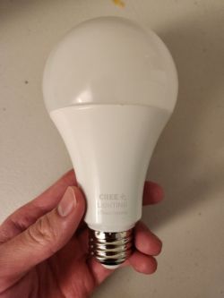

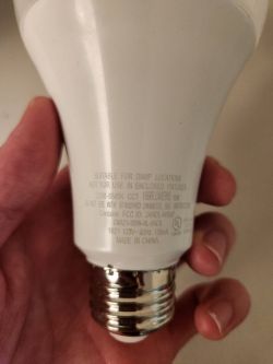

  • This is a short teardown of the Cree A21 100W tunable white + color changing bulb. It is sold in the USA and is currently $13 on Amazon, Lowes, and Walmart.
    The bulb uses a BK7231T Tuya chip.

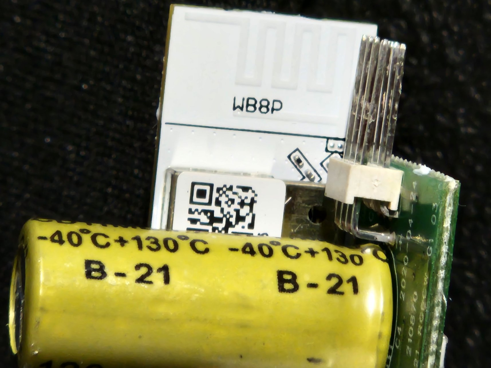

    It's a WB8P. More pictures:
    [BK7231T] Cree A21 100W RGBCW bulb [BK7231T] Cree A21 100W RGBCW bulb [BK7231T] Cree A21 100W RGBCW bulb [BK7231T] Cree A21 100W RGBCW bulb [BK7231T] Cree A21 100W RGBCW bulb
    This one shows where to connect the wires.

    Thanks, I have added the extra information to the database.
    By the way, did the manufacturer "forget" to solder something here?

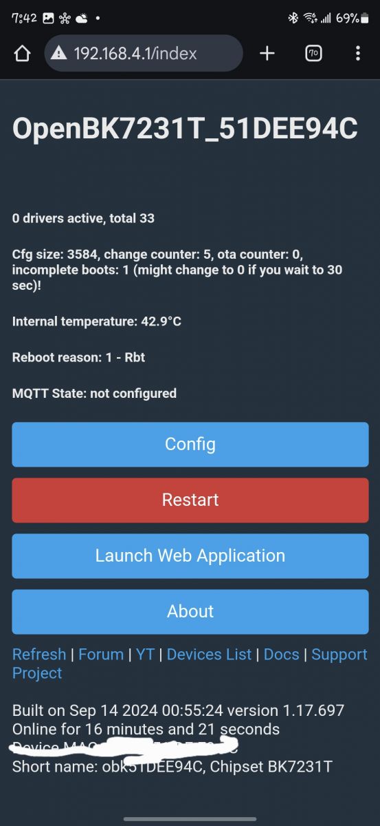

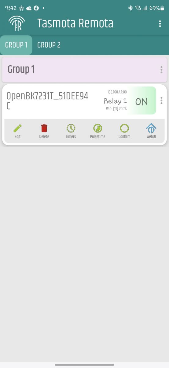

    #10 21358205
    fierrote
    I need some help figuring how to use openbeken. I used the tuya-cloudcutter to install the firmware. After adding the Wi-Fi credentials the bulb won't light up. I'm able to enter the config web and don't know where to start. I used the Tasmota Remota app to connect directly to th Cree bulb but can't turn it on. I tried googling but can't find a good guide. Trying to add to smartthings but only see it for home assistant. If you can guide where to start. Thanks. OpenBeken user interface with configuration and restart options for the device. Screenshot of the Tasmota Remota app displaying a device OpenBK7231T.
  • Suggesting template extraction or manual PWM pin setup
    #11 21358431
    Posts: 14771
    Rate: 12914
    Welcome to forum, @fierrote . The lack of RGBW controls on your main panel strongly indicates that you haven't configured your bulb yet. Can you try doing template extraction as on our video?
    Alternatively, have you just tried to set manually the specified pins to PWM, as shown in the first post? It can be done via GUI in the Configure Module menu, under Config.
  • Device selection from drop-down fixed configuration
    #12 21360215
    fierrote
    I went into the config and just pick my device from the drop list instead of input manually (because I'm lost) and it worked. Now figuring how to add it to HA. I install it in a QNAP NAS, but apparently you need the supervised version and could not find it on the NAS. I have N100 board on the way that I ordered and going to install it there. I really want to add it to smartthings but can't find much information. Thank you.
    edit: I just the first post and it has the pin layout, I didn't know what meant. I though it was the pin layout you needed to tap into to flash.
