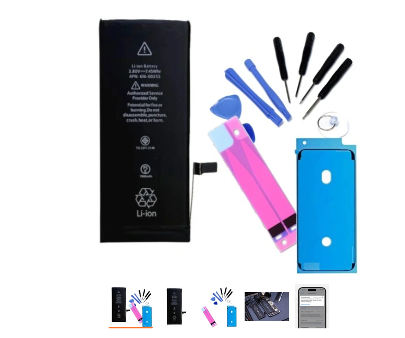

How do I replace the battery on my iPhone? How do I remove the screen? How much does such a replacement cost if we do it ourselves? Can a complete layman (me) handle it? Here I will try to answer these questions, as circumstances forced me to perform this replacement. After many years of use, my iPhone had essentially stopped working on its battery, it held a charge for maybe 15 minutes and the % charge jumped from 100% to 1%. For this reason, I decided to replace it, and to make it more interesting, I did it myself...
Purchasing battery kit [/size] .
You can get a kit on the internet containing (supposedly?) all the necessary tools for this operation. I will check it out. I purchased it for 60zł:
iPhone battery replacement kit with screwdrivers and tools. .
The battery here is unlikely to be original, but as long as it works I won't complain. You can get shipping for free, so for now the cost of play is 60zł....
The kit should be matched to the phone you have - the battery for the iPhone 7 Plus does not fit the iPhone 7 itself, etc!

In this kit from the topic I still have a sort of insulating frame under the screen, but I haven't fitted it for now.

In addition, there was a hitch in the whole process, because the cheap screwdriver from the kit failed after 3 screws, but the seller quickly sent me a replacement... what quality must these screwdrivers be that one broke so quickly? After all, I didn't try to unscrew the mismatched screw with it....
I can also point out here that I only used two screwdrivers from the set and there were four. I didn't need two more.
Basically, however, I closed in this amount of PLN60 anyway, there were no additional costs.
