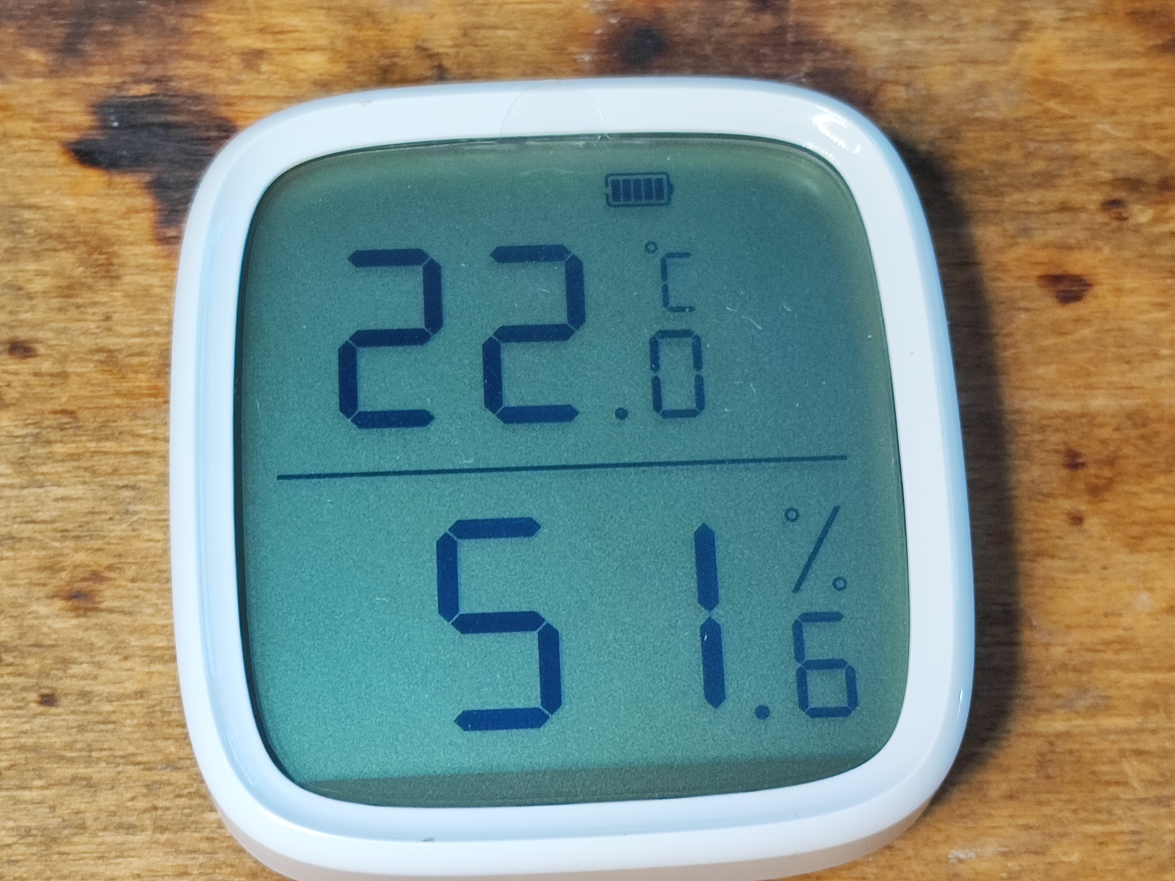

  • Sonoff SNZB-02D is a tiny temperature and humidity meter with a 2.5" display, measuring 62.5x59.5 mm and running on a CR2450 3V battery.
  • It pairs with Home Assistant through Zigbee2MQTT and exposes temperature, humidity, battery level, and connection quality entities.
  • The teardown found a BU9792FUV LCD controller, Puya P25Q80H Flash, and a C224HG/EFR32MG22 Zigbee SoC, plus an unspecified humidity/temperature sensor.
  • The meter costs about PLN60 locally, works well with Zigbee2MQTT, and the battery-powered design cannot extend Zigbee network range.
Sonoff SNZB-02D temperature and humidity sensor with display. .
Today I am going to present a useful gadget for every desk - the Sonoff SNZB-02D, which is a tiny temperature and humidity meter with a 2.5" display. Dimensions: 62.5x59.5mm. All battery-powered (CR2450 3V) and additionally connectable to Home Assistant via Zigbee2MQTT. In our country, it can be purchased for around PLN60, from abroad it can be imported for almost half as much.

The sensor provides four entities - temperature, humidity, battery level (from 0 to 100) and connection quality:
Application screen showing data for Sonoff SNZB-02D temperature and humidity sensor User interface displaying data from the Sonoff SNZB-02D temperature and humidity sensor. Temperature and humidity calibration and precision settings screen. Screenshot of SNZB-02D sensor data in Home Assistant. .
Based on these measurements, automation can be carried out in the Home Assistant and the history of measurements accumulates itself in clear graphs.

Handy, small and hassle-free. Zigbee2MQTT works well. Definitely a better choice for local operation than the same type of display but WiFi based, no need to change the batch, no configuration problems.... The only thing to remember is that, as a battery-powered device, the SNZB-02D is not able to extend the range of our Zigbee network.
Other than that - highly recommended.
