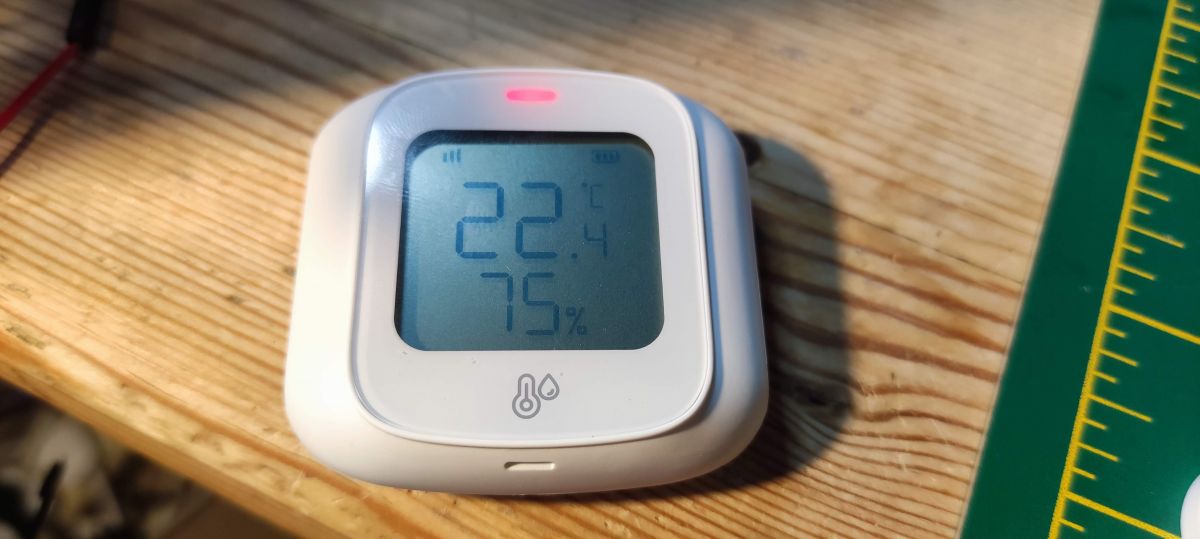

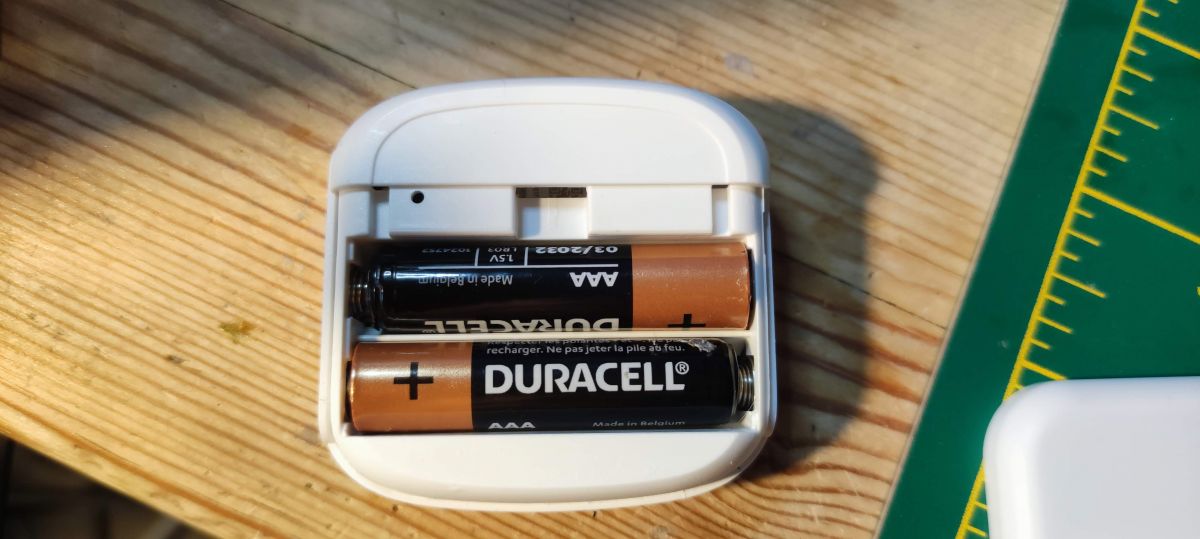

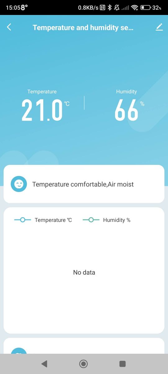

    Grabbed this from Ali as it's not one I've seen on the forums or played with myself. Comes in Zigbee and Wifi flavours.
    View of Tuya Smart WiFi/Zigbee thermometer and hygrometer with LCD display.
    As with the TH01s and the door sensors this takes 2x AAA batteries so some considered deep-sleep power management settings will be needed or the batteries will die within a day or two. Especially so considering there is no TuyaMCU.
    The packaging contains only the device, a double-sided 3M spot sticker and a reset pin for the push button hole, situated under the battery cover. No manual or protective device sheath.
    Digital temperature and humidity meter with LCD display. Interior view of a device with two AAA Duracell batteries. Package with temperature and humidity sensor and accessories Packaging of temperature and humidity sensor with accessories Packaging of temperature and humidity sensor with accessories Device addition screen showing a temperature and humidity sensor being added. Software update screen showing no updates available App screen showing temperature 21.0°C and humidity 66%. App interface showing temperature and humidity sensor data

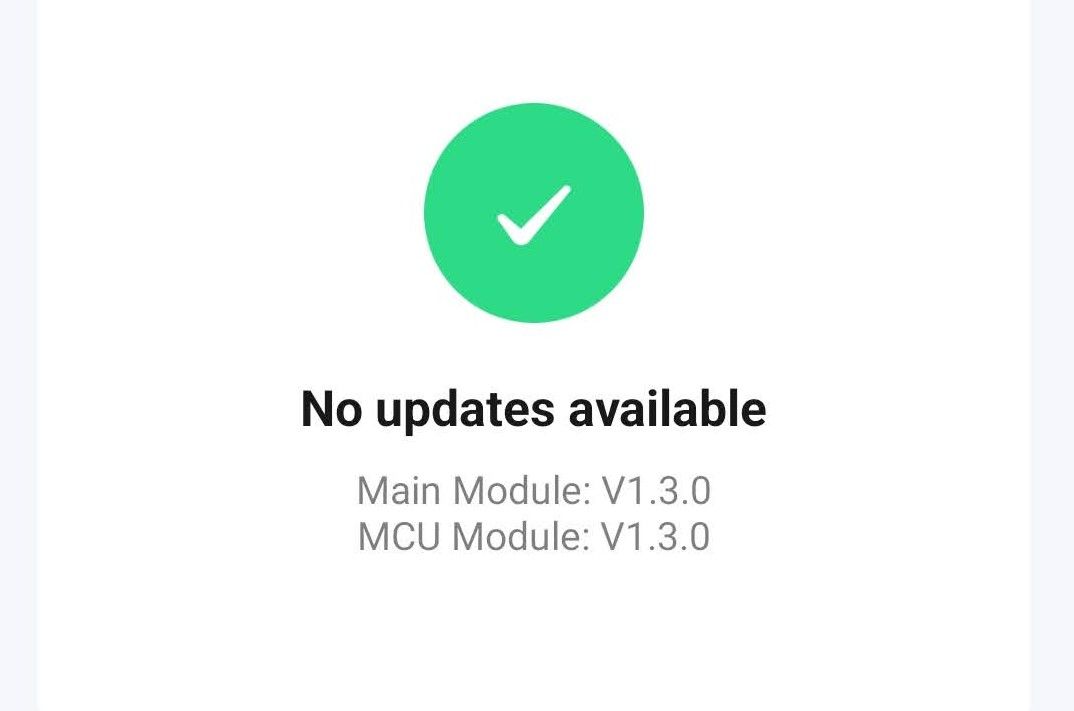

    That factory firmware version is not suitable for Cloudcutter exploitation. LED behaviour is flashing when in pairing mode then off.

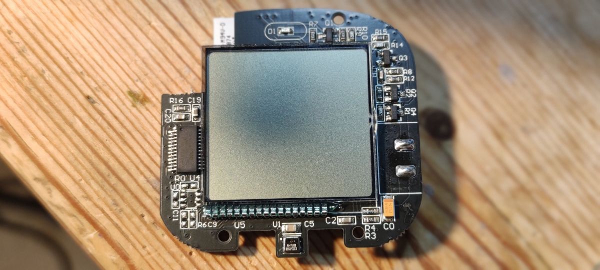

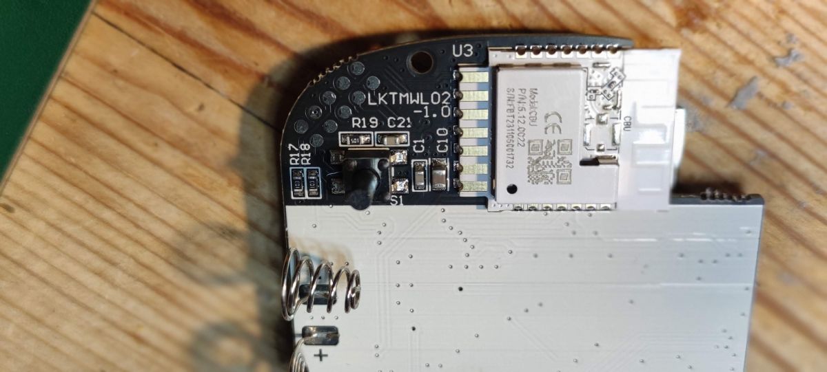

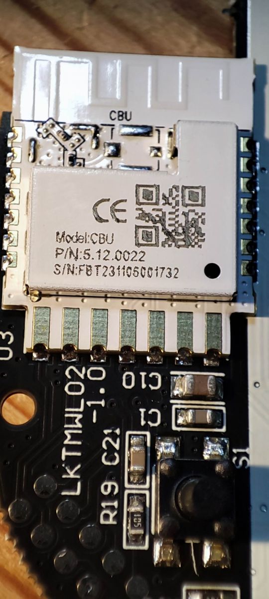

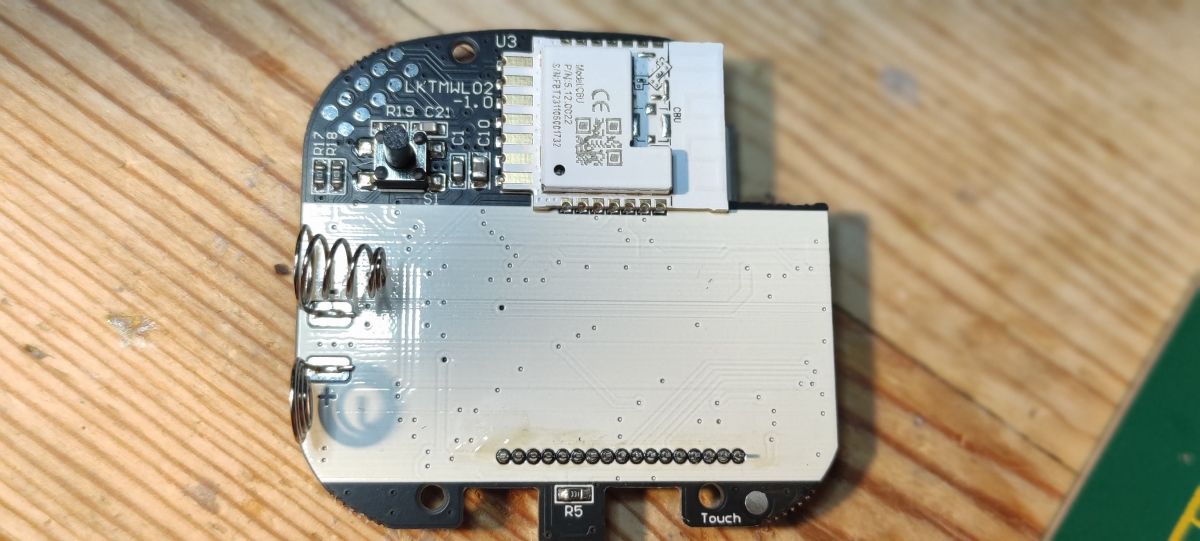

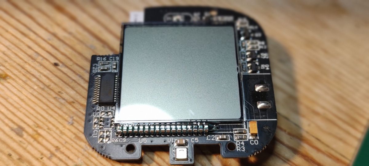

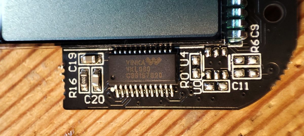

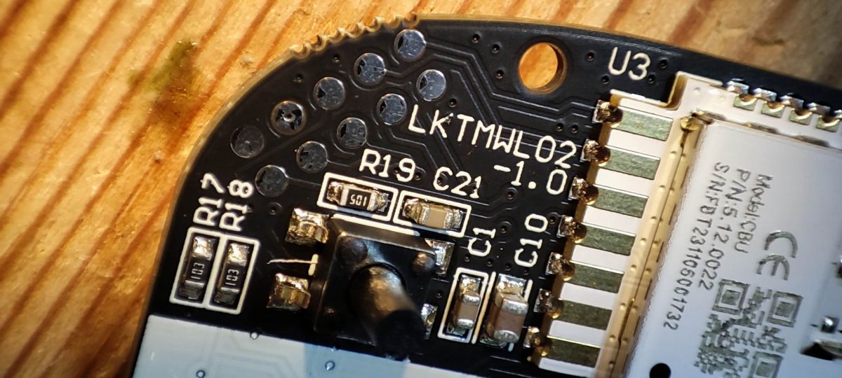

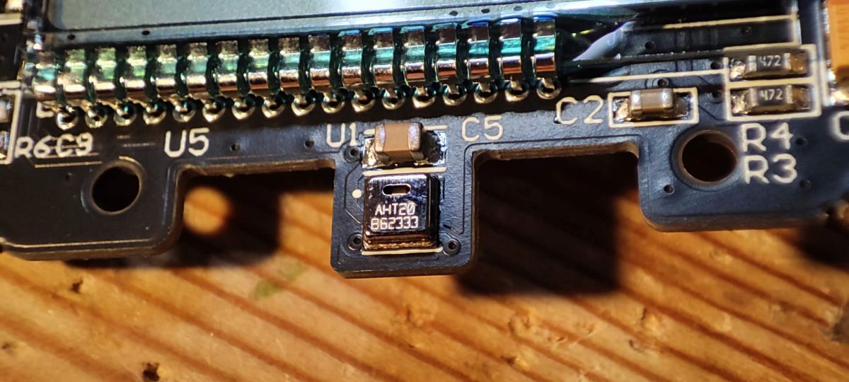

    Inside the device we see a CBU (BK7231N) module with RF shield (which I later removed), an AHT20 - an i2c temperature and hygrometer sensor, an LCD display (not sure of resolution) and a Vinka Microelectronics VKL080. VKL060 is a dot-matrix memory-mapped LCD driver that can support an LCD screen with a maximum of 60 points (15SEGx4COM).

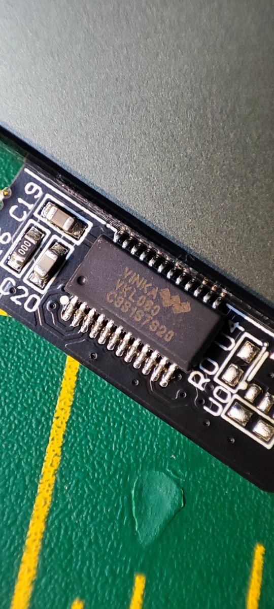

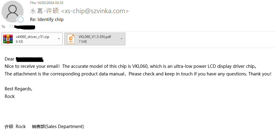

    I emailed Vinka about this as their site only lists a VKL060, Googling VKL080 produces no results of meaning. I was impressed with the prompt response. I never usually get one.
    Screenshot of an email regarding VKL060 chip identification.
    Datasheet and driver attached though they are available from their site.
    Inside the device:
    Close-up of Vinka VKL060 chip on a PCB Electronic module labeled LKTMWL02 with components including battery slots. LKTML02 sensor circuit board with BK7231N Wi-Fi module Circuit board with LCD display and electronic components Electronic board with LCD display and SMD components. Vinka VKL080 chip on a circuit board. Close-up of the CBU module with visible markings and serial number on the LKTMWL02 board. Close-up of AHT20 chip on a circuit board. Close-up of an electronic board with an LCD display Close-up of PCB model LKTMWL02 with visible components and markings.

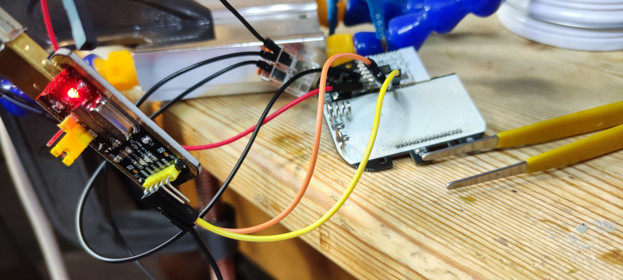

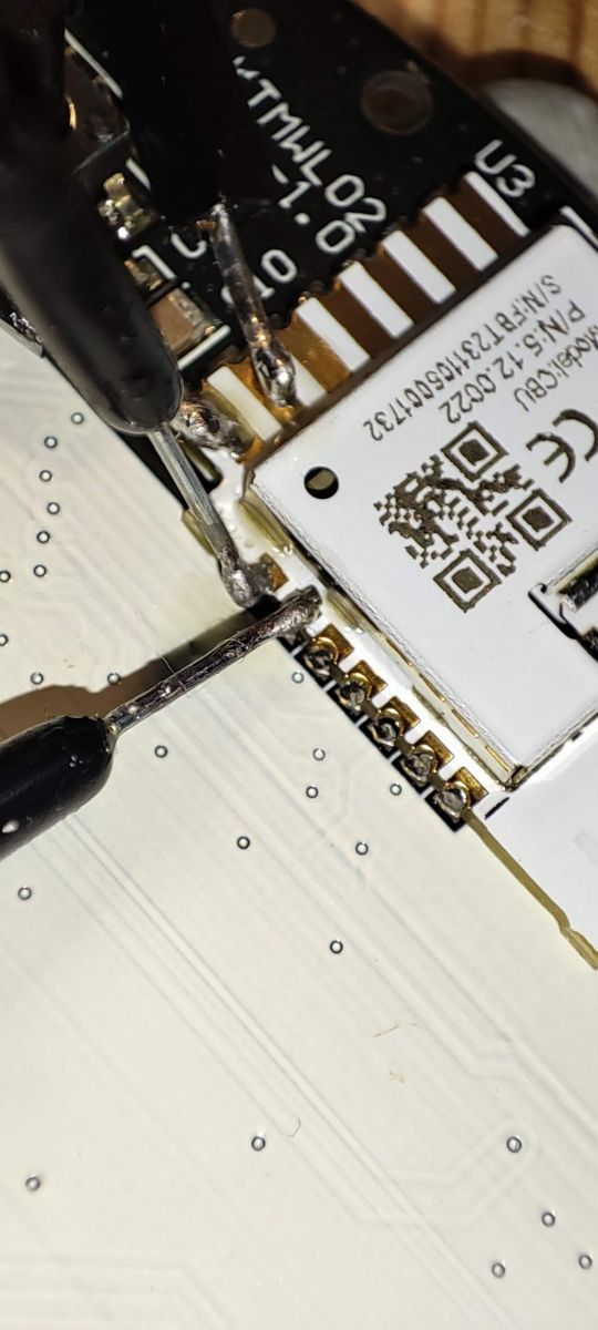

    I soldered pwr/gnd and used pogo pins on the RX2/TX2 to capture factory boot log
    Interesting it mentions BK7231NL. It also does some of the work on pin assignments for us, which we'll need later

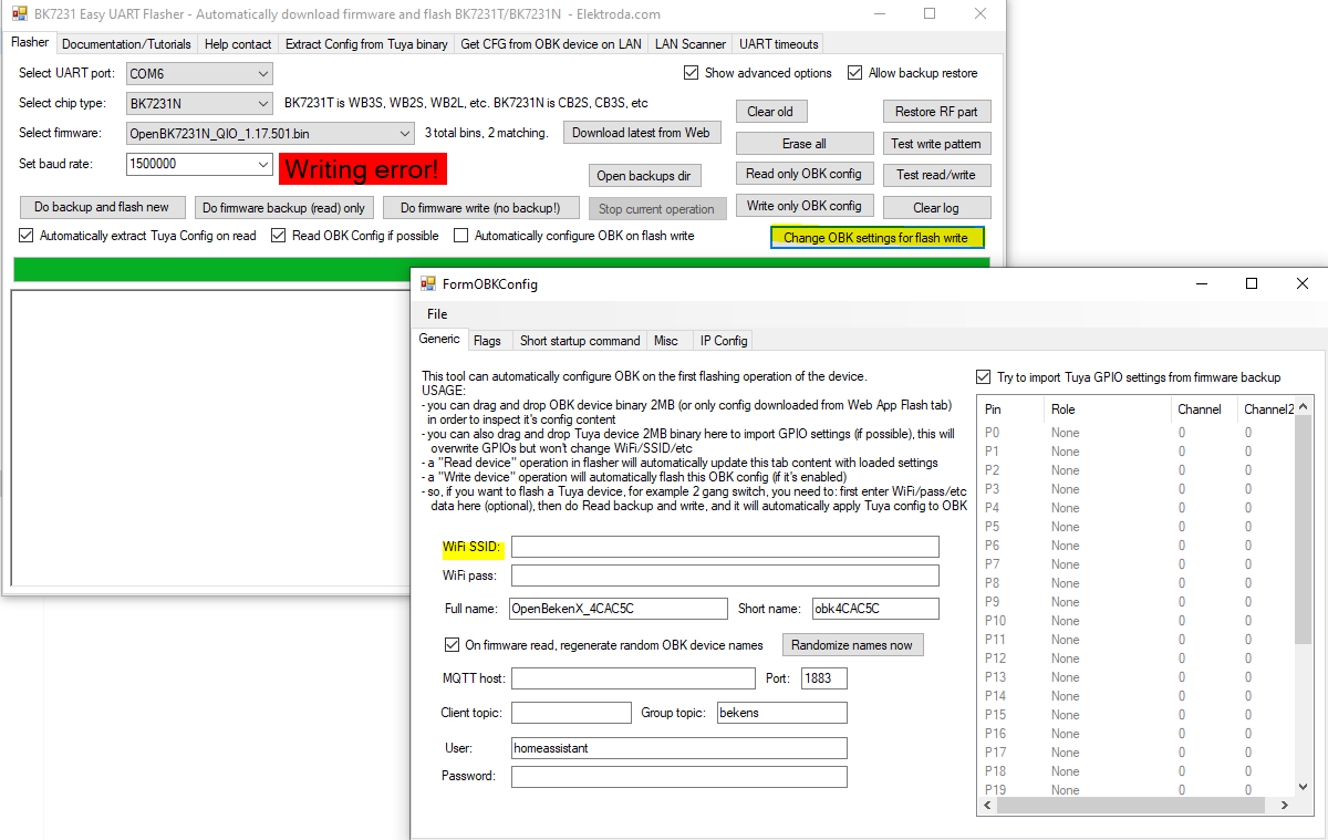

    Easy Flasher had trouble setting a baud reliably to dump flash so I soldered RX1/TX1 and shortened cables direct to USB-TTL
    Close-up of solder connections on a PCB with an electronic module visible.
    Close-up of an electronic circuit with wires connected to a PCB, on a wooden work surface.

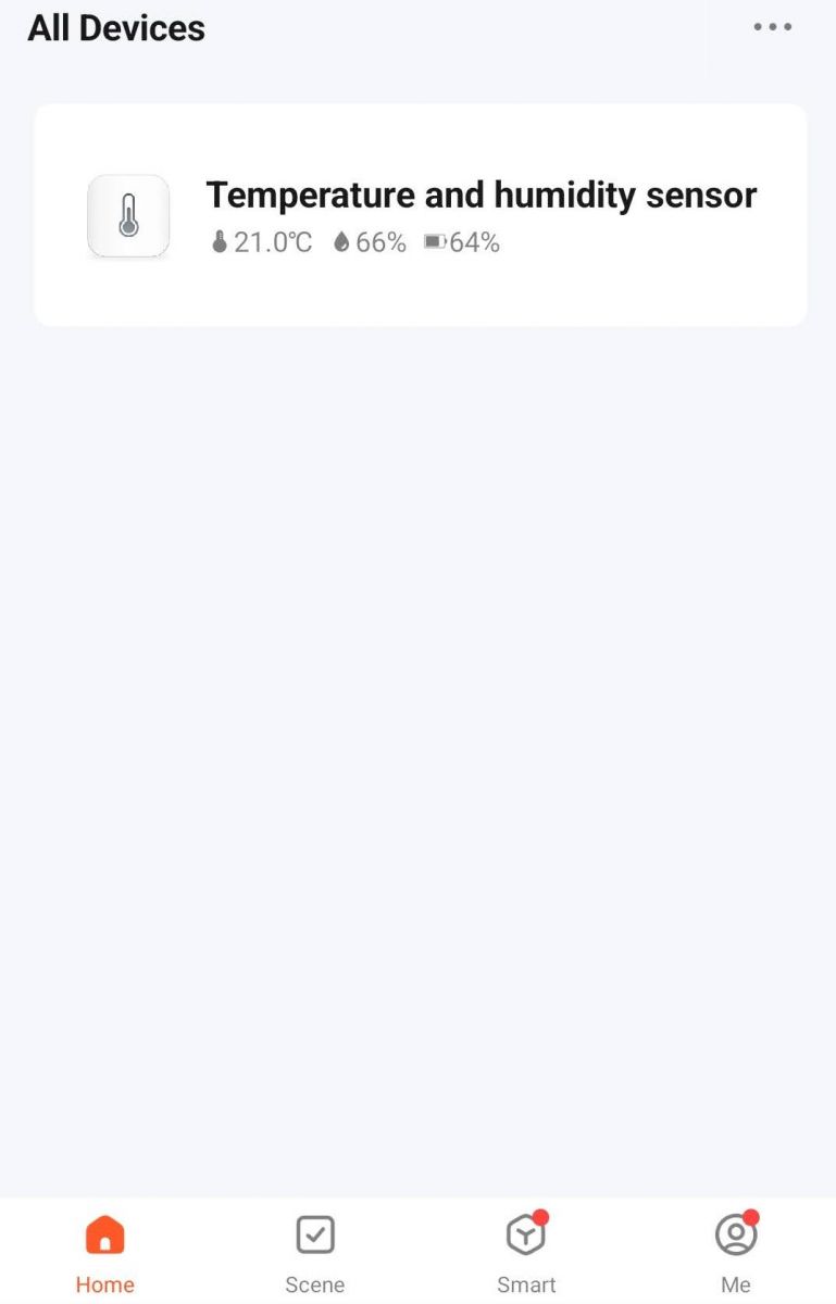

    Full Tuya API response for this device
    After flashing OBK the AP was oddly behaved. It would appear but my phone and PC could sometimes not connect or it would connect but not receive an IP from DHCP on the device. Once or twice it did let me bring up the web console but then died. I flashed it a few times and restored RF partition too. Back to factory firmware then to OBK again to fix mac address. I decided to forget AP mode and use the Easy Flash config setter. It's been fine connected to the router, so :shrug:
    Flashing software interface for Tuya devices with writing error

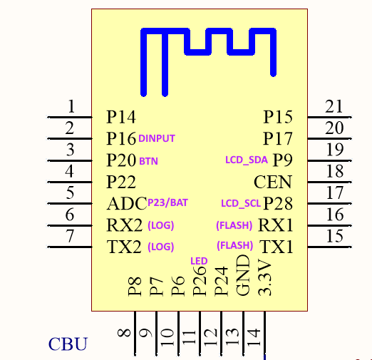

    We know some pins from the boot log and that BAT_ADC must be P23
    I tested the Btn and LED were correct. Not sure how or what dInput should be used for.

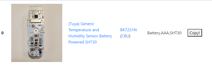

    I looked through devicelist.json for a similar config that could be used to complete BAT_REL, AHT20 SCK, AHT20 SDA. The template for this device covered all the above known pins
    "Generic Temperature and Humidity Sensor Battery Powered SHT30"
    https://www.elektroda.com/rtvforum/topic3945688.html
    Image of the interior of a battery-powered temperature and humidity sensor, models BK7231N and CBU, showing electronic components.

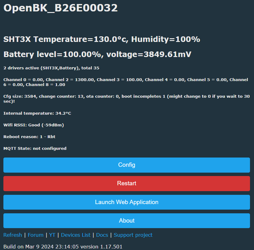

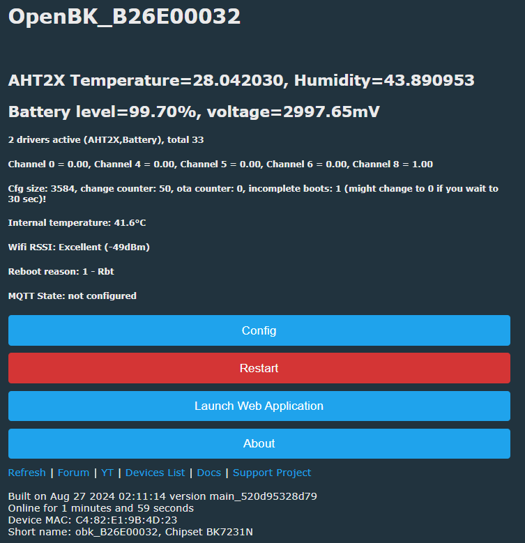

    Using that template produces this in the gui
    OpenBK user interface displaying temperature, humidity, battery level, and voltage data.
    Yes, while on external PSU, the battery level is correct, but I'm feeding it 3.35v not 3.85. The temp/hum is clearly wrong. This of course assumes the SHT3X driver is correct for the AHT20. I'm not sure OBK has a working driver for the AHT20 though or if the pins are just wrong at the moment. We could do with having a list of supported chips alongside the driver list here https://github.com/openshwprojects/OpenBK7231T_App/blob/main/docs/drivers.md - for example, CHT8305 now supports CHT8310 too. Unfortunately I cannot get multimeter probes under the AHT20 to be able to trace SDA/SCL to the CBU.

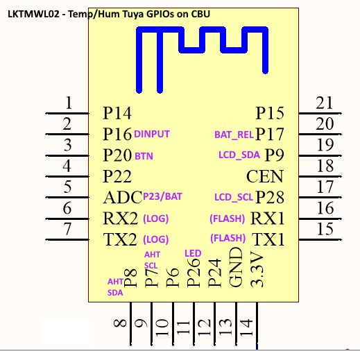

    I have however traced the pins for the VKL060 :D. Here's what we know for certain so far
    Pin diagram of CBU module with labels.
    though I have no way of using the display at present. The LCD is currently blank with OBK, as one would expect. I recall seeing something about SoftSDA and SoftaSCL in another post, so gave that a go on the pins for the LCD controller. With these set:
    and after running:
    we get a result:
    But I'm yet sure what happens from here. I guess the driver needs sorting?

    actually. switching the SHT3X pins assigned to SoftSDA/CLK produces this on scan, so I guess maybe those pins are right
    and only P17 set as BAT_RELAY gives any readings for voltage and battery level, so I guess that's right, just needs calibrating down.
    so now:
    GPIO pin diagram for LKTMWL02 with function labels.

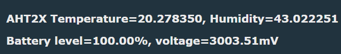

    It assigns temperature to channel 2 and humidity to channel 3. I don't know what I'm doing yet so I'm not sure if that's wise or correct, but it looks like it works to me.
    I'm still learning how to do all this, but I've cloned the repo and applied the required changes; binaries can be downloaded from the Artifacts at my repo the same way they can from the Build System. I've turned off TuyaMCU, Wemu, and Hue drivers and enabled AHT2X. It is my test/learning repo so it'll be messy; this is my first unsupported OpenBEKEN device so I'm just now learning how it works inside.
    It shows temperature and humidity in the web interface, claims to be reporting via MQTT -- I haven't tested it further.
    Does anyone reading this know about displays in OpenBeken? Is there a chance it can be enabled and used without a driver, ie, poked and tested via commands? I bought four of the stupid things thinking they were Zigbee and I refuse to ship them back to China. I've got free time so I'm willing to give it a poke.
    EDIT: Battery calibration works, but the firmware seems to be confused somehow?
    startdriver battery
    battery_setup 1500 3000 1.95 2400 4096
    Info:DRV:DRV_BATTERY : Measure Battery volt en perc
    Info:DRV:DRV_BATTERY : ADC Value low device not on battery
    Info:DRV:DRV_BATTERY : battery voltage : 2738.759765 and percentage 82.583984%
    "Battery" is my bench supply, hooked up and feeding a measured 2.76v so I could take a swing at calibrating it. I'm not sure why it says the value is low, why it thinks that means it's not on battery, what the "en perc" means, but it's reading the right value and calculating a valid percentage, so I'm not sure how to correct this one.

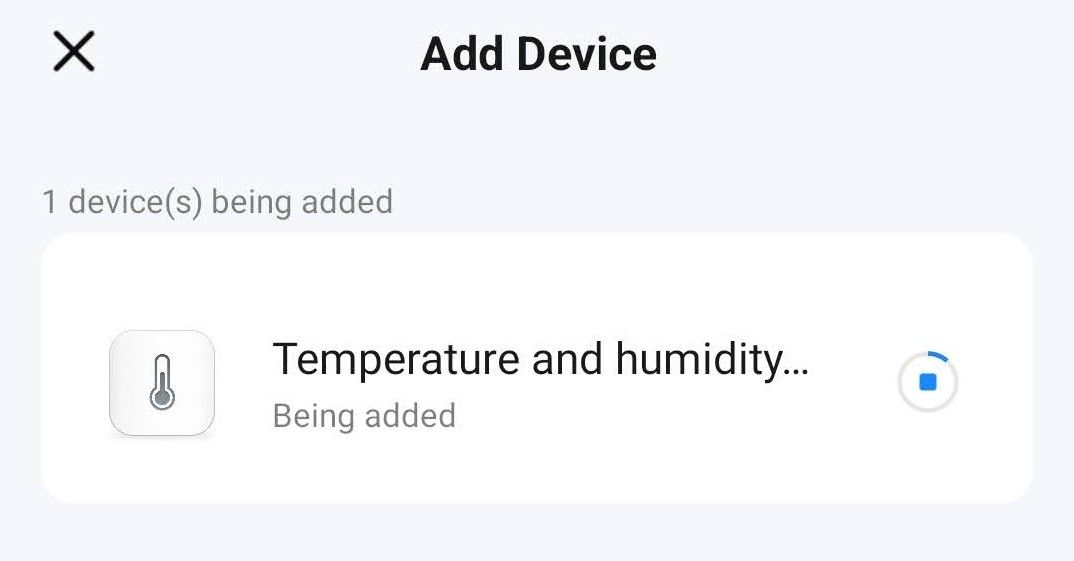

  • Wi-Fi connection failure after flashing firmware
    #7 21238019
    valentinviez
    I am very interested in your project, I have the same thermometers.
    So, I tried to use the firmware you generated above.
    Once the download is finished, the screen turns on and the temperature is correct! (Great)
    However, the sensor never connects to the Wi-Fi, so I cannot configure it.
    I tested with a 2.4GHz network but it's impossible, it refuses to connect to the Wi-Fi.
    Can you help me?
    I am a beginner and stuck :(

The AP shows but my phone can’t connect or gets no IP. How do I fix Wi‑Fi?
Restore the RF partition with Easy Flasher or flash back the entire factory firmware to reapply calibrated RF, then flash OpenBeken again. Also ensure your AP uses 2.4 GHz WPA2‑Personal (not WPA3 mixed). Several users resolved joining issues after RF restore or full factory reflash. [Elektroda, divadiow, post #21238177]
AP mode seems flaky. Can I configure Wi‑Fi another way?
Yes. Use the Easy Flash config setter to write SSID and password directly, then boot to your router. One user abandoned AP mode due to DHCP issues and configured over serial/tools instead, which proved stable once on the LAN. [Elektroda, divadiow, post #21003628]
How do I send sensor data to Home Assistant?
Enable MQTT in OpenBeken, set broker credentials, then publish channels. With startdriver aht2x 7 8 2 3, temperature is channel 2 and humidity is channel 3. Confirm messages with a test subscriber before adding to Home Assistant MQTT sensors. One tester noted the build “claims to be reporting via MQTT.” [Elektroda, CodeFaux, post #21205194]
Is GPIO16 actually used on this board?
GPIO16 appears unconnected on some samples. The button is on P20 and the battery ADC is on P23. You can leave P16 unassigned if it does nothing in your unit. Traces observed suggest P22 exists but may be unused in the shipped design. [Elektroda, divadiow, post #21206241]
