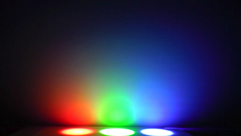

Three LED spotlights in red, green, and blue illuminating a wall, blending in the center. .

In the prototype circuit I have used a 1W power LED. Of course, this part can be freely extended.

@efi222 Congratulations on making this device. However, I was concerned with colour mixing and not flashing three separate colours. Colour mixing as it is, for example, on an LCD screen. Then there is... [Read more]
efi222 21 Mar 2025 22:05
This is a prototype. We have an RGB output. Further you can do whatever you want with it. You can mount the Led more point-wise. I focused more on the smooth modulation of the light. Nothing prevents you... [Read more]
Preskaler 22 Mar 2025 10:37
Sixty-plus years ago I did the blending on three bulbs painted with transparent spirit varnish and placed behind a milky glass. The bulbs were as close together as possible and placed some distance from... [Read more]
efi222 22 Mar 2025 11:01
LEDs, unlike incandescent bulbs, are not suitable for voltage control. The current characteristics are too steep. About the linearity of the luminosity of such a solution I will not even mention. (Most... [Read more]

For me "the bomb"! A really great job. White light will be difficult to achieve, because in this way of mixing there will always be unevenness in the individual colour beams and colour spots will appear.... [Read more]
