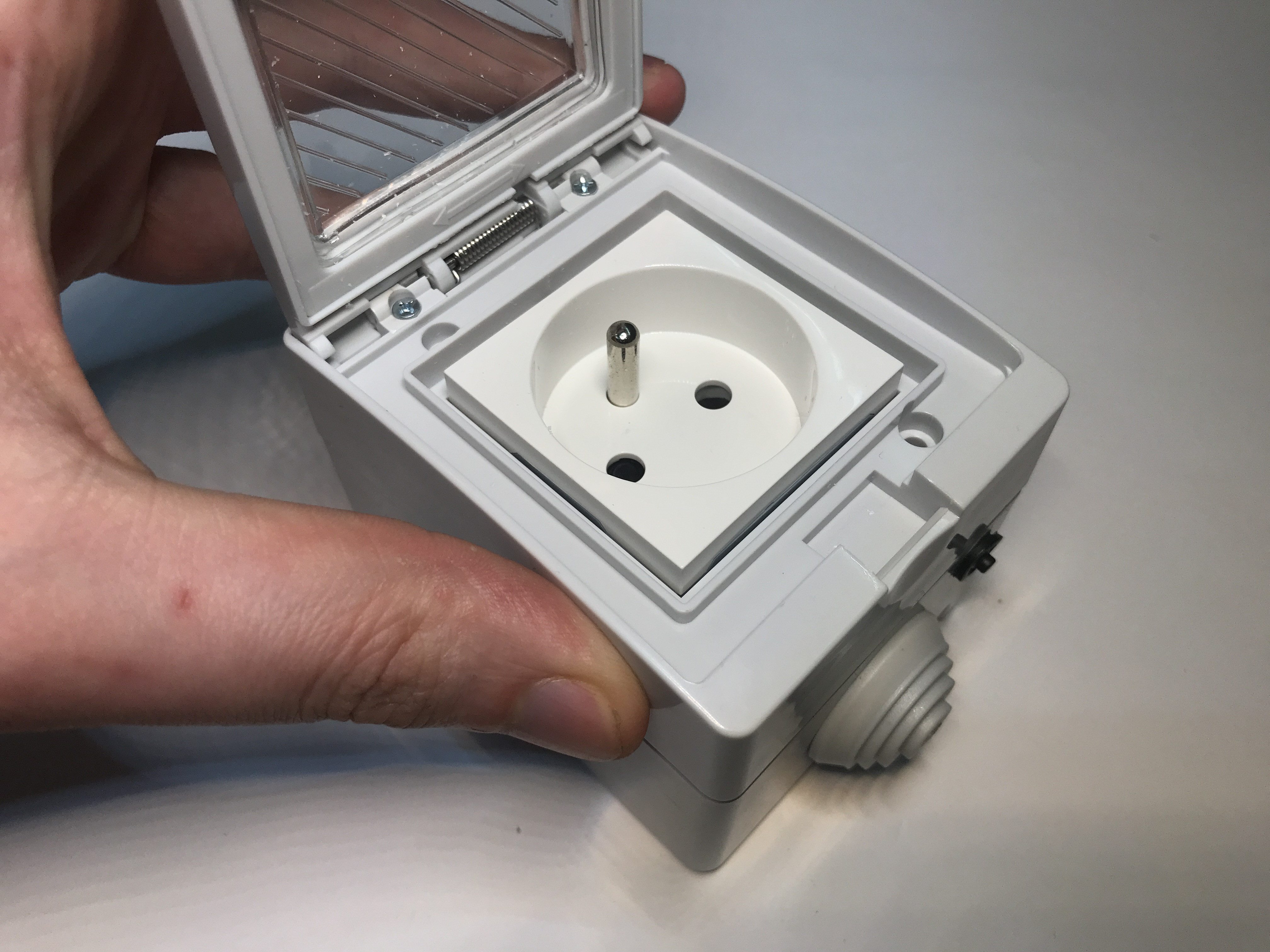

Here I will introduce the ATLO-S1IP5-TUYA external 'French' socket, offering control via WiFi and (emergency) via a button on the case. What sets it apart is that, in the series I tested, it is still based on the ESP8266, so Tasmota can be uploaded. The whole thing is purchasable at about the same price as the internal sockets, which is around PLN60.

However, I'm interested in the inside of the product, so it's time to unscrew the front panel:
Close-up of a hand opening the lid of an outdoor French-type electrical socket. .
Indeed, the manufacturer has made a basic effort to make this socket a little more resistant to moisture. Both plastic parts are protected by a rubber seal:
