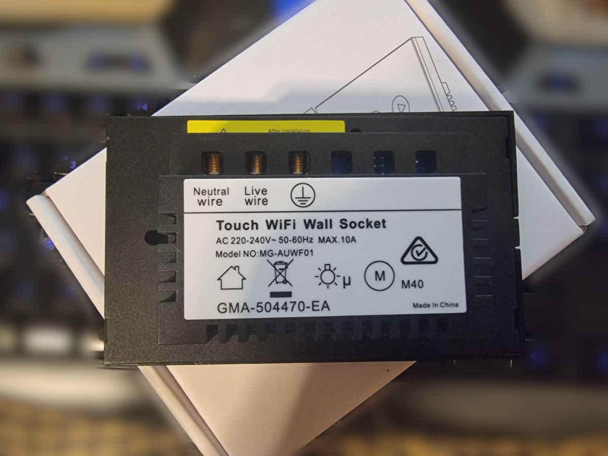

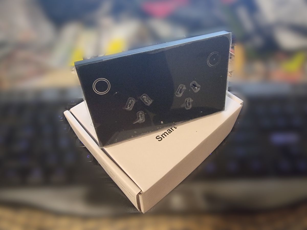

  • Glass touch panel with black surface resting on a white Smart Switch box. Rear label of MG-AUWF01 touch WiFi wall socket showing wire labels and specs. White box labeled “Smart Switch” with a drawing of a touch switch panel White box for smart touch switch with configuration options chart on the side
    I had previously bought a set of these around 2020 because they contained an ESP-12F with Tasmota support. later I bought some more, but they changed the chip used in them. Thankfully I've found people have been making a similar firmware for this board as well. There's no guide for this particular device however, but I can use this as an opportunity to contribute something!

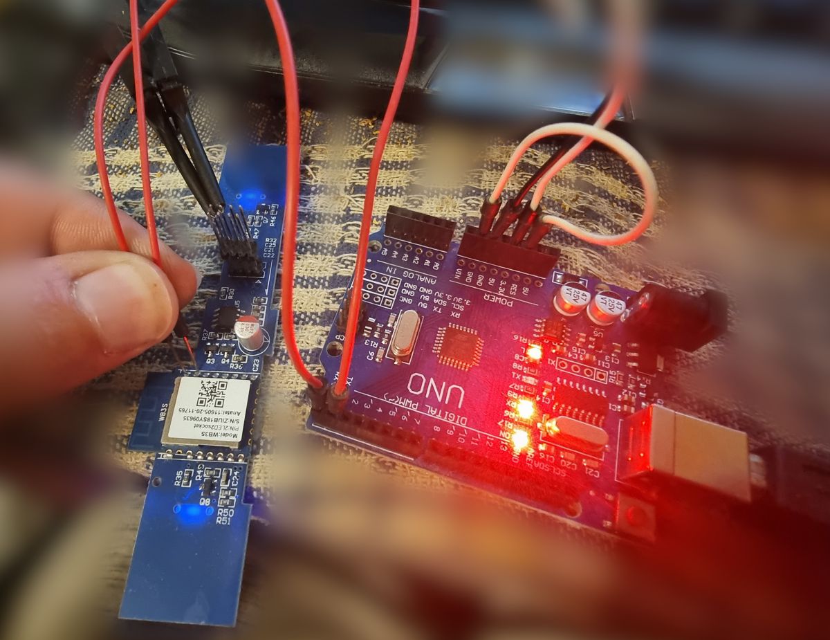

    I had only used tuya-convert before, so this was a bit of a learning curve, but actually doing the modification was not difficult once you've figured it out. once i'd done one of them, the rest took less than 5 minutes each.

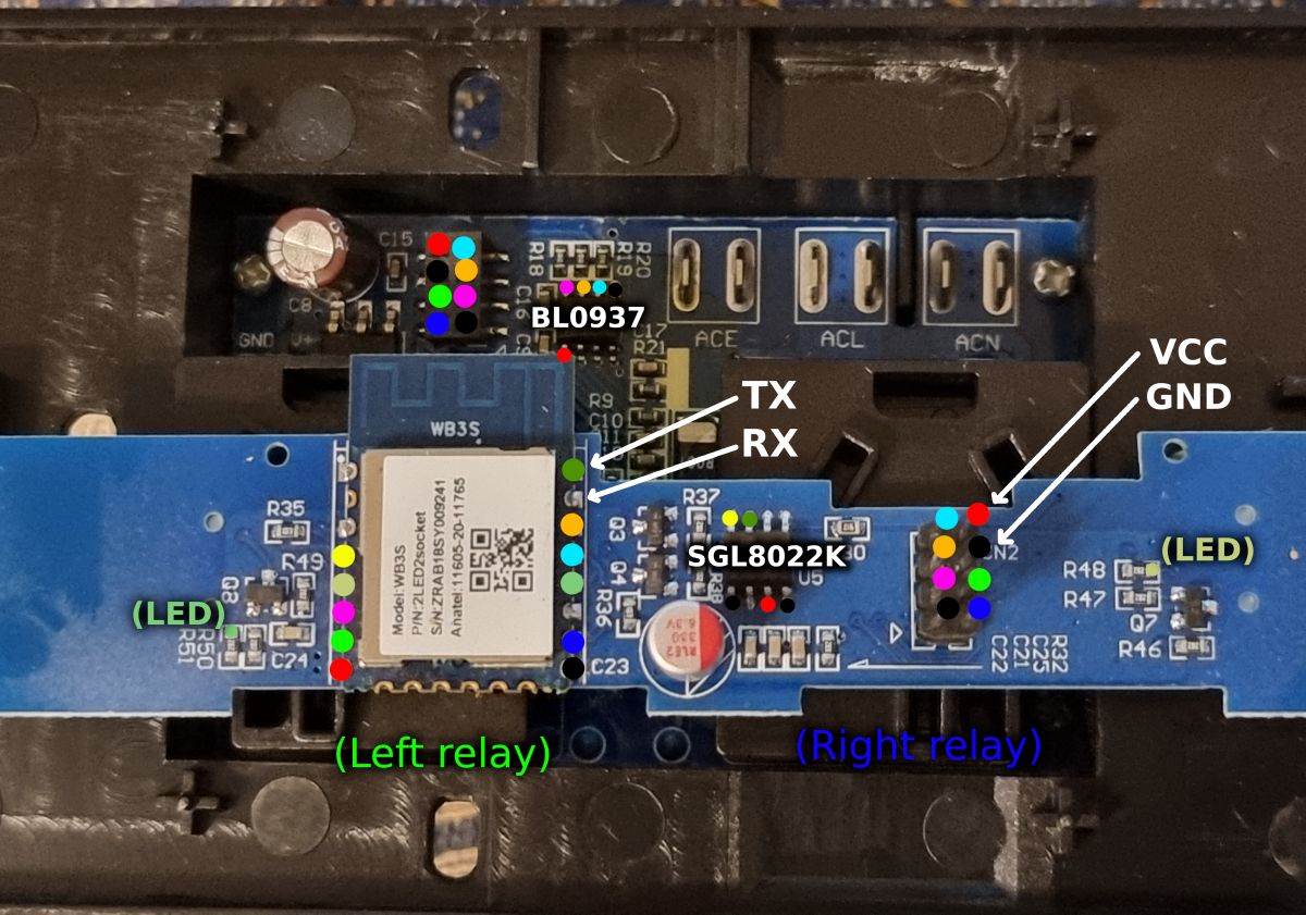

    Here's what i ended up doing for most of them. initially I soldered all four wires (VCC/GND/TX/RX), but later I used cheap probes for the power (could do wire wrapping instead), and just held the TX/RX by hand (no soldering!). Using a clone Arduino UNO held in reset in place of a USB to TTL serial adapter. I used the BK7231 Easy UART Flasher tool, running it under linux using mono. A baud rate of 460800 was consistent for me. I simply held the serial wires in place, clicked the read/write button in the flasher tool, then plugged in the VCC pin to the Arduino.

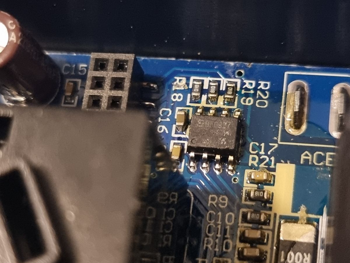

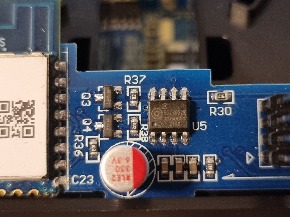

    GPS module connected to Arduino UNO board with wires on a fabric-covered surface Electronic module with labeled WB3S, BL0937, and SGL8022K chips and pin annotations

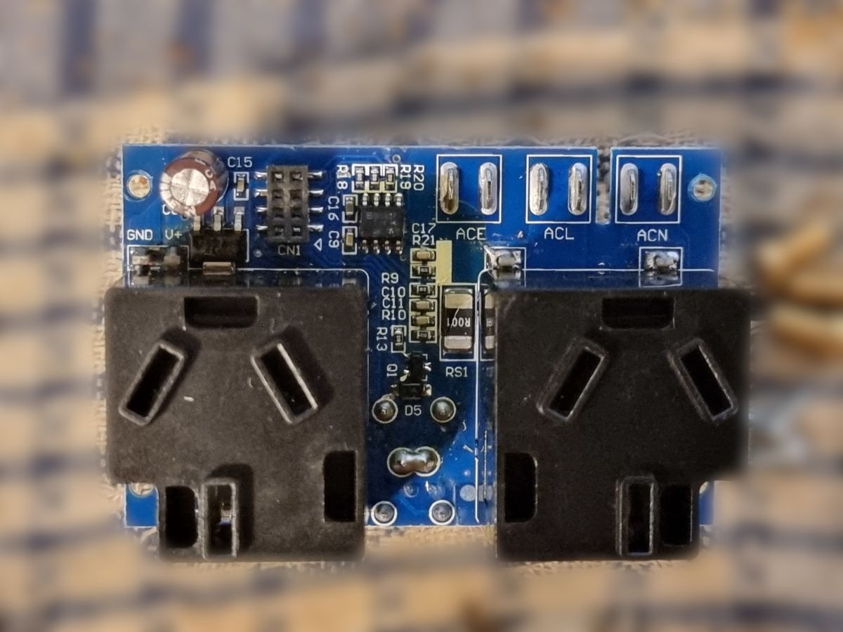

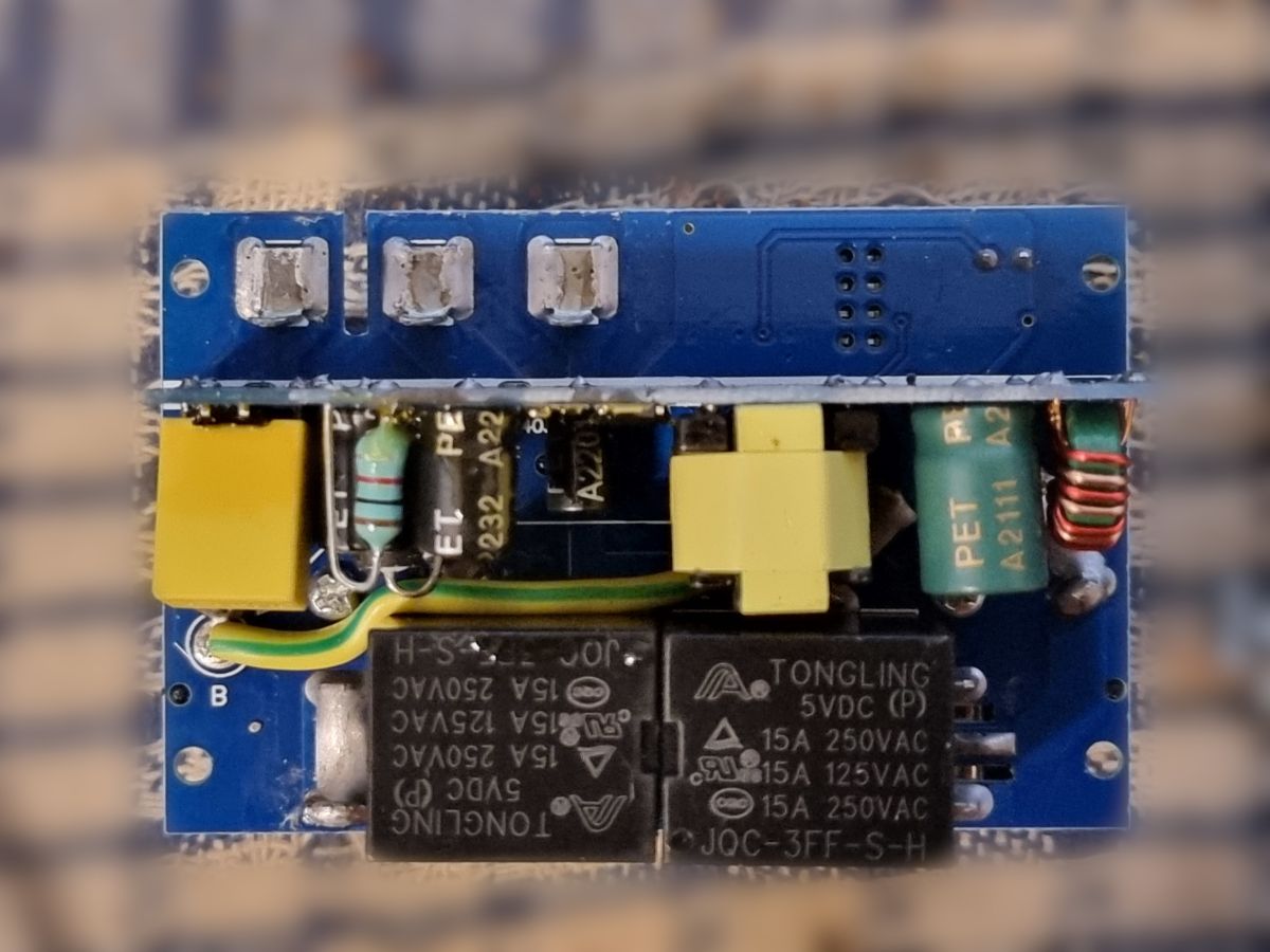

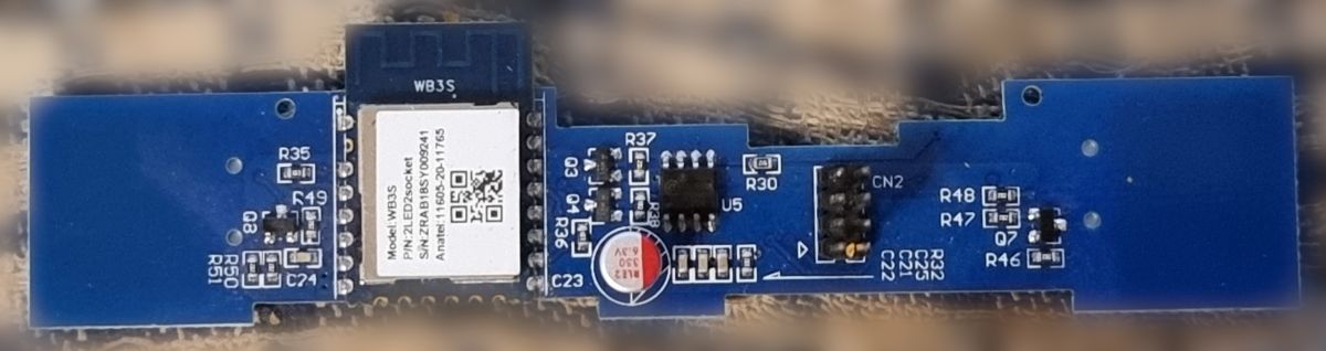

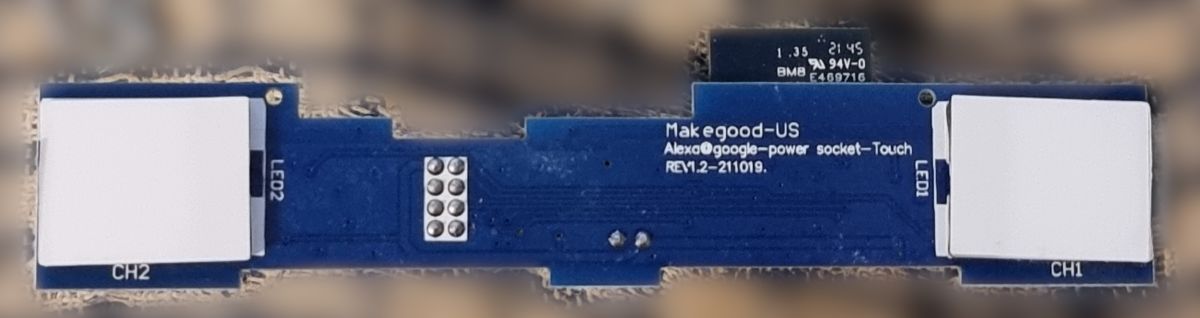

    Here's some photos of the boards:
    WB3S electronic module on blue PCB with SMD components and pin headers Makegood-US touch PCB with CH1 and CH2 channels and two touch pads Circuit board with relay, capacitors, and screw terminals Electronic module with AC sockets and components mounted on a blue PCB Close-up of a blue PCB with a BGL8022K microchip and various electronic components Close-up of an integrated circuit and SMD components on a blue PCB

    A general explanation of how to configure OpenBeken for a new device would be nice. I spent some time figuring out how the pin numbers in OpenBeken correlated with the board I have, before realising the pin numbers are for the Beken chip itself, so I basically had to ignore them and use the names for the pins only (except pin 14 which was just pin 14). I also didn't learn OpenBeken had tools to detect and test pins within its' UI before I had already worked it out by tracing/beeping out each pin with a multimetre
